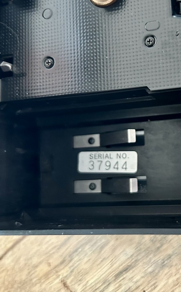

  4. Emiel
    1,113
    I thought I had shared the serial # of my unit:
    37944, pointy head.
