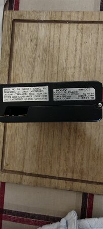

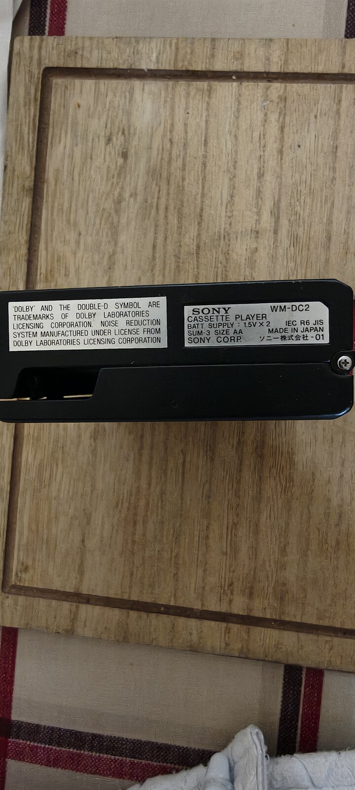

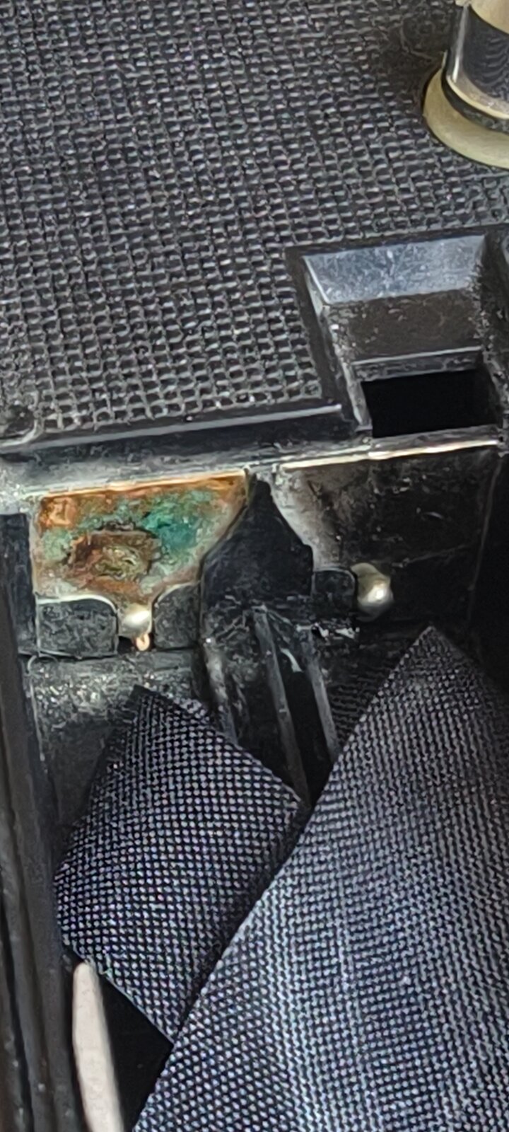

    Many years ago I was given my now late dad's WM-DC2 Walkman. It was just the Walkman and 2 red speakers. I recently opened the battery compartment and saw one of the batteries had leaked. I therefore have no idea if the Walkman is in good working order. Turned to my "good mate" Google and being in the UK can see I need the AC-37 adapter plug. I have an AC-39 from the USA which a friend gave me but haven't as yet used it as still need to buy a transformer. On eBay I bought an AC-38 which is set to 240v. I connected it with a USA to UK plug and just for one second I saw the red light. The helpful seller advised it depends on which model I have eg. "E" but I don't know in which country it was purchased. Does the photo shed any light for which country it was manufactured ? Can I use the AC-39 with a 2 to 3 point adapter and a voltage converter? Did I damage the Walkman by trying the AC-38? Or the best case scenario would be if anyone has an AC-37 for sale? Any advice would be appreciated.

    Work on cleaning the battery compartment. How bad is it? Put up a picture here and people will advise what methods are best to try.

    Thanks for all the replies. As the consensus is to use batteries I will appreciate any advice as to how to clean the battery contacts. Does anyone have an explanation as to why the red light shone only for a second when I connected the AC-38 as mentioned in my original post. I am attaching 2 photos of the battery compartment which is not easy to capture.

    I would remove that battery terminal and clean it with a wire brush in a drill or with sandpaper.
    It's harder to clean it in place, while removing isn't hard at all. Only thing it requires is to press on the top part a bit inwards (towards the battery compartment) while pressing down.
    Soldering should be done only with terminal removed, otherwise there's a risk plastic holder will melt.

    Hi Valentin. To date I haven't tried to clean the battery compartment as am so nervous of causing damage and not confident enough to think I grasped your instructions on how to remove the entire battery compartment and solder - the latter confused me as what do I solder.

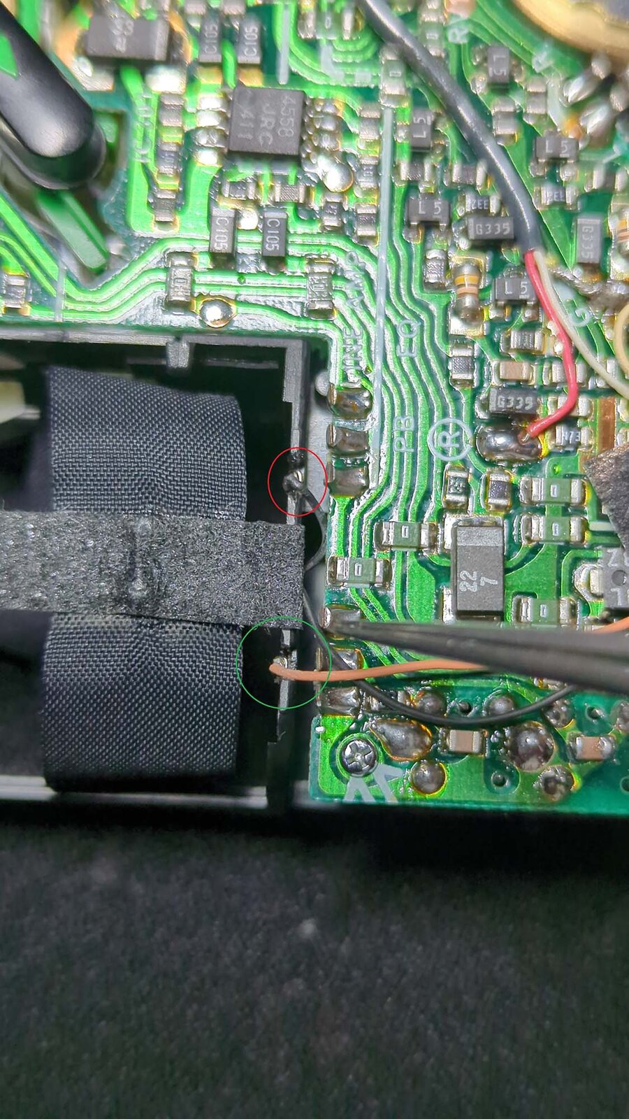

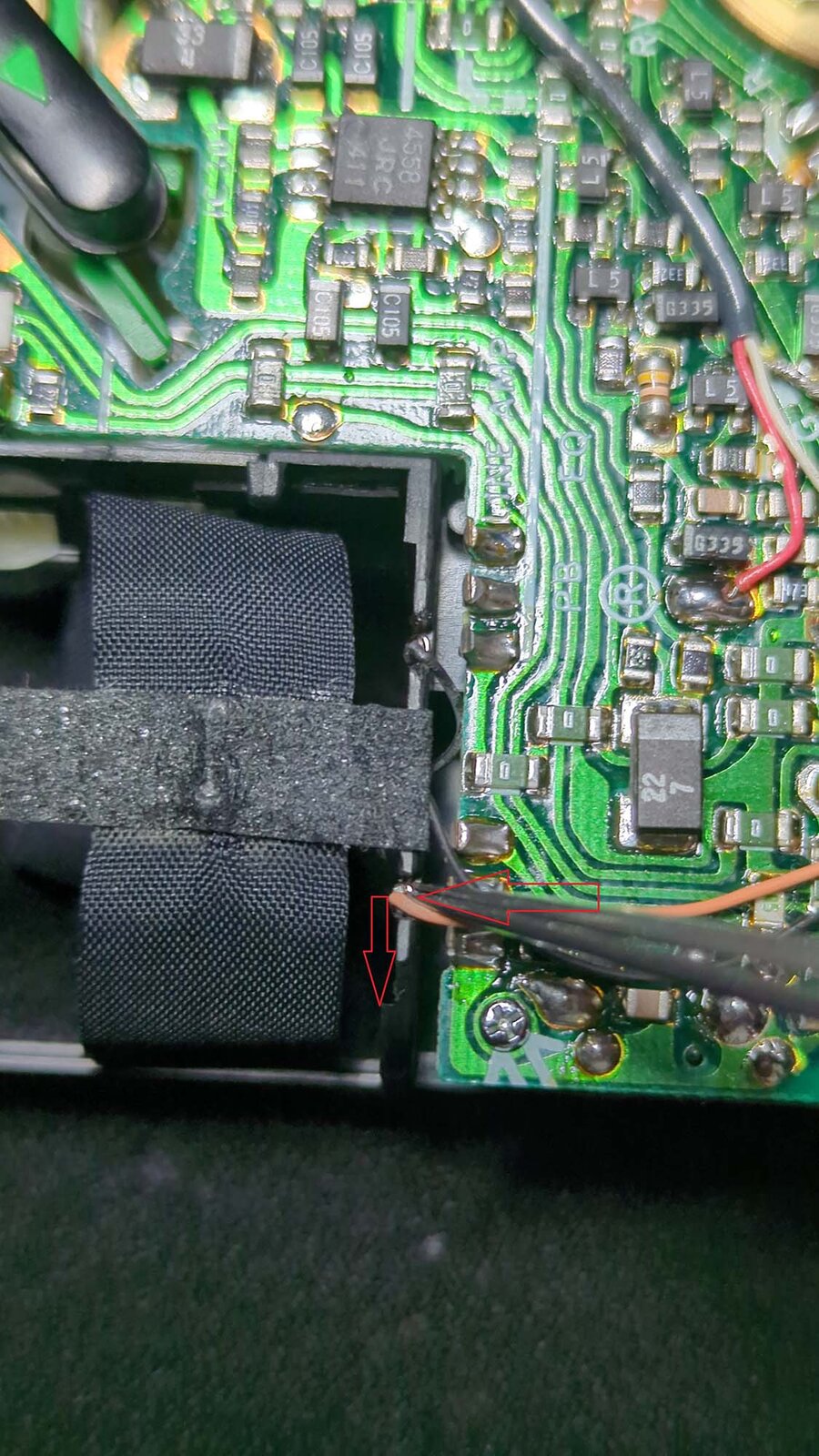

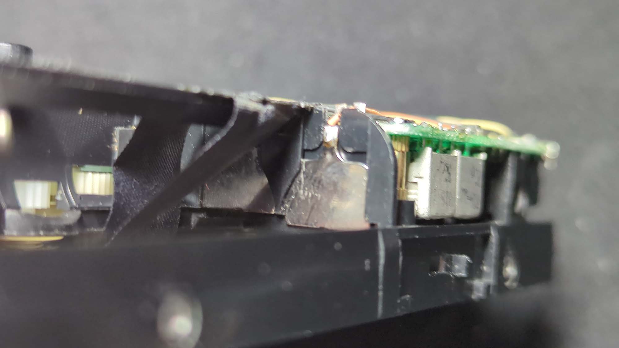

  9. Valentin
    1,956
    See pictures attached for more clarity.
    Battery compartment does not come out, it's part of the chassis. it's only the terminals that come out.
    You must push the top of the terminal (where wire is soldered) outwards toward the inbside of battery compartment then down (in the direction of arrows).
    The terminal is mounted on rails. Once it comes out you can desolder the wire and clean.
