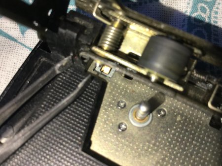

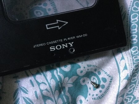

    Hi all, was just wondering what the size screws are for the front door to attach to the unit? Mine is missing two, and the screw holding the door on is bare. Its a lot bigger than the m1.4... perhaps requires a nut also?
    Also I’m missing another screw inside. The m1.4 are all present. There are two originally, one on each side of the head chassis, which holds the door assembly to the lower plate. It holds plastic to the metal in each corner. image.jpg image.jpg

    The screws holding the door to the walkman body are Sony custom made (Sony part number 3-307-831-00) as they also serve as hinges. In your case it looks like someone drill a hole in the door to add an extra screw but that is not how it is supposed to be fixed :)

    Ah! I knew it looked odd! I think from other images, there’s one screw in the door... is there a nut on the inside holding the screw? Curious to know what the original looks like. I have no comparison

    Possible, but the head mount is sprung with a small catch and easily accessible. My theory is the previous owner couldn’t get the custom screw and cannibalised this unit for another one in better condition and just used a wider screw. Another thing I noticed is the missing screw inside where the tweezers are, the door action moves the whole plastic area because this screw is missing, so possibly this action has worn out the original screw.
