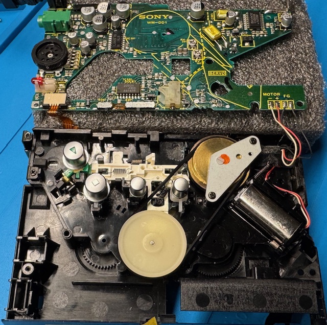

    I have been servicing my collection of Sony Walkmans for some time now.
    I replaced the belt and all the capacitors on my DD10. The audio sounds as it should again. However, there's one strange problem: I have to quickly press the play button twice to activate the Walkman. Pressing it once isn't enough. It's not the switch, because bypassing the switch with a test cable has the same effect.
    It's the white switch in the middle bottom of the PCB
    If the player works and I unplug the power cord and plug it back in, the Walkman starts playing immediately.
    Does anyone have any ideas what could be the cause of this?

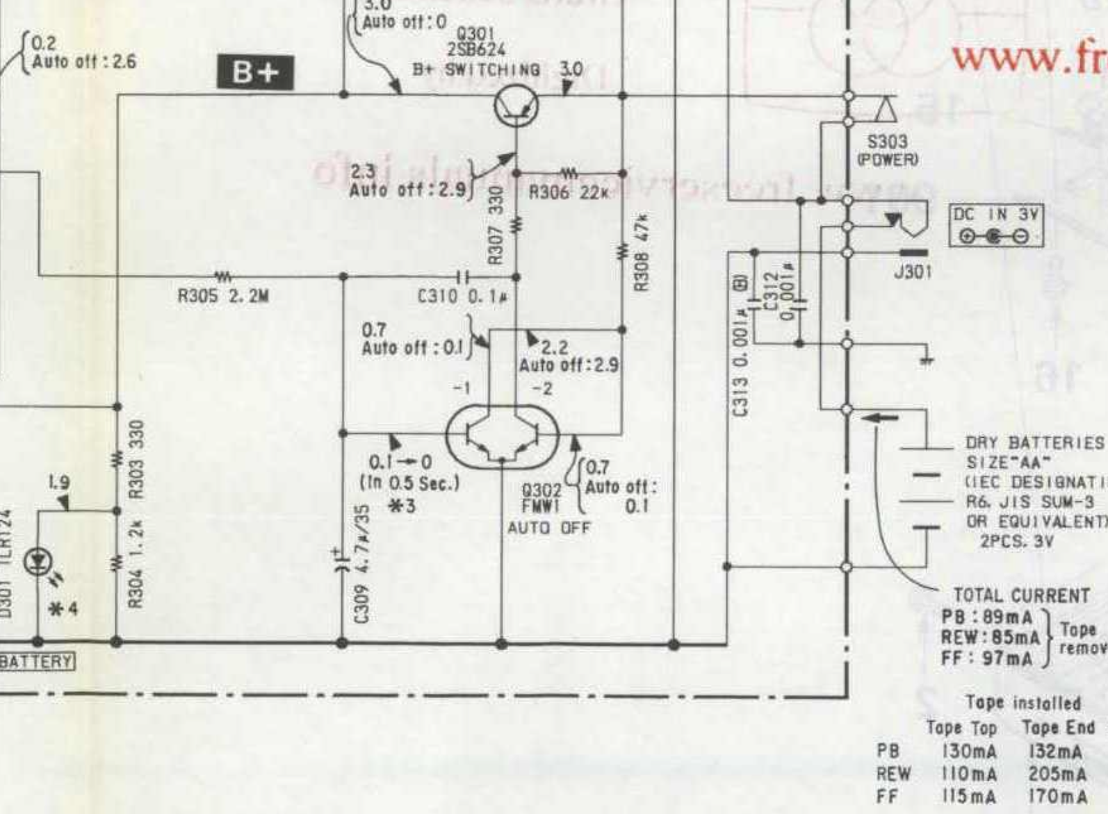

    I removed the switch and, with a test cable, short the two contacts on the print board. When I tap once, the motor does not start. When I tap two times (quickly) the motor runs.
    So it has to be an electrical issue. I replaced Q301 and Q302, but no effect.

    What happens if you remove R305 from the circuit ?
    What about the power LED, does it remain on even after 1 press ?

    I soldered the C309 on the wrong place. (My DD-1 print deviates from the schematic I have)
    I soldered it on the right place. Now the WM functions perfectly!!
