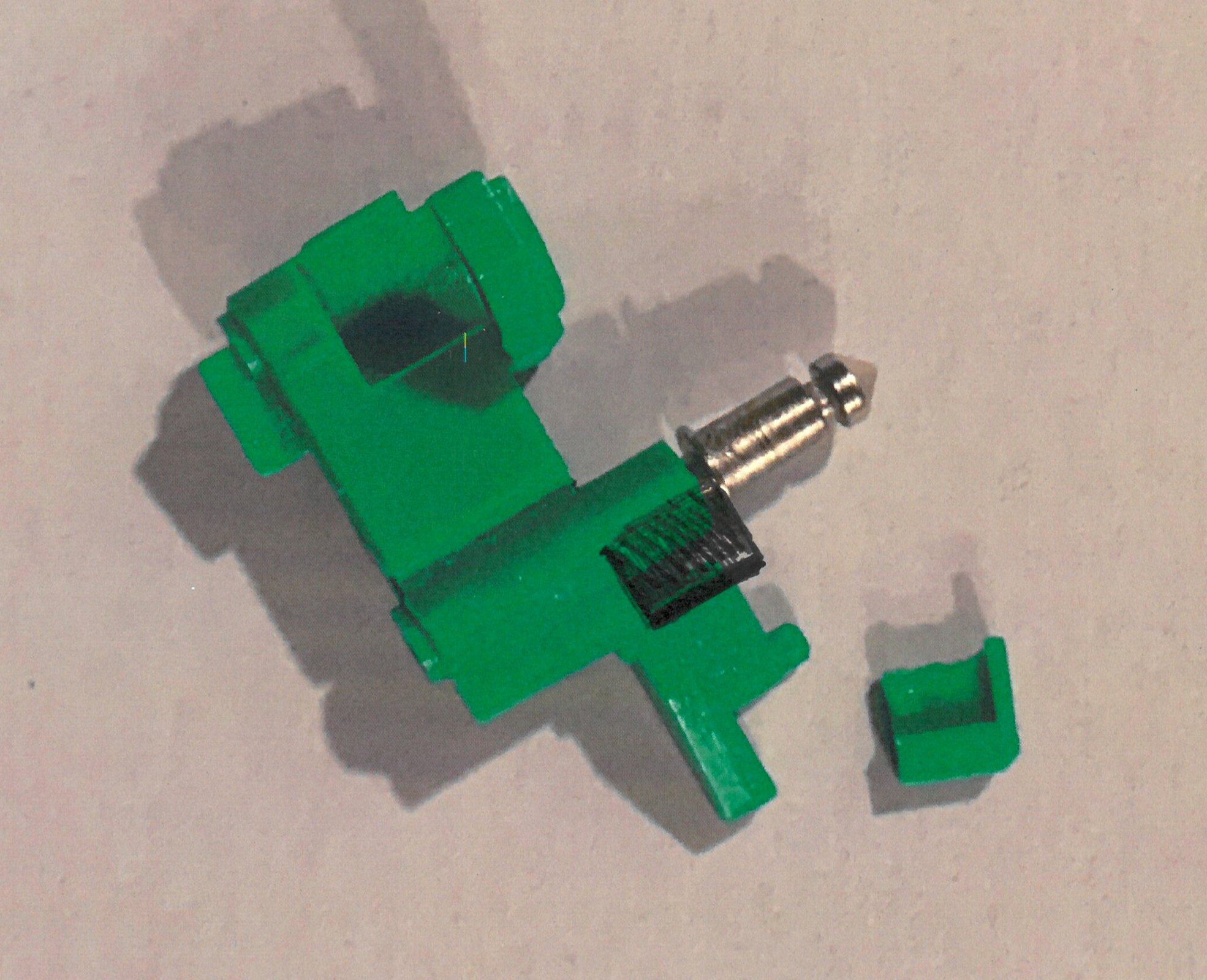

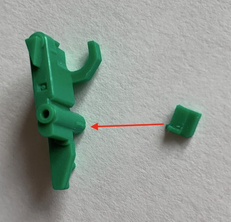

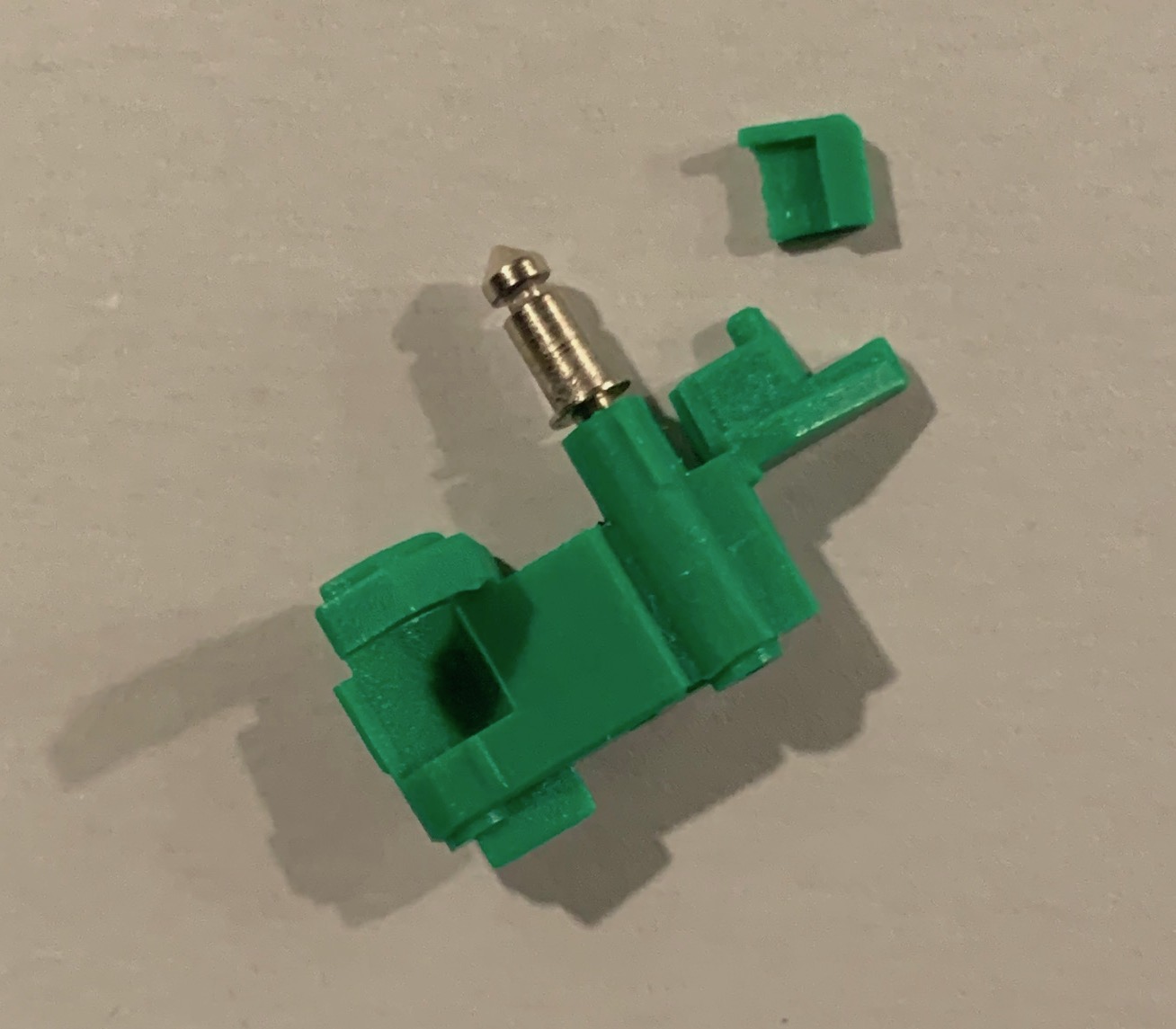

    Hi,

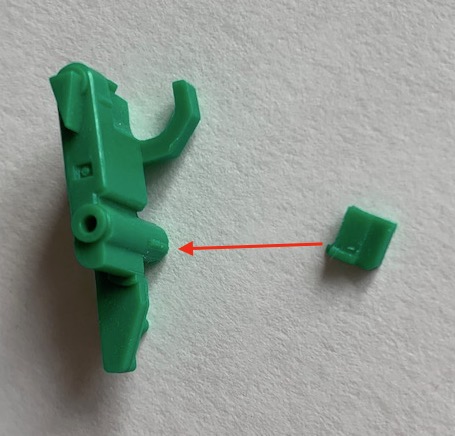

    I have a small collection of WM-33 walkman, of course all with broken CG, which is no longer a problem thanks to Marian's brilliant repair kit.

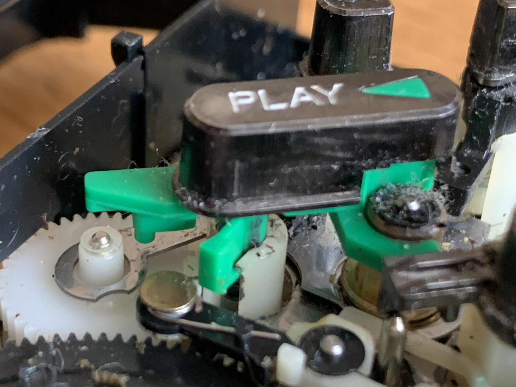

    According to my experience the the play/stop/ff/rev buttons must be removed in order to replace the CG, .
    The play button is very delicate. Unfortunately I already broke off the part (see photo) on two of them.
    This makes the whole walkman unusable.
    I tried different ways to glue the parts together: Formic acid (recommended for PA), superglue etc. unfortunately without success.
    I don't suppose any of you were able to secure a whole box of these buttons when Sony stopped walkman-production
    :nwink:
    but maybe someone has such a part left or an idea how to fix it or even know a workaround to replace the CG without removing the buttons?
    Many thanks,
    Konrad
  2. Longman
    3,678
    When gluing have you tried adding any kind of reinforcement e.g. stiff wire ?
    If the part is big enough to do that it will make the joint much stronger.

    That might be a good idea, thank you.
    The dimension of the broken-off part is only approx. 3.5 x 3.5 mm, the thickness is approx. 1 mm.
    I will get in touch with a watchmaker.
    I wonder if someone tried to fix a "flag" on the metal pin?
    I also wonder if nobody else has problems with this part? As far as I know, only the WM-DD33 has such a construction. All other DD models seem to be much less delicate.

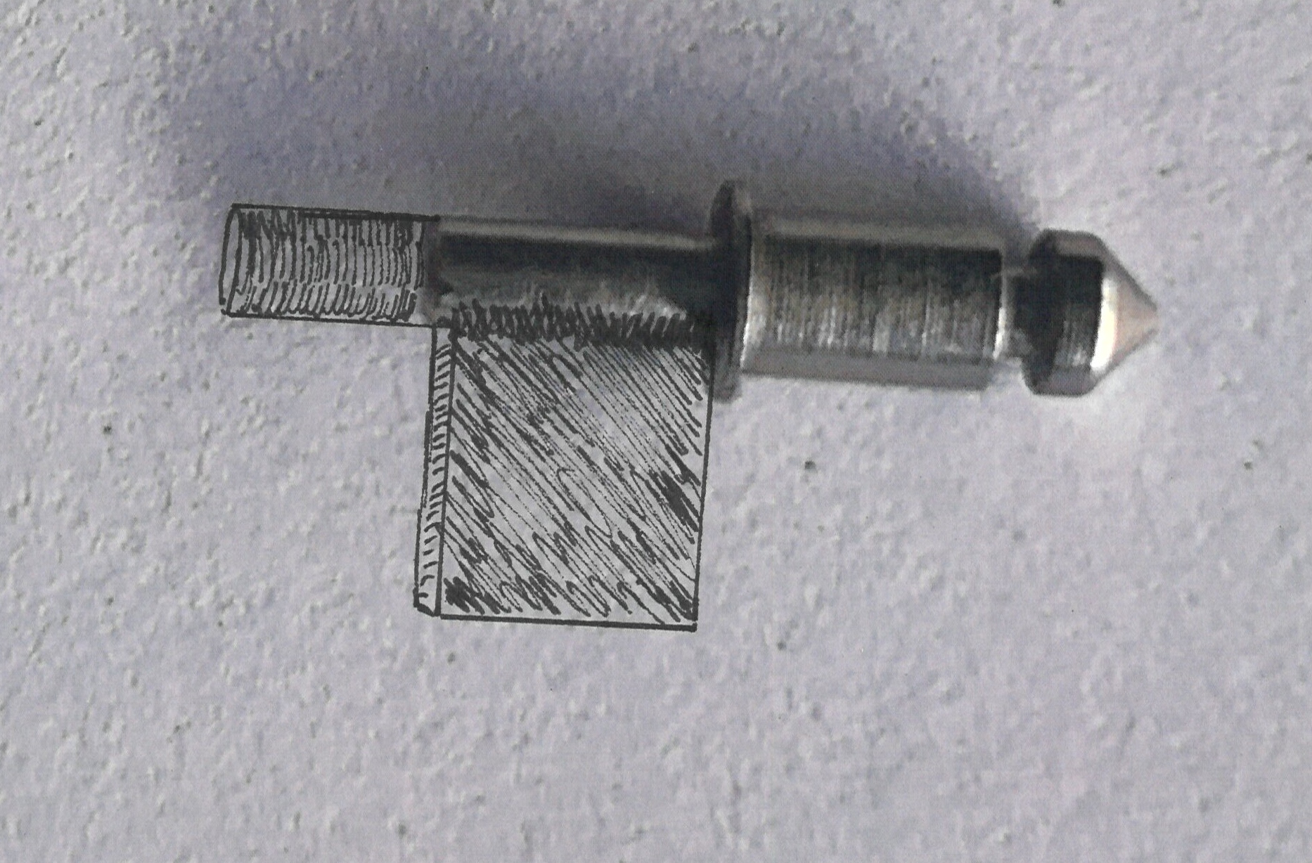

    At the moment I am trying to pursue two solutions:
    1. make a slightly longer metal pin and solder the "flag" to it. I hope that the two pictures show the idea clearly enough.

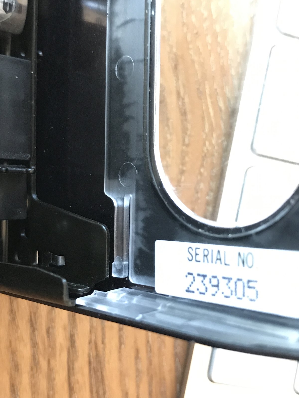

    @Mister X - I'm not at all an expert in plastics. It's just my guess that it's PA - mainly because all conventional gluing methods won't work. Including epoxy, which was not stable enough. I will try the method with the metal rod. The extra epoxy-layer will be hard to apply as there is really not much room (s. photos from an unrestored DD33)

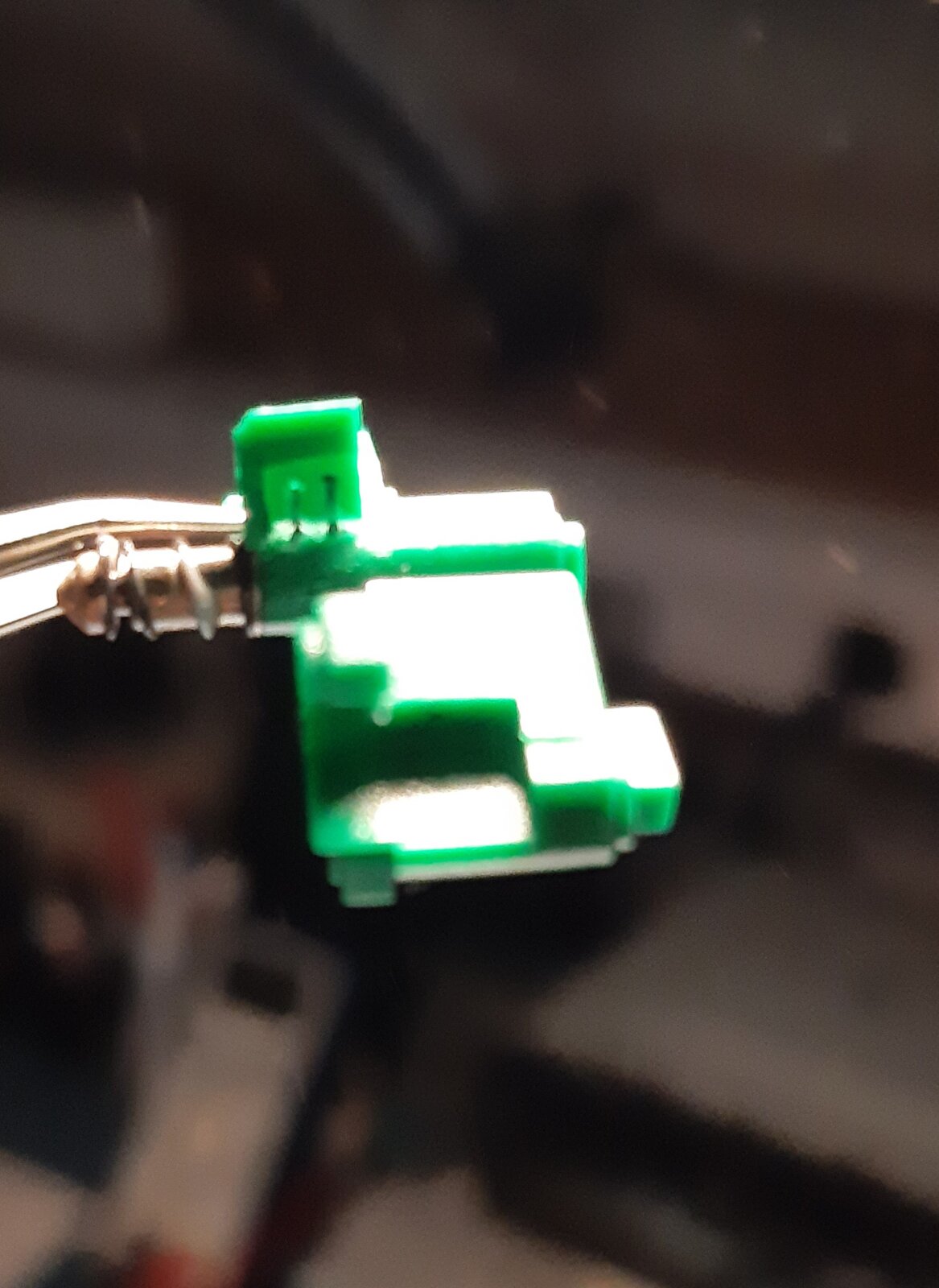

    Same problem here but with the Stop button that has a small pin which i broke. So i'm stuck, unable to reassemble the unit.
    Anybody found a workaround or has a spare stop button which they'd be willing to part with ?
    Thank s in advance.
  18. George
    George New Member
    24
    Serbia
    You can bond it with Loctite G E L super glue.
    You need to wait 12h to cure.
    I have one such part that I played with and after gluing you can only break it in another place.
  19. Analogtape

  20. George
    George New Member
    24
    Serbia
    Like this?
    That transparent space at the bottom is super glue.
    I cut the spring and used its ends to make a reinforcement.
