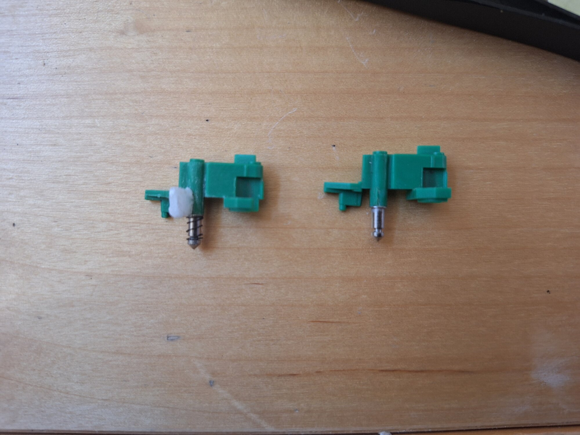

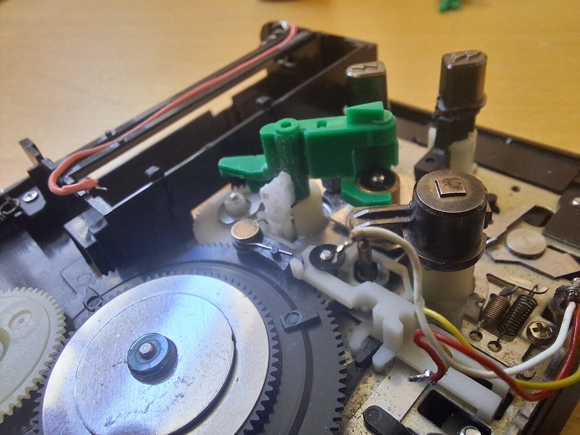

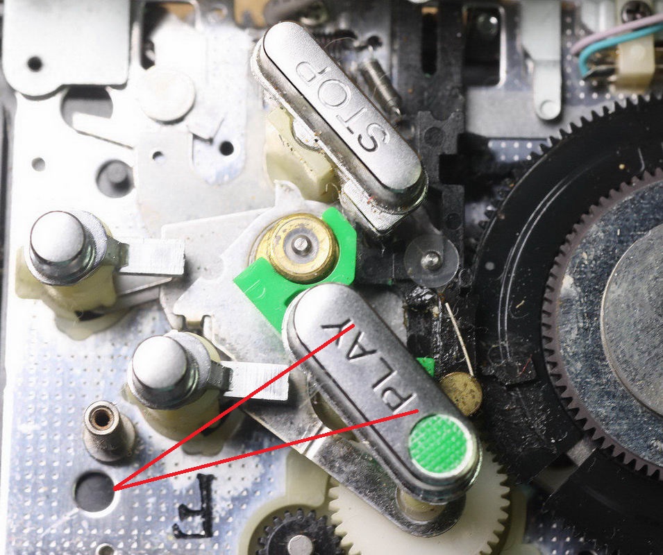

    Want to add something myself. This part is likely breaking due to the fact it was removed incorrectly. Have repaired many DD walkmans and this part never broke.
    How I remove it is with a pair of tweezers as indicated on the picture attached. Put the tweezers underneath and pull up.

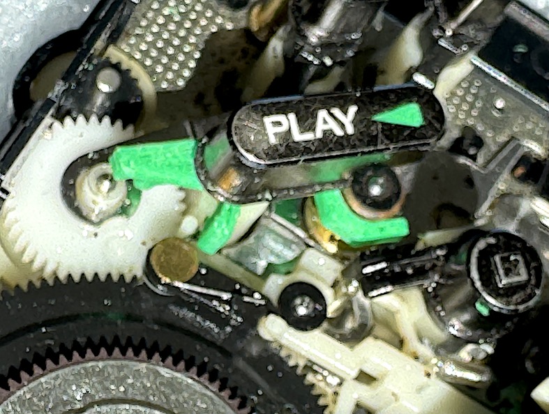

    I tried this @dom69 and. . .it worked! I've never seen a complete play button but I tried "sodacrete" using this thread's images as reference and it worked after a few attempts.
    There are some limitations because this "flag" is more complex than a broken switch. I was not able to make the ridges on the bottom that keep it from coming out when you press stop. And I have yet to make it 1mm thin without it breaking so it doesnt get jammed in the button sleeve.

    In the meantime I found out that the play button can be removed much easier if you press the FF and REW button at the same time :)
    So no more buttons break.

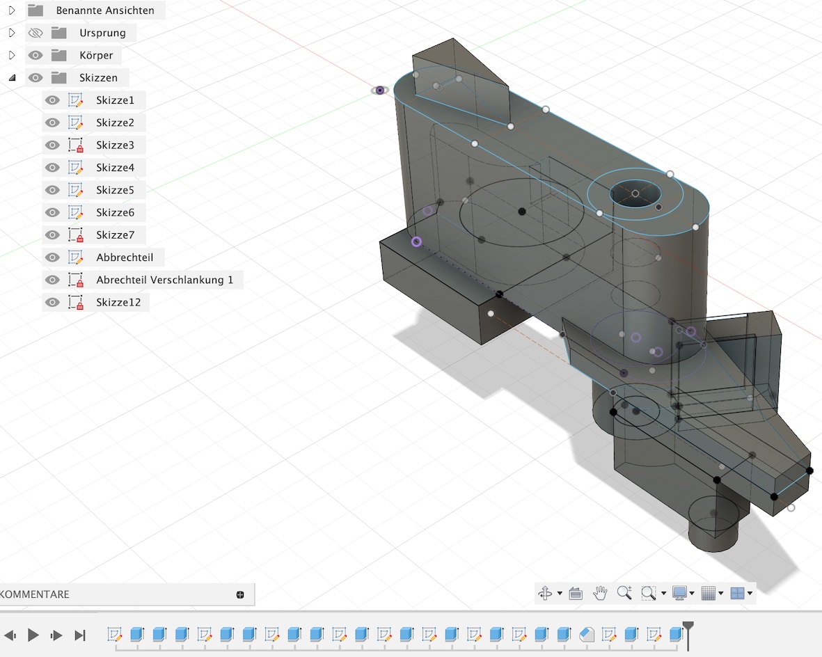

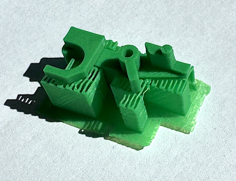

    Nevertheless, by curiosity I did some experiments with my 3D printer. After many attempts, I finally got a play button that works. I guess in terms of accuracy a part like this is the limit of what can be made with an FDM printer.
    It has not exactly the same shape as the original part, but it has all the surfaces needed for it to work. I suspect the original button has certain shapes that came from the limits for an injection molded model.
    Some WM-DD models have a "green dot" instead of an arrow and on some the arrow is in a different position. This can be handled easy in the construction file for the 3D printer.
    If anyone is interested in the .stl or .f3d (Autodesk Fusion) file, just let me know.

    Just tried the print I am super impressed. Works perfectly! Now I have the limited edition dd33 with the black button:boogie:
