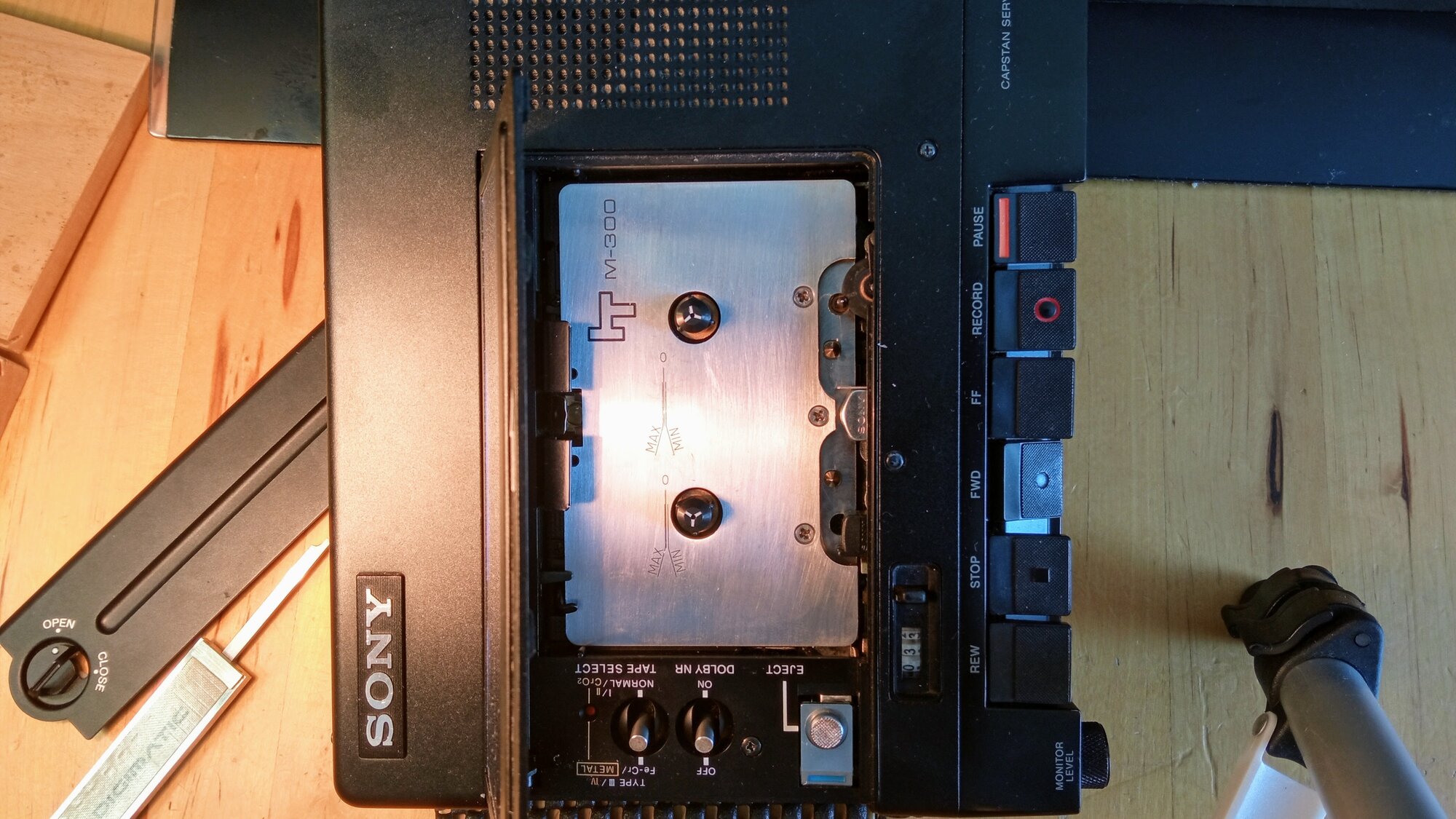

  6. MBentefor
    MBentefor New Member
    Ukraine
    Tonight I will provide some photos with head/rollers/everything in both open/closed and engaged state.

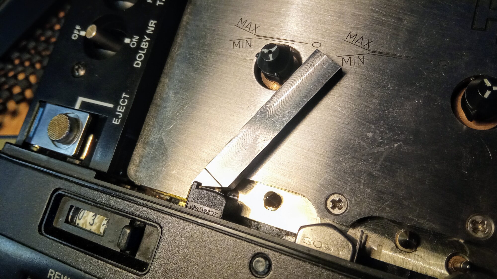

  8. MBentefor
    Ukraine
    Here, check this:
    Seems that when engaging, the head set is not lifted up evenly: back part (closer to the case) is lifted higher than the front part.
    What can be the reason for this? I tried with my nail and there is nothing which would block the head from lifting further.
    I checked thoroughly and can't see any option here...
  9. MBentefor
    Ukraine
    Even though there is nothing to report, I will report anyways:
    I've disassembled the head carriage and found 2 tiny thin rectangular plastic sheets behind the head (between the head and the carriage itself). They look like something off factory, however there is no such thing in the service manual. When I removed them, finally the head and tape guides were inline. However the entire head carriage was still at a serious angle (as seen in the video).
    After thorough inspection, I wasn't able to find anything suspicious. Also I wasn't able to reason what could possibly lead to head being lifted unevenly (in theory eveyrthing should have been working fine...). So I did some bending job. As a result - the head carriage is now completely inline with pinch rollers/capstans and perpendicular to their axis.
    However not a single thing that I've done made any change to the HF loss effect.
    At this moment, if I gently lift the front (outward facing) part of the head just a tiny bit, the HF are back.
    However if I do that gentle lifting, the opposite playing direction starts losing HF a bit...
    Also I wasn't able to make up any option on how to preserve that gentle lift.
    Right now all of this makes little sense to me.
    Maybe my 1989 copy is somehow faulty... Maybe it lacks something...
    Sad :(
