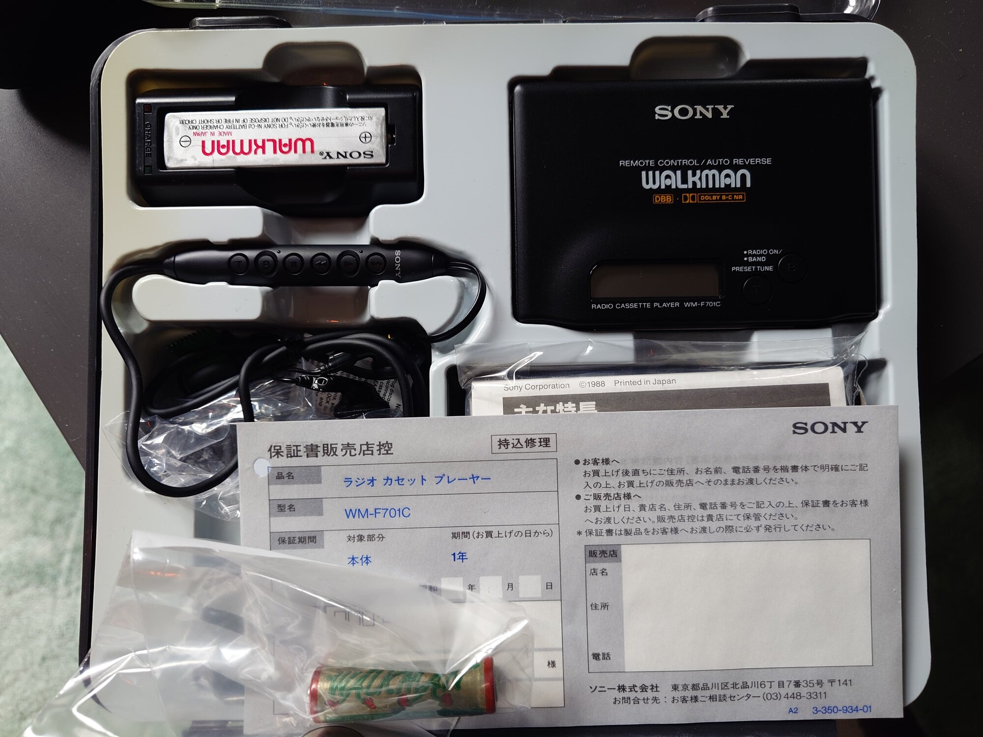

    I just picked up a completely BNIB Sony WM-F701C with all accessories which has never been used.
    WhatsApp Image 2024-04-21 at 11.07.18_e169afa0.jpg WhatsApp Image 2024-04-21 at 11.07.18_c28314e4.jpg
    After opening it up, the belt is completely gone (as expected). It otherwise seems totally flawless, no leakage, bad looking caps etc. Obviously might change when I actually get it working but for now it truly looks like it was manufactured yesterday not in 1988.

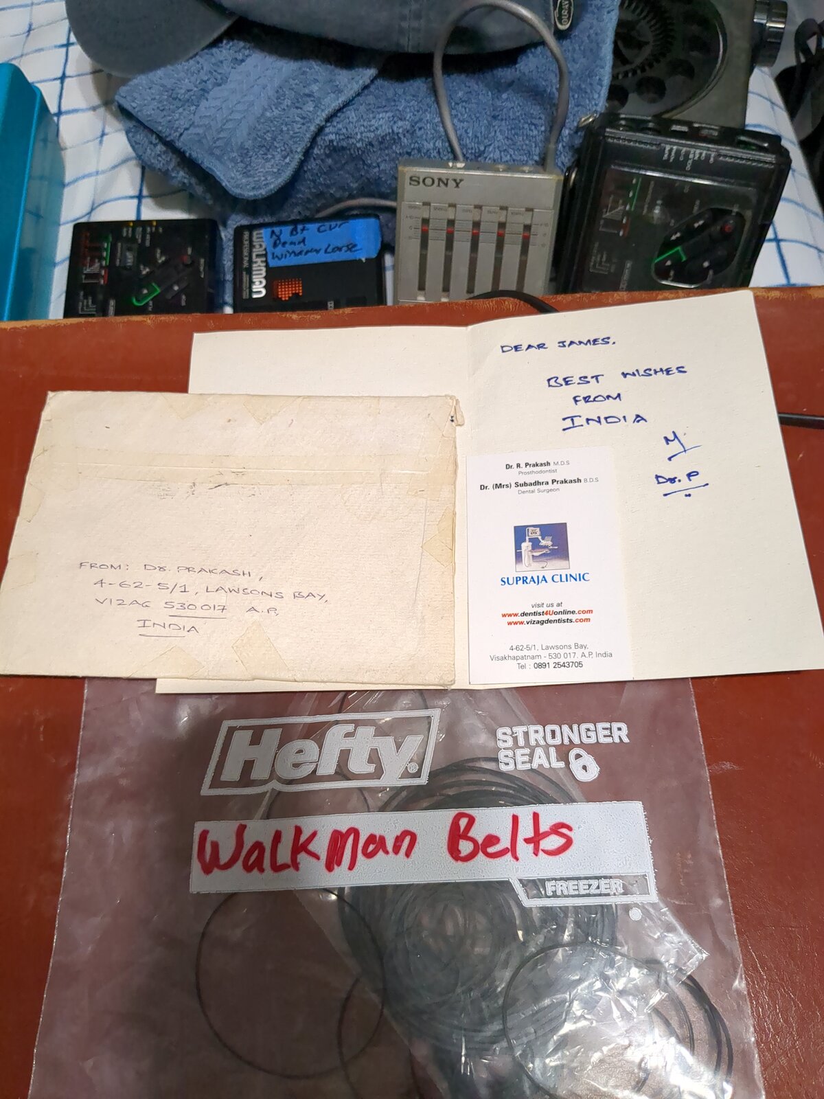

  6. Matias
    Matias New Member
    Argentina
    Valentin and Emiel like this.
  7. givemeyourwalkmans
    givemeyourwalkmans Member
    96
    Thanks for sharing your belts! I think you would have much better luck selling these if you put the item names and their descriptions in English :)
    Emiel and Valentin like this.
  8. Matias
    Matias New Member
    Argentina
    Hi, I still donĀ“t have ads on ebay..only selling in Argentina since 2019 through mercadolibre platform and directly.
  9. Valentin
    1,340
    @Matias I suggest creating a separate thread on the forum regarding your belts. This way more people will know about it.
    Mister X and givemeyourwalkmans like this.
    14,265
    Everyone wants and needs belts, I think DocP is still around here also selling belts out of India.
    Matias, you have some very nice equipment on Instagram, you should post some of your equipment on here.
    Valentin likes this.
