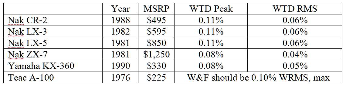

    here is a table for the decks I had over the last 5-7 years:
    Any idea where 0.10% for TEAC should be placed? I copied the exact W&F sentence from its Service Manual, the last word 'max' confuses me because it might mean Peak. Considering the age/price/build quality, it should be WTD RMS.

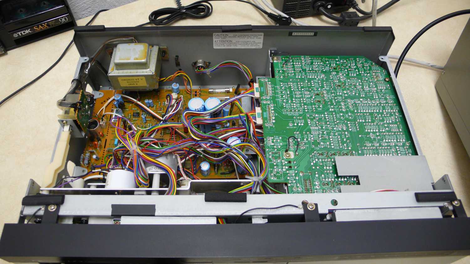

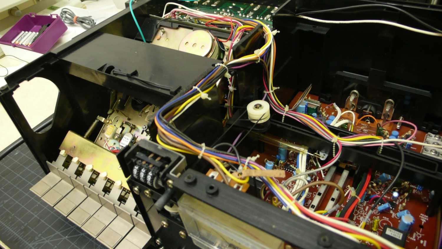

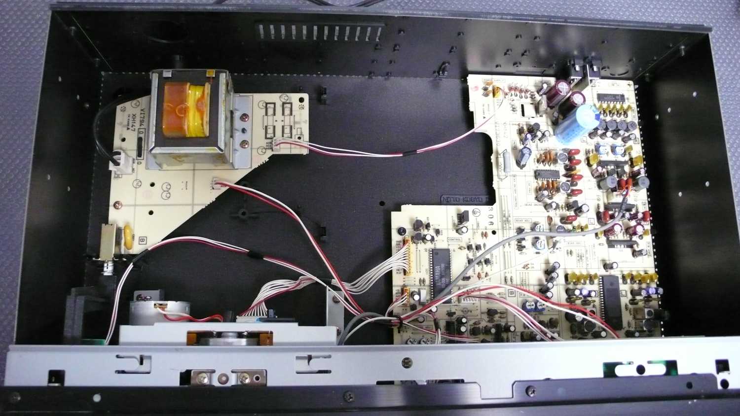

    Unfortunately, I did not take a single photo of my CR-2 rebuild, only my struggles with its Sankyo mechanism. But it is interesting to see the 'evolution' from A-100 to LX-3/5 and then back to KX-360:
    Boodokhan and Valentin like this.

    In my opinion, given they state it's WRMS, that's the maximum accepted figure for wow&flutter, but in general they expect lower than that. I think of it similar to a parameter in a component datasheet, with MIN, TYPICAL and MAX columns.
    Here, they give the maximum, but the typical value that's expected for most units is likely in the 0.06% WRMS area.
    Emiel likes this.
