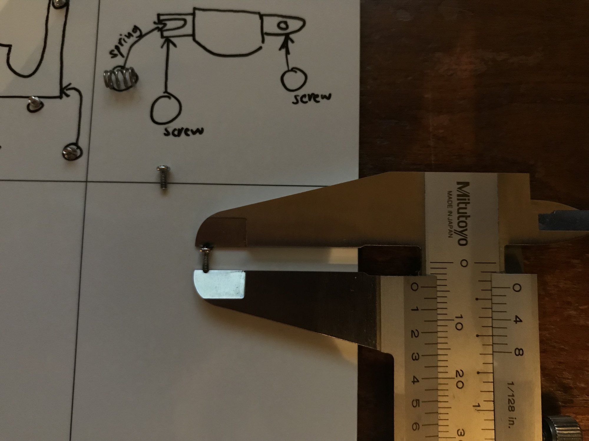

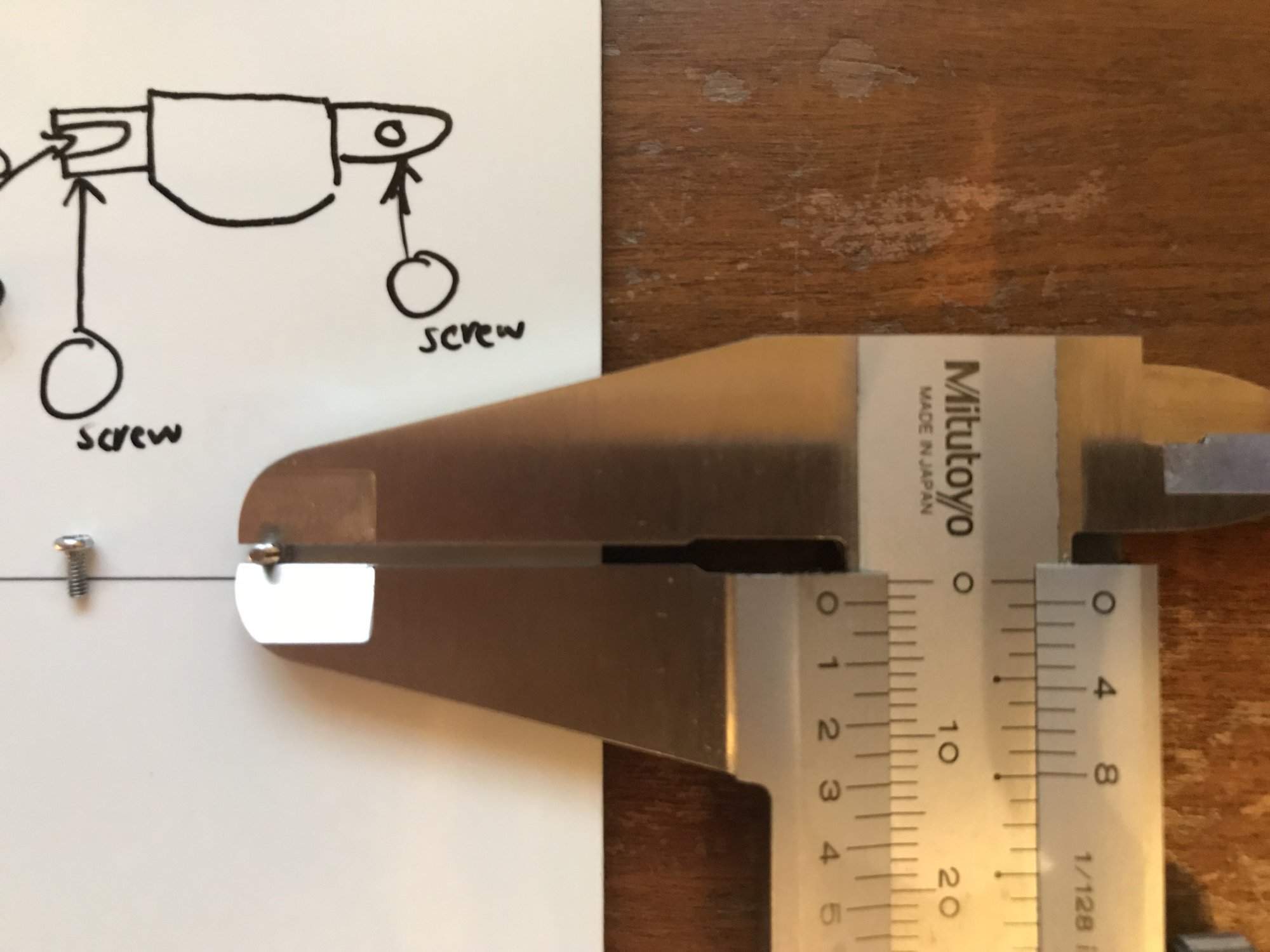

    Your belt orientation seems to be correct. Mine was incorrect. Also, here are some photos of the measurements of the screw for the tape head. It appears to be identical to the other screw for the tape head but hear are the measurements provided in the photos:
    Length:
    Threaded part diameter:
    Head diameter:
    I am almost certain both screws are the same, here they are side by side:

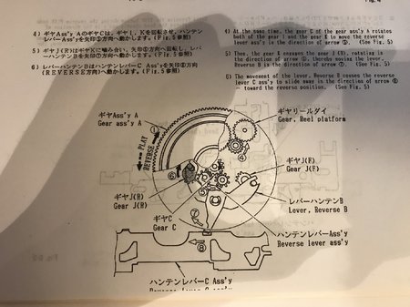

    So this is the mechanism that is broken somehow,
    (along with something else probably)
    those are the twin gears/cog wheels you see on the drawing,
    that should change the direction and move
    the left pinch roller forward and the right pinch roller backward,
    when the auto reverse modes kick in.

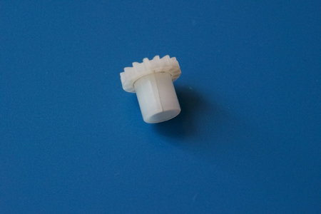

    Okay, finally got around to fixing the auto-reverse problem. The issue is a nylon gear that cracks presumably due to age and/or wear and tear. Here is a link to the video I made which shows how to disassemble the AIWA cassette player and repair the gear.
    I recommend that you watch the video in its entirety prior to attempting the repair. Also here is a close-up picture of the cracked gear for your reference:
    Let me know if you have any questions and good luck with the repair!

    Yes, all the screws are metal. When disassembling I didn't notice any thread locker on the screws, but adding a little probably wouldn't hurt. I haven't had any screw fall out during normal use (finger crossed).
    I would advise against drilling the gear to increase the diameter of the hole. The auto reverse seems to rely on friction with the other larger nylon gear in order to trigger the auto reverse. I was actually tempted to glue the 2 gears together since I don't see a reason why they shouldn't be, but I opted not to since it wouldn't be reversible.

    I had the same issue witm my hs-j09.
    The problem was that cracked plastic wheel.
    It did slide, so it did not swap the capstains and probably also did not switch the channels.
    Anyway. The solution was to get a plastic hs-j36, having the same reverse mechanism.
    Luckily, the j36 had the wheel in perfect condition.
    The work is definitely not simple, requires few hours and patience. Good luck!
