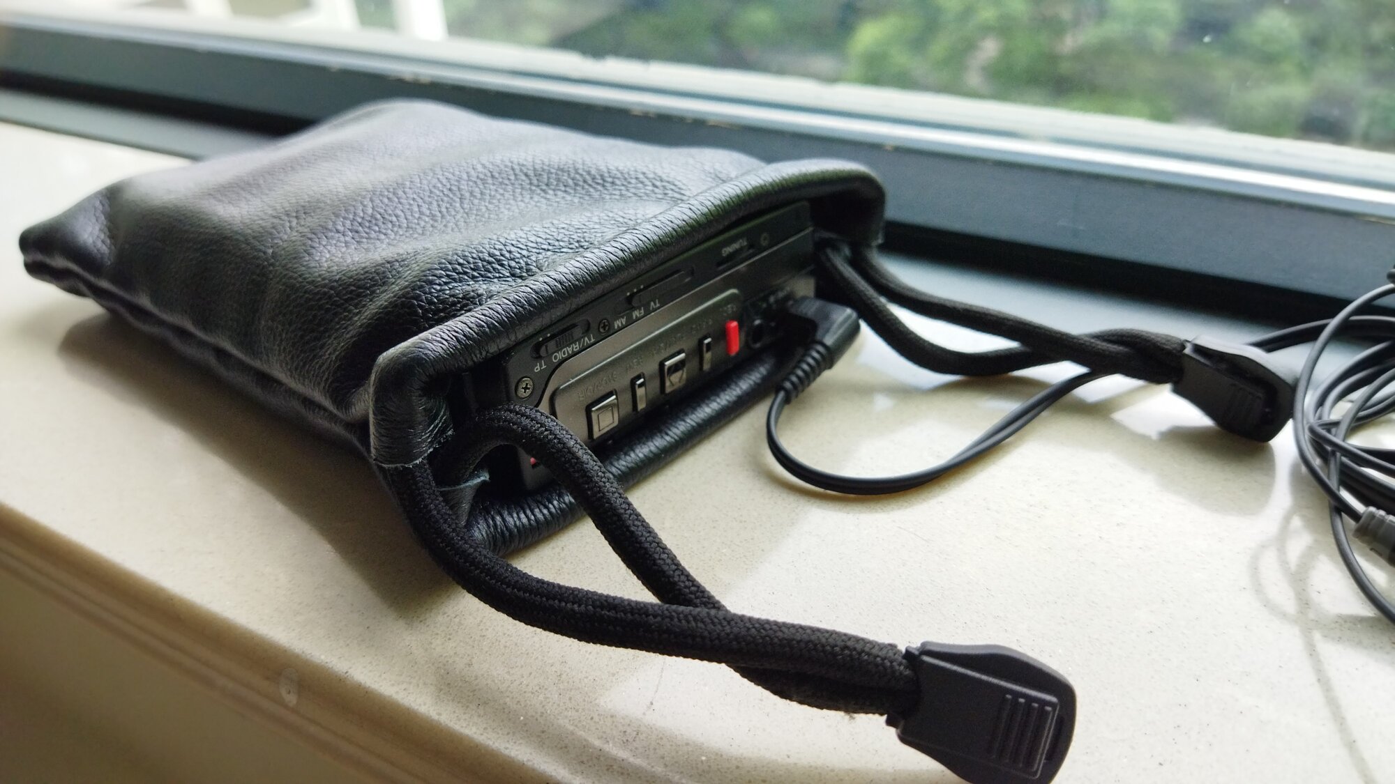

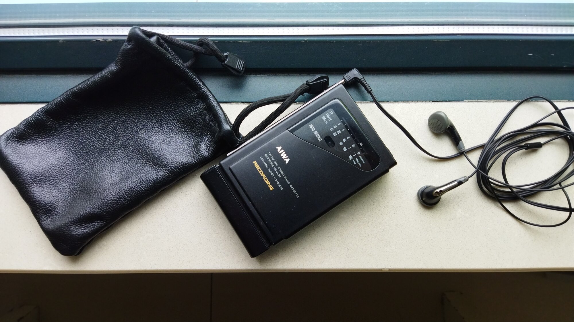

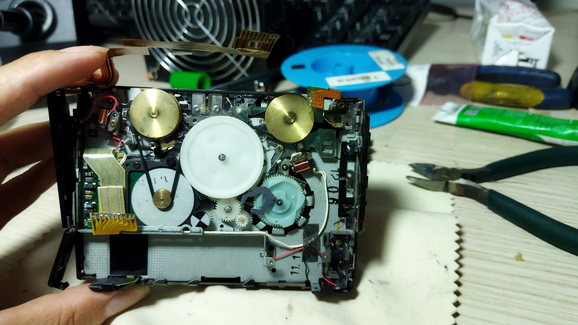

    Attached some AIWA JL30 some pictures , I have made a leather sheath by myself。

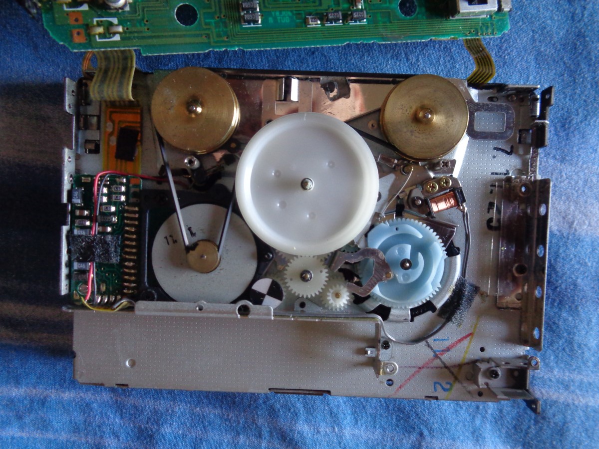

    I would say they have the same mechanics looking at your photo

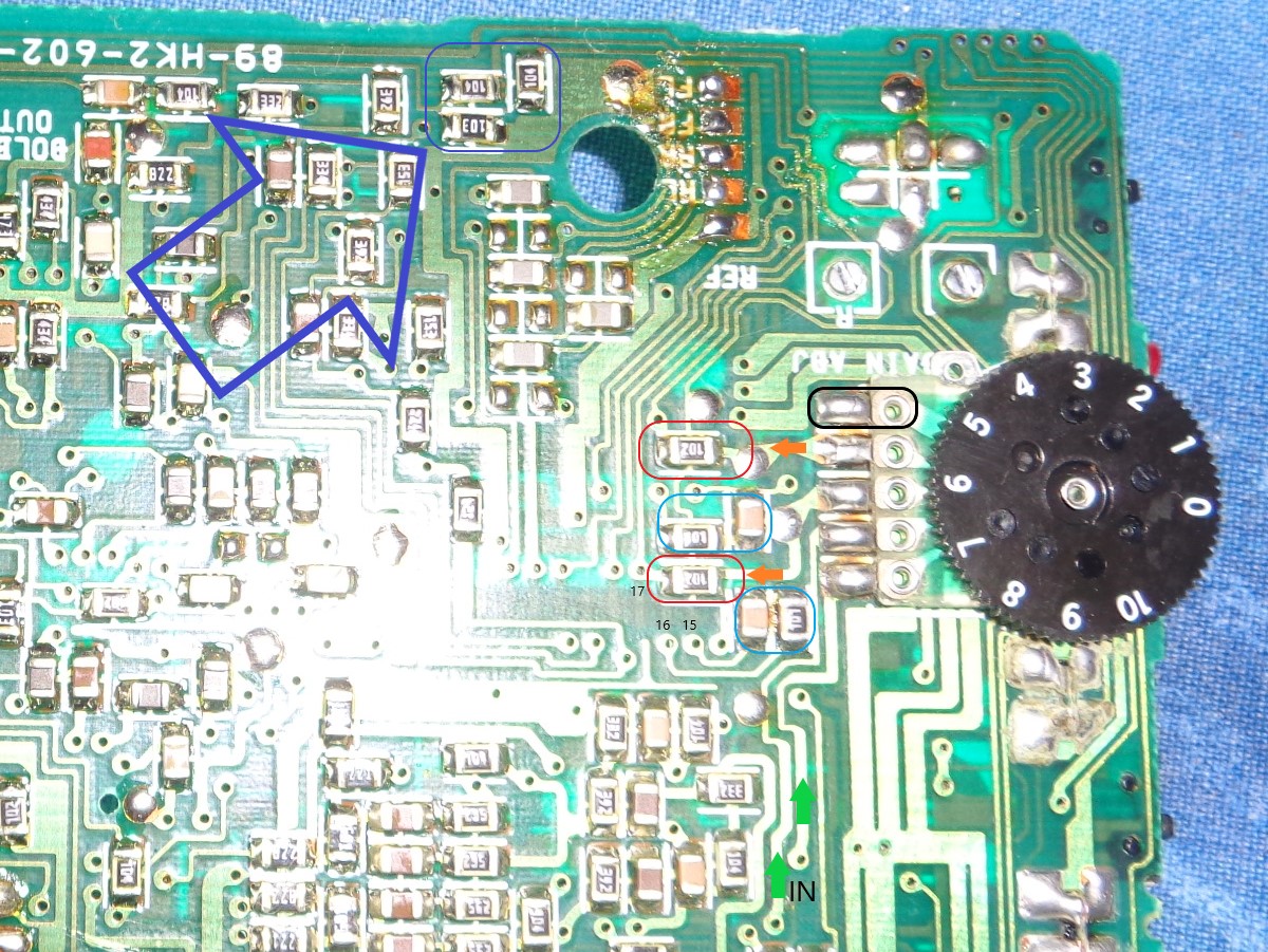

    thanks for sharing your repairing experience. I recently got an AIWA HS-PL50 too. After replacing all the capacitors and thoroughly clean up the main board, the mechanism works but the volume adjustment is not working. Earphone will be at maximum volume after plug-in. I may need some help if anyone could. I have two questions: 1. where can I find service manual for PL50? If it is free download, will someone share a link? 2. I replace the volume VR, it still output maximum volume. Any idea where I should check? thank you in advance for all the aiwa headphone stereo lovers.

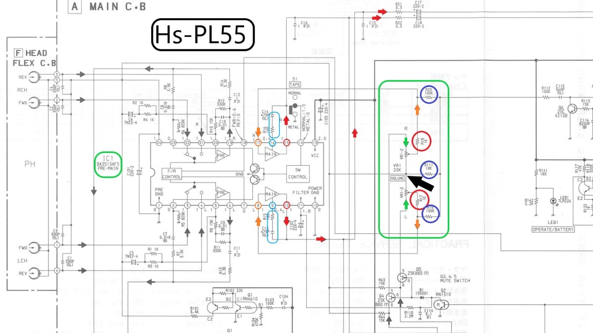

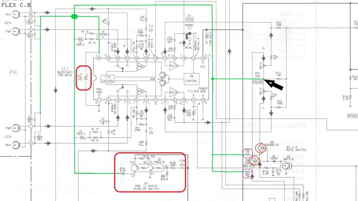

    Hello and welcome .
    I'm sorry I don't have the service manual of this Walkman and I don't know where to find it ... I looked for a while but then I resigned ... but thanks to other schemes I would say similar can make a diagnosis.
    Of the HS-PL 55 scheme you can see that it uses the same CIP BA3513A and thanks to the photos taken when I repaired mine, I say and the same scheme .. from your description Check if it continues from the 10k resistance to the potentiometer pole indicated by the black arrow

    These are very helpful information. Thank you! Yes, PL50 has exactly same design on those areas. I also have another heavily damaged PL50 board as a reference. Now the supposed-to-be-fixed board got different readings from the meter. The three deep blue resistors when soldering on the board (without VR soldered) got all wrong readings. R19 and R20 came back 29-30K (supposed to be 100k) ohm. R11 came back with 8.7k (supposed to be 10k) ohm on the meter. But when I took them out, the readings are fine. the reference board has all the correct readings (even it is dirty and has partially damaged traces) Do you have an idea what has cause the wrong readings (when they are soldered on the circuit board.)? I tried to check all the traces/through holes and cleaned up, the reading are still incorrect. It is so odd.

    Hi Silver965, will you be able to share the service manual of PL55? if not I can understand so no worries. The diagram of PL55 just may be able to help me to figure the resistor issues. Do you think maybe I got a bad electrical capacitor among them? When I connect the PL50 to my computer speaker, I can still hear the volume go louder if I adjust the volume knob, but only slightly higher (cause it was already so loud.) Maybe one of the transistors got bad?

    HI
    I am attaching the manual below...a few posts ago you will also find the px50 manual..the difference between the two is that one uses DSL and the other uses BBE...they share the same cips as the pl50 which is a mix of the two
    Returning to the circuit where I indicate with the black arrow it should be a ground or gnd... but in this case it is not... pin 24 of the BA3513 cip is connected to the volume control and also to other... I think this be the problem ..follow the trail ...some components are in the picture I can't find any others from the photos I have

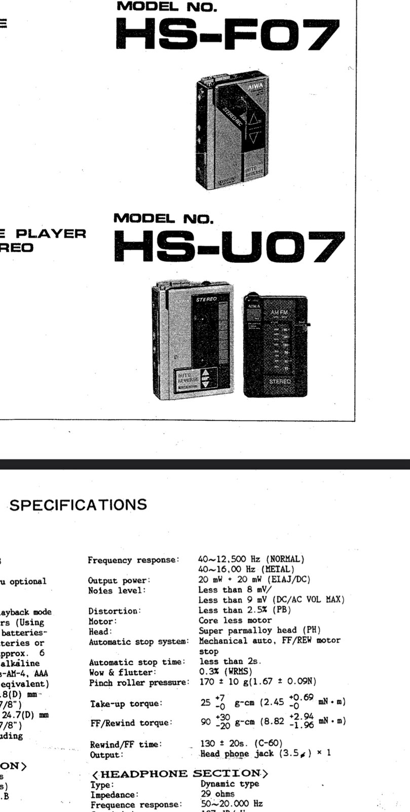

    Nice to see W&F specified, although at 0,45% on the high side. Most of these overperformed it seems, so that is a good thing. The frequency response surprises me a bit, 8Khz at the top of the range?

    Hi Silver 965, I cannot find the trace on the two red circles (RN4610) indicated above but all other green traces are connected (grounded). Will you elaborate more? thank you.

    Problem solved. It was a GND issue. Thank you for all the helps! Really helpful on the diagram and indicators @ Silver 965. This player has an unique DSL signature sound other than PX505 or PL30/35. the only minor issue is the mute switch, when rewind or fast forward the volume still a bit loud comparing with other Aiwa players I have. after clean up the symptom remains. Since I have a few aiwa having the same issue. I believe the mosfets got damaged because the heat of soldering? Can I use 2SK880-Y(XY instead of XG) to replace it?

    Well it was as I thought.. that point indicated with the black arrow on the PL50 and ground gnd
    for the Mute.. change one and try to listen if it goes...
    the Mute command starts from the cip 9311 from pin 14 try to see if there is continuity near the mosfets

  19. Emiel
    1,113
    See this screenshot of the HS-F07/P07/U07 service manual.
    Lower W&F and better frequency response.
