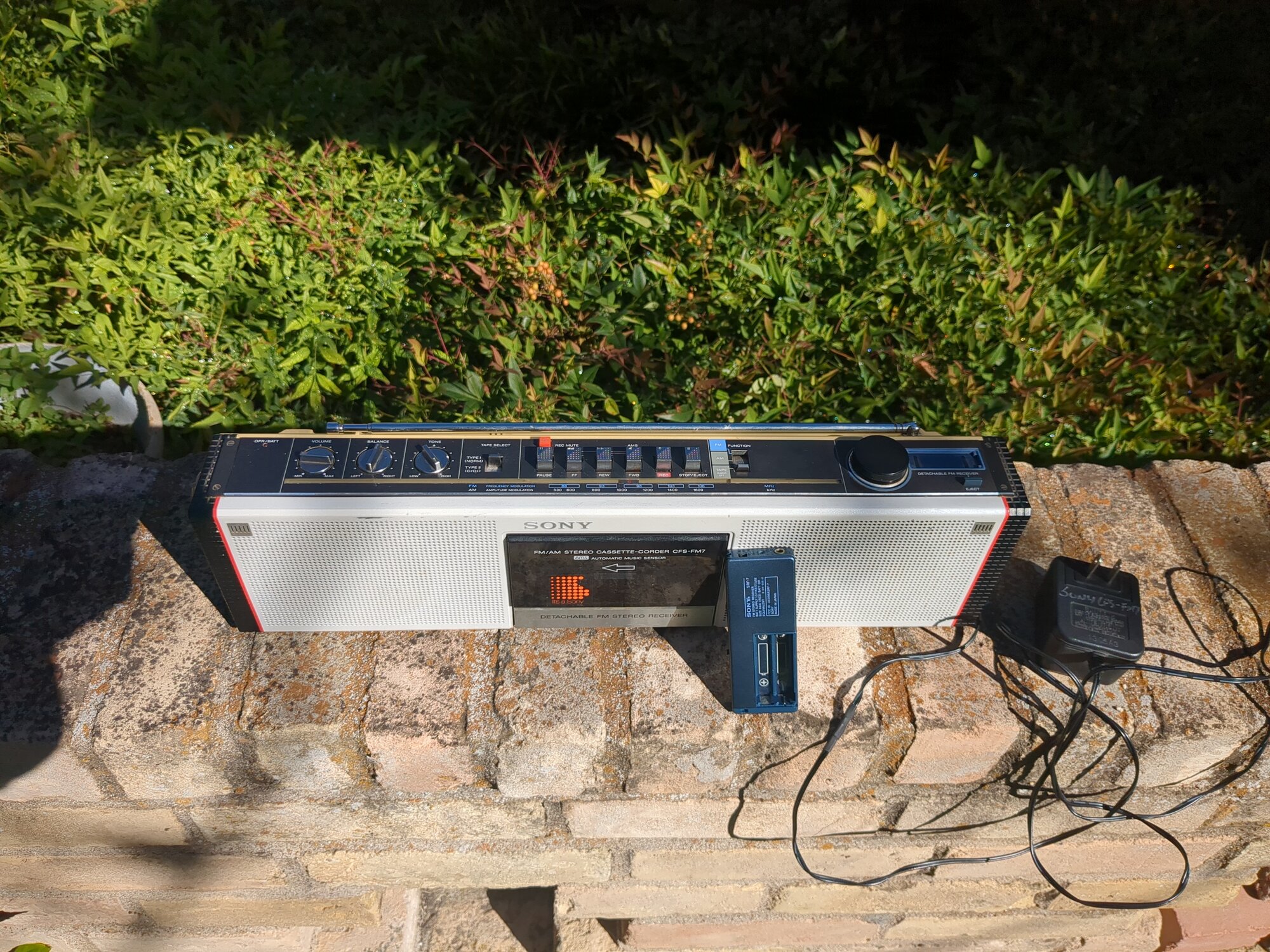

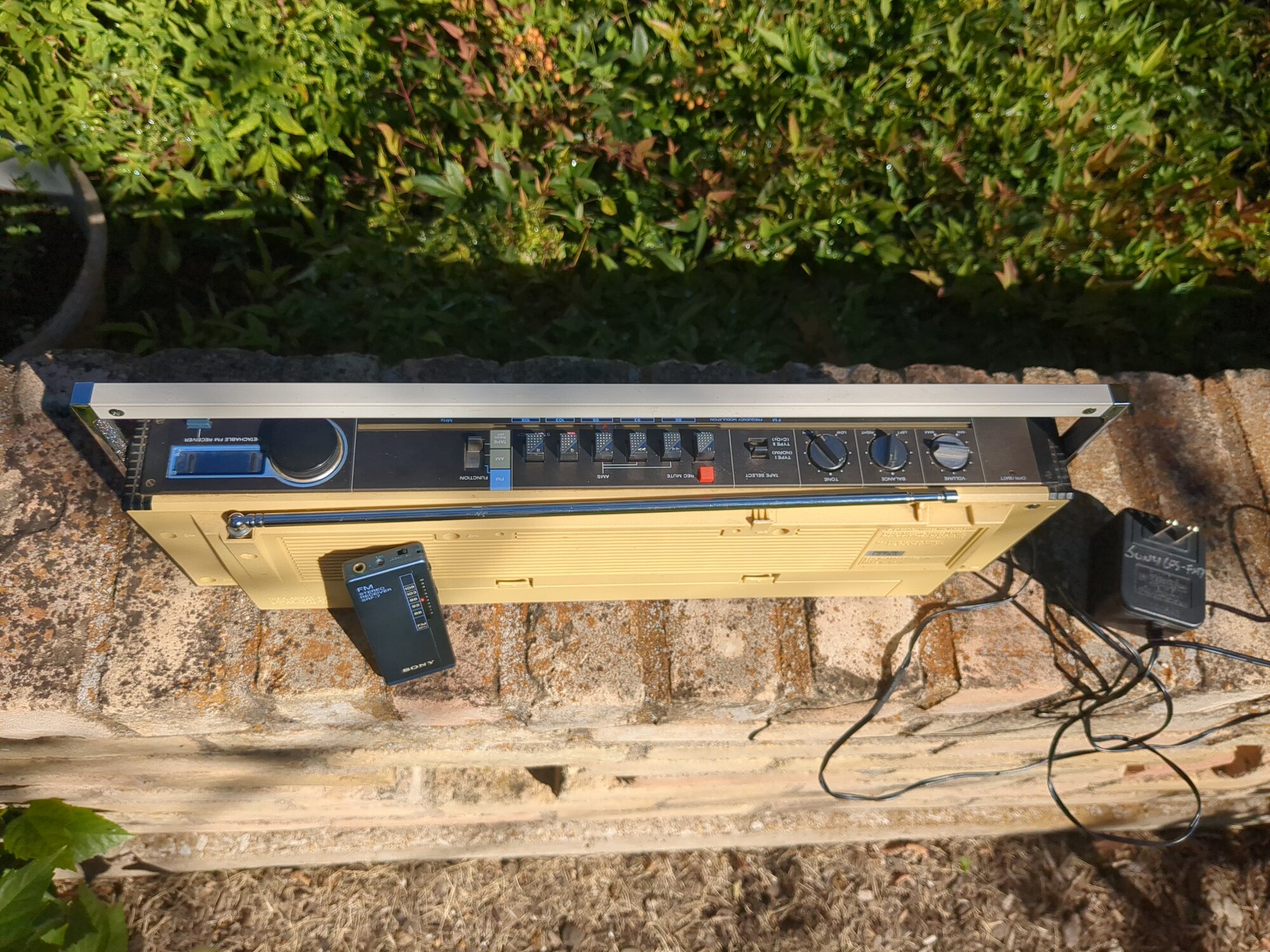

    Sony CFS-FM7 will work without the fm module. Without the Blue fm inserted you still have AM and the cassette deck giving sound from the main unit.

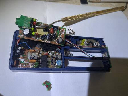

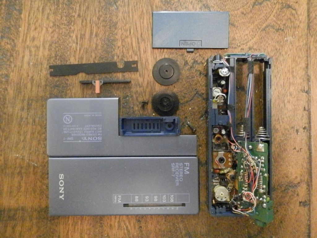

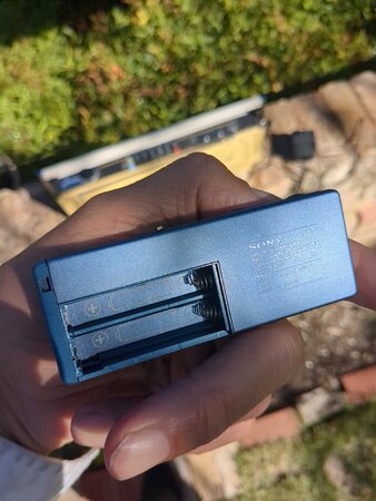

    That Sony CFS-FM7 is so stylish, i do have the FM transmitter SRF-7 but not the boombox. Came across it when emptying out a drawer, not working unfortunately only static. But there is a bunch of caps in there that probably need changing. The SRF-7 has a metal body btw and is easy to take apart although it doesn't look that way.

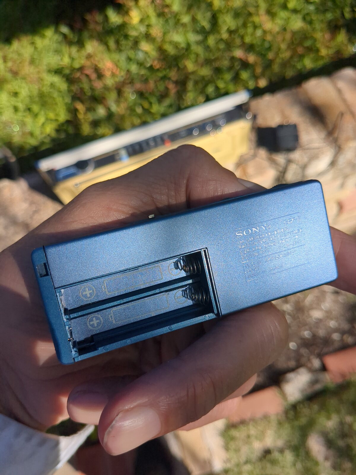

  10. Cassette2go
    1,615
    Mine is dead. Will you send me yours ?
    decentman4you2007@gmail.com email me

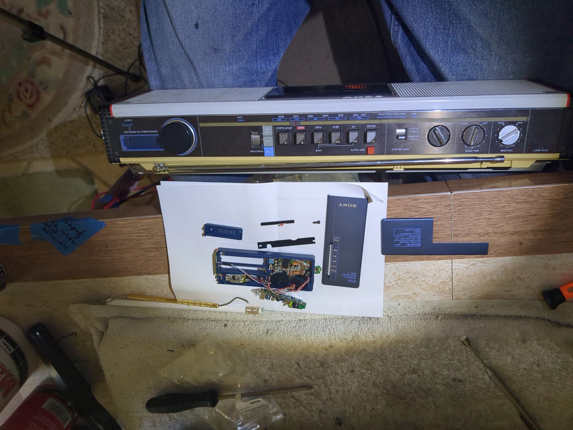

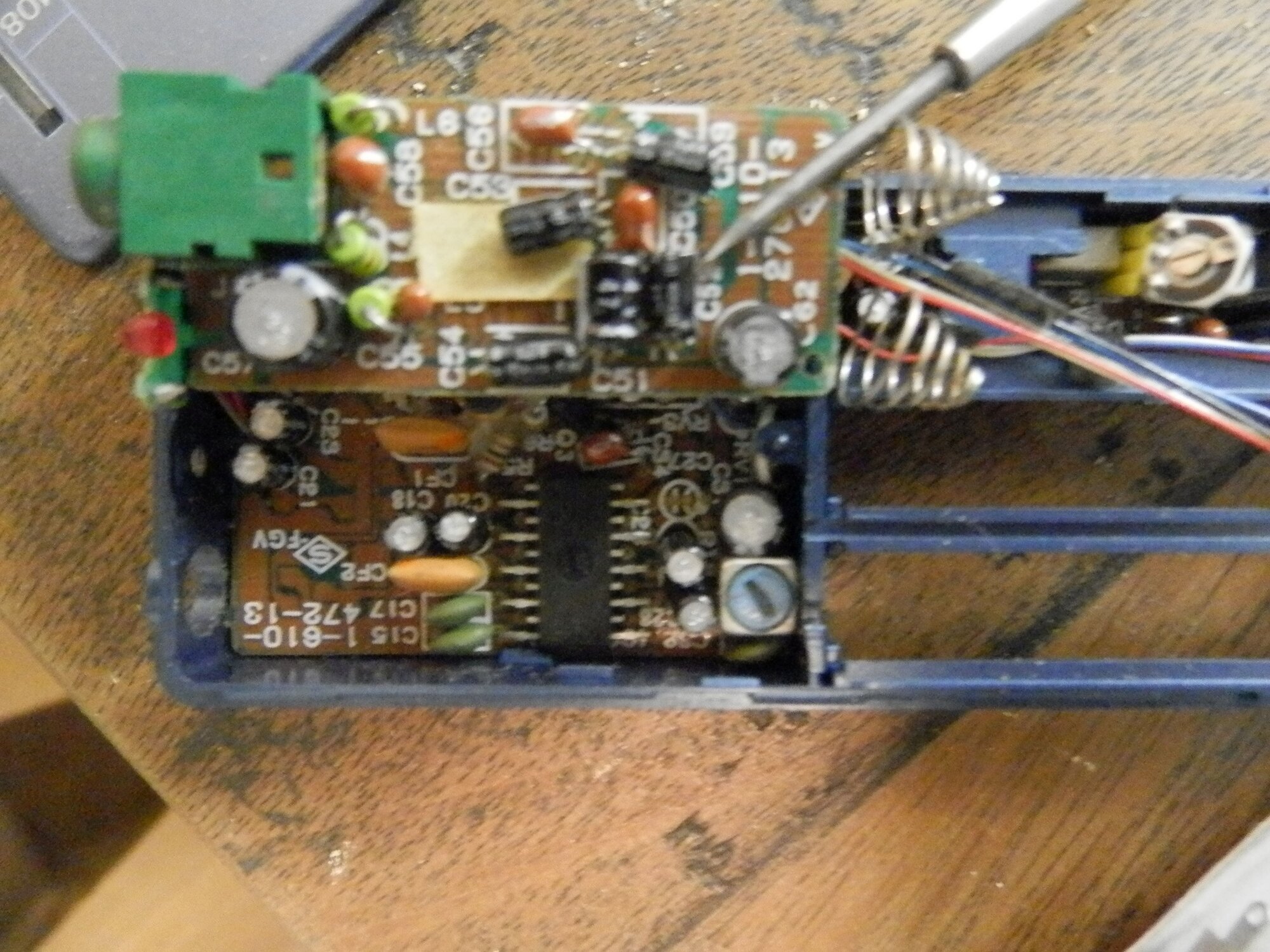

    My FM radio just doesn't work. Everything else is perfect otherwise.

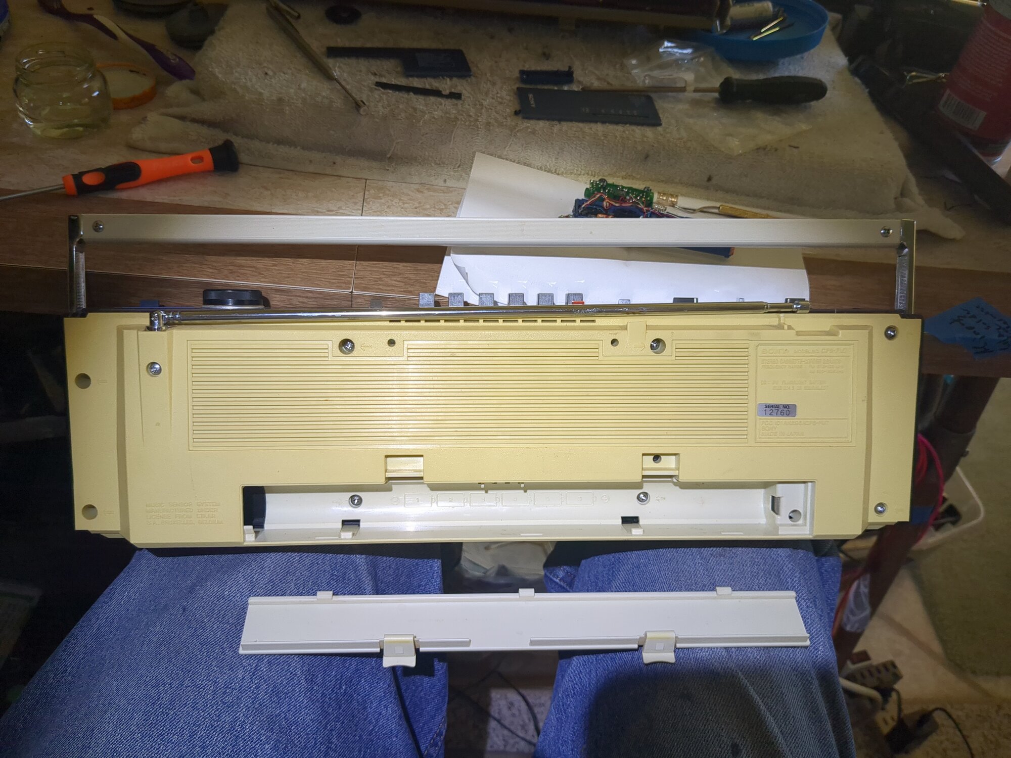

    Backside
    Ps just how does this come apart because I took the little screw out the bottom and nothing else would come apart without hurting it?
    Black Fingers likes this.

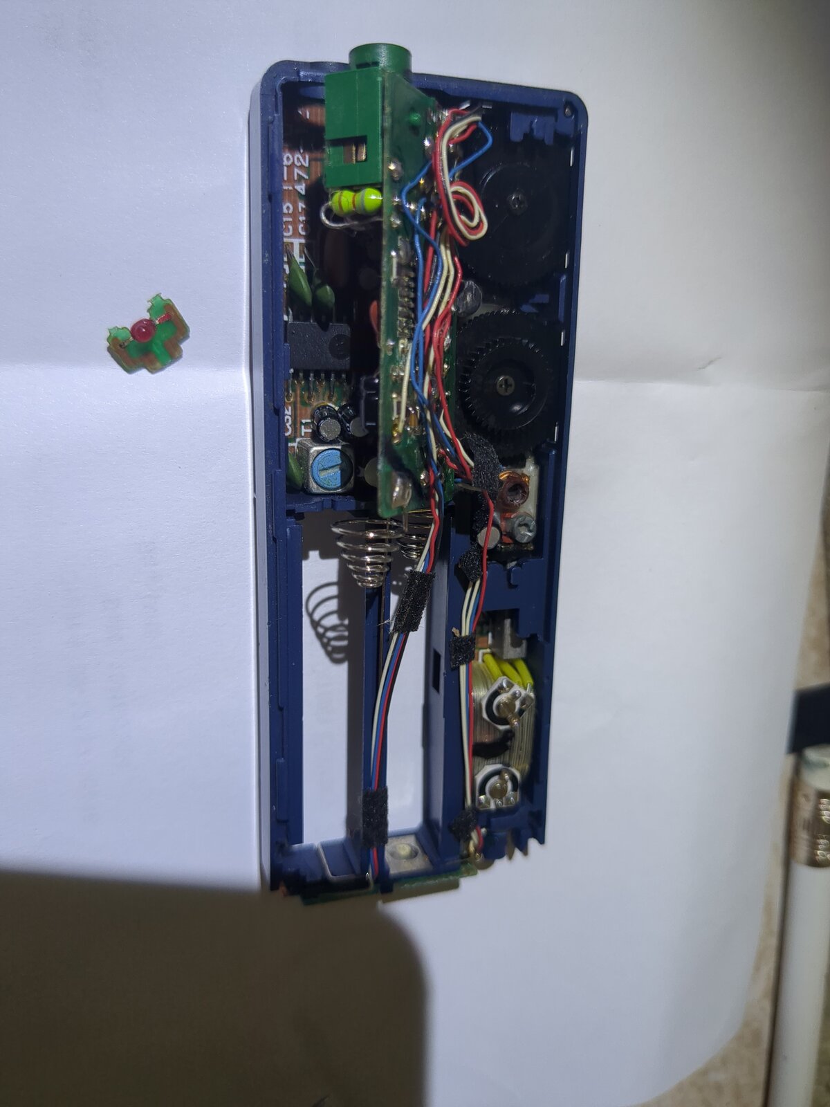

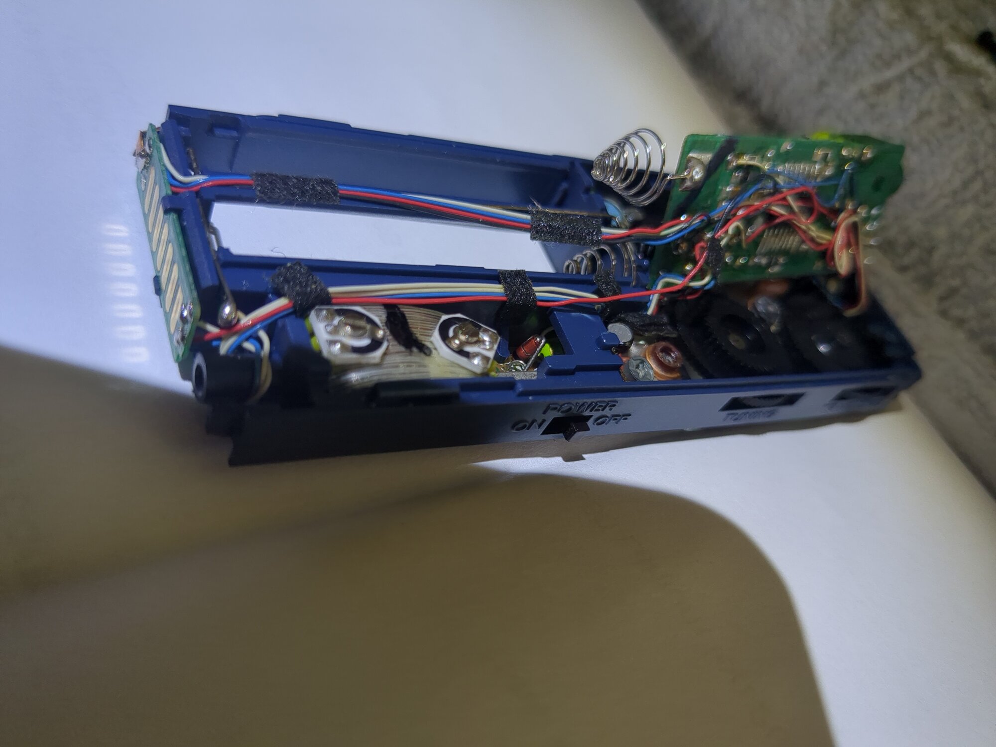

    @Cassette2go
    Mine is dead also....

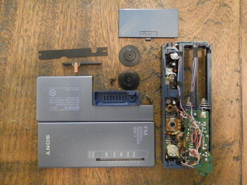

    Taking apart is easy, take out the only screw on outside, now carefully take off bottom end, you will see the holding clip inside the battery compartiment, now it will click free, then slide off the metal body part on the battery side, same goes for scale side, it just slides off. That bottom part holds the two metal body parts in place, as soon as you remove it the body comes free....
    btw if you have open it up could you tale a pic from the inside?, i have a loose red wire, cant say where it should go....

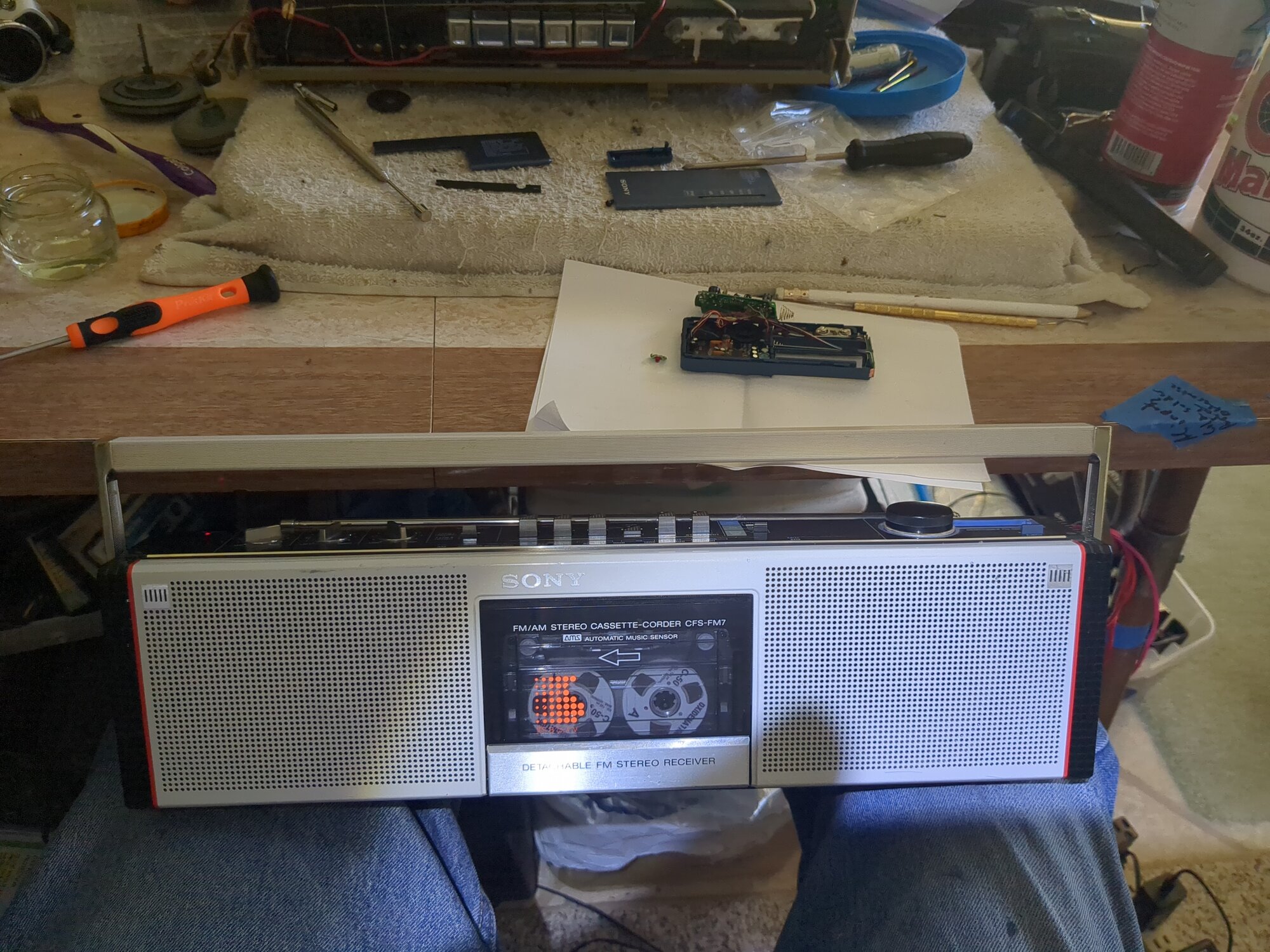

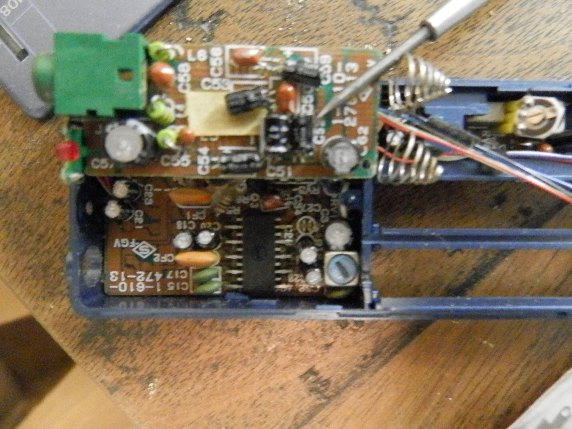

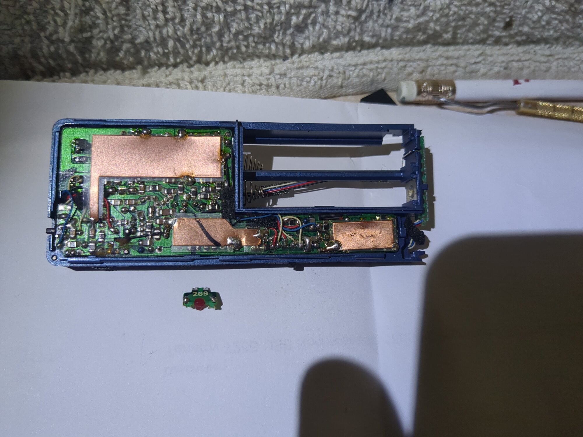

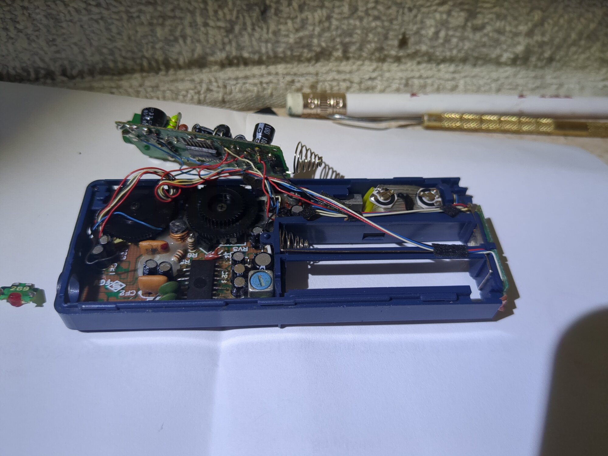

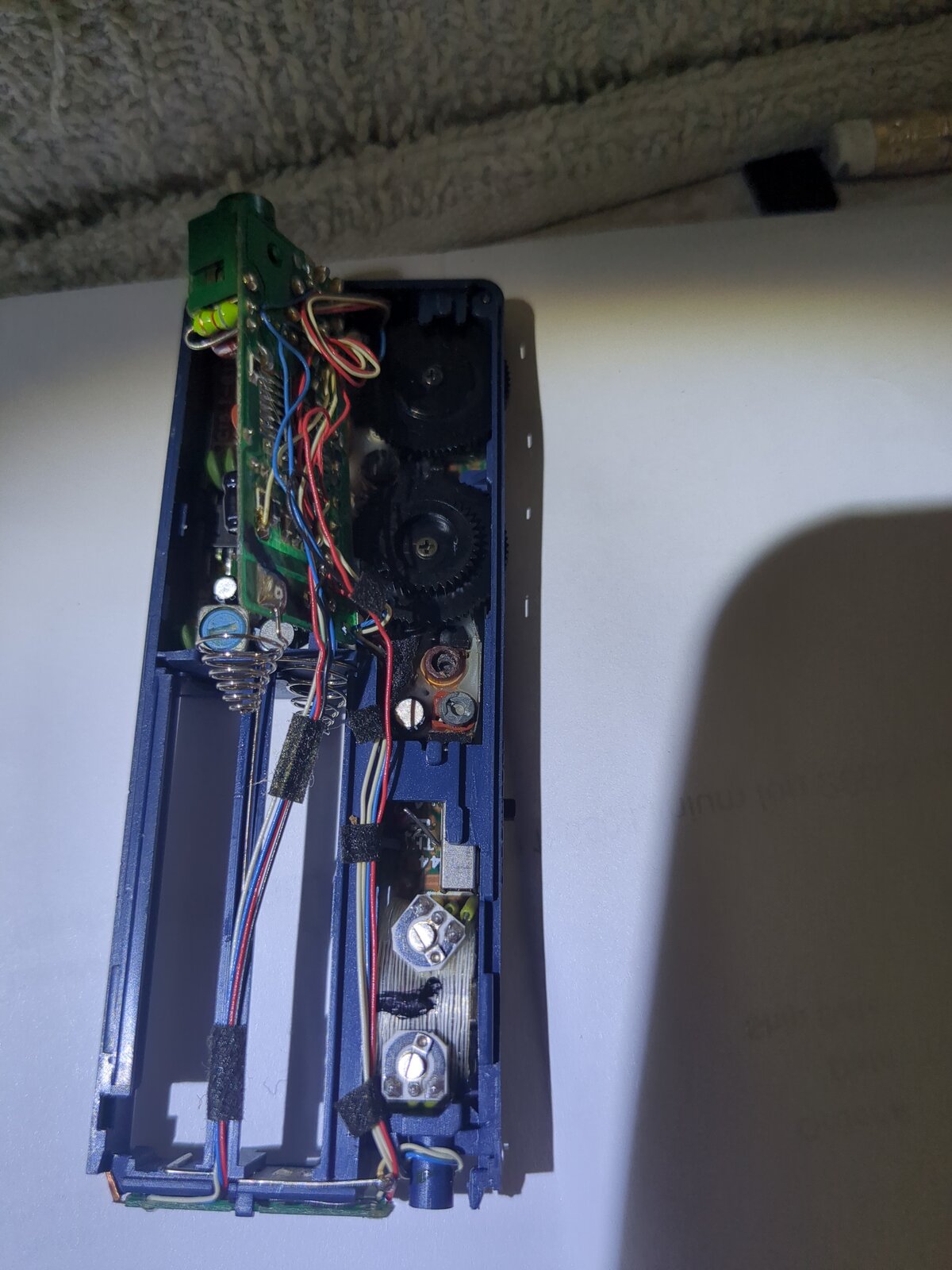

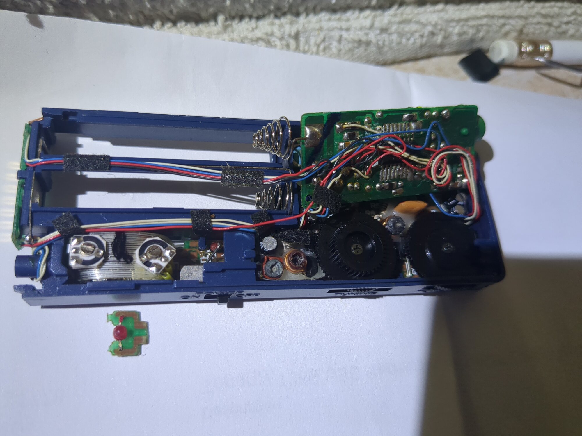

  12. Cassette2go
    1,615
    Broken now
    Other side.
    End.
    End 2
    Stereo diode LED
    Other side
    I have a blue wire loose now
    Back
    Parts
    Am radio music search. Cassette deck works fine, just no FM. In this Sony CFS-FM7

    @Cassette2go that led breaks off easily and is also easily resoldered.....no panic yet. It was shabby the way Sony connected it in the 1st place.
    Have to check for you about that blue wire, mine are still connected but man those wires are brittle like porcelain they break off so easily.
    Anyway i need to draw a wiring diagram otherwise we both get lost, best to put it aside untill then. Will recap mine and report back, also with the wiring diagram.
    Do you happen to have the service manual of this Sony?
    And maybe best to open a new thread ft. this Sony otherwise these valuable posts get lost in this thread.
