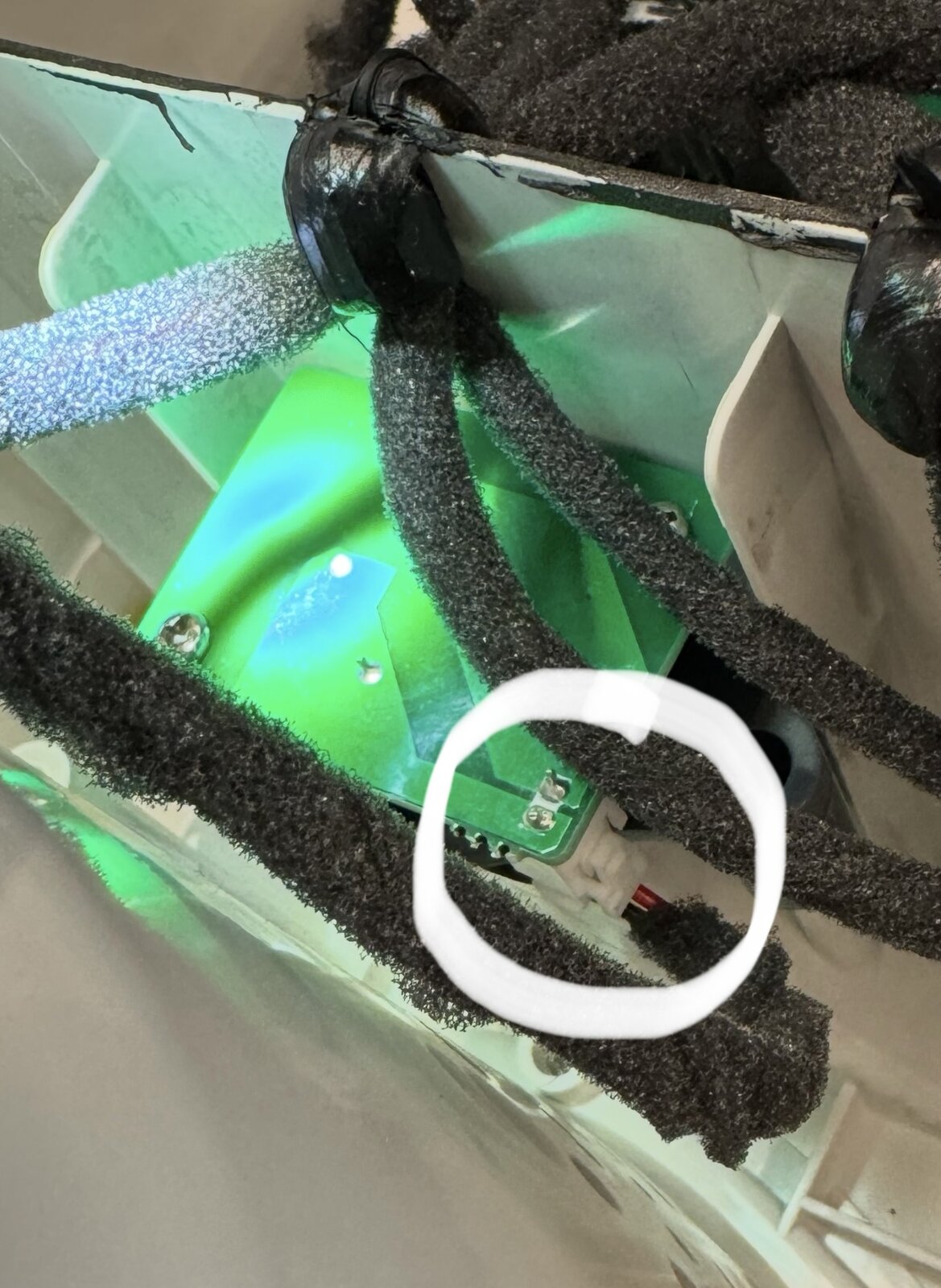

    A COMPLETE CHANGE OF HEART ABOUT THE BB-77'S SOUND QUALITY:
    I was initially so disappointed by the poor sound quality of my BB-777 that I was going to ask for a refund. The treble was shrill, harsh, and at higher volumes grainy, crunchy and congested. The sound quality was horrible. The cassette playback sounded particularly bad. Right before I packed it up and hit send on the refund email, I decided to take a listen to the BB-777 with headphones. Via headphones it's a completely different experience. Everything sounded completely normal. Very solid audio quality with no harshness! WOW!
    I decided to open up the radio and see if I could disconnect the horn tweeters. It was brainlessly simple. 10 screws on the back that are all the same size, use the padded feet on the bottom of the radio as the fingers-only leverage point to crack the seal (no spudger required). Horns are unobstructed and have a simple plug. Disconnect and zip tie to the wiring harness, reassemble radio. Takes about 10-15 minutes.
    WHAT A HUGE DIFFERENCE IN SOUND QUALITY!!!! All the harsh cheese-grater-to-the-ear sound is GONE! All inputs sound cohesive, balanced, natural. It's a completely different radio that I am now THRILLED to own.
    The coaxial speakers with integrated dome tweeters provide PLENTY of smooth, clean, natural treble.
    The only conclusion I can draw for those AWFUL horns was to throw the treble across a large room or outdoor space ( a "party" speaker").
    You still have to turn the bass and subs to full on most inputs to get normal, usable bass, but it's a concession I am now happy to make!

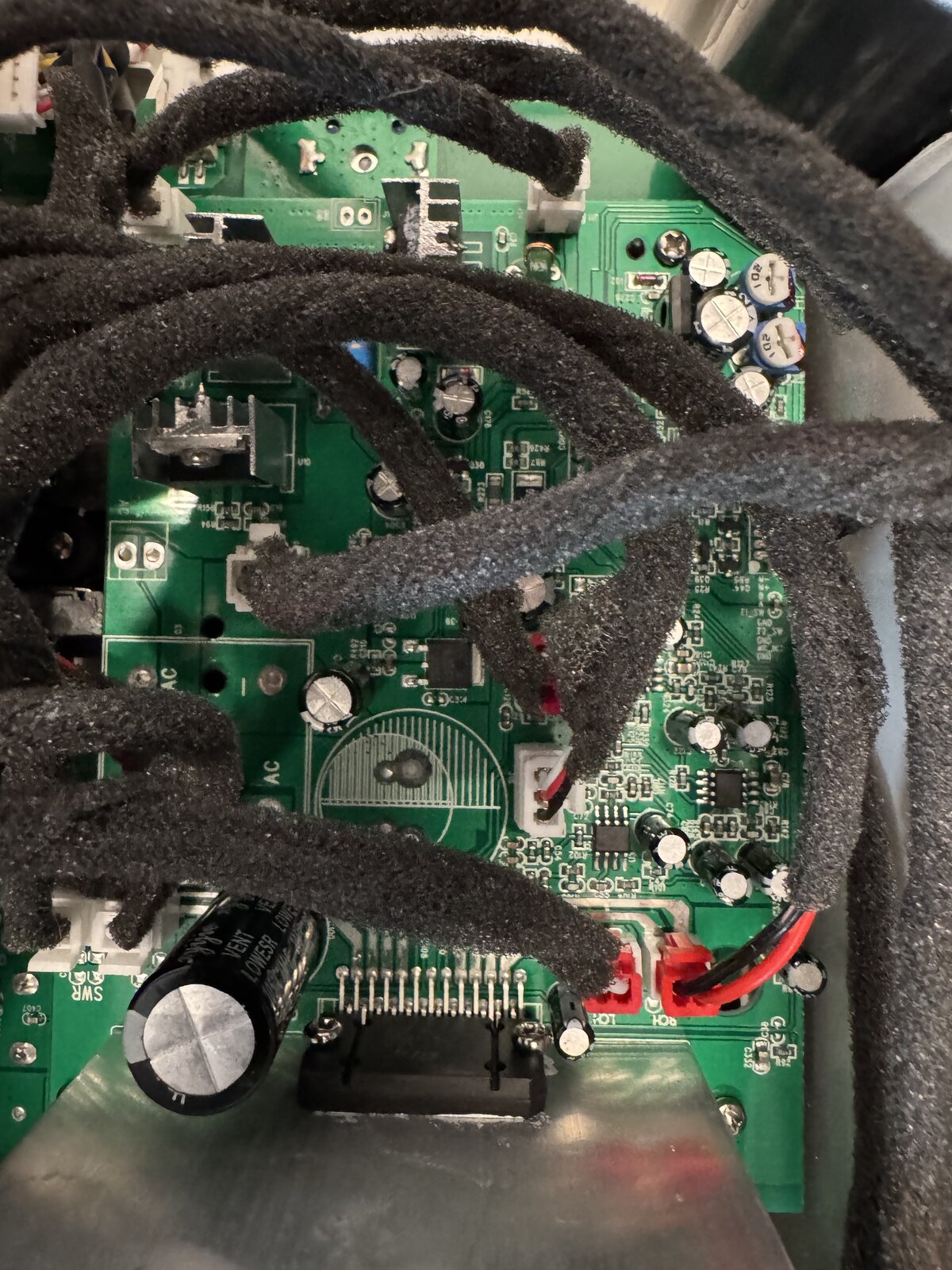

    BB-777 Amplifier: What It Actually Is: (ID'd the amp chip while I had the boombox open)
    The BB-777 uses an STMicroelectronics TDA7388, a four-channel Class-AB BTL amplifier originally designed for automotive audio. It is a legitimate, proven mid-grade amplifier IC and is capable of good sound when used within its limits.
    The important part is understanding the power ratings. ST markets the chip as 4 × 45 W, but that 45 W figure is not clean continuous audio power. In ST’s datasheet, the 45 W figure is tied to a saturated square-wave output at 15.2 V. At a more typical 14.4 V supply, ST rates it at 26 W/channel at 10% THD, which is already heavily clipped and not what most people would consider clean audio.
    A more realistic usable figure is around:
    18–20 W RMS per channel into 4 Ω at roughly 1% THD
    So, assuming the BB-777 supplies the chip with about 14.4 V and presents roughly 4-ohm loads, the amplifier is realistically:
    ~75–80 W RMS total clean/usable output
    That is the number I would use in a technical discussion, with the caveat that the BB-777’s actual rail voltage and speaker loads still need to be measured for a definitive system rating.
    The advertised 270 W peak is not representative of continuous amplifier output. The TDA7388 only has four amplifier channels. Interestingly, 270 W equals 45 W × 6 speakers, but the BB-777’s six physical drivers are not six independently amplified 45-watt channels.
    Sound-quality-wise, the chip itself is respectable: ST specifies about 0.04% typical THD at 4 W, low output noise, decent channel separation, and extensive protection circuitry. Its weaknesses are mainly efficiency, heat, and limited clean power, not fidelity.
    Bottom line
    Advertised: 270 W peak
    Chip headline: 4 × 45 W max/saturated
    At 10% THD: 4 × 26 W
    Realistically clean/usable: ~4 × 18–20 W RMS
    Total: roughly 75–80 W RMS
    So the BB-777 is not really a 270-watt amplifier in any conventional continuous-power sense. It is much more accurately described as an approximately 80 W RMS four-channel Class-AB system.
    Michiel, retro and Mister X like this.

  8. Reli
    1,117
    Wow, great detective work!
    I always assumed it had a class D amp like most other modern speakers do, but the cooling fan should have tipped me off that it was class AB instead.
    And you say it's a 4 channel amp? Does that mean 2 for the subs and 2 for the other speakers?
  9. Jam_On_It
    Jam_On_It Well-Known Member
    224
    Arizona
    Correct Reli. The coaxials and the horns are running off the first set of channels and the subs off the second set of channels.
