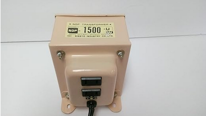

    Check Amazon and see if they have any Nissyo's, that would be my choice. I don't know what your plug, voltage or Hz are. Good luck!

    They come in different wattages, most people get them for Japanese Rice Cookers. If you get more JDM Equipment it's a good investment but they are built like a tank and there's cheaper alternatives.

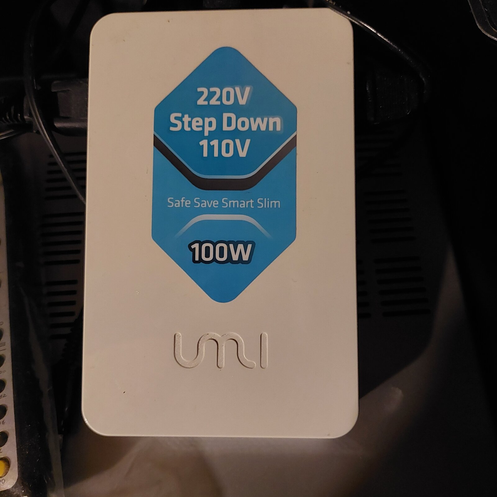

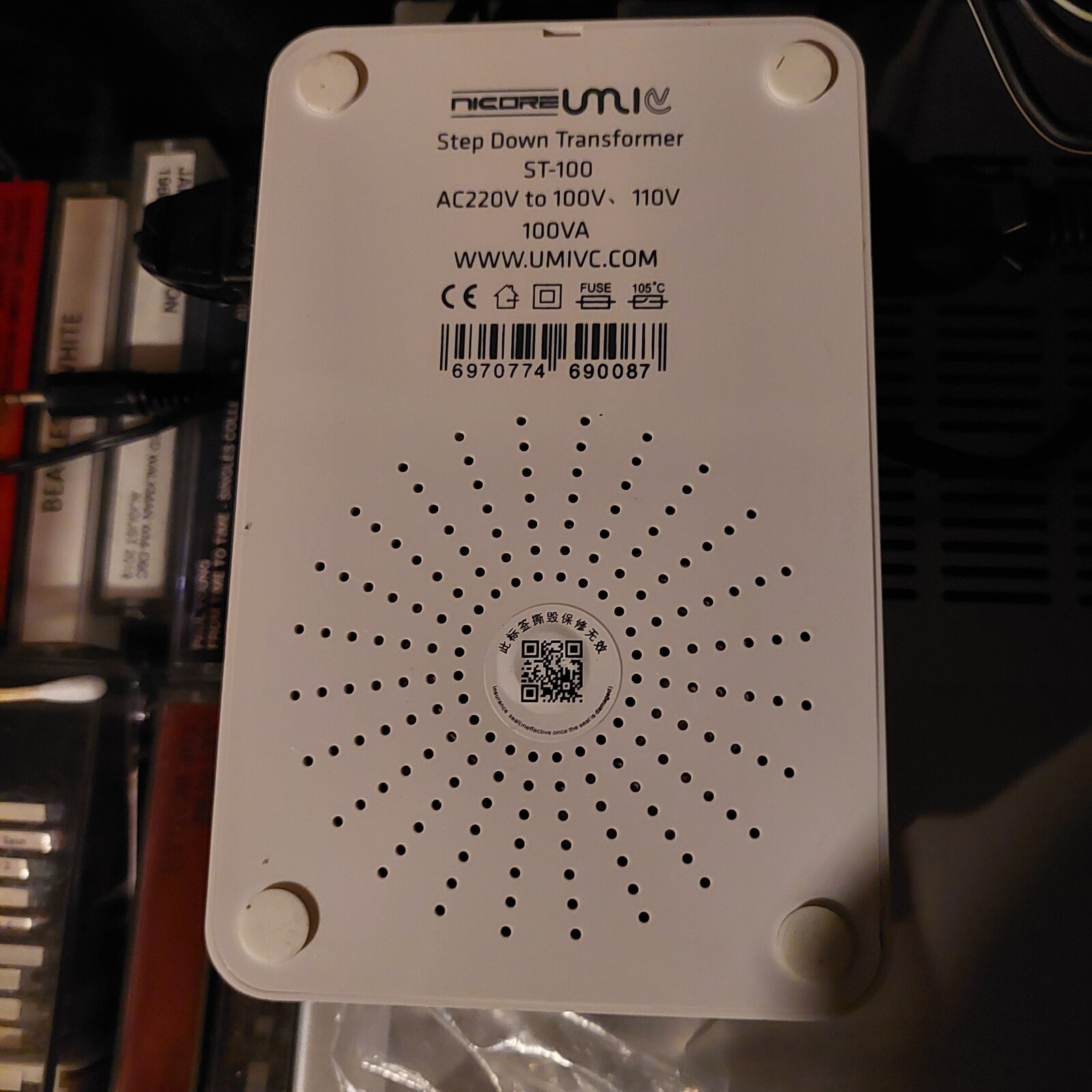

    Well I have a great step down unit with twin outlets 100VAC and US 110VAC. I'm running my CT-F1000 deck on the 110VAC and my brilliant Onkyo MD-105FX HiMD recorder on the 100VAC outlet. There is a warning in the Onkyo manual stating that the MD recorder should not be connected to a 110VAC power source. I'm not sure why but having seen so many Walkman WM-D6C Professional recorders ruined by switch mode power supplies I tend to pay heed to that recommendation about external power sources.
    You may find this transformer is available in your country with a 110VAC input in place of the AUS 220/240 VAC mains I needed.
    I've had this for 5 years and it's been 100% reliable.
