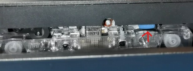

  10. HelloDD
    HelloDD New Member
    CN
    The problem is that when switching play/FF/REW, the tape will be attracted by the permanent erase head, causing serious erasure.
  11. Anthème
    Anthème New Member
    21
    france
    What unit is that ? On mine, the PM isn't as close as this one in the photo, but yes. Seems important no to mess around with PLAY/FF/REW without hitting stop.
