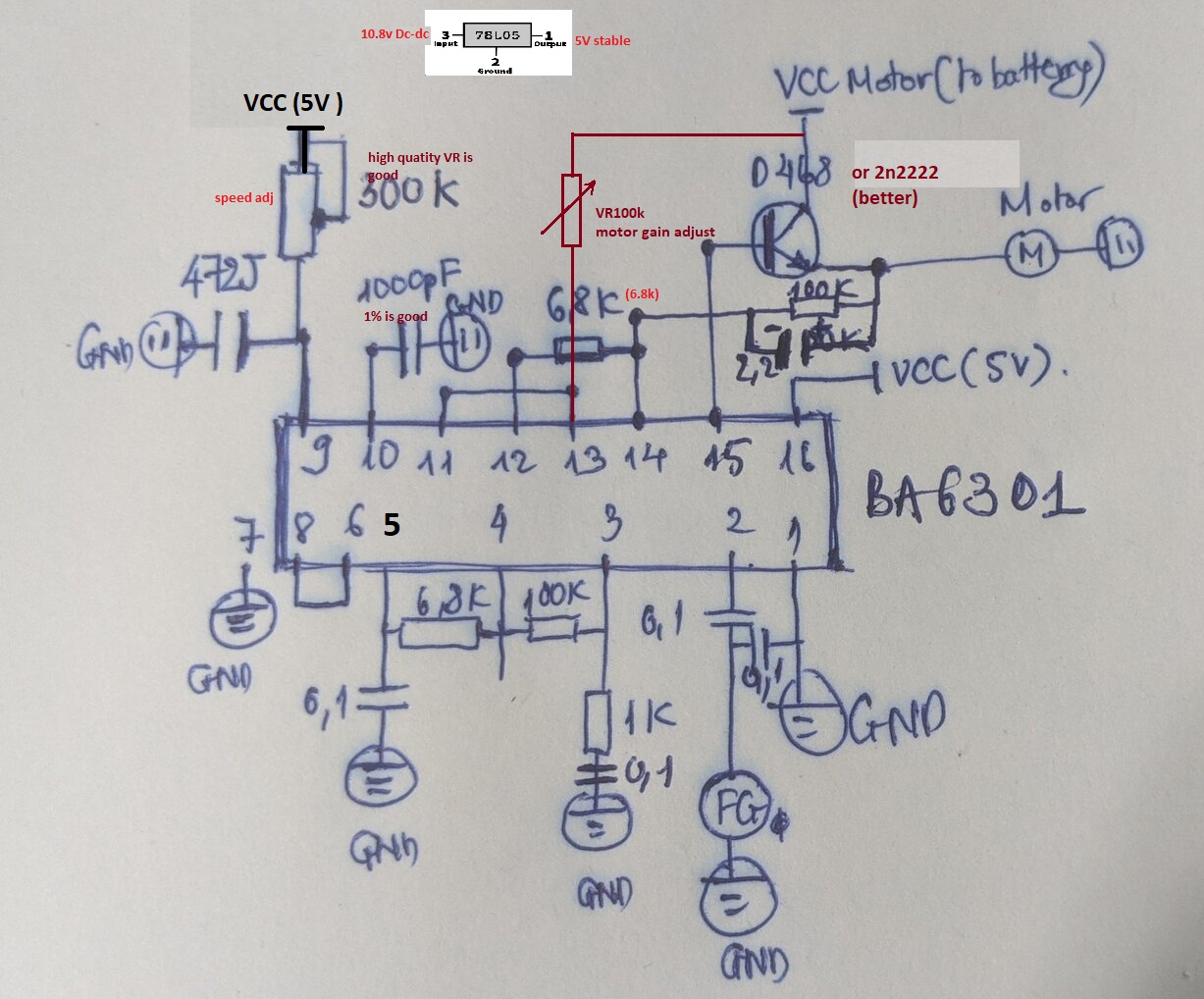

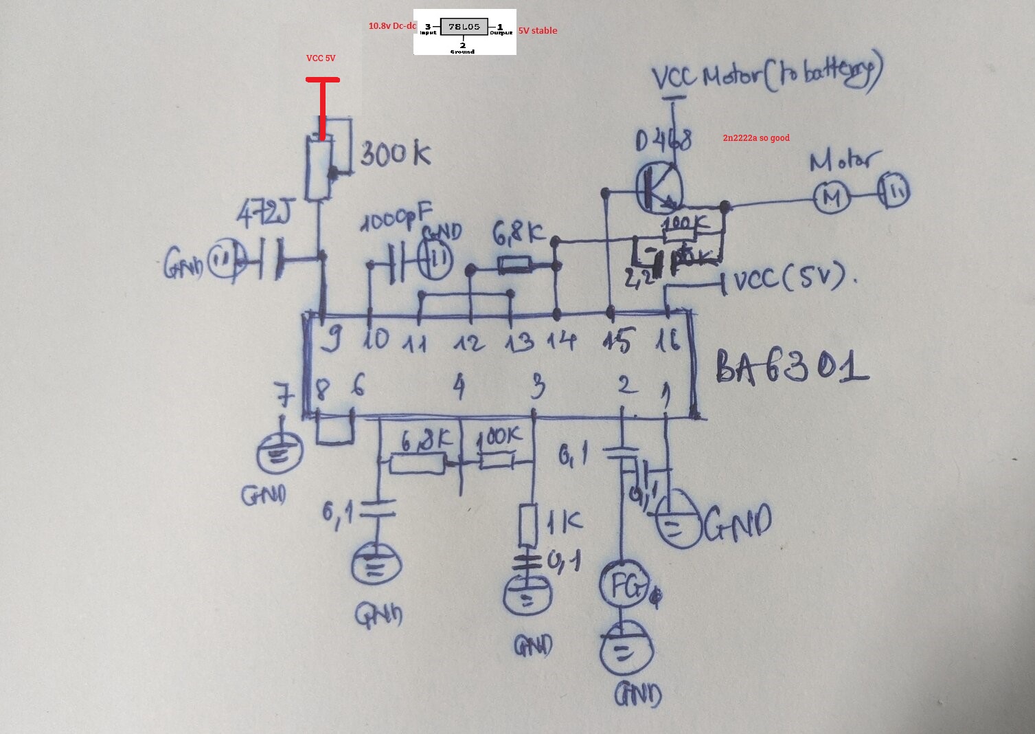

    My parts ( HAS BEEN EDITED 21/4/25 becaus there is confusion at pin 9 and add more detail )

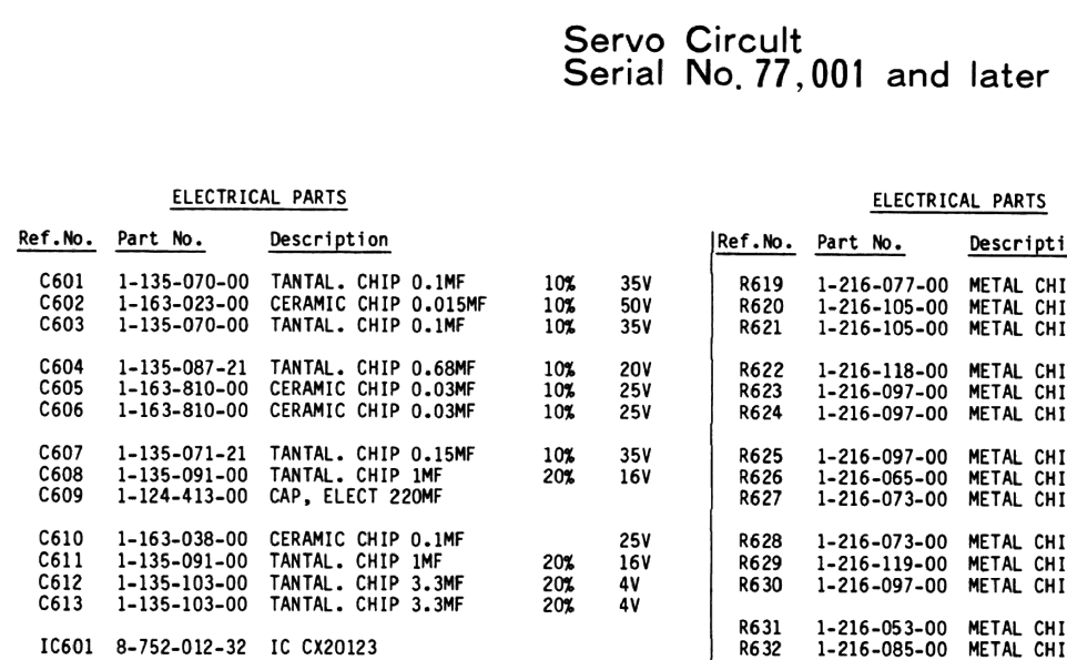

    Shoot, I made a mistake with the list. The CX20084 is next to the CX20123.
    That is the servo IC in a lot of units (not DD), usually indicated by the traditional IC601.
    Think of: Sony WM-10 and WM-30 Serial No. 77001 and later, WM-40, WM-100, WM-F200, etc.
    I am working on making some of these overviews available on Walkman.land, progress is kind of slow.
  9. Valentin
    2,122
    The CX20123 was used in the WM-100 and WM-200 series as far as I know, while WM-10/20/30 series use a discrete servo circuit built around a NJM2901 comparator.
    Then at the WM-500 series, when they switched to a normal DC motor instead of the 3-phase brushless they used before they also swtich to the generic AN6653 servo IC.
  10. Emiel
    1,115
    Take for example the WM-10II / WM-30 - up to serial number range 77000 it is the NJM2901B, above the CX20123.
    Not sure what a Servo Circult is though :)
