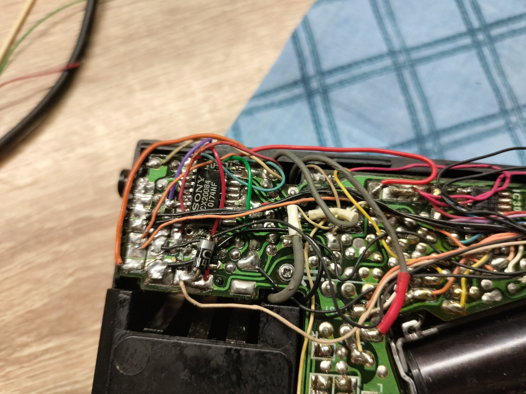

    I sincerely apologize for my hasty words earlier. First, regarding the purely analog solution, we already have Lekos's excellent approach. As for the MCU-based solution, even though I might have a slight prejudice against it, I still fully support it and look forward to seeing the results.
    Although my knowledge is limited (as my major is mechanical manufacturing), based on the time I've spent researching this IC and the CX20084 circuit of the D6C, I would like to point out a few things according to Lekos's guide as I understand them. I hope this helps you guys visualize and review the setup, and proves useful to some of you. Please feel free to correct me if there are any mistakes:
    1. Wire from "To pin 4 of CX20084" connects to the pad for pin 4 of IC601. Since both ICs have an output pin from the sawtooth wave generator block, this pin receives a reference voltage to determine the capstan motor speed—pin 9 for the BA6301 and pin 4 for the CX20084. On the D6C circuit, a reference voltage is already present at the solder pad for pin 4 of the CX20084. This reference voltage incorporates the results of both the speed tune function and the quartz lock. The voltage from this pin 4 solder pad is supplied to pin 9 of the BA6301 to provide the reference voltage for the IC.
    2. Wire from "+5V" pin on the replacement board connects to the pad for pin 5 of IC601. Inside the CX20084, there is an integrated voltage regulator block, and pin 5 is its output pin. It supplies a stable voltage to the aforementioned reference voltage generator circuit. When switching to Lekos's circuit, we supply a stable 5V to the pin 5 solder pad. However, due to this voltage difference from the original design and compatible with the new IC, R603 and R604 must be changed. Additionally, a few minor adjustments (RV603) need to be made so that it runs at the correct speed when the speed tune knob is centered and there is no intervention from the quartz lock circuit (Speed Tune ON).
    3. Brown wire #15. (OR the brown wire from the replacement board can be soldered directly to PAD 7 of the CX20084, but resistor R605 must be removed and do not remove wire 15 (brown) of the D6C).
    This is the signal for the auto-stop circuit.
    4. Blue wire #17 . (OR the blue wire from the replacement board can be soldered directly to PAD 9 of the CX20084 and do not remove wire 17 (blue) of the D6C ).
    The quartz lock circuit needs to sample the Sawtooth wave from the FG coil to compare it with the quartz crystal frequency, then make adjustments by acting on the reference voltage. When the CX20084 is removed, this signal is no longer supplied, so it will be taken from pin 6 of the BA6301 IC (after the IC's Hysteresis Amp block).
    5. Red wire from motor solder to the same place as brown wire #18.
    To make it easy to understand, the Red motor wire is to be connected to the positive (+) terminal of the 6V battery pack.
    And from what I can see, with certain circuit design modifications, a simplified replacement board could be made that just needs wiring to the CX20084 solder pads, with minimal modifications to the stock D6C circuit

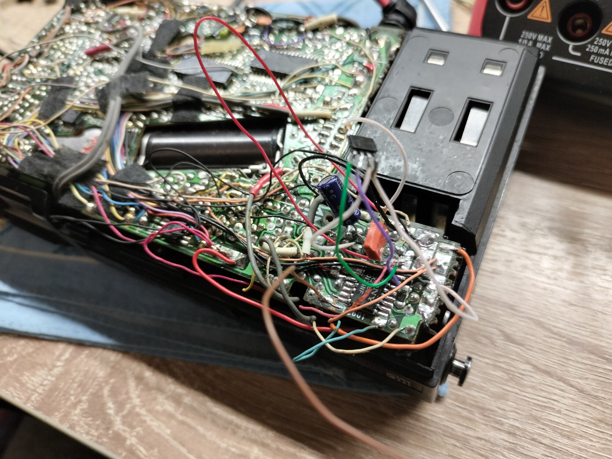

    Another interesting thing about CX20084 is that before I decided to create a replacement board, I tried to figure out which part of the IC was dead and which was working. In my case, it seems like the only part that was not functioning properly was the Phase Corrrector, an OP-AMP connected to pins 13-15 of CX20084.
    I tried to bypass it by connecting another OP-AMP to the same pins and it worked for about a week. It was about a year ago, so I don't remember exactly why I eventually decided to move on to a new board. I do recall that I might have burned down my CX20084 in some other way, which caused it to completely stop working.
    Here are some photos of the external OP-AMP in the attachments. The Q601 was not the original one - the previous technician that tries to repair this unit decided to install a convenient IC for stabilizing the motor speed, but it worked terribly - W&F around 0.2 RMS and speed drift when carrying the device in hands. So, that technician removed Q601, that`s the reason why I installed a different transistor.
    What will you do with that information? I'm not sure, but this is a possible way to "fix" the original IC if it dies in the same way as mine did.

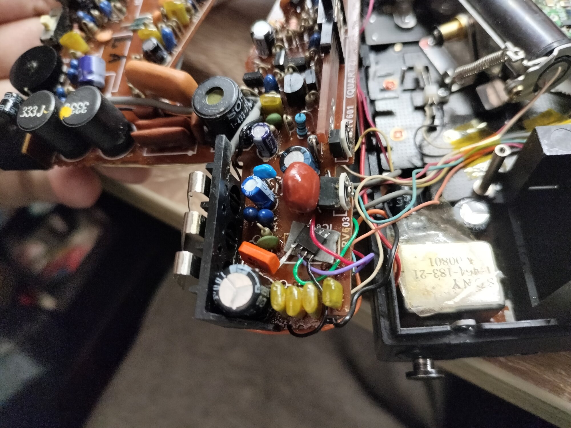

    I managed to build the LeKos board and install it but probably because of my own lack of analog experience I could not get it to lock. I see the servo hunt (at 64Hz, see screenshot) for lock around 3k but it fails and always drifts away.
    Could it be that I am the first to attempt this with a green PCB model? Certainly, reworking the main Sony PCB to replace 0803 series components is not in my skillset. Instead I attempted to recreate the Sony resistive summer (components around pads 5/4 of CX20084 position) discretely and perhaps went wrong there.
    In addition, Valentin pointed out that my machine has a different motor with different characteristics so that may be my issue too.
    Anyway, assembly of the board was quite straightforward and worked first time. I used solder paste and a cheap heat-plate from Amazon and it worked very very well. In case someone else would be interested, I will post some documentation of the build process here shortly. This board has proven successful on earlier brown PCB units with the original motor so I am sure it's a good design for those. My offer of a free blank PCB still goes, just send me a private message.
    I want to thank LeKos and Valentin for help and advice. All mistakes were mine I am sure :)

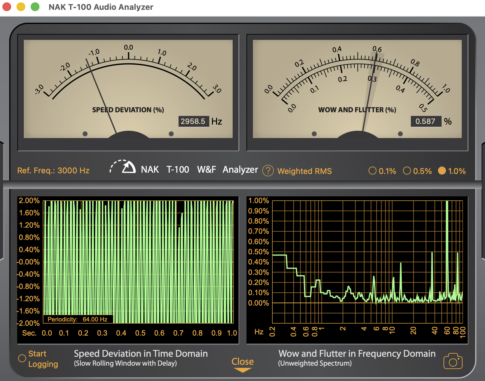

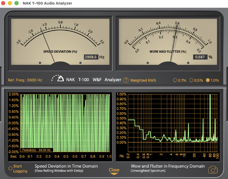

    This guy is selling new old stock from a Florida Sony dealer/service dept. that closed in 2011. I bought 2 and understand he has 8 still available.
    The CX20084 I received is authentic Sony, not removed from a machine and works perfectly. My W/F with the new chip is 0.07%wrms.
    I have no connection other than as a customer and this is a lot more than I’d like to spend on one chip but not as high as some. I recommend:
