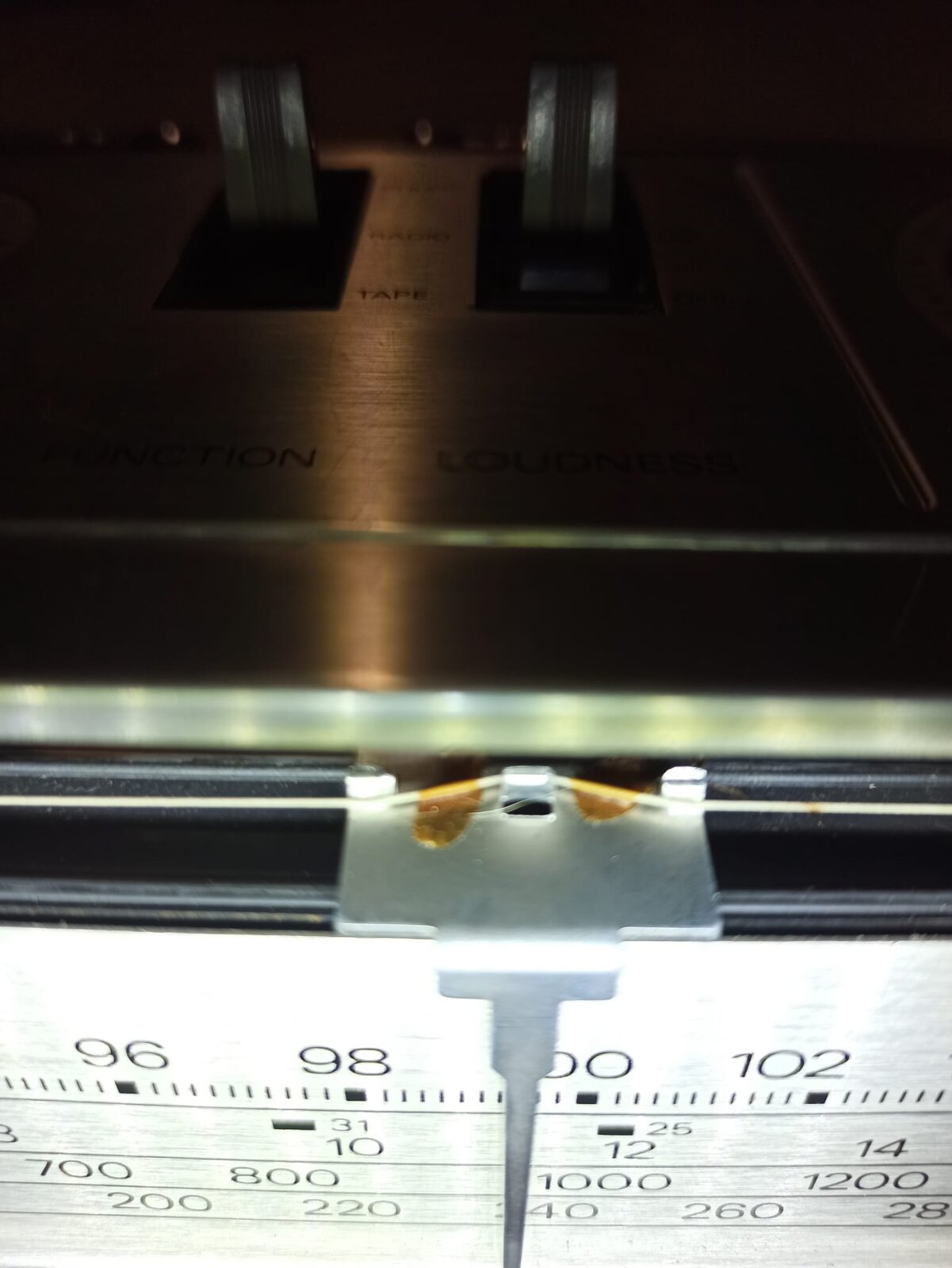

    hi i am new to this site and i would like to ask for help from someone more experienced than me i have crown csc-850 that stops searching for stations on the left side!
    Opening the radio, if I pull with my fingers, the white wire unlocks and goes well to the right, but if they go back to the left it stops again.
    Thanks in advance to those who want to help me.

  3. Nicola Torboli
    Nicola Torboli New Member
    5
    Italia
    thank you very much it is definitely out of phase but my fear is that the cotton cord is fixed to the pointer with two points of glue then I send the photos.
  4. Nicola Torboli
    5
    Italia
    hello mister x see my fear is at this point. I'm afraid to pull the thread t index.jpg index.jpg o win the glue I'm afraid that if it breaks I would like to do it to try to phase it again since it is moved and directed with another radio
    19,126
    On some radios people try to go one direction and it pushes the pointer until it doesn't match the dial setting. Do not mess with the glue or pointer, it needs to be restrung which can take a long time to get everything correct. Take photos of how the string is wrapped around the pulleys then figure out a way to release the tension and pull it over. I'd mark the string in spots that don't get exposed on the dial so you know how far to move it.
    There should be more information on the internet, most of these dials are very similar on every brand.
