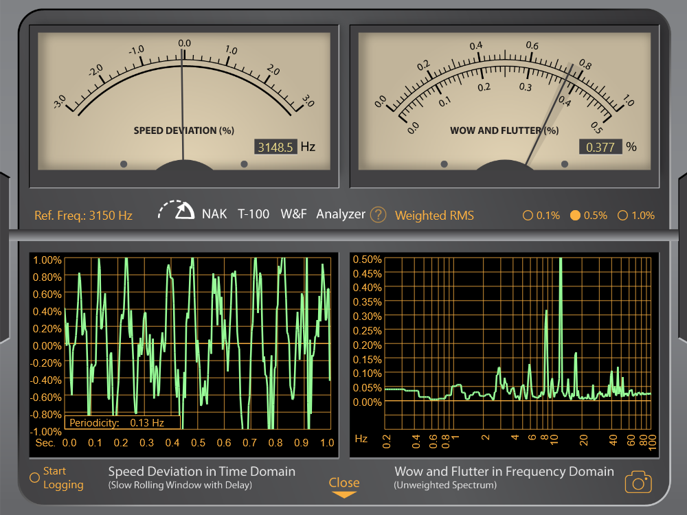

    Update: Checking the voltages didn't yield much—nothing matched the values listed in the Service Supplement (except for polarity), though both of my units read very closely to each other. It’s likely just another (?!) undocumented production revision.
    With no other clear avenues, I disassembled the donor unit, gave it another thorough cleaning, and relubricated all possible friction points, incorporating the tips mentioned above. After reassembling and testing, there’s a noticeable improvement! The wow & flutter dropped by nearly half to 0.377% WRMS.
    While still not close to ideal, it's a big step forward and makes this WM-2 donor listenable. I suppose the combination of minor tweaks finally paid off. Plus, count me sold on the capstan etching procedure—I had my reservations initially. The next step is doing the same to the main unit and wrapping this project up. There's only so much tinkering one can do!
    Thanks to everyone for the input and support throughout this thread—it's been an incredible help.
