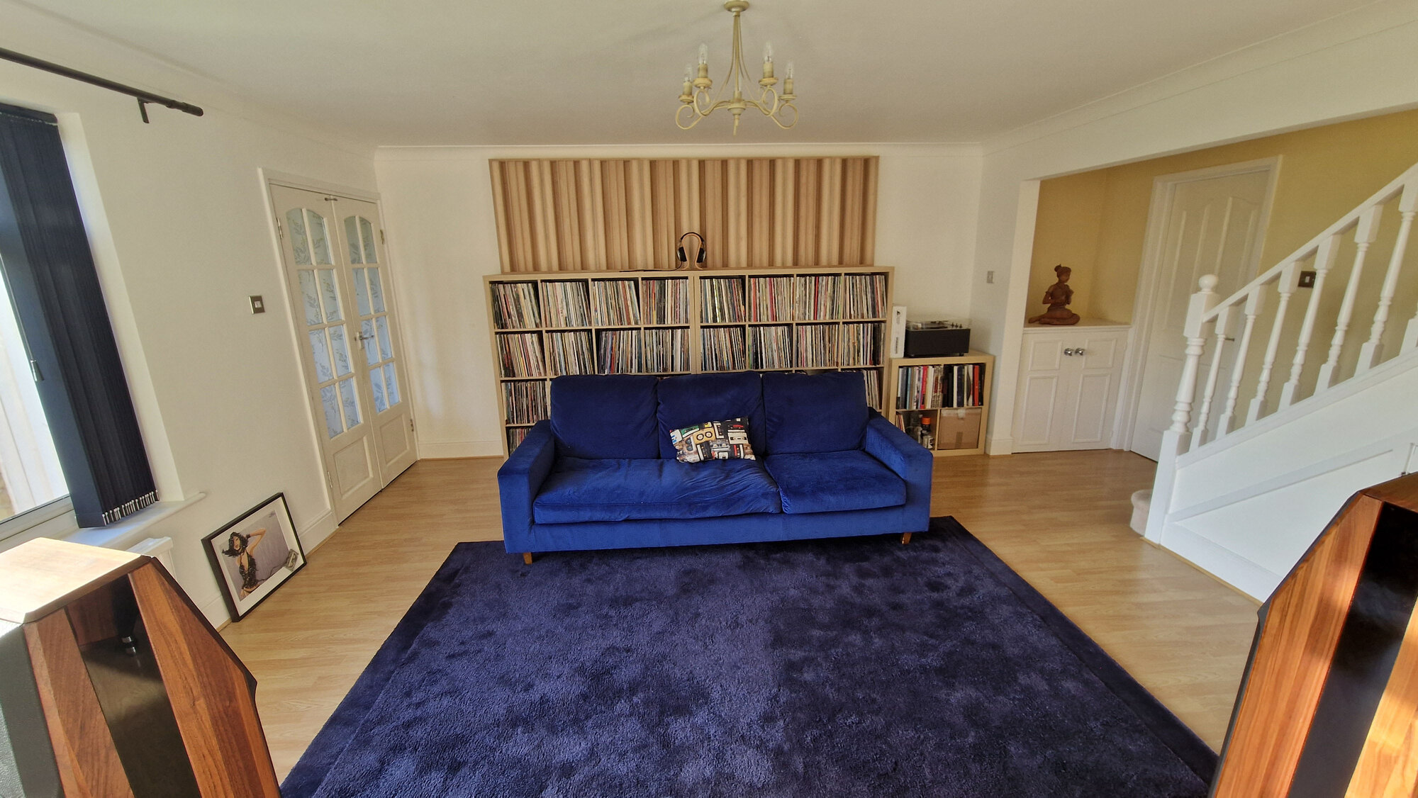

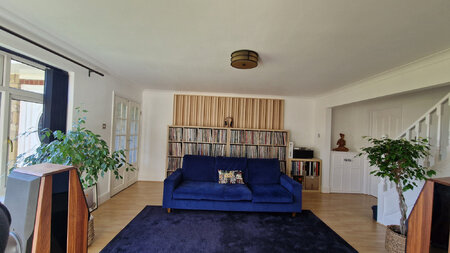

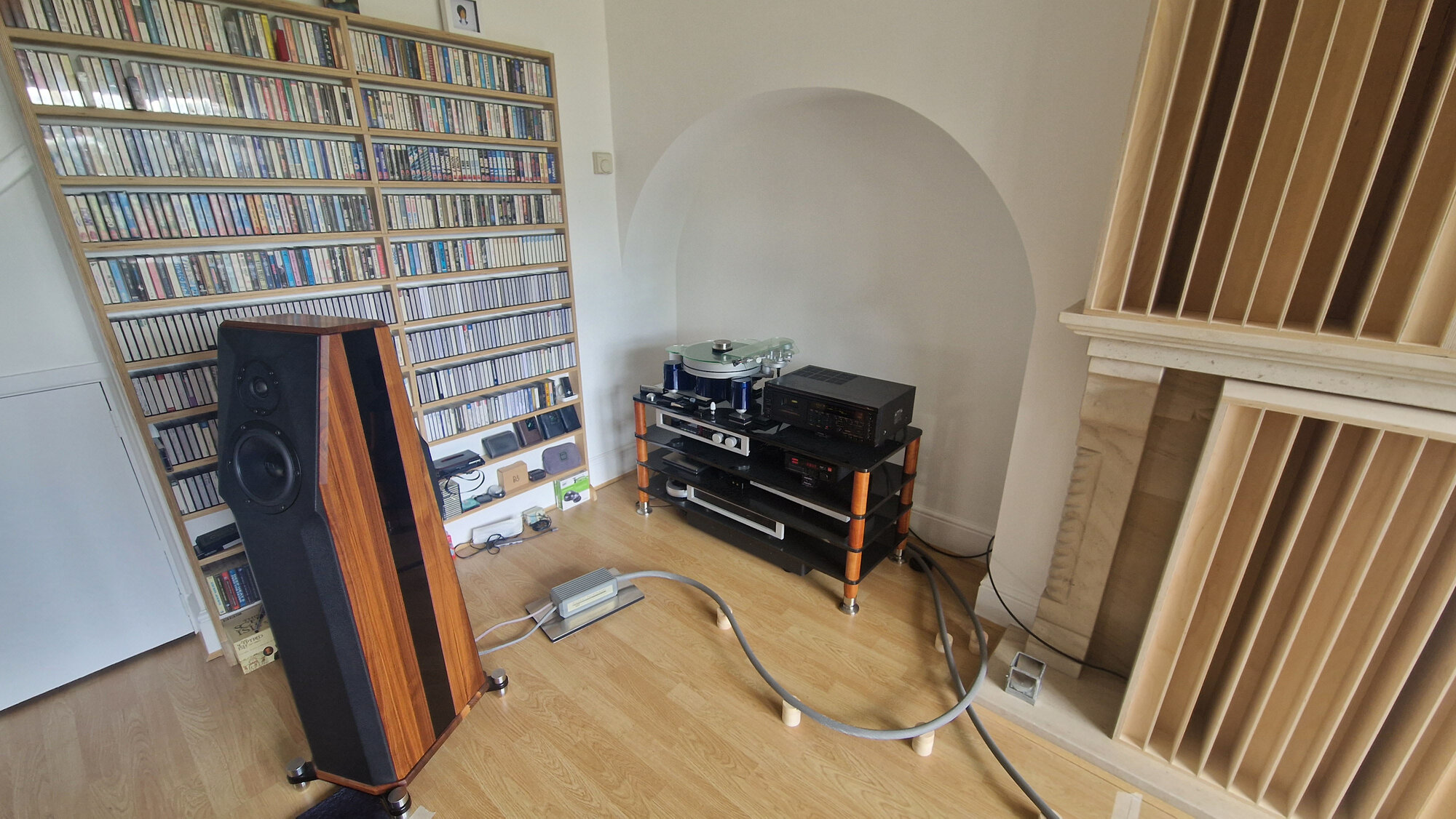

  3. TooCooL4
    3,645

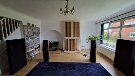

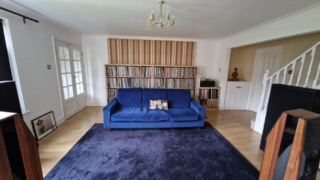

    Slow progress with the house and room.
    I bought some DIY plans from Acoustic Fields. I now have quadratic diffusers for the front and back wall. The front ones are 9½ inches deep and the back ones are 4½ inches deep. I could have gone deeper in the front to get lower wavelengths, but the units would have been deeper than the mantelpiece that would not look good.
    I could not go deeper with the diffusers on the back as they are too close to me and the sound waves would not be fully formed by the time it hits my listening position.
    Regarding diffusers on the front and back wall, I have covered as much surface area as I could. I still want the living room to look like a living room, and the middle of the front wall is the most important for the imaging as far as I am concerned. Yes, it would be nicer to cover the whole front wall, but that is not practical in this case.
    I will need to do the cloud cover and replace the first reflection points with new panels from Acoustic Fields, that is something for a later date need to do other things in the house first.
    So, what do I hear from just doing the front and rear wall diffusion.
    First thing I noticed is centre image focus much sharper, image thrown much wider than the speakers. I now get the height information back, greater image depth. I also get greater clarity.
    I will probably have to play with the speaker placement again, to take more advantage of the new diffusers.
    I am now hearing more of what the speakers can do, baby steps but getting there. :thumbsup2:

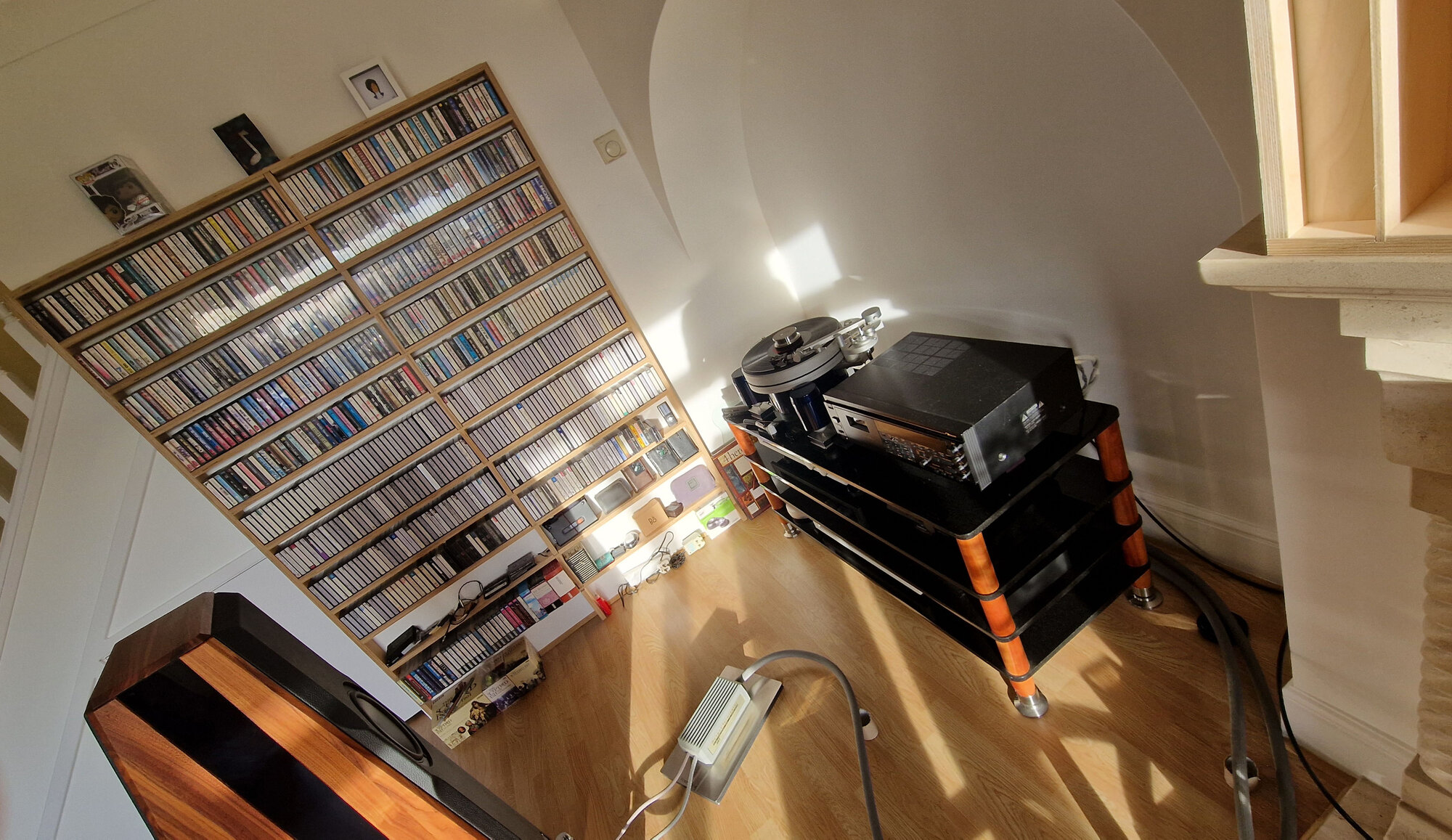

  5. TooCooL4
    3,645
    Having time off over Christmas meant I had time to work on my room some more.
    Before getting any more room treatments installed, I thought I’ll experiment a bit more with what I already have.
    I removed the first reflection points absorbers, the first thing I noticed was the music had a bit more life to it. Hearing a bit more of the room, gave the sound a more liveliness feel to it. So those absorbers, sucked a bit of life out of the music. The speakers being over a meter from the side walls, meant I can get away with not having anything at the first reflection points. I also gained almost a 1db rise in the sound pressure level.
    I also removed the Symposium Rollerblock Jr’s from under the speakers, to replace them back to the original feet. By placing the original feet back on, I am now able to adjust the rake angle to give me more height in the soundstage. I rake the speakers up by 1.4 degrees, that helped with the image height.
    Before I do anything else to my room, I will need to make some measurements of the room to understand what else is going on. No point in addressing a problem that’s not there.
    Now I just need to find a friend with a measurement microphone to borrow one from.

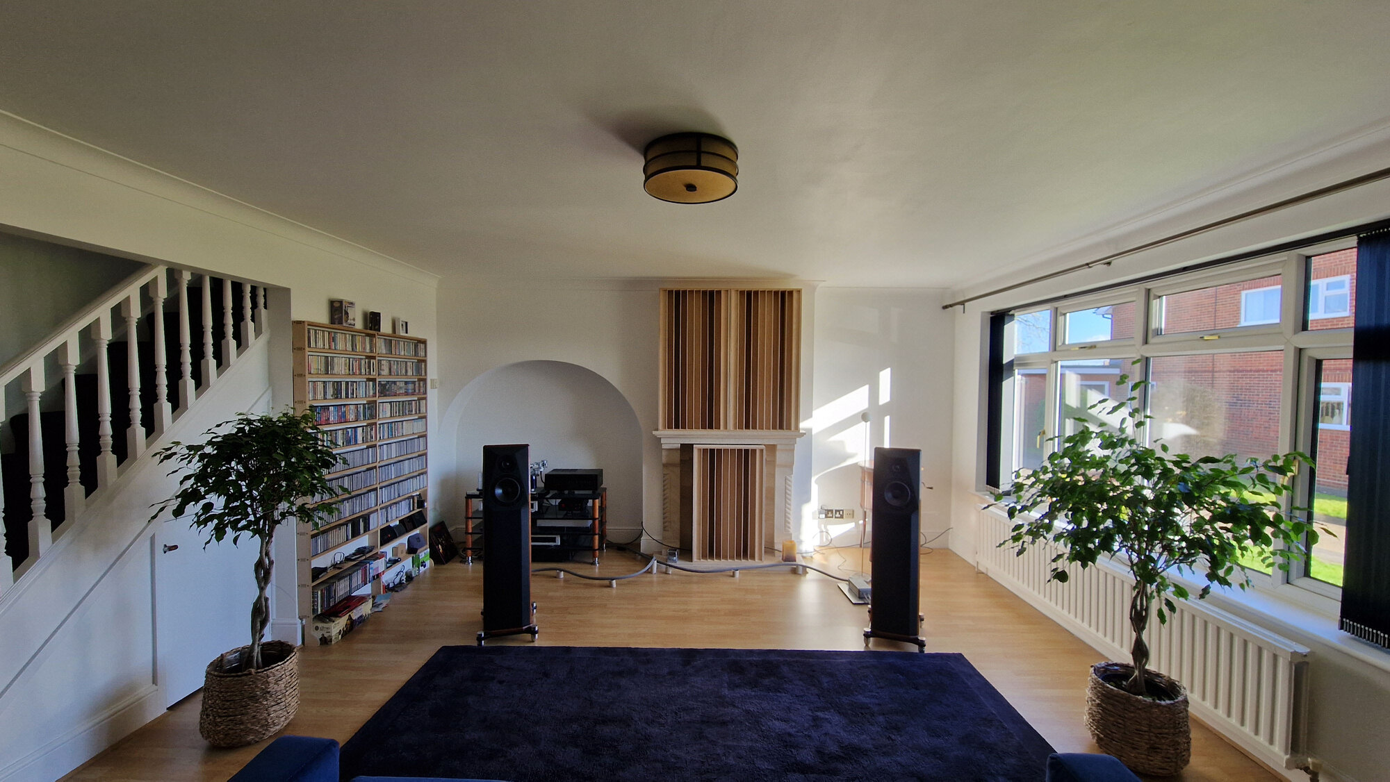

  9. TooCooL4
    3,645

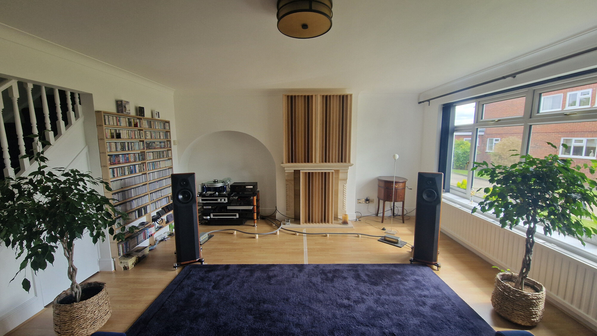

    After replacing the main light in the room and seeing the mess with the ceiling, I have decided to hold off on the cloud cover in the listening room. As it’s going to be a big messy job.
    What I have done for now is to get some really thick underlay to put under the rug, to help a bit more with the floor bounce. I think that is good enough to help and minimise the floor to ceiling bounce, I’ll have to get some friends in to listen and see if they agree with me.
    I thought my one plant looked a bit lonely, so I got another Ficus to balance the symmetry in the room.
    I think I am done for now, with the living room regarding making the Hi-Fi sound better.

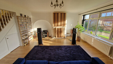

  10. TooCooL4
    3,645
    Time on my hands during the bank holiday weekend, while my neighbours were out watching the RAF flyby I was being boring :tongue:and moving the speakers around for a better soundstage / image. I did get out at the last minute just to see the Red Arrows fly past.
