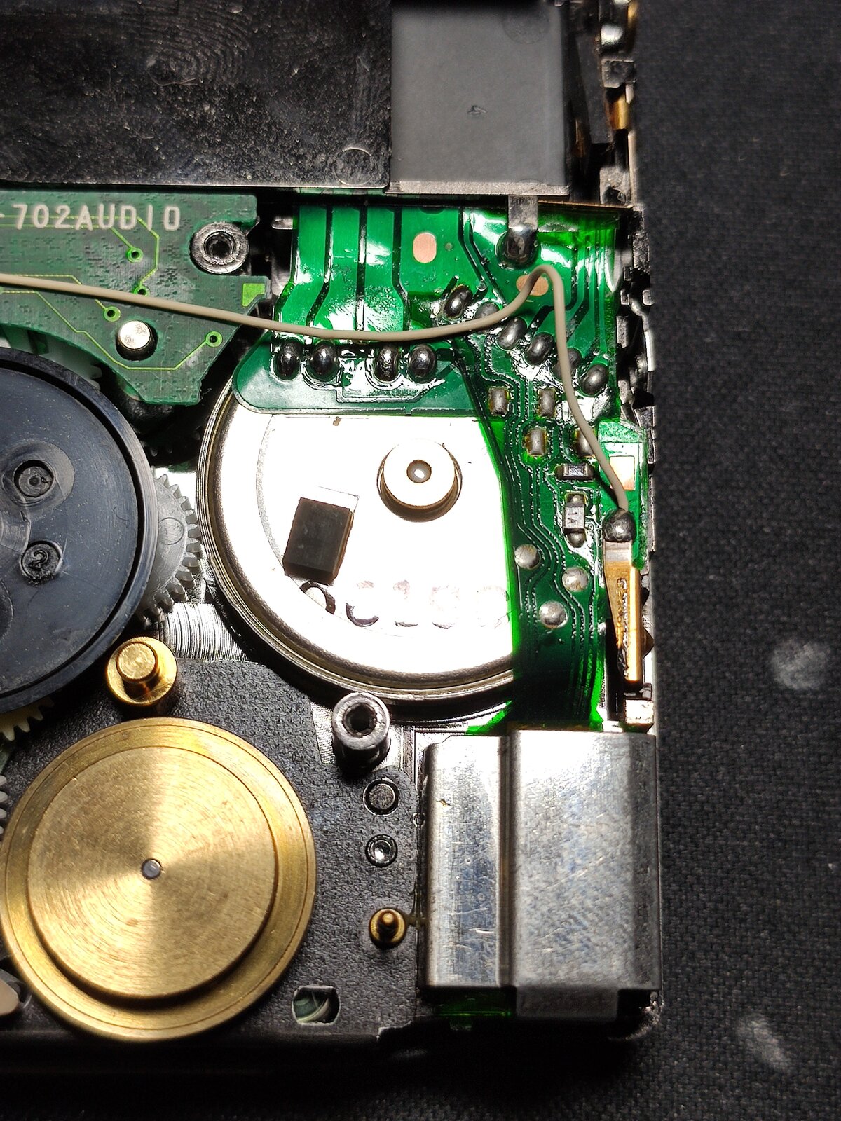

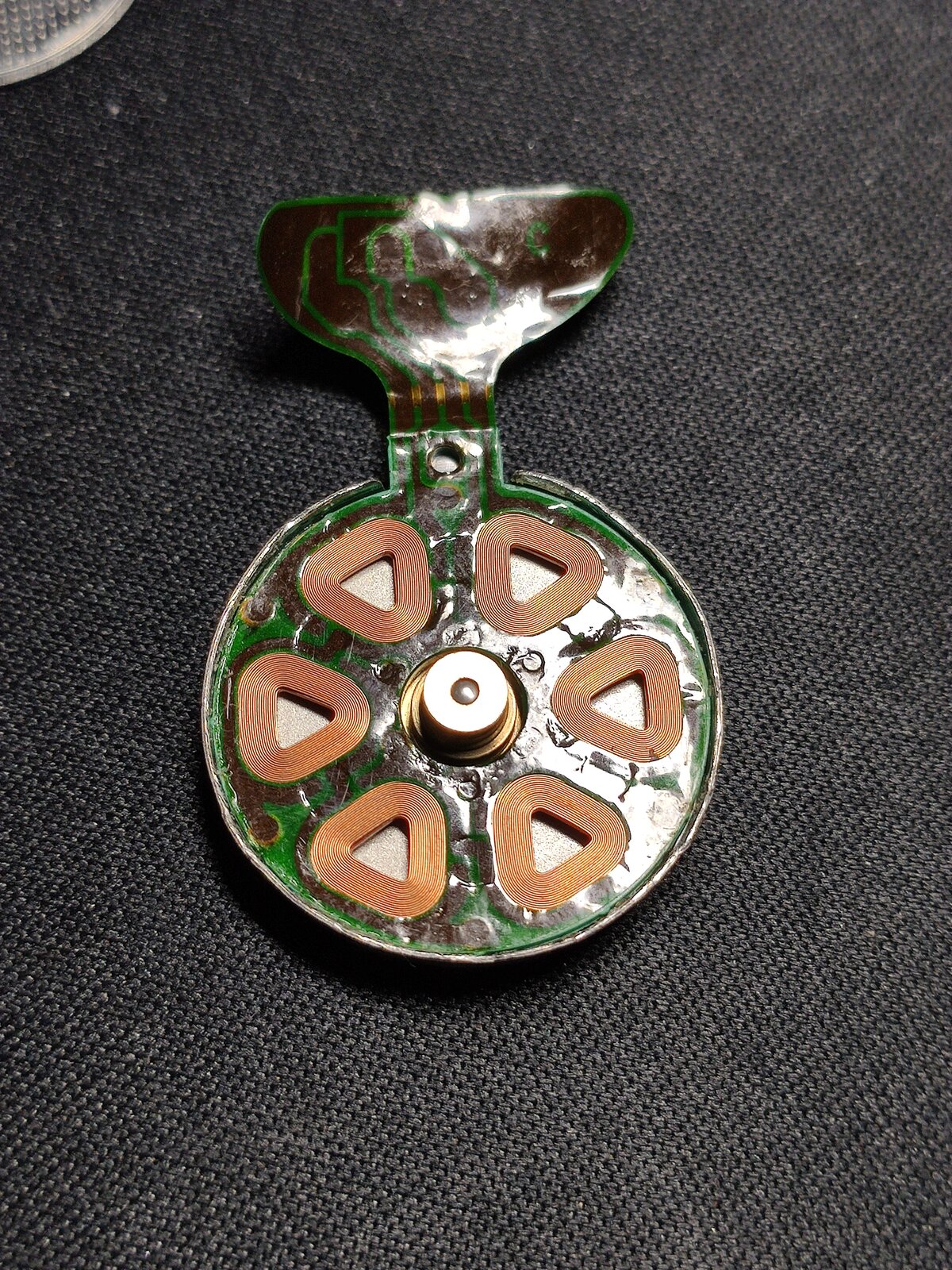

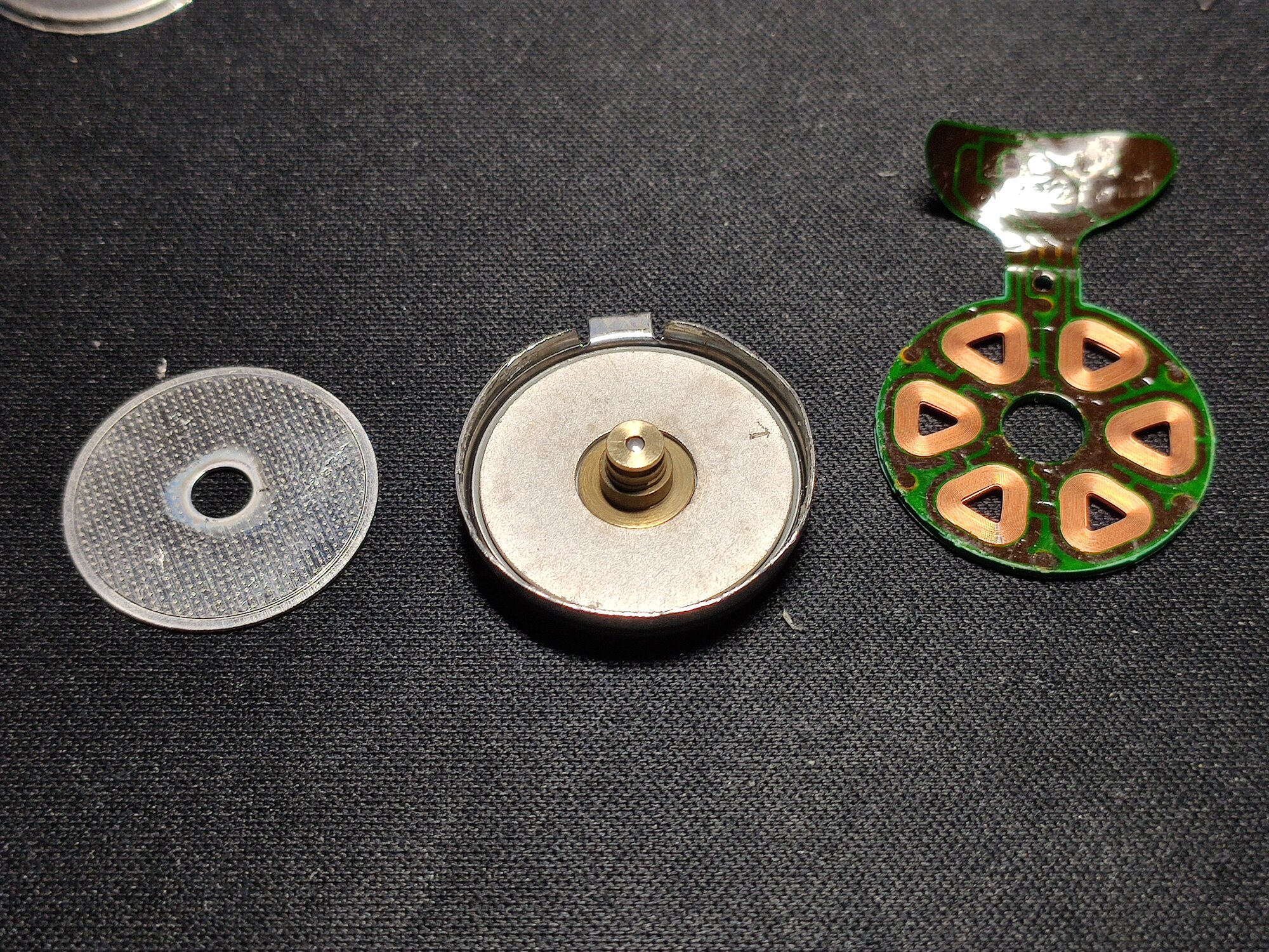

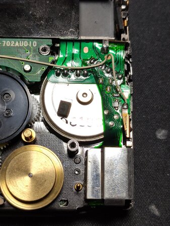

    This thread will cover the disassembly and lubrication process of cages disc-type motors used in SONY walkmans.
    A short list of walkman using this type of motor:
    1. WM-A602/WM-B602/WM-B603/WM-AF604/WM-150/WM-170/WM-F181/WM-190/WM-506/WM-2091/WM-F2095/WM-EX49/WM-EX49C/WM-EX50/WM-FX50
    2. WM-701C, WM-702
    Similar to the SONY WM-EX/FX series (which has a very similar motor, but not caged), this type of motor is prone to wear and being noisy due to lack of lubrication and improper lubricants used at the factory (very thin coat of grease).
    That is why it is recommended to to this when you replace the belt in your walkman, as it is recommended to do a cleaning and re-lubrication of all rotating parts to assure a good wow&flutter figure.
    Disassembly of the walkman and taking the motor out is not covered in this thread and it is assumed you have the skills to do that. Otherwise, I do not recommend attempting this repair, as it's pretty high risk.

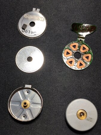

    STEPS:
    1. Take the motor out of the chassis.
    2. Remove the glue on the edge of motor metal cover. You will need a very sharp tool to remove this glue, as it may be very hard in some cases. I recommend removing all glue before attempting to remove the cover, otherwise you will bend it.
    3. Remove the metal cover.
    4. Remove the top metal disc (not shown in pictures). Use a plastic tool to remove the metal disc.
    5. Remove the PCB containing the coils
    6. Remove the rotor.

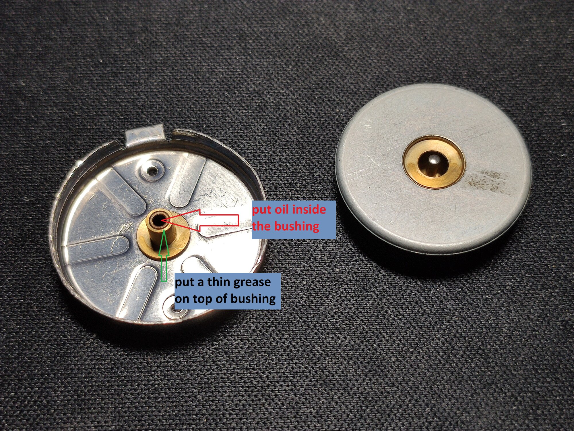

    7. Clean the shaft and bushing with a cotton swab immersed in IPA.
    8. Lubricate the bushing as indicated in picture. Use watch oil to lubricate the inside of the bushing and a thin grease (like SW-92SA or similar) to lubricate the top of the bushing.
    9. Reassemble. You will need to glue the top cover back. It's enough to do it in 3 or 4 spots, not on the entire length.
    NOTE: If you bent the cover, straighten it before re-assembly.

    The EX/FX motor has magnets on both sides, but that is because the coils themselves are only PCB traces (lower number of turns), thus generating much weaker magnetic field in the EX/FX type.
    This is about the only difference compared to this one: https://stereo2go.com/forums/threads/how-to-diassemble-and-lubricate-sony-wm-ex-fx-motor.7940/
    As a sidenote, motor used in WM-10 is also of this type, but without a cage (it only has a top thin metal cover hold on with screws).
    The difference in WM-10 is that one uses a ball bearing instead of a bushing (which will also need lubrication, as some WM-10 have very noisy motor with bearing noise).

    If it's locked solid, it means the rotor is coming into contact with the coils. The coils assembly or PCB in the case of EX/FX type motor needs to sit flush with the case,
    as the clearances are very tight (0.2mm-0.25mm) and any slight misalignment will result either in friction between rotor and coils or complete lockup.
    The WM-10 motor is slightly different in design as instead of a bushing it has a ball bearing. However the coils are exposed copper, not just traces on a PCB.
    Please provide a picture witht the 2091, as it might have a different type of motor than all 3 types we are talking about here.

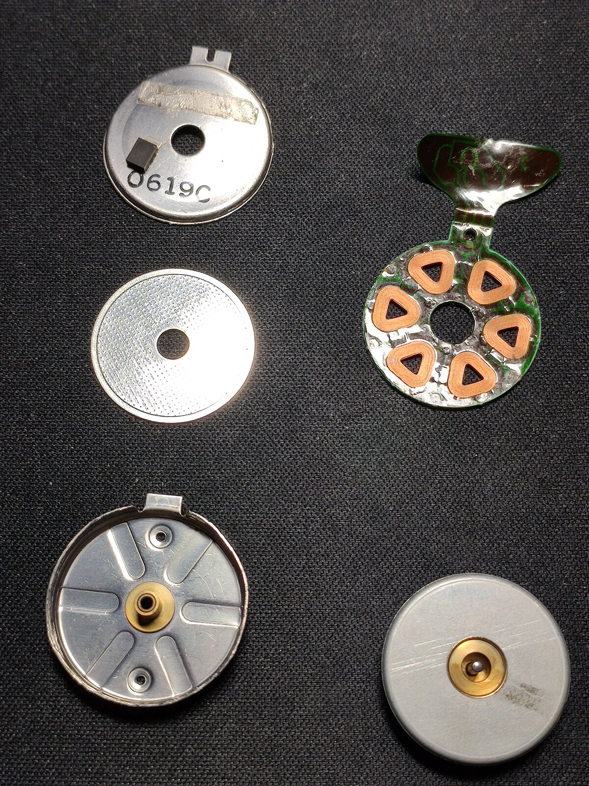

  7. Wombat
    Wombat New Member
    27
    Australia
  8. Valentin
    1,355
    Yes, I do know this one, WM-2091 being in the same series as WM-150, WM-B603.
    This type of motor is the same as the one described in this thread in terms of how it is disassembled, but the coils are on a PCB, like the EX/FX type.
    It has nothing to do with the WM-10/20 and alike, those are different: ball bearing instead of bushing and magnet (rotor) is only on bottom side, as it has to be very compact.
    Wombat likes this.

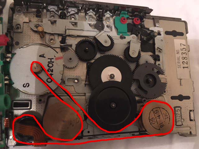

    Can anyone show the belt wiring diagram for the WM-A602/B602?
  10. Valentin
    1,355
    Here you have the belt routing, which is the same on all models with this mechanism:
    WM-A602/WM-B602/WM-B603/WM-AF604/WM-150/WM-170/WM-F181/WM-190/WM-506/WM-2091/WM-F2095/WM-EX48/WM-EX49/WM-EX49C/WM-EX50/WM-FX50/WM-GX51:
    Igor62 likes this.
  11. Igor62
    Igor62 Member
    23
    13
    Ukraine
    Thanks a lot! you confirmed my guess
  12. Igor62
    Igor62 Member
    23
    13
    Ukraine
    I wonder the purpose of the black plastic pulley at the bottom left.?
  13. Valentin
    1,355
    Small black pulley is for routing purposes only, it doesn't drive anything. Many mechanisms have such an "idler" pulley.
