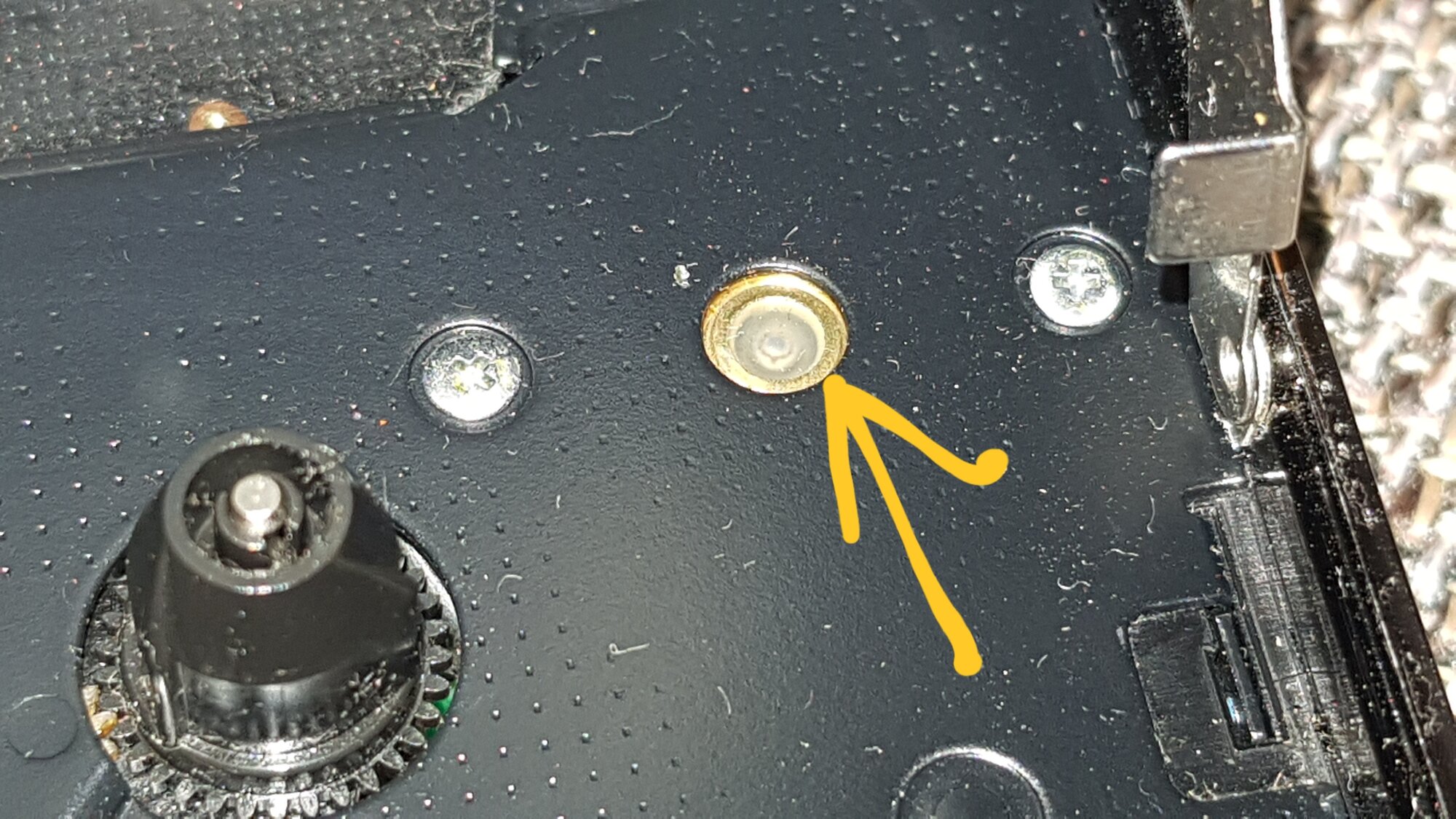

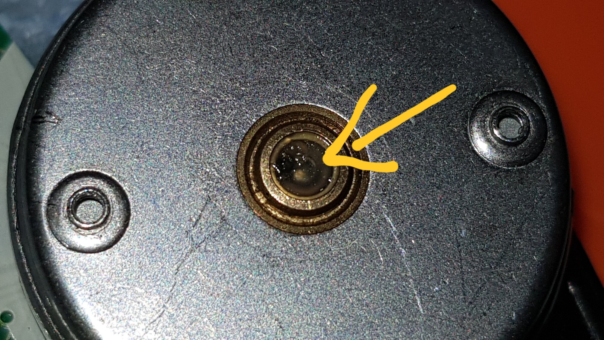

    I was under the impression that injecting watch oil through the plastic membrane on the other side of the motor would lubricate the shaft. Am I wrong? See attached pic.
    That part of the motor is even made easily accessible from the outside without having to disassemble the Walkman. If not for lubrication, then what would be the purpose of making it easily accessible?
  3. Valentin
    2,092
    That plastic membrane is part of the bushing, it's there to keep the motor shaft at the correct height.
    Don't know why on some motors it is made of transparent plastic, but it's not for oiling.
    Piercing it to add oil will alter its geometry and also oil will tend to sip out through that hole.
    Unfortunately there is no other way to oil the motor apart from disassembly.

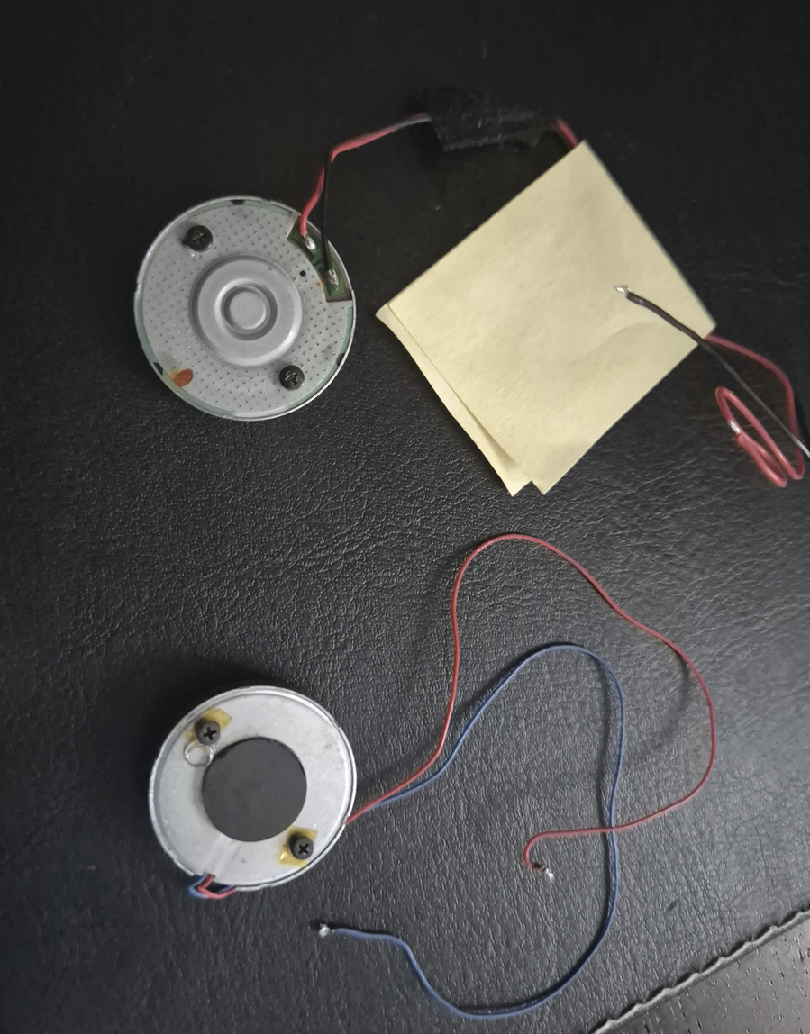

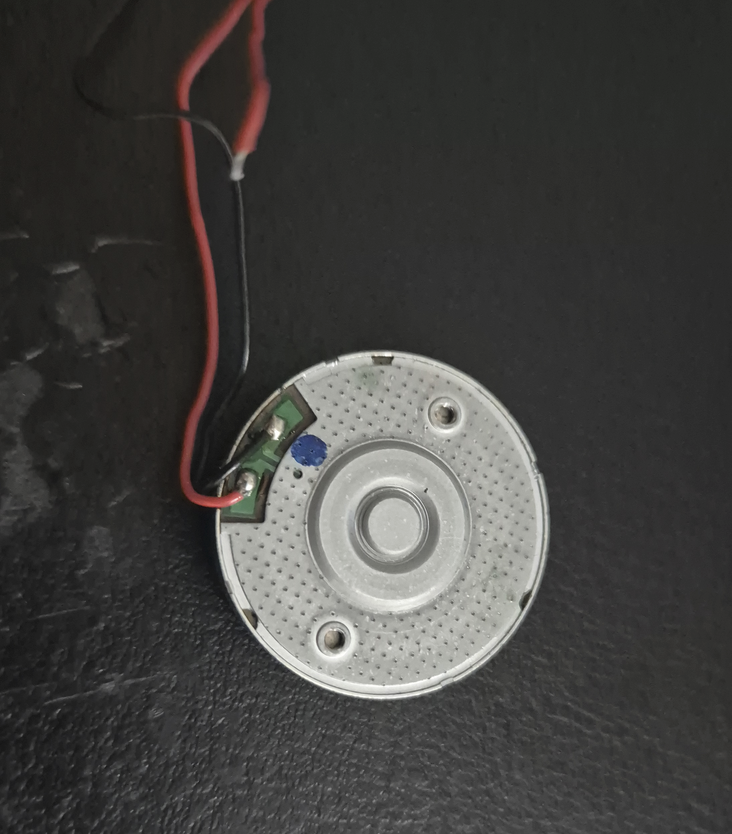

    I'm trying to disassemble a (spare) WM-150 motor to see if I can potentially reduce the noise it makes when spinning, but I simply cannot figure out how I am supposed to remove the cover? There is no gap whatsoever that even a craft knife can penetrate around the edge:
  8. Valentin
    2,092
    @djsubtronic What you show here is not a brushless 3 phase disc motor, but a DC motor.
    Opening it is completely different and more risky than the type I showed.
    Wasn't aware WM-150 units also featured this type of motor. Do you happen to know the serial of the walkman it was installed on ?
    To disassemble a brushed DC motor you first need to remove the pulley, then remove rotor + brushes as a complete assy (think back cover is part of that asstly) othewise brushes can be damaged.
    Same goes for putting it back.
    The back case is stamped in a couple of points. Generally I recommend against opening such motors.
  9. djsubtronic
    djsubtronic Member
    71
    @Valentin Thanks for the reply, I assumed these were brushless as well. I can't remember the serial number anymore as I have a lot of these motors that I already took out. Of all the WM-150s I have had, has either one of the below motors:
    There are ones with thicker red+black wires soldered to the outside - I found these mostly on units from Japan/later units. Then there are the thinner red+blue wires that go into the housing. I found these mostly on UK/older units. The blue ones tend to run much quieter. I have yet to see a WM-150 (out of at least 11 or 12 units I have worked on) that has not had one of these two variant of motor. The WM-150 doesn't have a servo like the WM-2091 version for example.

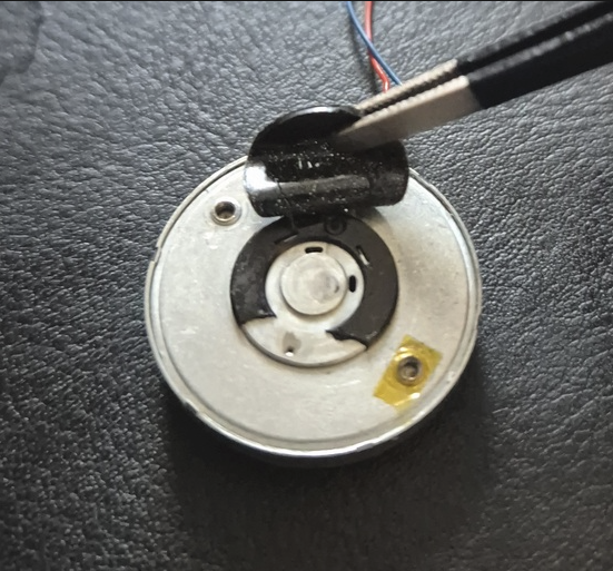

    I just thought I would respond here in case it helps anyone else. I used a spare motor to see if I could get oil closer to the middle (where the bottom bearing would be) without putting into the wire hole and hoping for the best, so I attempted to remove the black sticker on the base. Turns out this is actually a rubber ring with a flat sticker on top. In the case of this spare, the rubber was accidentally broken in one section but I dont think this is consequential in any way. However, with a bit more care, the sticker alone can be peeled back to reveal the central part of the motor. Underneath, there are two holes near the very centre of the motor. I have a picture showing this, but the site is currently erroring when I try to attach so I can try attaching a pic later on. In any case, I applied small drop of oil in both the holes and then ran the motor for a while. I did this on Friday (4 days ago), rebuilt and recalibrated the device, and since then I have played the device for over 8-10 hours per day. The speed has been fully stable so far, so I think the oil hit where it was supposed to, and this is indeed the right solution to the stability issue I described above @Valentin.
    One thing to note - this sticker + central holes only exist on the older style motor with blue+red cables, not the newer one with black+red cable.

    Thanks - it was actually only around 500x500, I think the forum had bugged out for a while. Here is the pic:
    You can see two small openings, which is where I oiled.
    Valentin likes this.
  17. Valentin
    2,092
    Seen this design before, bearing can be lubricated through those holes.
    Ideally the motor should be kept with holes up when oil is inserted so gravity naturally guides it into the bearing.
    Bering itself is right it the middle, so the oil has to flow a couple of milimiters to get there.
    The best motor design when it comes to lubrication are the ones that have the hole near the middle, although this design makes it doable too.
