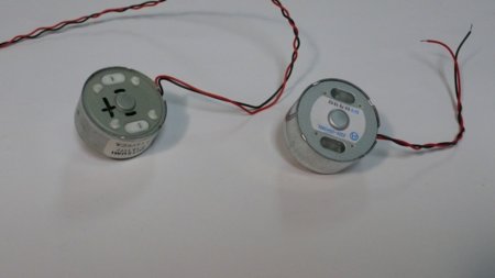

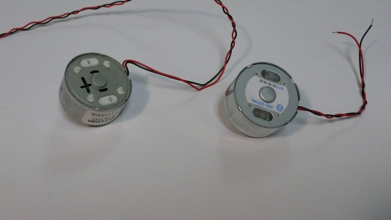

  5. Jorge
    1,785

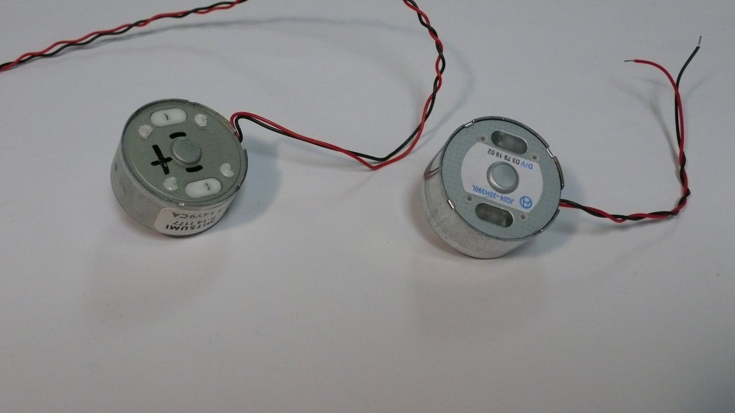

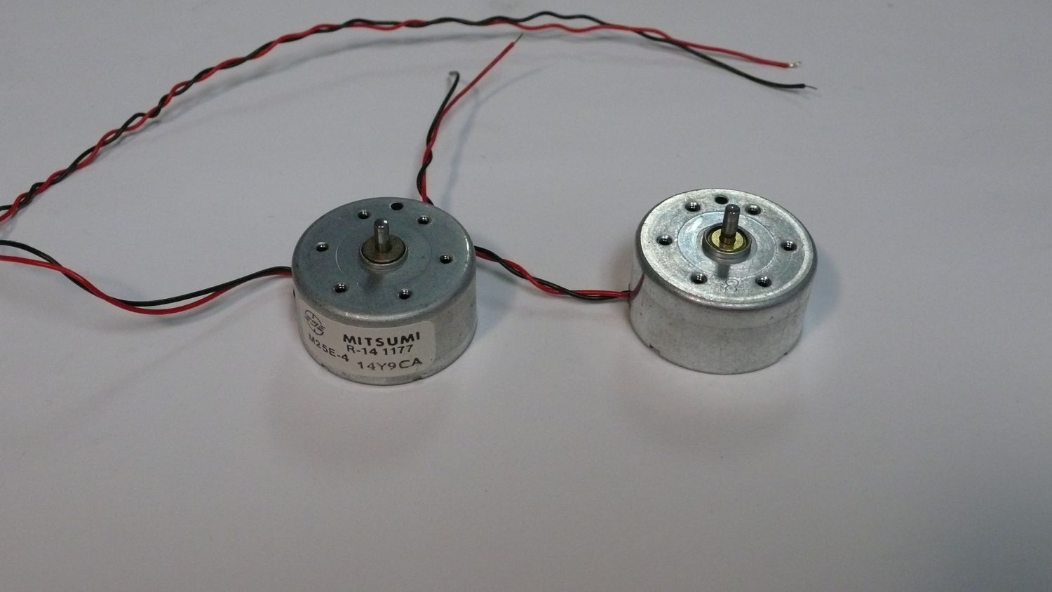

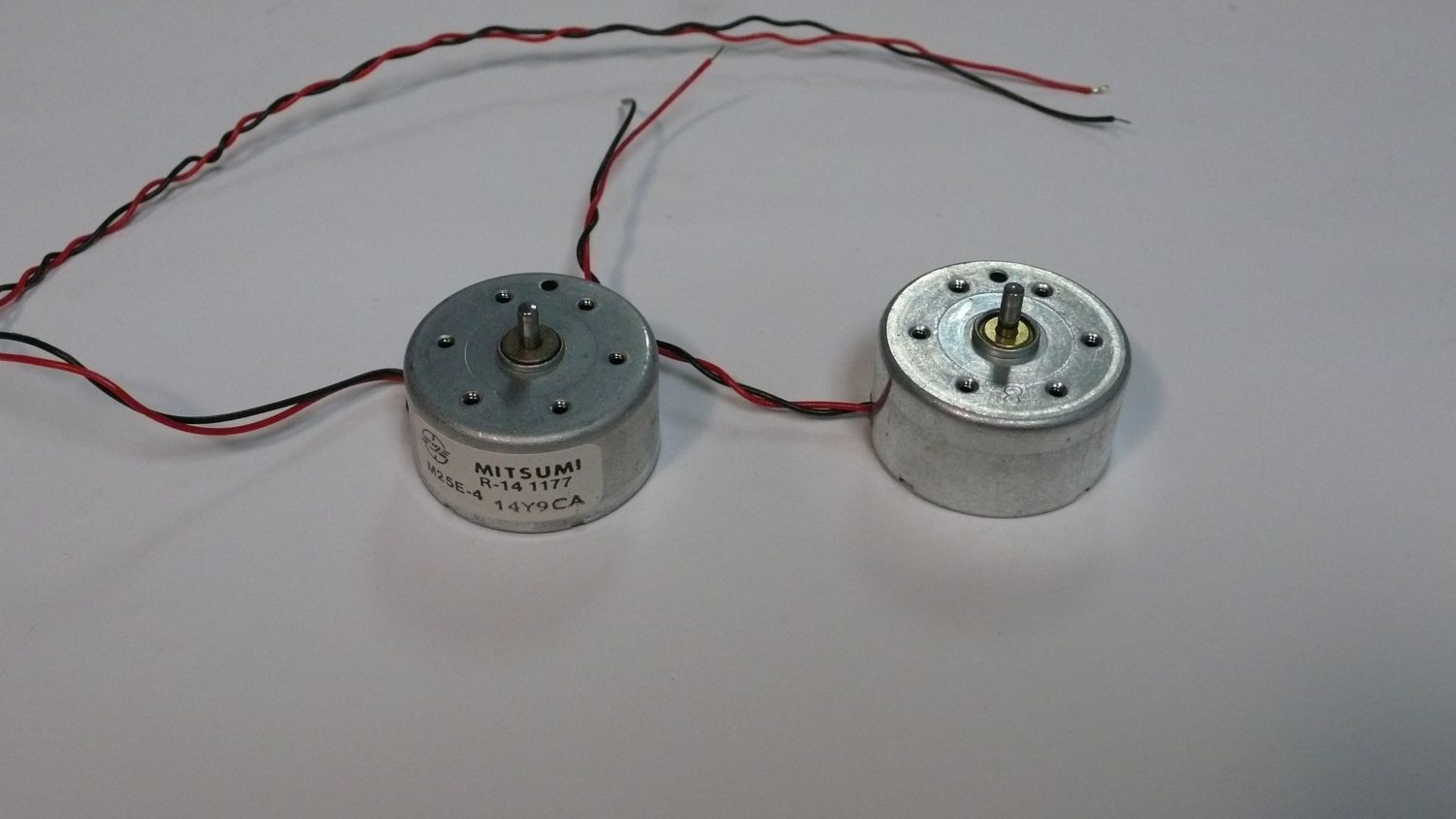

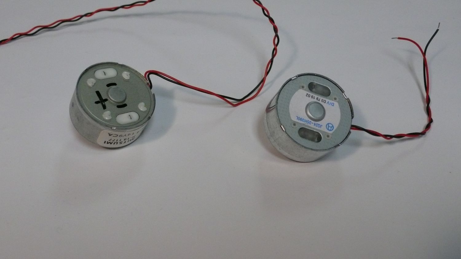

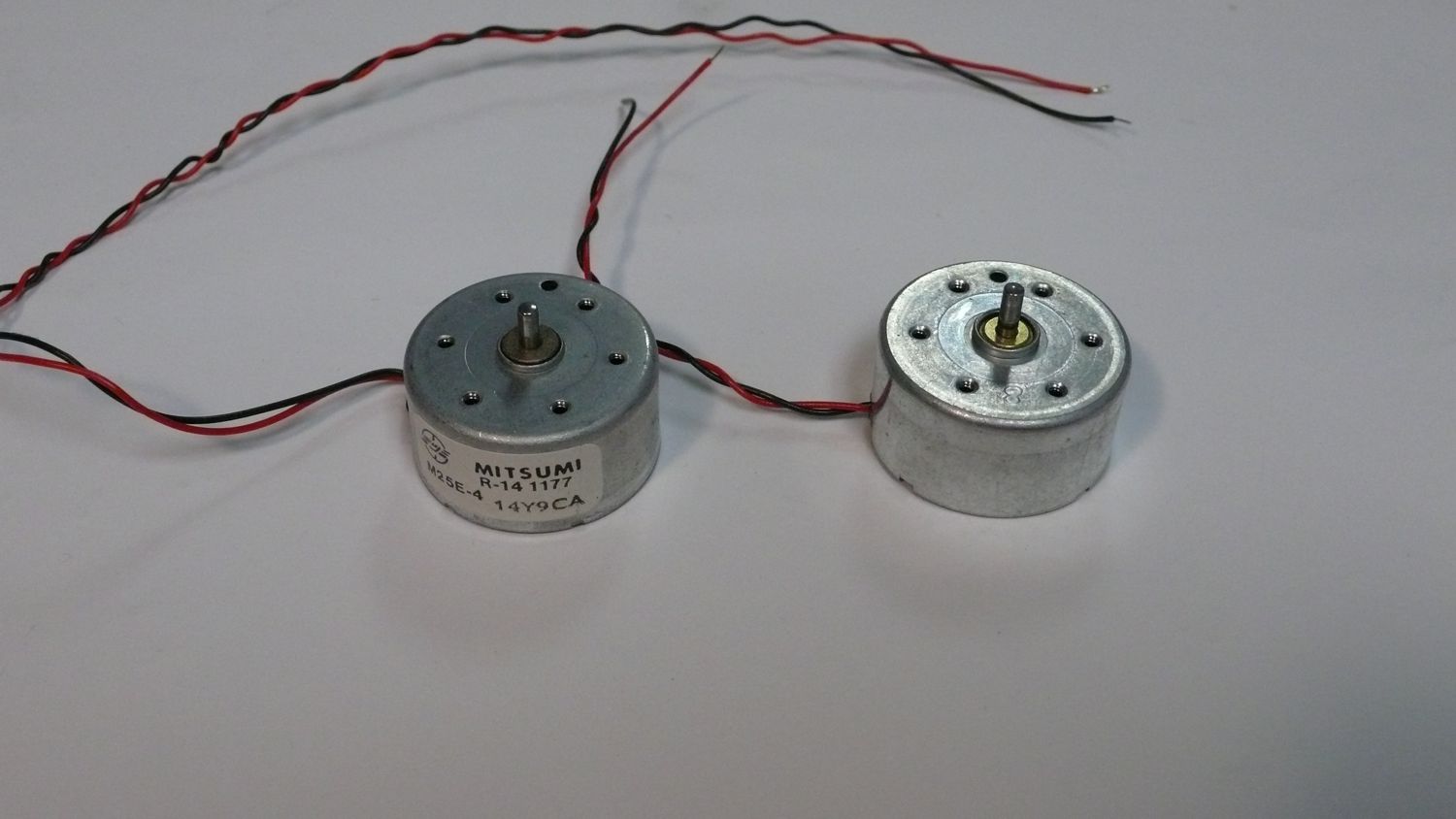

    I use these: Mabuchi RF-300CA Shaft is 0.5mm longer than the original but fits perfectly, no need to shorten it. Just extend the wires, reset the platter and you are all set! I used to buy RF-300 with longer shafts and then would cut to exact 'Sony' size with diamond Dremel cutter wheel but the pains of sealing the motor so that metal shavings won't get to it do not justify the end result ;)
    Few photos of the motors: the original (Left) and from the link above:
    I posted a few photos on 'how-to' at my hobby-site here: Sony D-90
    If any Questions, just ask!... and Good Luck!!!

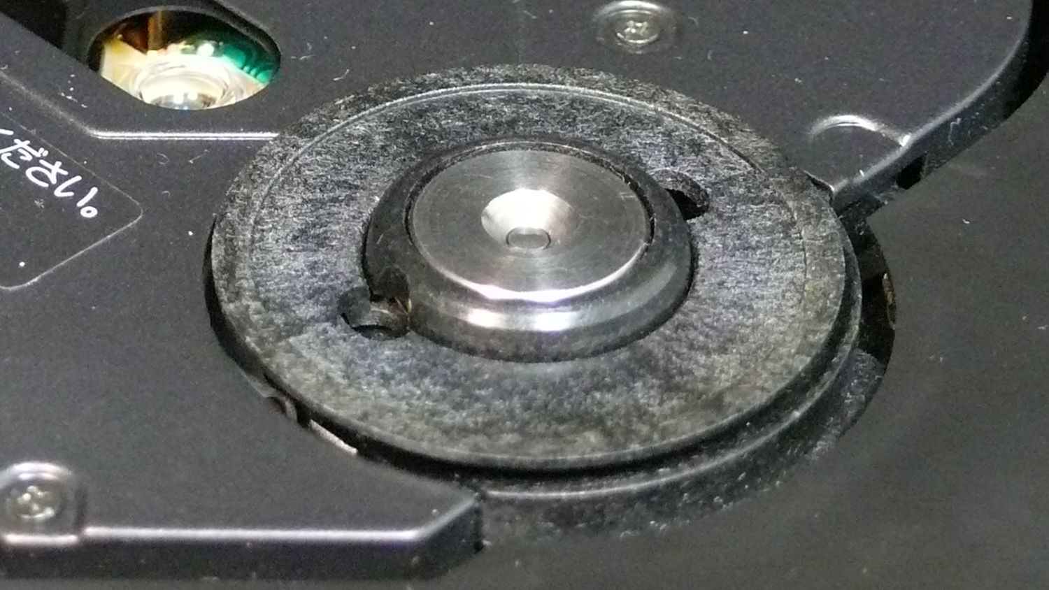

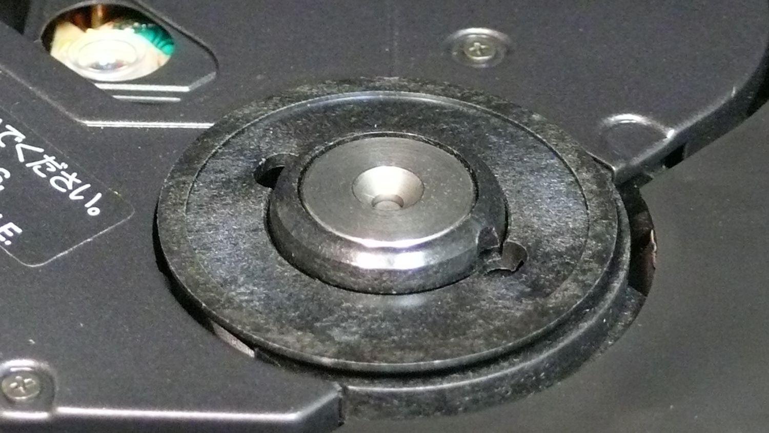

  7. Recaptcha
    Recaptcha Well-Known Member
    356
    Wow, thanks a lot! That looks to be very easy to do. I just ordered a few for my d-9's. They work great, but only if you can get the spindle motor to stop popping and clicking.

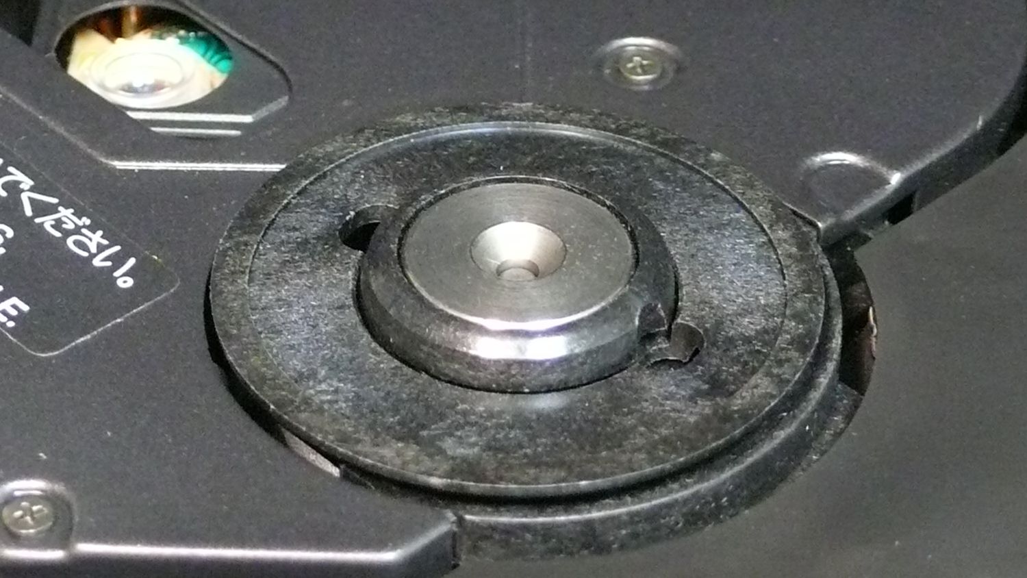

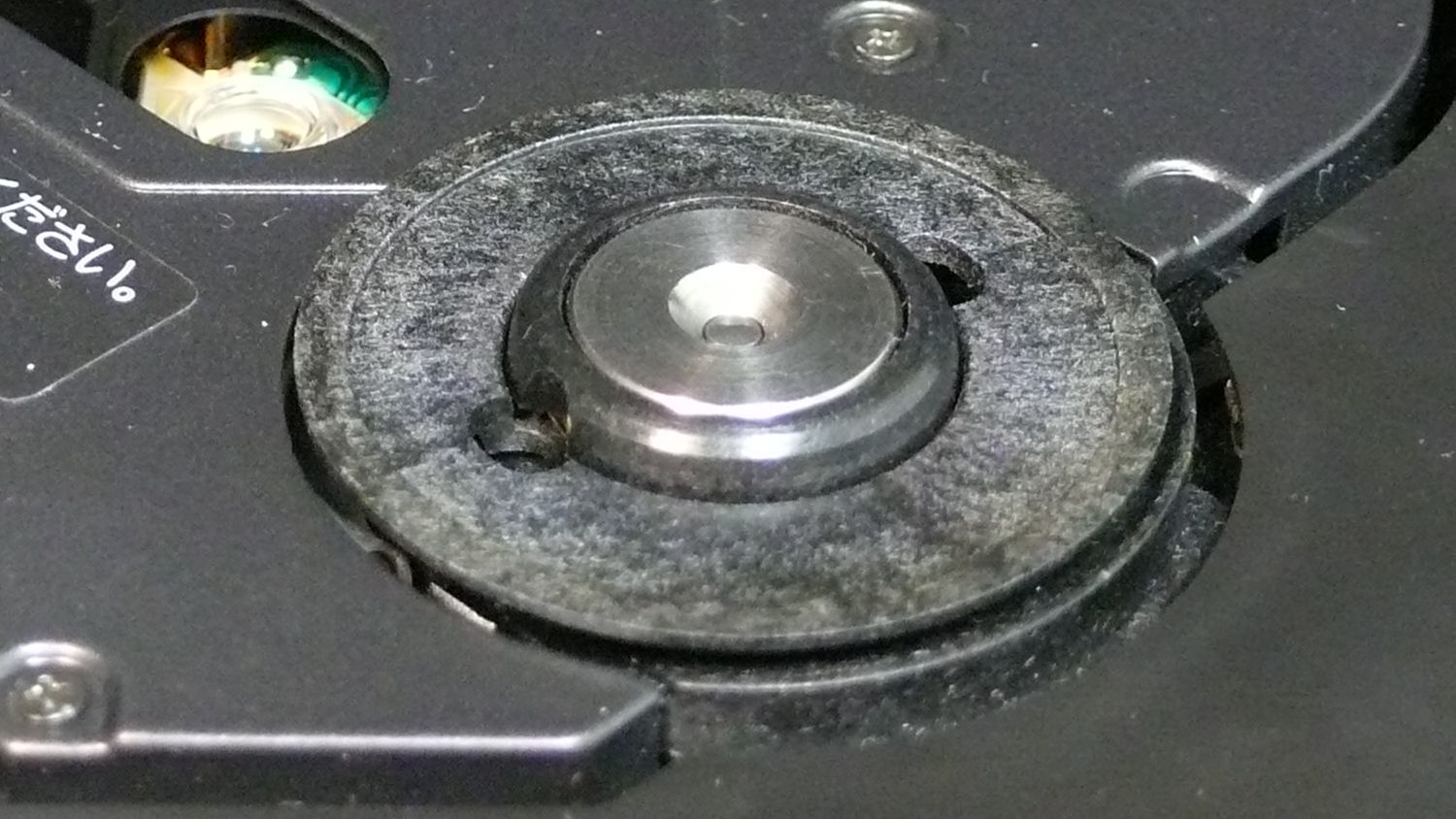

    Any good tips for getting the platter off?
  8. Jorge
    1,785
    Two medium-size flat screwdrivers (old-skool screwdrivers of course, not the ones with interchangeable bits!) on both sides under the platter, all the way to the brass center, then gentle but powerful push.

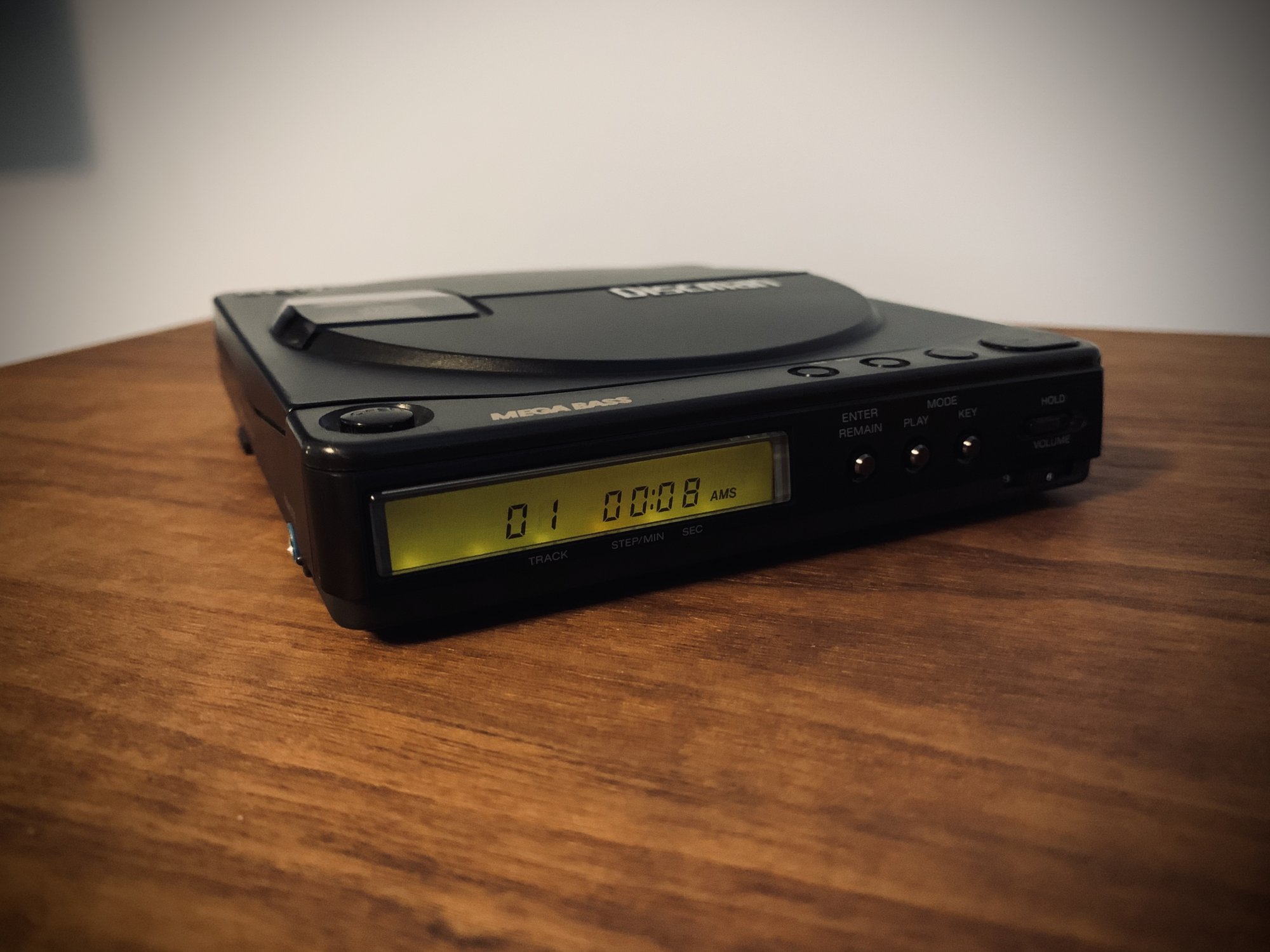

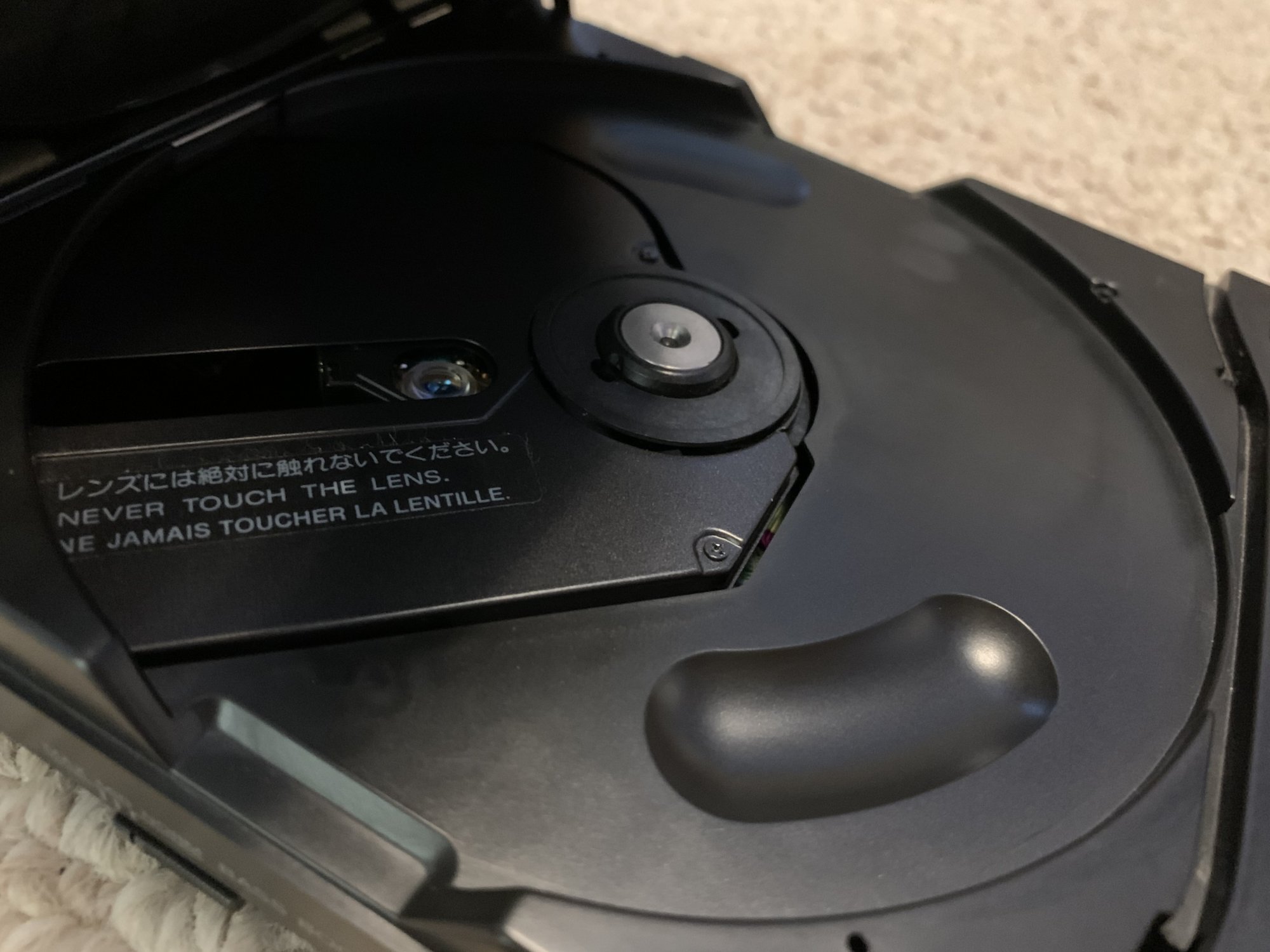

  10. Recaptcha
    356

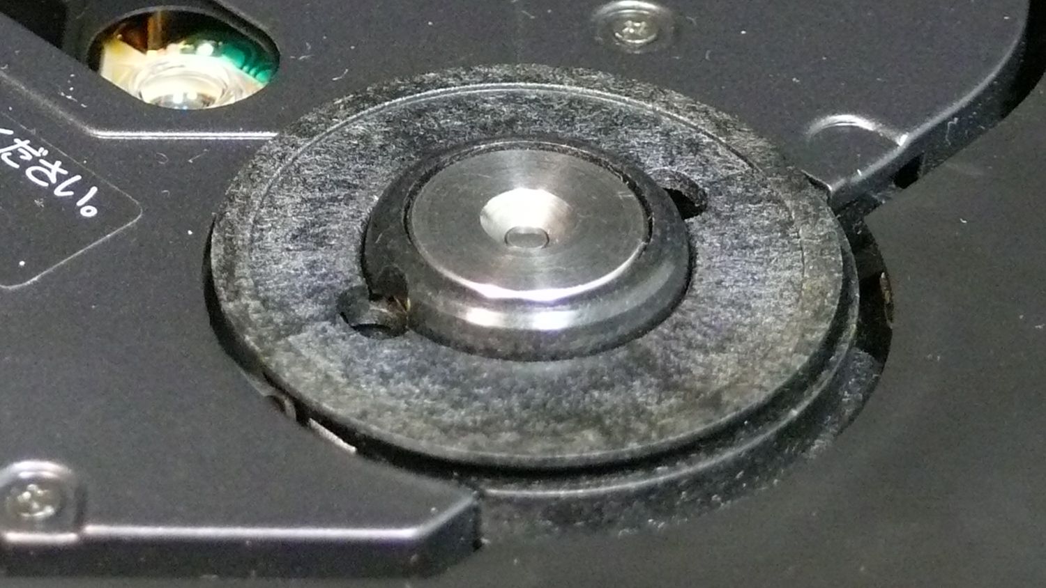

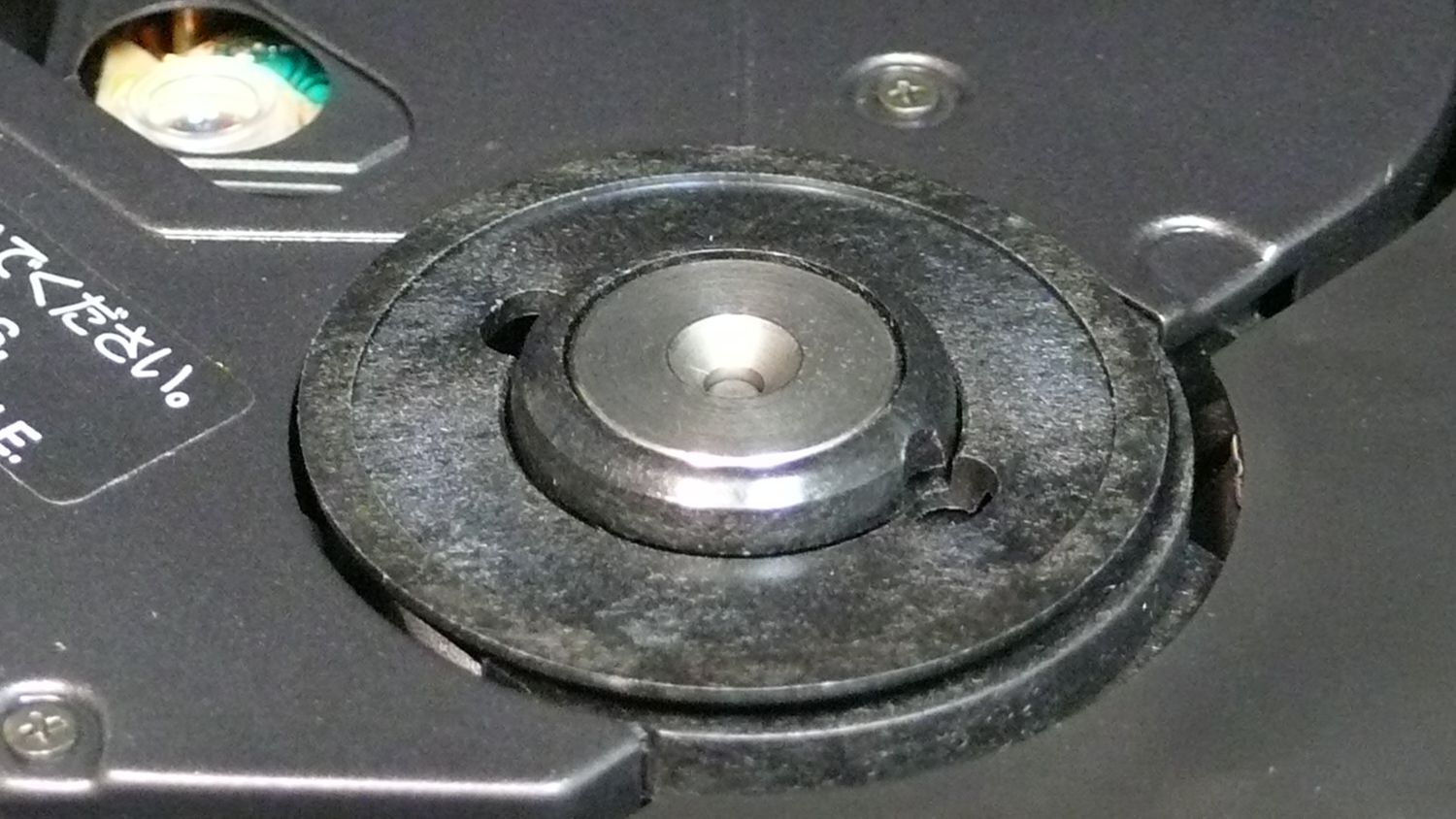

    OK, I have removed the old motor and successfully removed the platter as well. Yes, I do have a template for the platter so I will know how far to put it on the new motor. After some quick testing, I found the old motor was super grindy and unstable!
  11. Recaptcha
    356

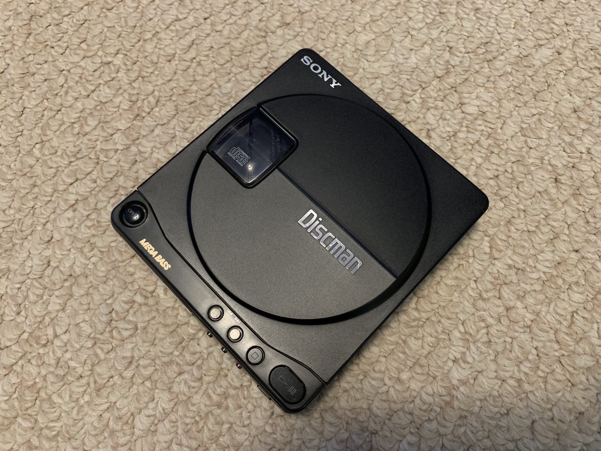

    Ok, GREAT NEWS! I've been searching.... (no, not Chicago), through my parts bin. I found a great Mabuchi 300 motor I had saved. I installed it in a D-9, and Voila!
    It is SOOOOOOOOO smooooooth. What was once skipping, is now completely quiet and stable. I listened to it for about an hour, and hey, it passed the Sussudio test.:applause:boogie:
