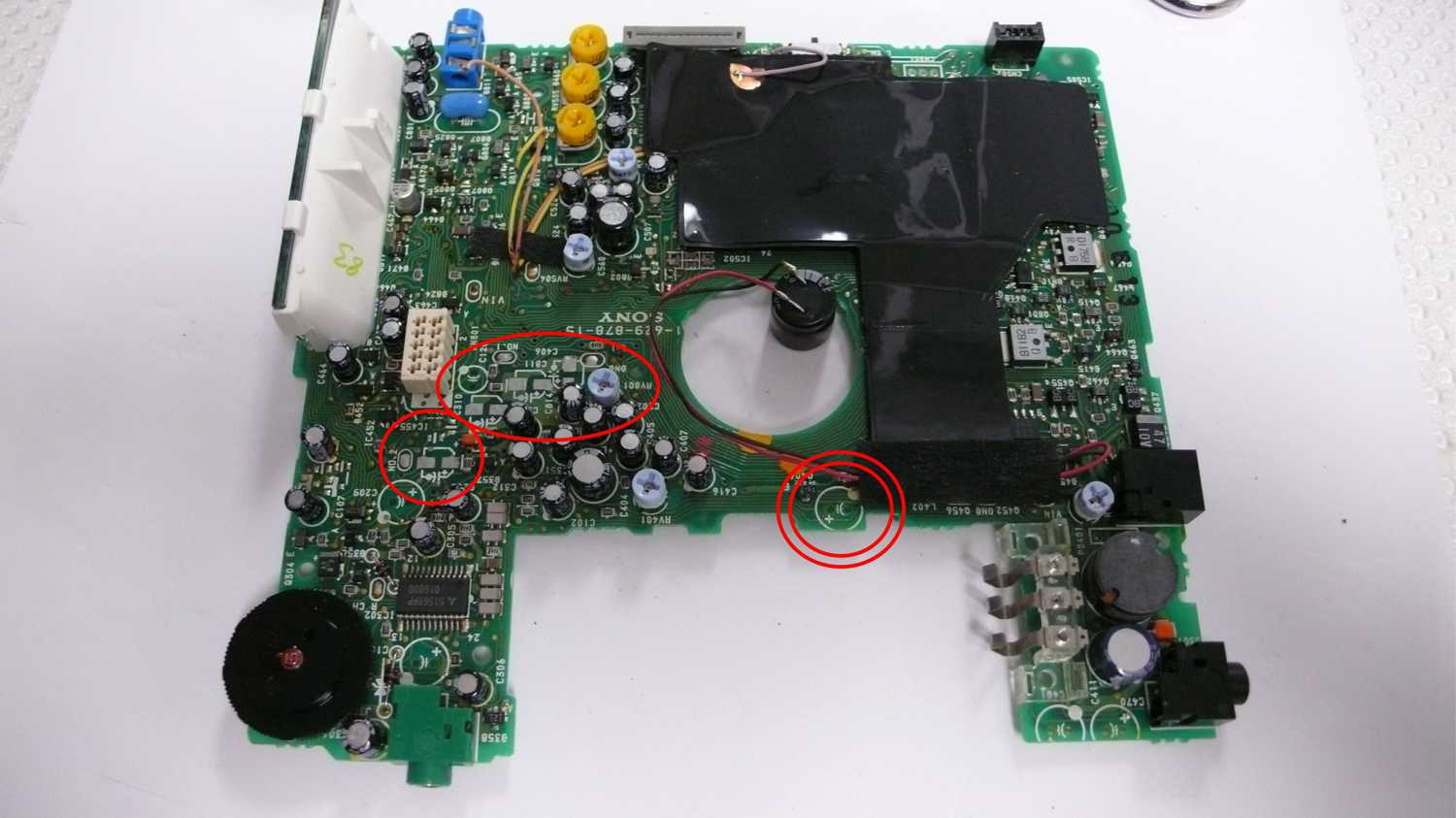

    Great job guys. I need some help! Trying to revive my D-9. Replaced the middle gear and cleaned all the gunk around it. The laser is functioning but I couldn't get it to play. It starts, spins, trying initiate a track and stops and shut off. I'm suspecting some bad caps. If so, which/what should I look for and where do I start?

    Absolutely ALL D-90 have a few caps gone Totally BAD! My tutorial on how to revive D-90 is here: Sony D-90
    Photo of D-90 board being re-capped, with bad and questionable caps already removed:
    I put double circle over 220uF/4V thru-hole electrolytic which ALWAYS leaks and pretty often damages traces and vias around it. 3.3uF and 4.7uF SMD caps circled red always leak and must be exchanged. 10uF SMD is usually solid (that is why the one behind LCD was left alone, but it is next to impossible to solder 3.3uF SMDs back without removing 10uF SMD

    Thank you much Jorge. That's a lot of work...hmm...but then again my D-9 is in mint condition with the original box, foam, unused case still in its wrapper, with everything else, and all paperwork intact! I think it might be worth the shot.
