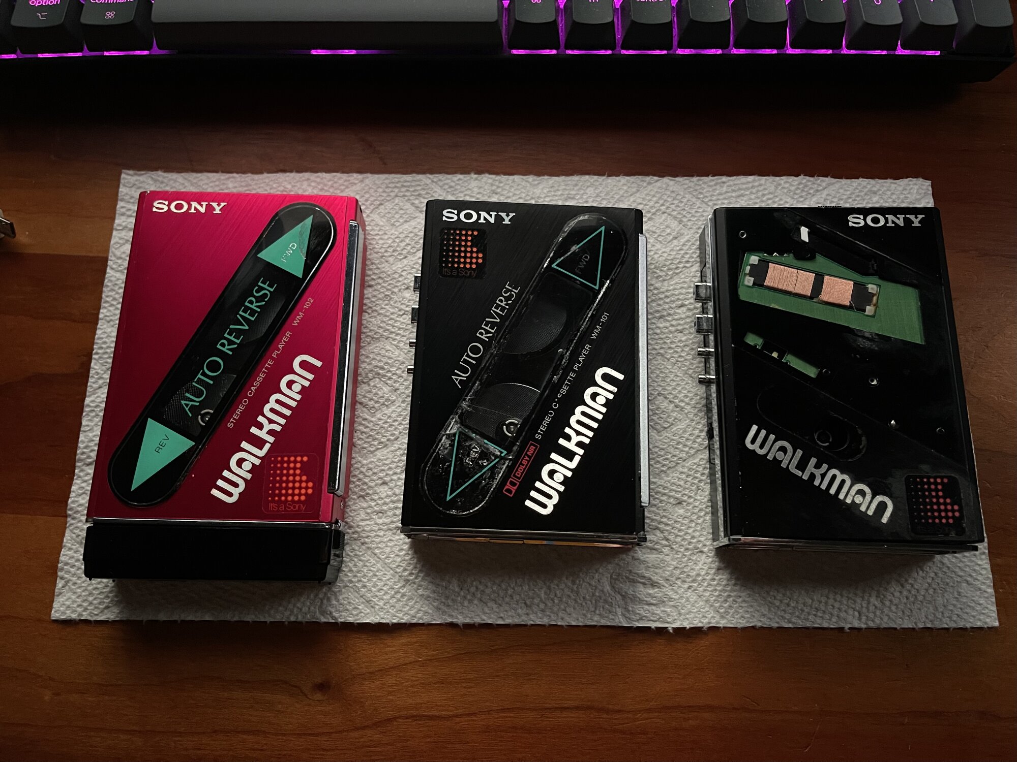

    I have a 3D model of a battery holder for my WM-F100… did all the electrical with either 14 or 16ga single stranded un-insulated wire. If anyone wants the file, send a PM.
    I recently bought a nice red 102 w/o holder and a black 101 w/ holder. The idea was to use the 101 battery holder for the 102…. They are close, but not the same. Does anyone have a file or dimensions or a spare battery holder for the Wm-102 models that they would be willing to share. I have full 3d modeling and printing capabilities and would make sure whatever I come up with for a model is available to the community. These holders are a nightmare to find but the Wm-10* models are my personal favorite portables and it would be a shame if they all disappeared or became unusable because nobody can connect a power source.
    anyway, please help me turn this red beauty into my every day portable (shown with the 101 holder - fits, kind-of…. Not a reliable electrical connection:
    Any help or info would be much appreciated!
    cheers!
  11. Emiel
    1,111
    I can't help you with the request unfortunately, just here to comment that the red one looks amazing!
  12. aepoc
    aepoc New Member
    17
    New York
    Thanks! Can’t wait for it to become my daily user.
