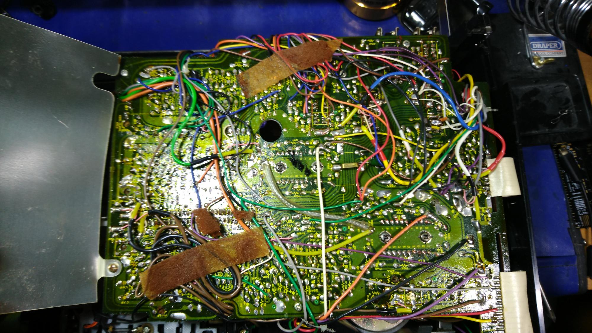

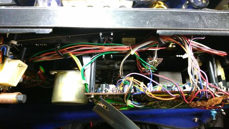

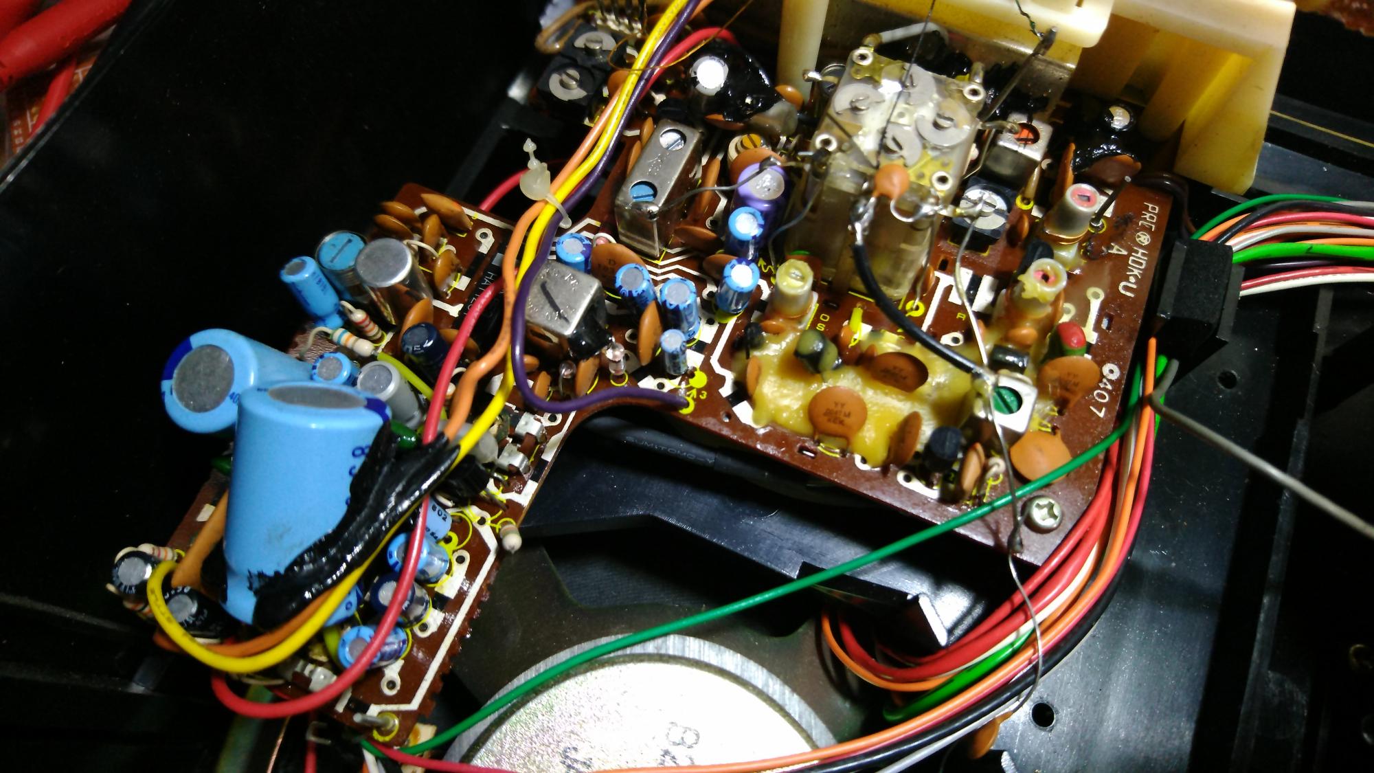

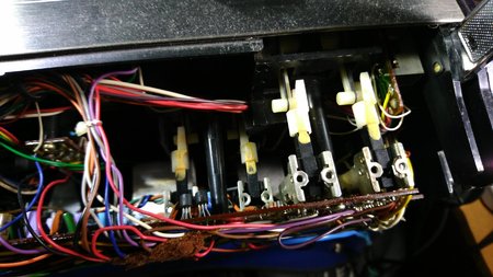

    The first steps with the Aiwa boom box, are daunting. Everything is soldered into everything else. The wiring is a rats nest. The only good thing is that the switches mostly appear to be armatures that go back to switches that are actually on the main board. The tuner is going to be difficult for a newbie like me to work on, and I already know that the caps are going to need replacing on that. I'm dreading removing the main board, because the side sockets are on daughter boards which appear to be connected... but there are also ribbon cables around there. - This is going to be a slow job.

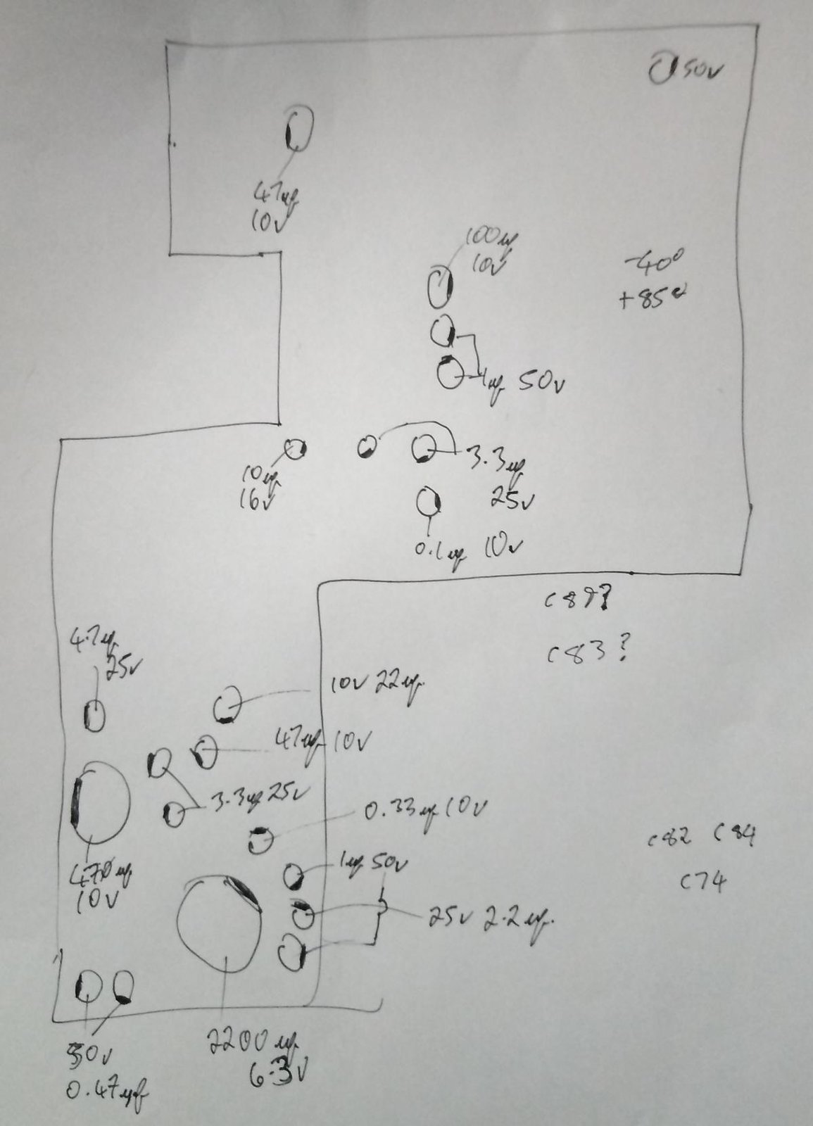

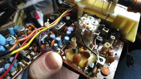

    OK - so... I managed to get the tuner circuit out and I've mapped the film capacitors, but not the ceramics. The question is... should I replace the ceramics as well, or is there no point? There's a lot of them.

    nope, ceramics and films rarely need replacement. All out electrolytic replacements are only applicable to walkmans, as there are relatively few, and they tend to leak and go bad faster than larger types in other products.
    If the box sounds good, and does not have very obvious capacitor aging issues, I don't recommend recapping it.

    I looked at the construction of the ceramics, and I thought that they'd likely be fine, but that was a pure guess. Unfortunately, there are issues with the radio not tracking, and a channel is out, which is most likely the amplifier... so I'll just leave it at replacing the electrolytics. I've also noticed a few links broken on resistors where the leads were bent tightly, so those will need replacing anyway.

    Channel out is usually a bad radio/tape switch, not capacitors. Radio is usually due to alignment of some sort. Random replacement of parts usually is a waste of time of money, it's better to find the causes.
    Replacing random capacitors is not the answer to random problems! Unless it's early surface mount types...

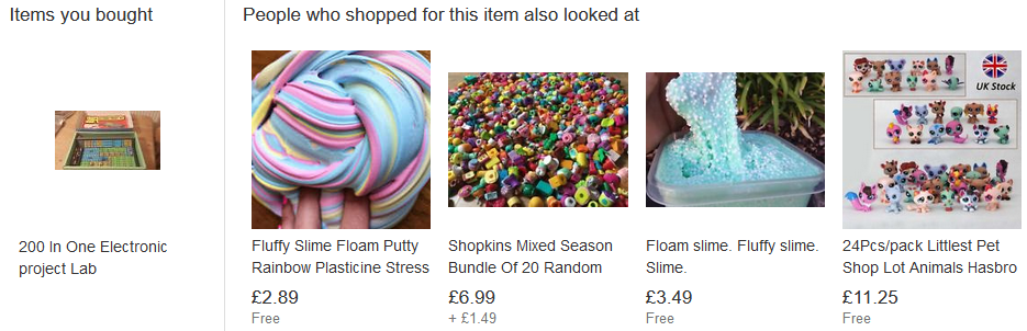

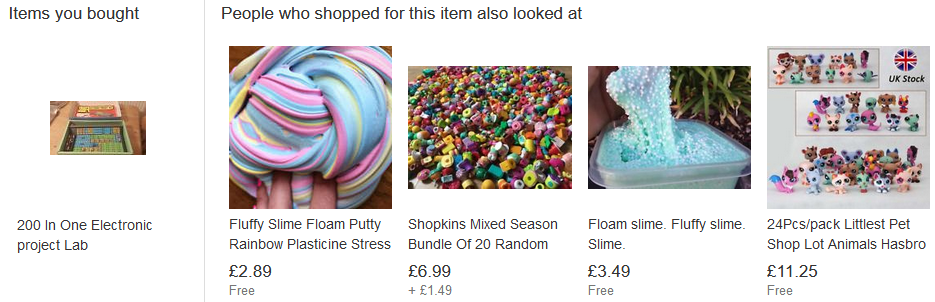

    The good news is that I secured myself a 200 in 1 electronics kit. However, the "People who bought this also looked at..." feature, has me concerned about the kinds of people who are learning electronics these days...
