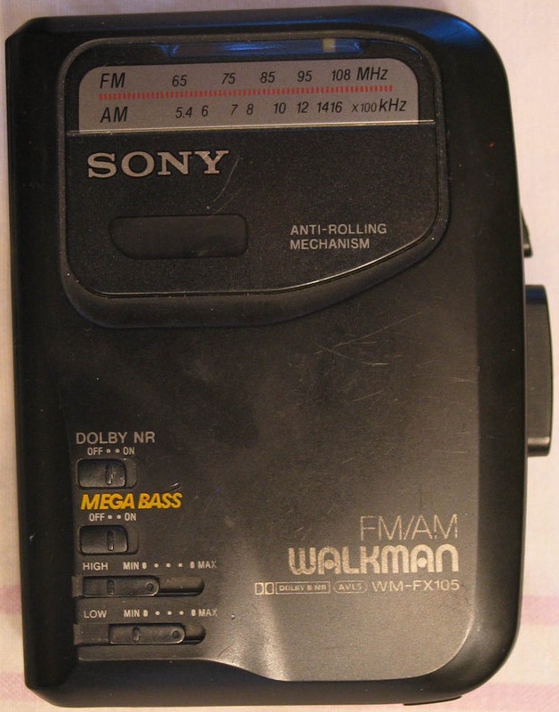

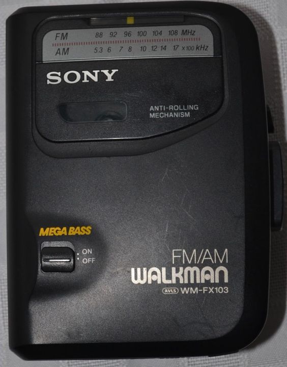

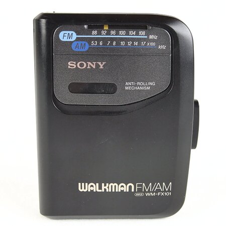

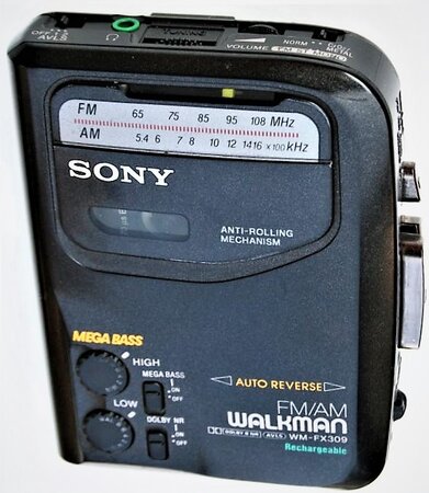

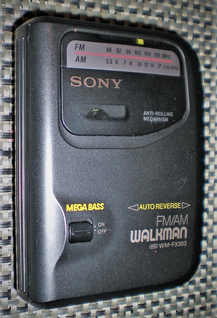

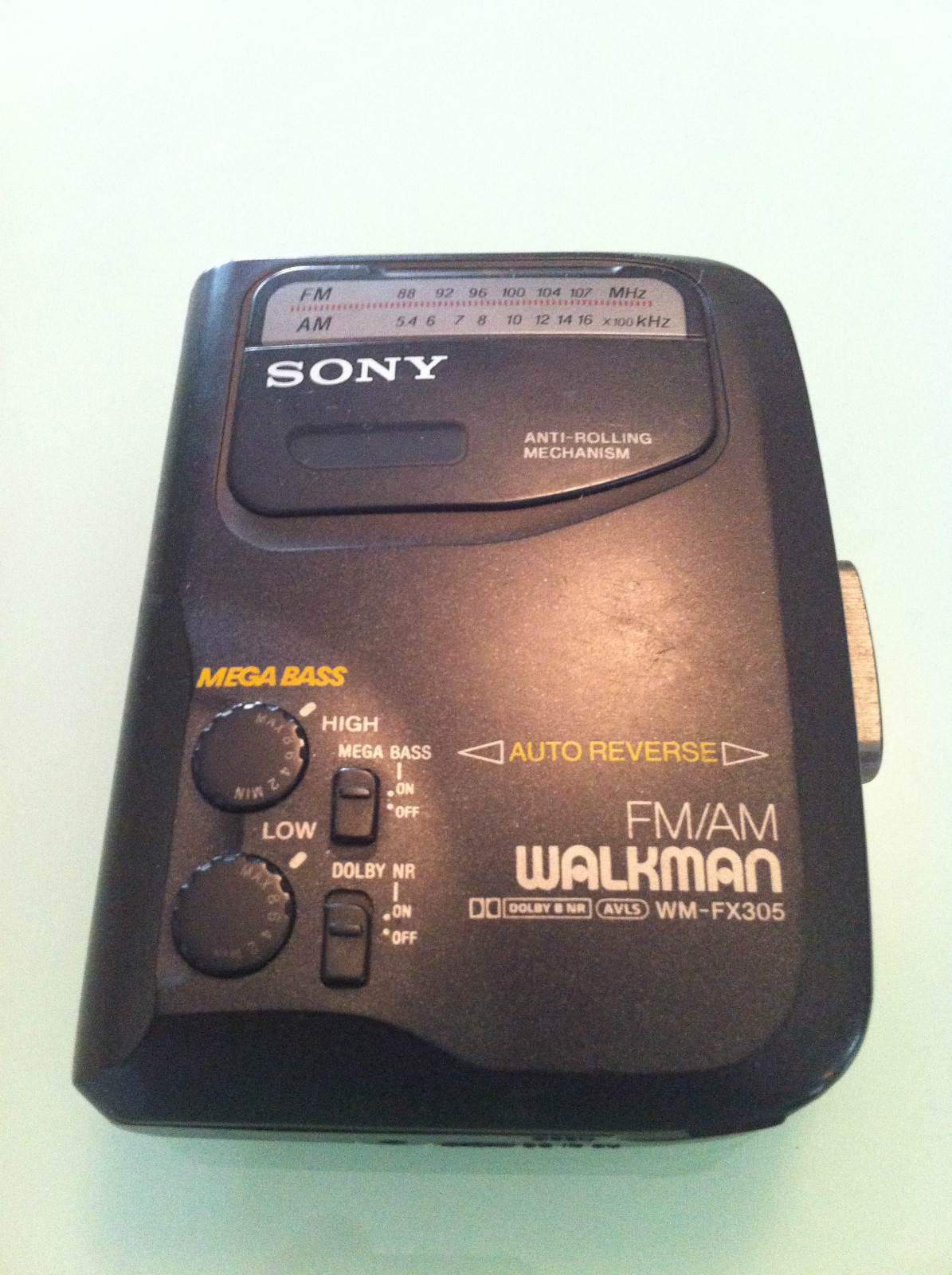

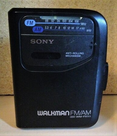

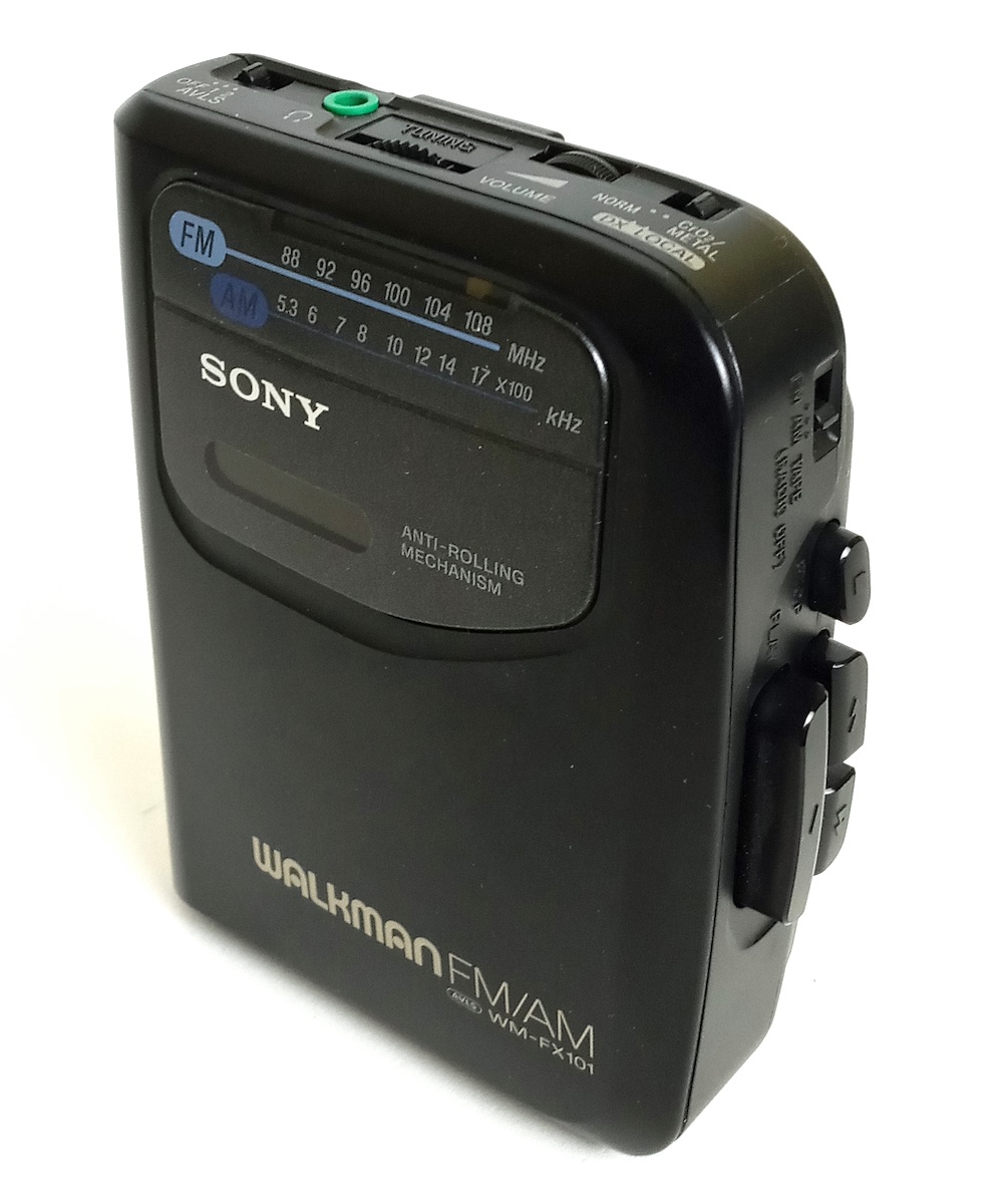

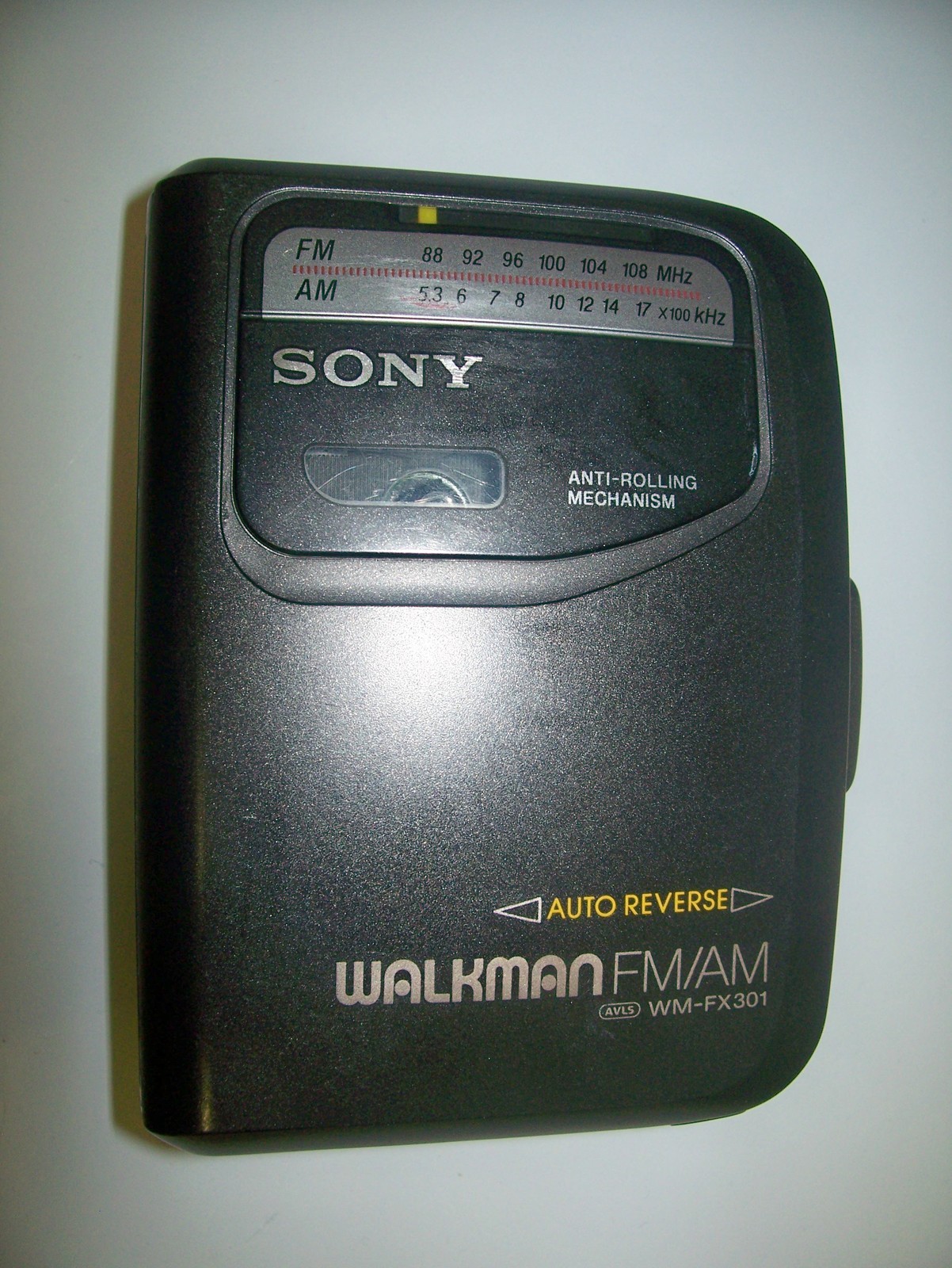

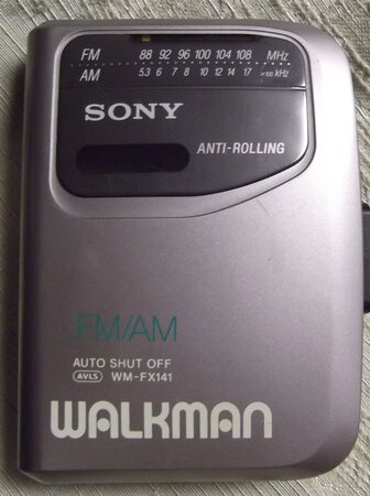

    In 2014 I compiled a photo list for this series to help organize my collection but the list might missing some models and/or versions :
    Kant and CDV like this.

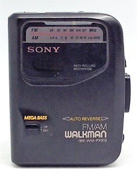

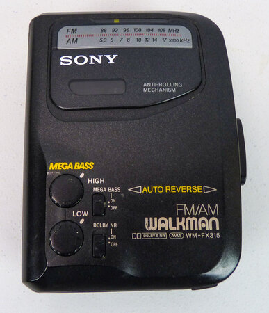

    I think I already mentioned in another thread, that I think that Sony made too many different models that are not different. Your photos are a case in point: what is the difference between the FX305, FX309, FX315?
    The FX309 says "rechargeable". Does it mean it simply came with rechargeable batteries that can be swapped with regular non-rechargeable? Does it mean that when the batteries are inserted and the walkman is connected to a power adapter, it charges the batteries?
    Cannot see the difference between the FX305 and FX315, or between FX303 and FX313. The FX141 looks just like the FX101, but a different color. Maybe the electronics was improved, I saw a version 1.3 in the FX141 service manual dated by 1999. Still, it seems there were more models than a natural rate of improvement required.
    I have an FX101 that I bought 26 years ago, a very basic player, but it still works, does not sound "rubbery", and I haven't even changed the belt.

    FX-305 , FX-309 , FX-315 have minor differences to radio section destined for different markets. FX-309 was also equipped with rechargeable battery .

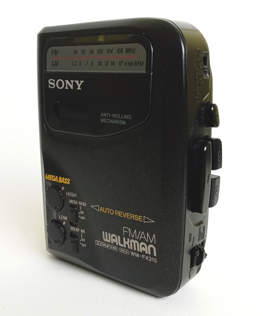

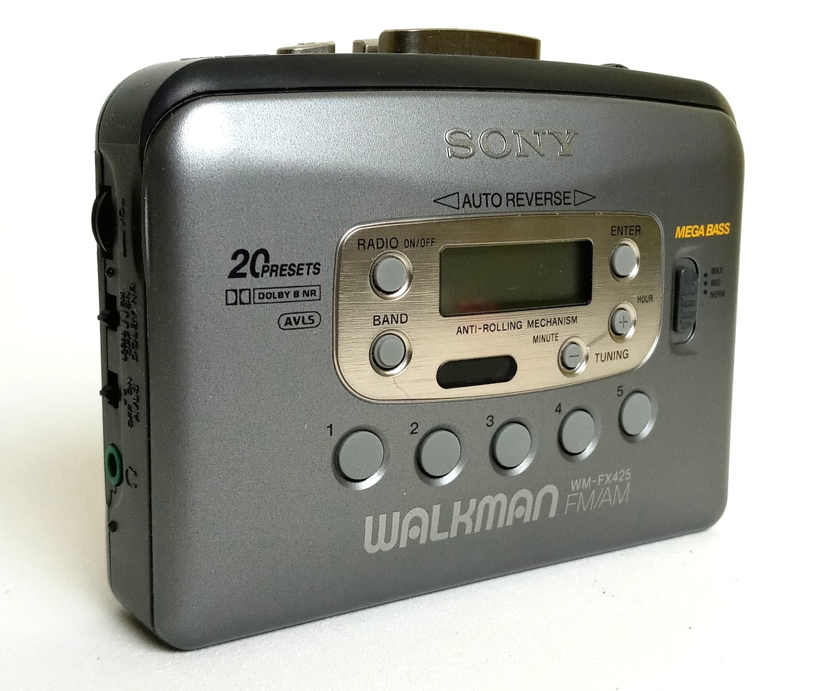

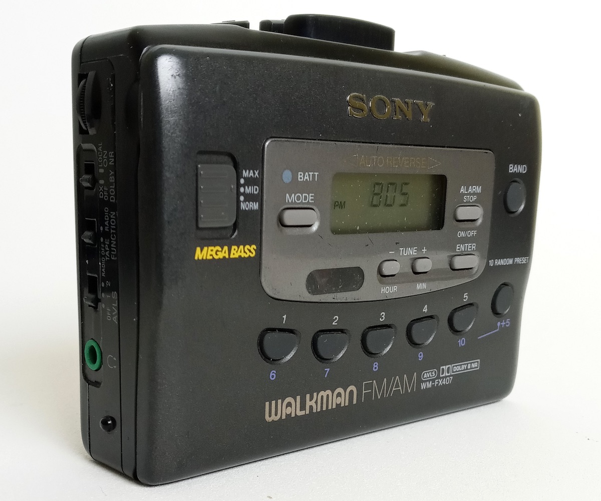

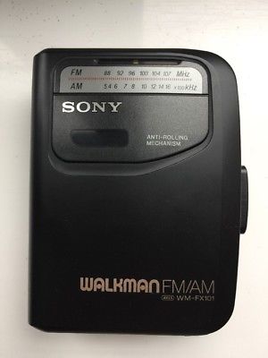

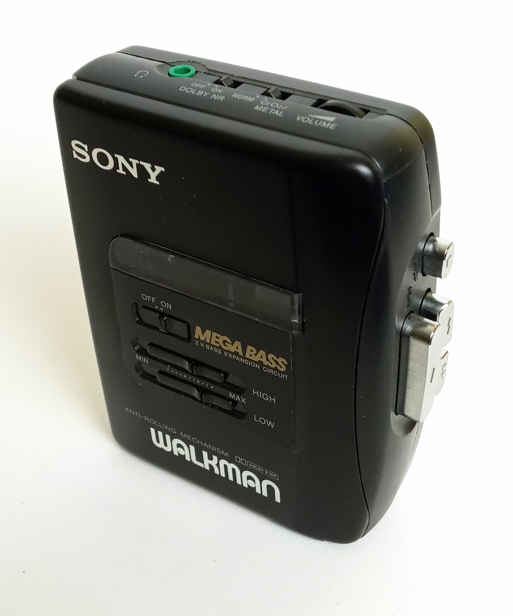

    Here are the photos of the 1990-1999 generation.
    WM-EX19: single direction, no radio, Mega Bass, two-way tone controls, Dolby NR.
    WM-FX101: single direction, manual radio.
    WM-FX315: auto-reverse, manual radio, Mega Bass, two-way tone controls, Dolby NR.
    WM-FX407: auto-reverse, digital radio, Mega Bass, Dolby NR.
    WM-FX425: auto-reverse, digital radio, Mega Bass, Dolby NR.
    My favorite is the FX407. The FX425 technically is the same, but looks less chunky, also the one I have is noisy, mechanically.
    walkman-ex19.jpg walkman-FX101.jpg walkman-fx315.jpg walkmans-FX407.jpg FX425.jpg
