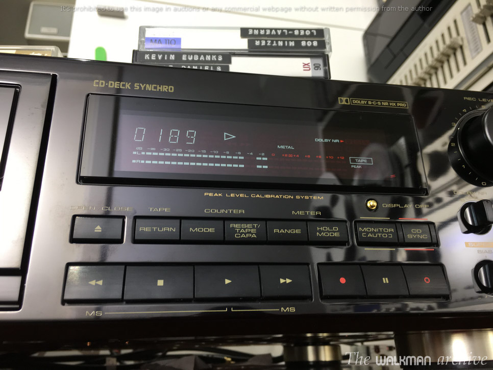

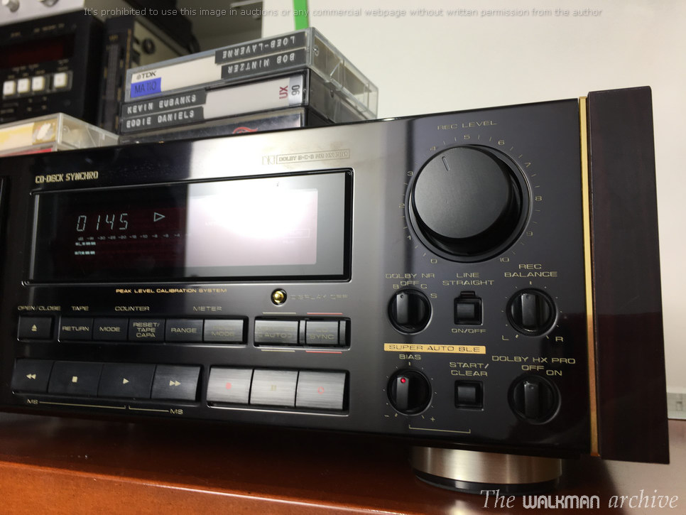

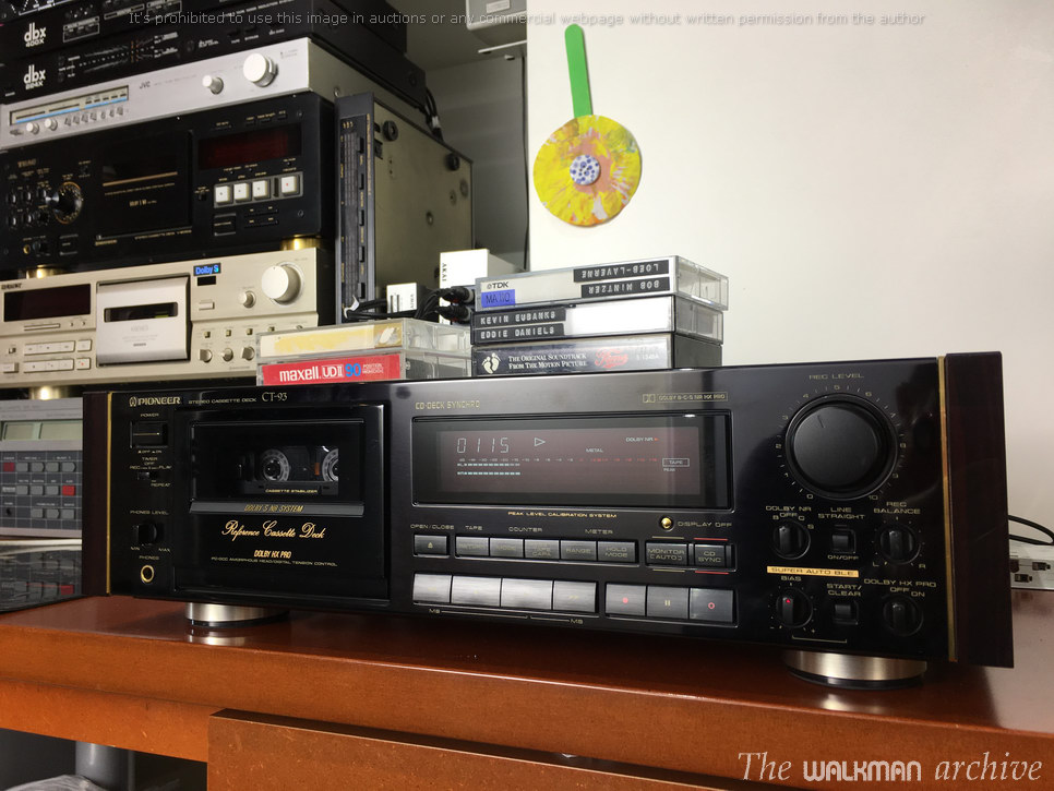

    I absolutely love these decks, especially the HX-Pro that puts them ahead in sonics and recording capability, I also love pioneer at this level... Congratulations and stunning deck.

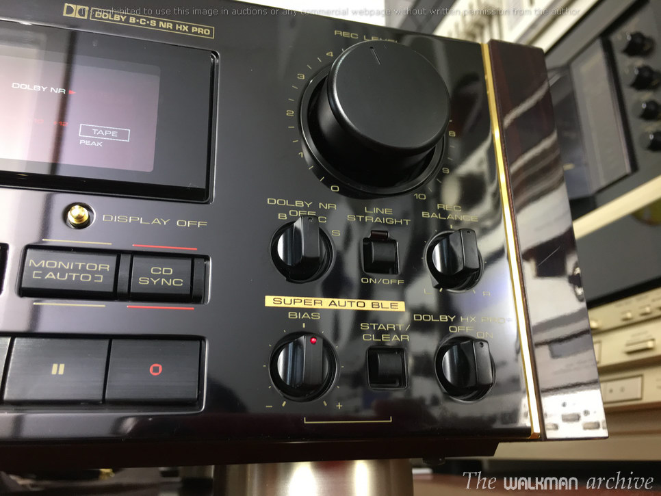

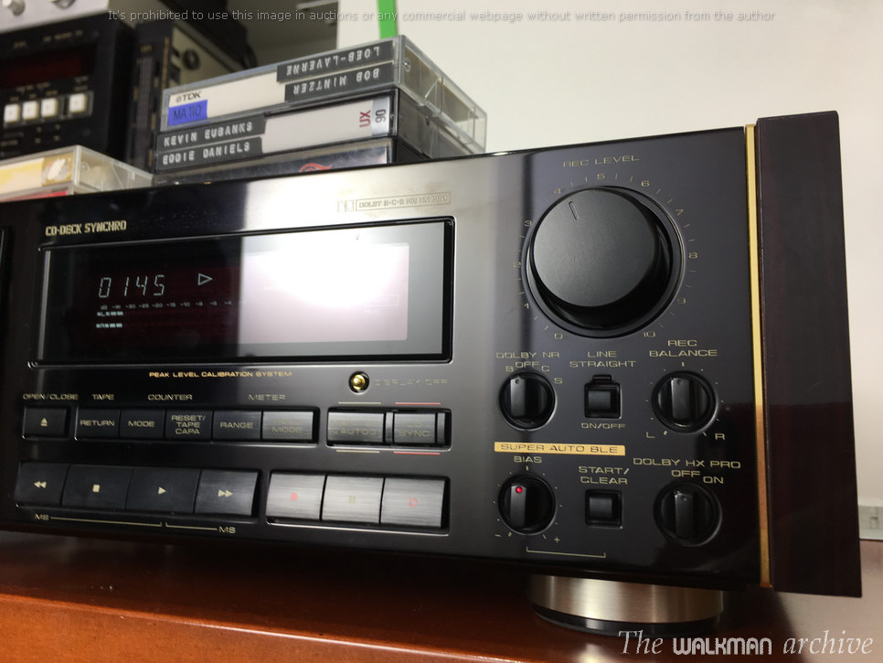

    Yes, it looks absolutely gorgeous. It's piano-like black laquered finish makes it pop against the rest.
    However, the HX-Pro doesn't make a big difference at all. At least, I could not heard it yet. I've did some testing with my K909ES time ago (which also has the HX pro switch) and could not hear any difference. I have to test it again with better headphones and a metal tape (I think I did the test with my GRADO SR325 and an UX-Pro).
    On a curious note: no Nakamichi had the HX-Pro... And I'm sure they could had implemented...

    the HX-Pro only makes a difference to the recording, you can push it to higher level with it, its not the same as Dolby it doesn't affect the sound just the recording levels.... hope that helps.

    I already knew all that; when I said I did testing, I mean I was recording and monitoring the recording and while focusing my hearing in HF, switched the HX Pro on and off to check for differences.
    But even doing that I could not find any in my SONY K909ES using an UX-Pro if my mind doesn't fail to me...
    Yes, HX system in theory improves HF by dinamically adjust the bias in real time, depending on the HF of the music itself. That's because the HF in the music can act as bias signal, and it actually erases itself a bit, so the HF readjust that to get better HF. All that sounds pretty good, but I guess the difference is less than 1dB or so...
