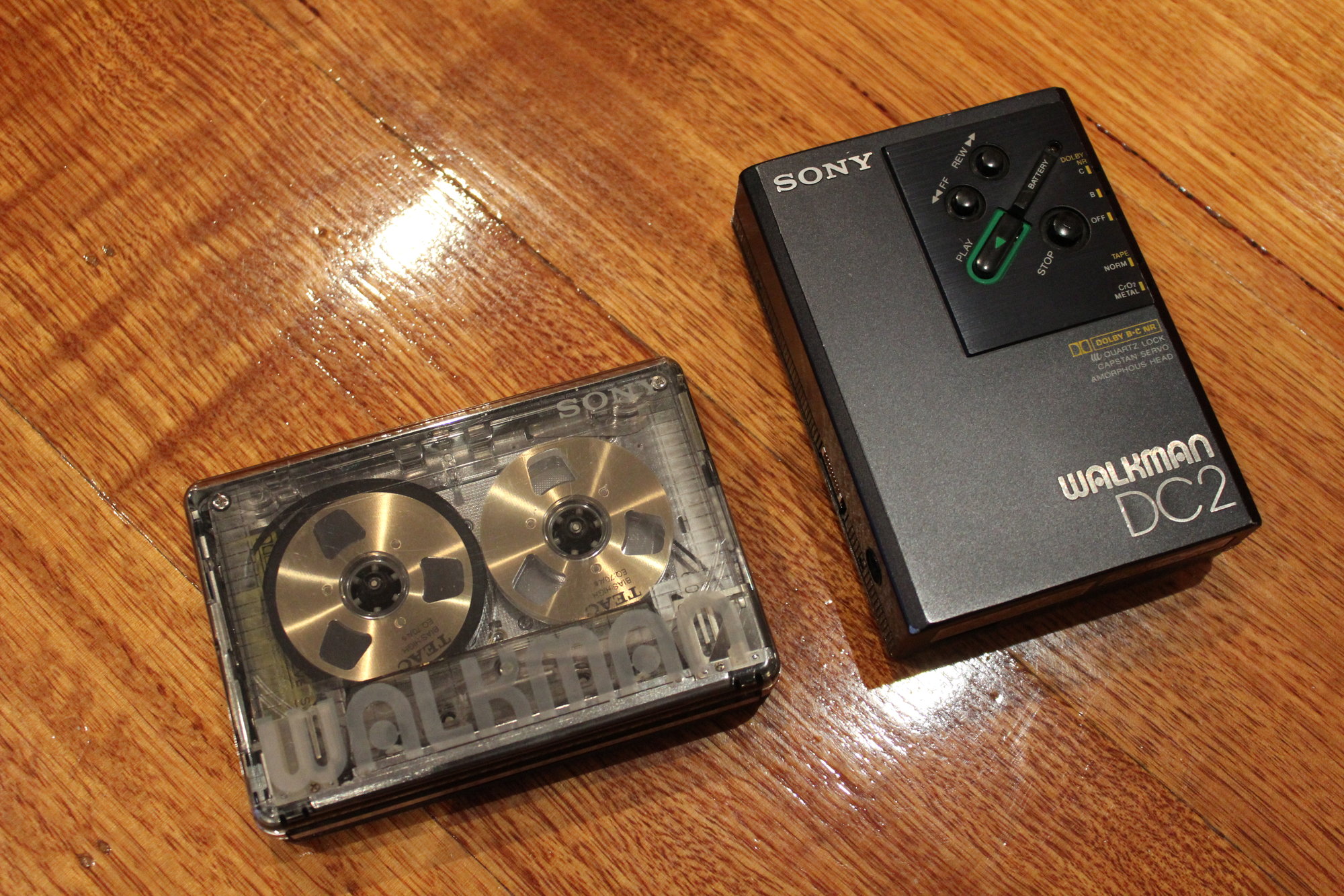

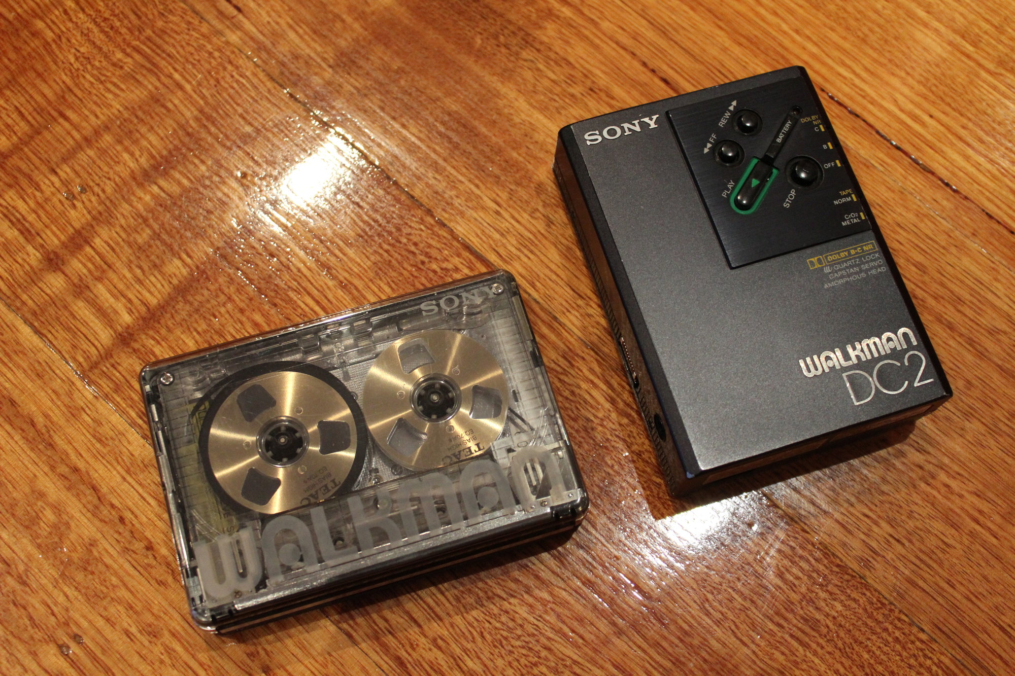

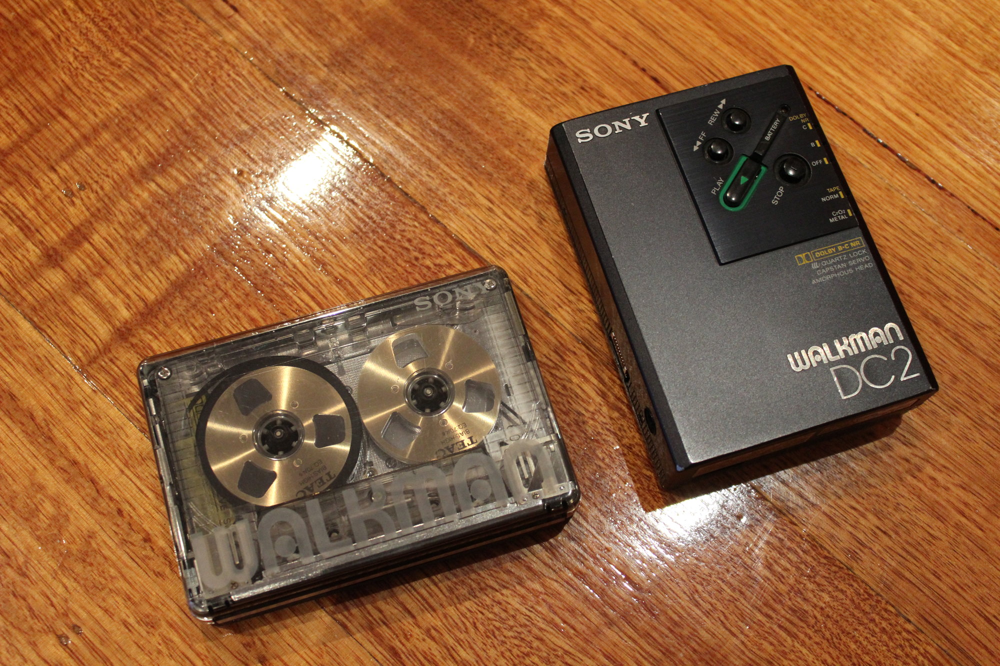

    New additions to the collection or as I call it these days "The pile" :) Finally got a WM 504 in excellent condition. The DC2 also in great condition but the lid will not stay closed. Seems to have some wear on the metal tab on the lid. Need to figure out a way to fix it or find a replacement lid. Plays cassettes but has the clicking noise.
    Patex, ebuy05, ggg12wmdd9 and 2 others like this.
  7. autoreverser
    1,965
    yes !
    congrats to those great units - as much as the DC2 is a "must have", it is not half as nice as the (especially in this condition) rare 504 :reelspin::reelspin:

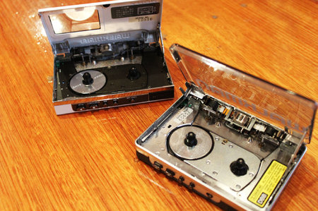

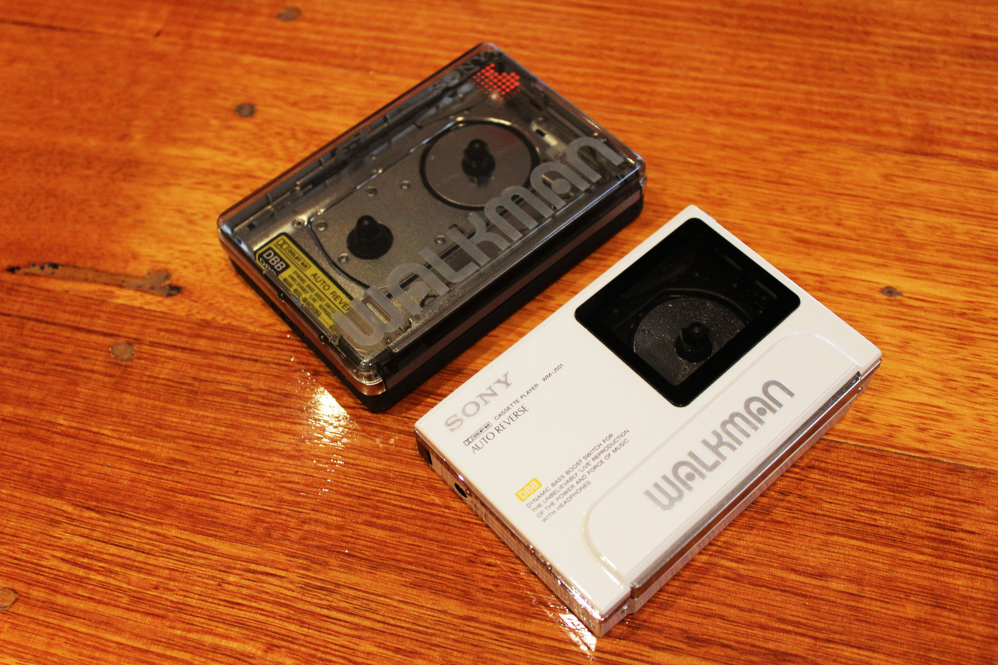

    A pair or rare beauties. WM 504 and WM J501.
    Patex, ebuy05 and walkman archive like this.
  12. Boodokhan
    2,477
    your collection gets better and better everyday

    That J501 looks gorgeous as well!
