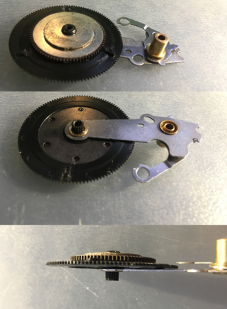

    I did the repair after receiving the gear 2 days ago. The instructions where short, but I thought it looked straightforward enough. I did it on a wm-dd33 and the problem I'm having is when the player is lying flat the screws of the gear seem to rub on the metal part. Up-side-down it's silent. I'm waiting for the PDF with instructions to see what I did wrong, but assembled / disassembled it 3 times now...

    From the image that you sent, it looks that the white gear is installed correctly - side with red dot is down.
    The gear kit is designed in such a way that screws should not overhang plastic gear. There is cavity around the screws holes, 0.3 mm deep. The screw head thickness is 0.35 mm. These are special, custom made screws, with thin and wide head.
    Did you screw all six screws tightly? On your image, one of the screws look like not screwed completely. But may be I just do not see it very well.
    Also, when gear assembly is removed from walkman, check if some of the screws doesn't overhang and also check if plastic gear is attached to the metal ring tightly. There can also be some "dirt" between them, causing troubles. Whole DD mechanics design is very precise. Even 0.1mm out-of-tolerance positioning will cause troubles.
    If you applied screw locker to the screws, be sure that there is only thin layer of it and that it is not located on top of the screw head.

    Yes, I got it done! I mistakenly used a DDII gear as the base thinking it was the same, but it was worn too much (the gear could tilt too far, and the thickness of the top gear is different). So swapped it, and now runs beautifully! Thank you so much for the effort you've put in this Marian!

  18. DannyG
    DannyG New Member
    7
    The Netherlands
    I took the gear out of a WM-DDII that broke, put the new gear on that one and put it into the WM-DD33. I've included a picture of that gear (I've glued a small part with new teeth into it already but I wanted to fix it with the new gear). On the third picture you can see the top gear. I believe this is a bit lower than the one from the dd33. On the third picture you can also tell that the gear hits the metal on the right so that's probably why the screws ran into the metal there. The DDII needs a new head, I only have 1 channel :-(
  19. 16s
    16s Member
    99
    So your DDII gear is either too worn or is slightly different specification/Tolerance compared to DD33? Is that what you mean?
