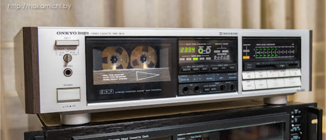

    Hello everyone,
    I'm restoring an Onkyo TA-2360 cassette deck (1986, Sankyo transport) and I'm trying to verify the original pinch roller dimensions.
    The deck currently has a pinch roller measuring:
    13 mm outer diameter
    6 mm rubber width
    8 mm overall width (including the hub)
    2 mm axle diameter
    However, I don't know if it's the original roller because the deck already came with a replacement installed.
    Could someone who has an original TA-2360 (or access to the service parts information) please confirm:
    - Original outer diameter
    - Rubber width
    - Overall width
    - Axle hole diameter
    Also, does anyone know if the TA-2360 shares its pinch roller with other Sankyo-based Onkyo decks (TA-2350, TA-2570, TA-2700, etc.)?
    Any measurements, part numbers, recommendations or photos of an original roller would be greatly appreciated.
    Thank you very much!
