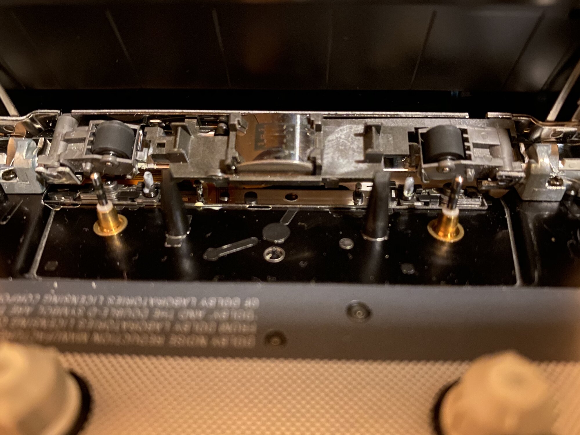

    Ahh, you have one of THOSE capstan setups, aye? I've heard horror stories about these, but my SXs' were never 'fortunate' enough to have this. This was included in 'higher end' models to improved the gripiness between the pinch roller and the capstan, since those pitiful excuses for rollers cannot do their job on their own when paired with that mechanism. This would ultimately improve the wow/flutter for the length of the rubber's usefulness.
    The problem with this is there is no way to find a replacement, unless you somehow make one, and you'd have to be pretty crafty (pun intended) to do this. You could get a lower end SX without the rubber and simply swap the capstans. The lower end units have a sanded metal band on the middle of the capstans.
    Your pinch rollers are surprisingly fresh looking BTW.

    As far as I can tell, it has been used very little; a gift from a business trip in Japan. The exterior is also basically mint.
    Anyway the reverse capstan bands just disintegrated with a minimal friction using a cotton swab soaked in alcohol; as did the original belts, and the clutch ring, and maybe the gear under the main flywheel ... definitely a reliable transport !
    Without the bands it plays the same way - not good.
    I'm done with the RQ-SX serie, if I want a Panasonic I will look for a "lesser" RQ-S or RQ-X.
    There is no point in trying to fix the unfixable, I'm quite sure that even with different flywheels it would sound the same, there is something wrong with this unit.

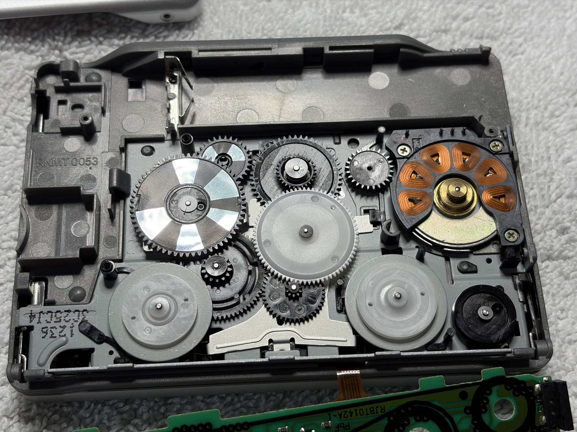

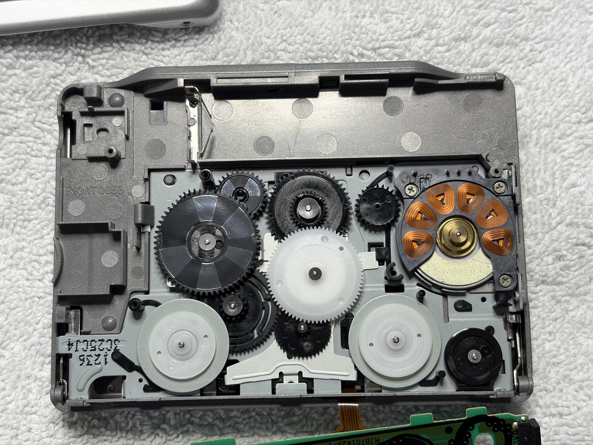

    So I've got two RQ-SX32's, one with the small rubber bands on the capstans, and one with the sanded capstans.
    I've bought new belts and clutch retaining discs from Marian at fixyouraudio.com for both units, naively trusting they will just work.
    Just like with everyone here, both units had horrible flutter making them completely unusable.
    Additionally, there was a nasty ticking in both units during playback.
    So here's what I did, along with some comments:

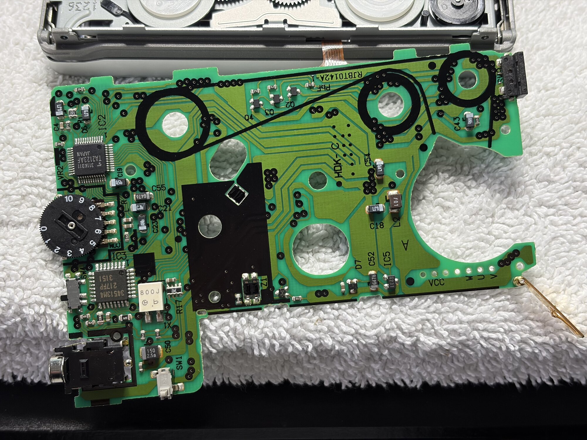

    Remove mainboard:
    - 5 screws.
    - Desolder: motor - 4 points, selenoid - 2 points, negative battery contact spring - 1 point.
    - Detach head cable ribbon - just pull.

    Do the same with the mainboard. Brush clean any residue. Don't worry, it won't melt, but don't keep it in IPA too much or the flexible button covers may come off. Then blow it dry.

    SO, finally, what were the results on my units?
    Playback ticking dissapeared from both devices. No more noises.
    And the big question - flutter:
    - First device - the one with the sanded capstans, for which I had great expectations - flutter was exactly the same, unusable.
    - The second device - the one with the rubber bands on the capstans - played VERY well.
    So I didn't stop here.
    Since the first device had more responsive buttons on the mainboard and a better head, I took both apart again and switched the mainboard and head/pinch roller assembly .
    The first device (tape transport with sanded capstans) was still bad.
    The device second device (tape transport with rubber bands on the capstans) continued to play well with the new mainboard and head/pinch roller assembly. I finally had a perfect player.
    CONCLUSIONS
    So what is causing the bad flutter?
    - It's not the mainboard (switching mainboards between devices had no influence on the flutter).
    - It's not the pinch rollers (switching the head/pich roller assembly between devices had no influence on the flutter).
    - It's not cracked gears (the problem was fixed without changing gears).
    - It's not a design flaw related to flywheel weight or the two-belt system.
    - So it is (at least partially) dirt. Cleaning everything and greasing the motor and selenoid fixed both the flutter and the nasty sounds during playback on one unit.
    - Finally, I think it's a loss of pressure between pinch rollers and capstans. The pinch rollers aren't spring loaded, they are free to move up and down, and are pressed on the capstans by sliding plastic pins. The pins are located on a lever in the chassis, while the rollers are located on the hinged head assembly. Therefore there are a lot of wear points that can lead to insufficient pressure between rollers and capstans.
    In my, case the transport having capstans with rubber bands worked, while the one having sanded capstans did not, but I don't not know my units' history and wear. All later models seem to have the rubber bands on the capstans, so it's plausible that this modification, and maybe some other less visible change, were made to increase pinch roller pressure, but that we'll never know for sure.

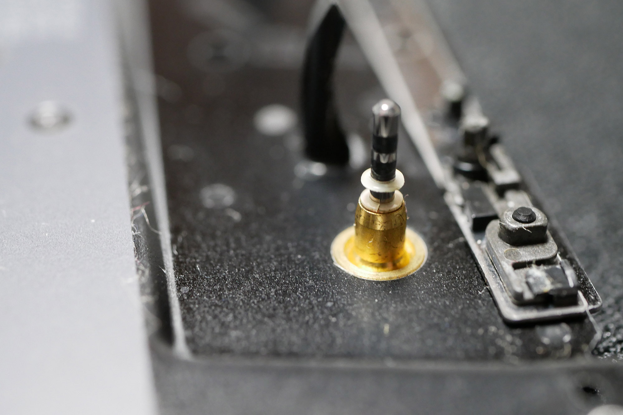

    I think the capstan bearings should also be oiled, since it's a metal to metal contact, especially if the mechanism has been submerged in IPA (so any trace of original grease/oil is gone).
    Know the washers are not as easy to remove as the split type, but it's also something that will only be done once.

    I completely agree. I actually thought about it, but I wasn't confident I could remove the capstans without damaging them, especially the ones with the rubber bands, which I presume should be ever so slightly thicker than the shaft.
    Luckily they spin a little slower than the motor, and the brass bearing is self lubricating to some extent.
    Also, the capstan opposite to the motor can be spun and checked by hand since it's rotating freely after removing the second belt.
    This way, at least you have a strong indicatione if they're stuck.

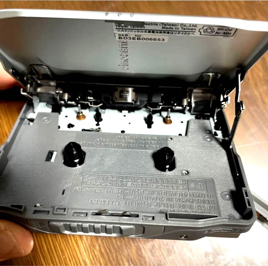

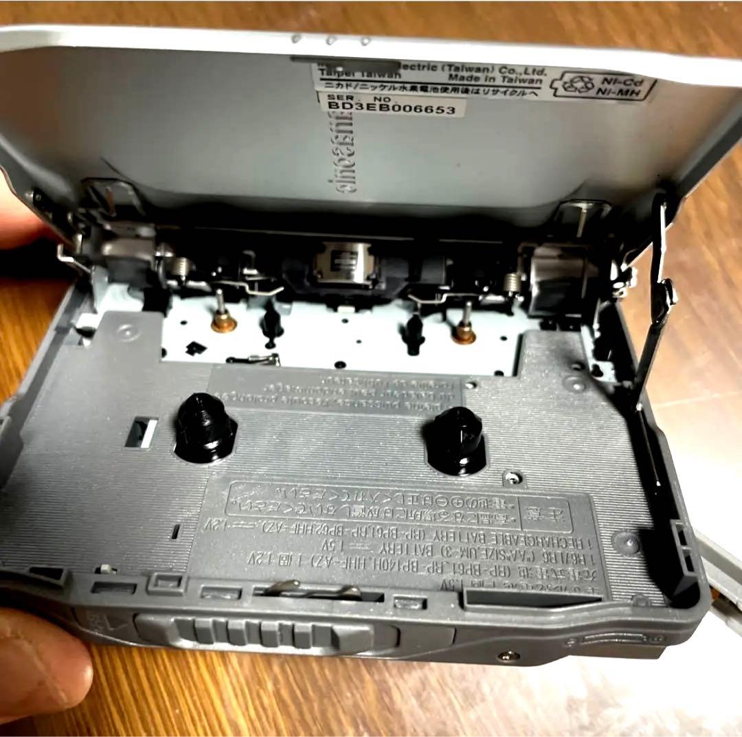

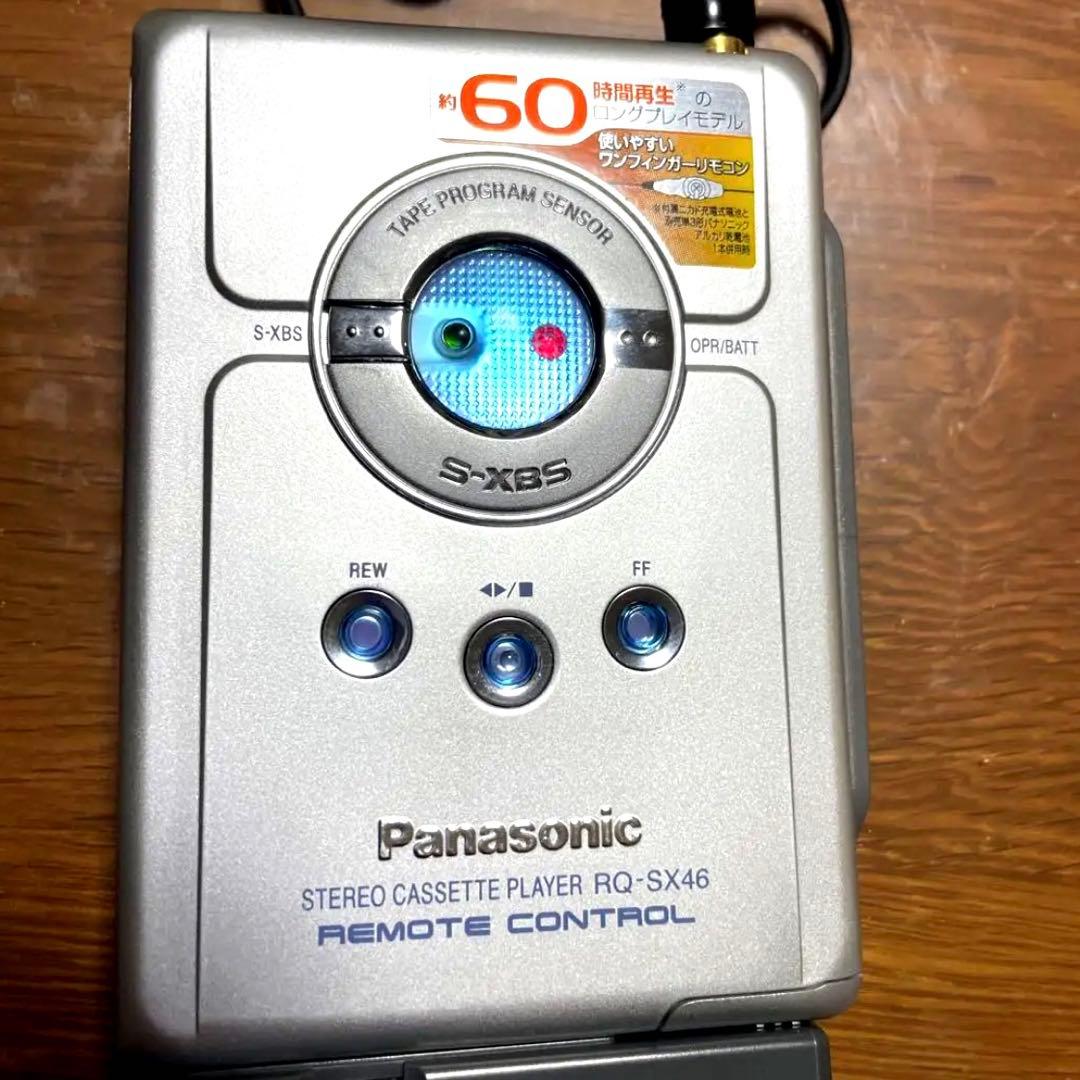

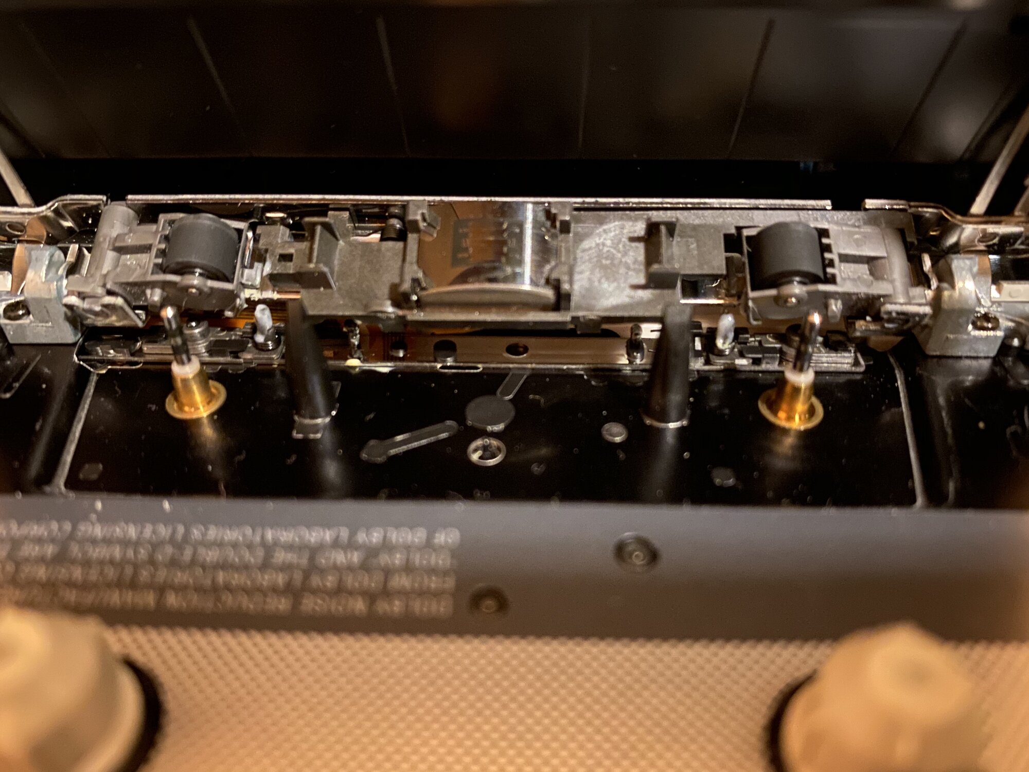

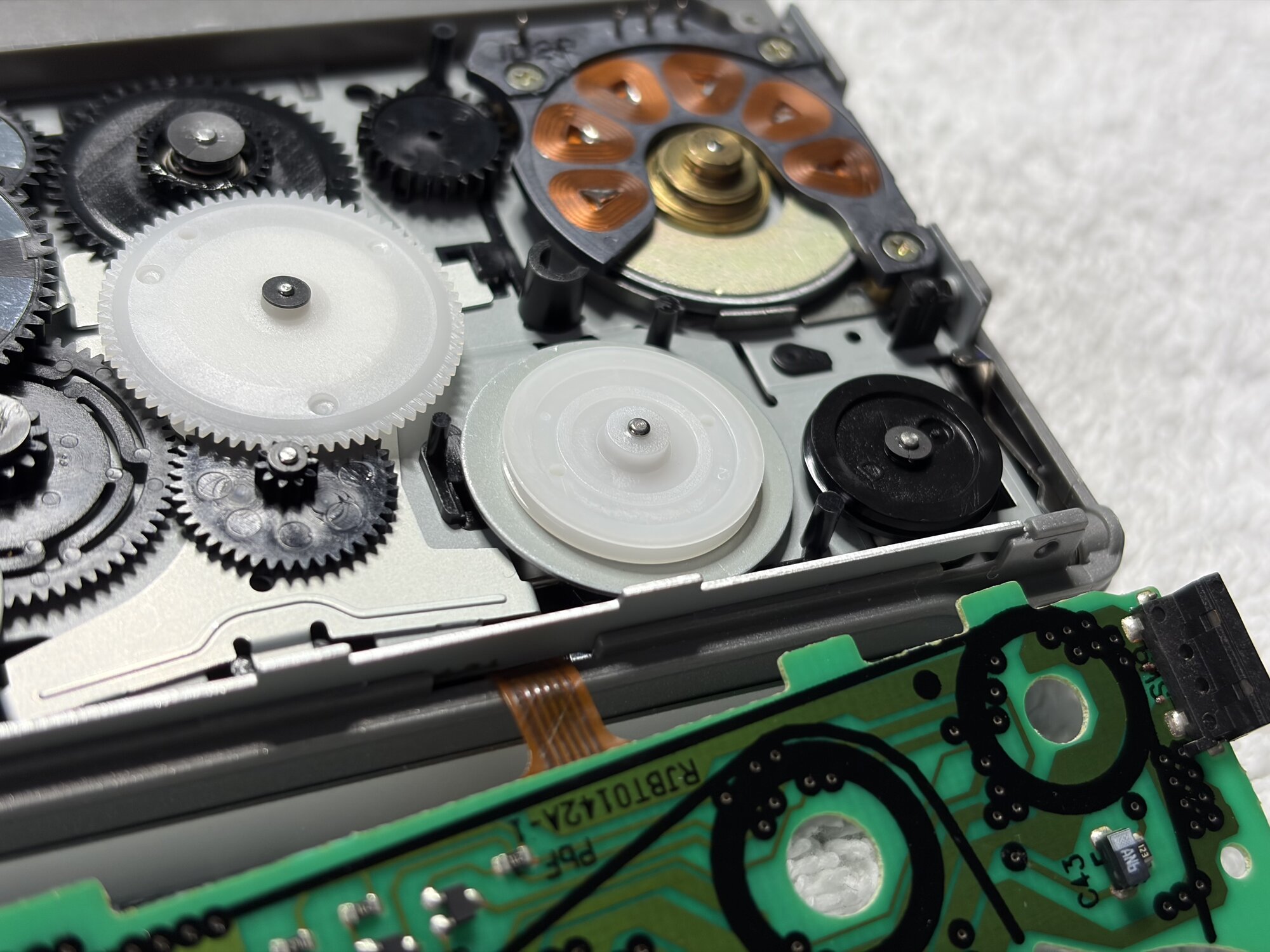

    Here is the SX46 I just bought (which is now in transit to be delivered early next week)
    Looks like it shares the same mech with your first unit (without the rubber bands on the capstan). Confidence inducing... yay. FYI, I settled on this unit because it was cheap from Japan, and I have a few Panasonic audio things from '03, and the design of this fits right in.

  10. dani7959
    dani7959 New Member
    Bucharest
    Wow that looks mint!
    I don't think it's the same mech. The tape compartment looks substantially different, and there is one key difference I notice - the pinch rollers of the SX46 look like they're spring loaded.
    The rollers on the SX32 are actually free to move up and down.
    After closing the door and starting playback, they are pressed on the capstans by a sliding plastic pin above them, which I think is actually the real design flaw of this transport system. The pin is on a lever in the chassis, and the rollers are obviously on the hinged head assembly, so there is a lot of wear points that can affect the pressure between rollers and capstans. Just like Valentin mentioned above, this low pressure system may be a key point of failure.
    I do believe your unit, being 4 years more recent in terms of design, has improved.
    Plus, there seems to be no actual wear.
    Be careful following the steps that I took, they probably don't apply.
    You could get away with just a belt replacement.
    Regards,
    Daniel
    Later edit: It actually seems that the SX46 is the only SX model ever made with the new tape transport system, before everything was discontinued in 2004. Please share your results, this could be interesting.

    Welp, the unit did arrive today and I got it apart and looked at:
    It's very clean in here. The entire belt had wrapped itself around the motor, so the pulleys and flywheels remained clean. I got lucky because my tweezers unwrapped pretty much the entire belt in one go from the motor spindle, and it only left some minor staining. Honestly, it's the luckiest I've ever gotten with melted belt.
    I noticed a few things about this mechanism that is very different from the others on this thread. First, this mech doesn't have a solenoid! Instead, the motor runs 'backwards' to change the transport mode, and forwards to turn the engage the tape spindles. Never seen this before. Also, the mechanism is really basic, with much lighter flywheels and less moving parts. In fact, it doesn't seem to have the problematic clutch that breaks on the earlier SX models of those brass flywheels with the cracking black plastic gear rings around the edge. I wonder if this mechanism will be any good? Anyways, I need a belt, and don't have one on hand. Just purchased one before writing this, so we'll see how it goes next week or so when it arrives.
    @dani7959 It's interesting that you mention Panasonic discontinuing these Walkmans in 2004, because the original owner of this mentioned he purchased this in October 2003. He also said that he bought it to replace his primary Sony unit which stopped working, but he only used it a few times as the Sony unit started working again.

    Its looks very AR20 mechanism. The differences I see are that the rotary switch has been changed from mechanical to optical. The motor is also different from the standard AR20. It's likely an upgraded newer version of the mechanism. If the capstans and pinch roller design match the AR20, then this is sure to be a very nice player :thumbsup:
    Recaptcha and Valentin like this.

    Hi everyone! I've fixed a few of these RQ-SX units myself, and also agree that it can be a pain bringing these units close to factory spec.
    For the RQ-SX46, it uses the AR21 mechanism made in the early to mid 2000s. If I recall correctly, 3 models utilize this mechanism, RQ-SX46 (2003), RQ-SX47 (2004) and RQ-SX59 (2005). The RQ-SX59 was the last model produced by Panasonic to use this mechanism.
    Also, thank you @Recaptcha for posting your insight on this last logic controlled mechanism produced by Panasonic. I was scratching my head figuring out how the mech works without a solenoid. These last gasp models reduced their part count, and cut down on the amount of metal used so as to reduce manufacturing costs.

    I surmise that the shrinking cassette market of that period led to manufacturers rolling out models that were catered more towards language learners.
    This can be seen in Sony's Walkmen models where they removed the Dolby NR feature and included speed controls. In Panasonic's case, they removed Dolby NR and kept the basic functions with the inclusion of S-XBS. In the RQ-SX59, the S-XBS button has a double function, in which a certain segment of a tape can be played repeatedly.
    Your unit looks close to pristine, if there are no electrical issues or if the motor didn't go bad, I'd say there's a fair chance that it can beat the older RQ-SXs. It also employs almost the same anti-rolling design commonly seen in Sony's Walkmen, so playback will be more stable compared to the AR10 mech.
    Repair wise, it's definitely simpler than the AR10 mech. For the AR10, you'd have to deal with a broken clutch retaining disc, the brittle gear next to the capstan driven by the motor, and the gear under the capstan which will develop micro-cracks.
    Maybe the most you'd have to do for this RQ-SX46 is just cleaning of the pulleys and perhaps lubrication of the motor bushing.

    For sure, even compared to the previous RQ-X generation (AR20), which had a clutch retainer prohlem (and it needed to be glued), this seems to have a re-designed clutch.
    So despite mechanism was made cheaper (optical encoder instead of mode switch), different motor, overall it's a better design.
    What I would recommend doing as maintenance is clean and lubricate (watch oil) the motor and capstan bearings.
    SX (AR10) are together with S (AR90 - pad lifter version especially) harder to restore than AR20.

    And now, the moment we have all been waiting for... the new belt is in, but does it sound any good?
    I am pleasantly surprised! Tape speed is pretty stable (compared to my previous luck with the SX series), it has a nice full sound, it gets plenty loud enough, and all of the track select functions work as intended! Off to a good start I'd say. Both reverse play and normal play have the same levels of wow/flutter, so it's not like my past RQ-SX experiences of having one side be really wobbly, and the other not so much. I would guesstimate the flutter at about 0.3%.
    So the wow/flutter is far from perfect, but we are now in the realm of tolerance (for me at least). I have proper working Sony EX series Walkmans from the early 90s that sound like this as well as other 'slim strong' style players with this level of stability. Do I think it could be better? Yes! If I replaced both pinch rollers and put a charged gum stick in it, it would improve slightly I think.
    You guys were right I think, this is a much improved mechanism over the previous models. It doesn't have any loud ticking or rough gear sounding noises, plus it feels more composed and less sporadic (thanks to the lack of flaky solenoid). The only drawback I think is the FF/REW speed and the time it takes to switch transport modes. Running the motor backwards and then forwards and repeating this a few times to change auto reverse takes about 3sec, so it feels 'laggy'.
    FYI, the motor noise that can be heard during FF and REW is cancelled out in play mode before the audio amp kicks in. Even between tracks, no motor noise is heard.
    I'll keep playing with it and see if I can improve it even further.
