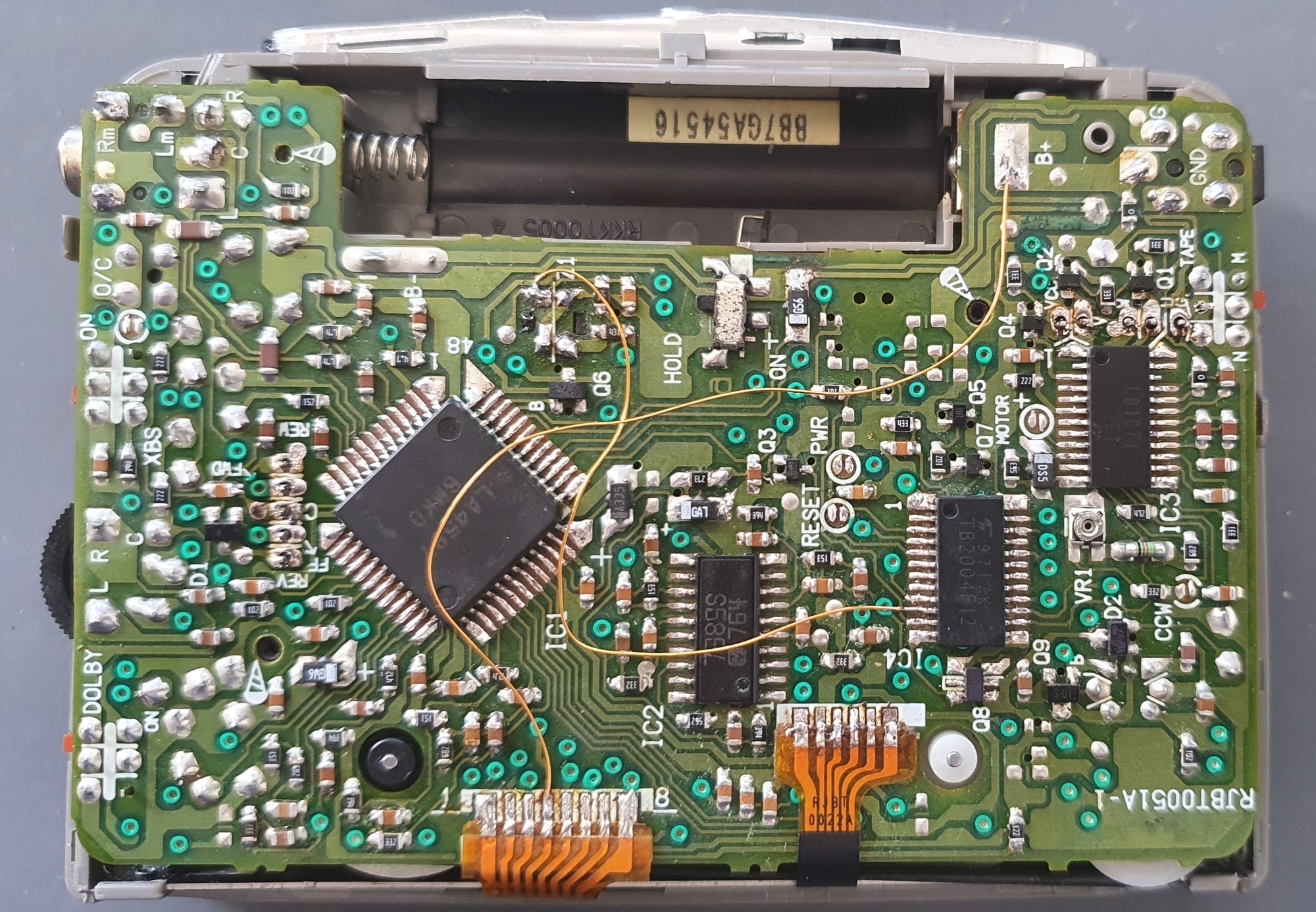

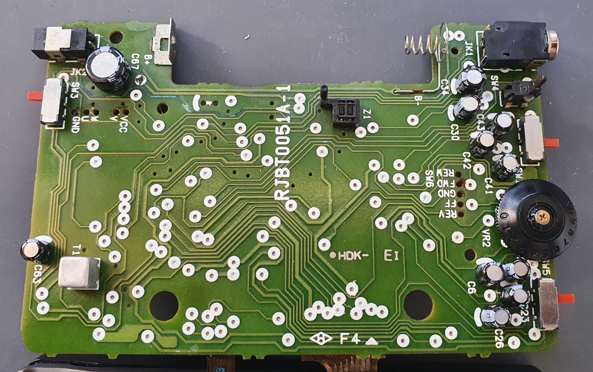

    Please share some pictures, for reference. Is the PCB single sided or double sided ? On double sided PCBs, vias can also cause broken connections.
    Broken traces are usually caused by a break in the PCB itself (can be caused by dropping the unit), which should be visible if you look very carefully.

    Ok I correct my statement. There are no visible cracks on the PCB, both of the connections failed because of faulty vias, not traces. I just learned they were called "via" :) an amateur enthusiast here.
    I will disassemble the unit again for belt replacement soon when I have time (because I had randomly fit a belt for testing at 02:00 in the night just to test the operation, did not have further time to fit better belt), and I will take photos of the PCB then.

    Here go the photos:
    Panasonic RQ-X11.jpg Panasonic RQ-X11 board.jpg Panasonic RQ-X11 mechanism.jpg Panasonic RQ-X11 board side B.jpg
    Emiel and Valentin like this.
