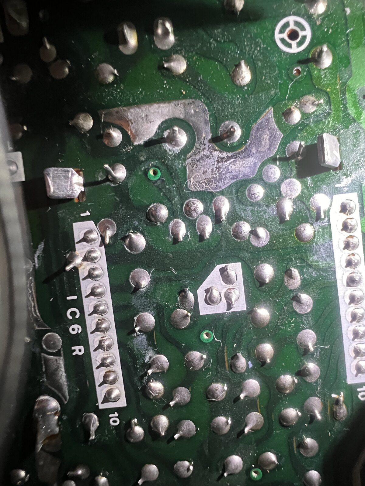

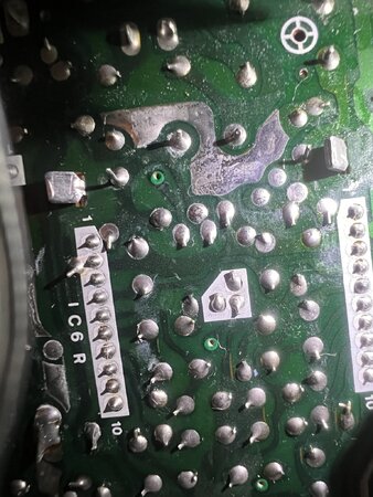

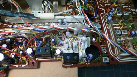

    I did get some pics of the ic chip. Does this look suspect at all? Should I try and reflow it for posterity sake?
    Jorge and Mister X like this.

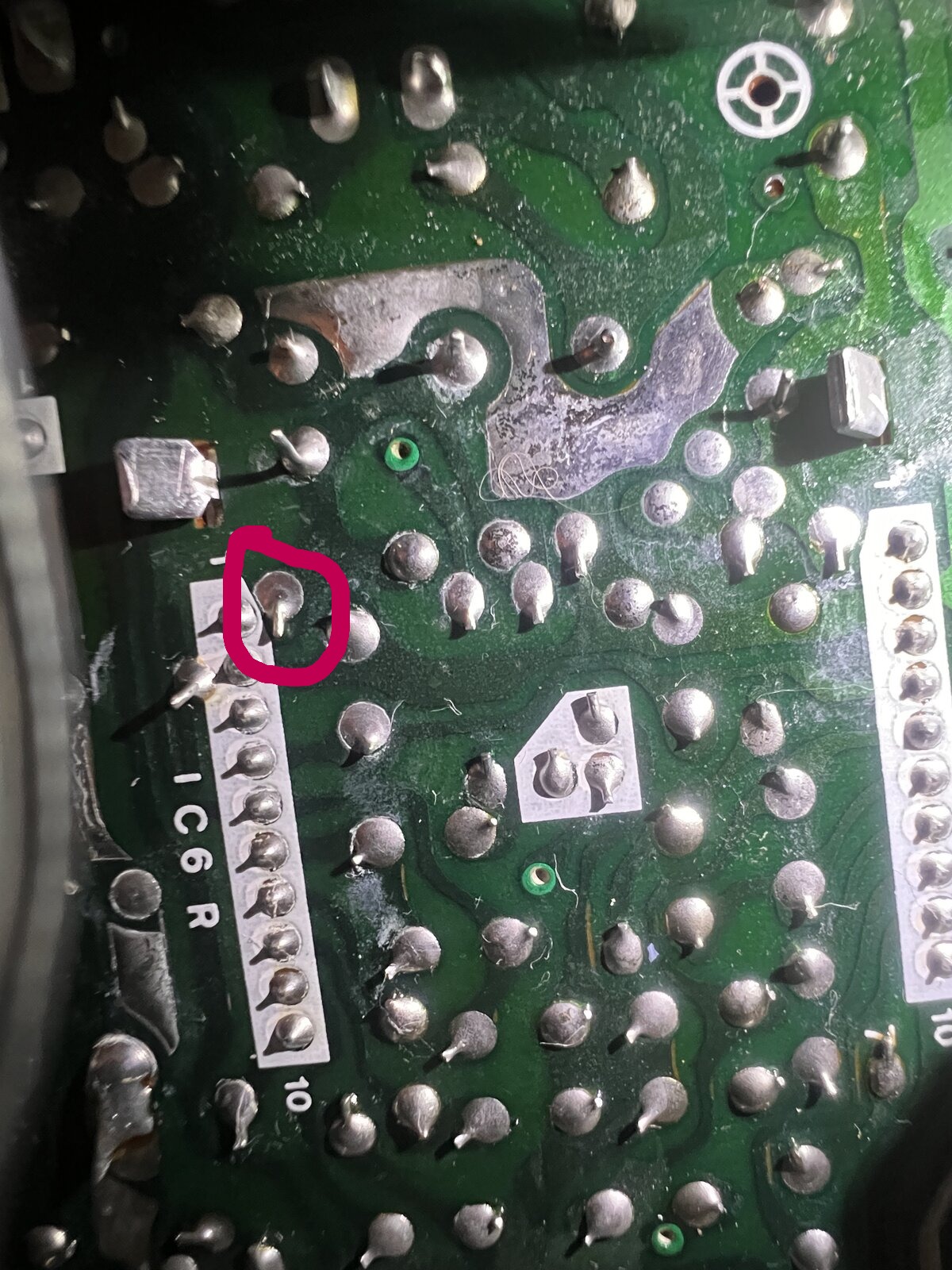

    I have had record switches so bad that I had to unsolder them and take it apart and clean and lube and put back in the machine . Also near IC6R there is a cold solder joint in your photo too and yes check the DC offset .

  5. bmsinc
    bmsinc New Member
    9
    buffalo ny
    thanks for your comment. The record switch was severely stuck in place when I got the unit but I’ve jiggled it quite a bit and a few deoxit sprays and seems to reliably move now with no resistance or crunchiness. It does make me wonder how bad it still might be inside. You think this could really be a related to weak single channel audio?
    I did reflow the ic6R chip this morning and there was no improvement in the decibel level of the right channel (through headphones)

  6. bmsinc
    bmsinc New Member
    9
    buffalo ny
    I’m sorry. Any chance you can highlight the cold solder joint you’re seeing?
  7. radiorich
    radiorich Active Member
    245
    Washington state
    Hello BMsinc ,
    Here is photo with a red circle around the bad joint !
    Sincerely Richard
    Mister X and Jorge like this.

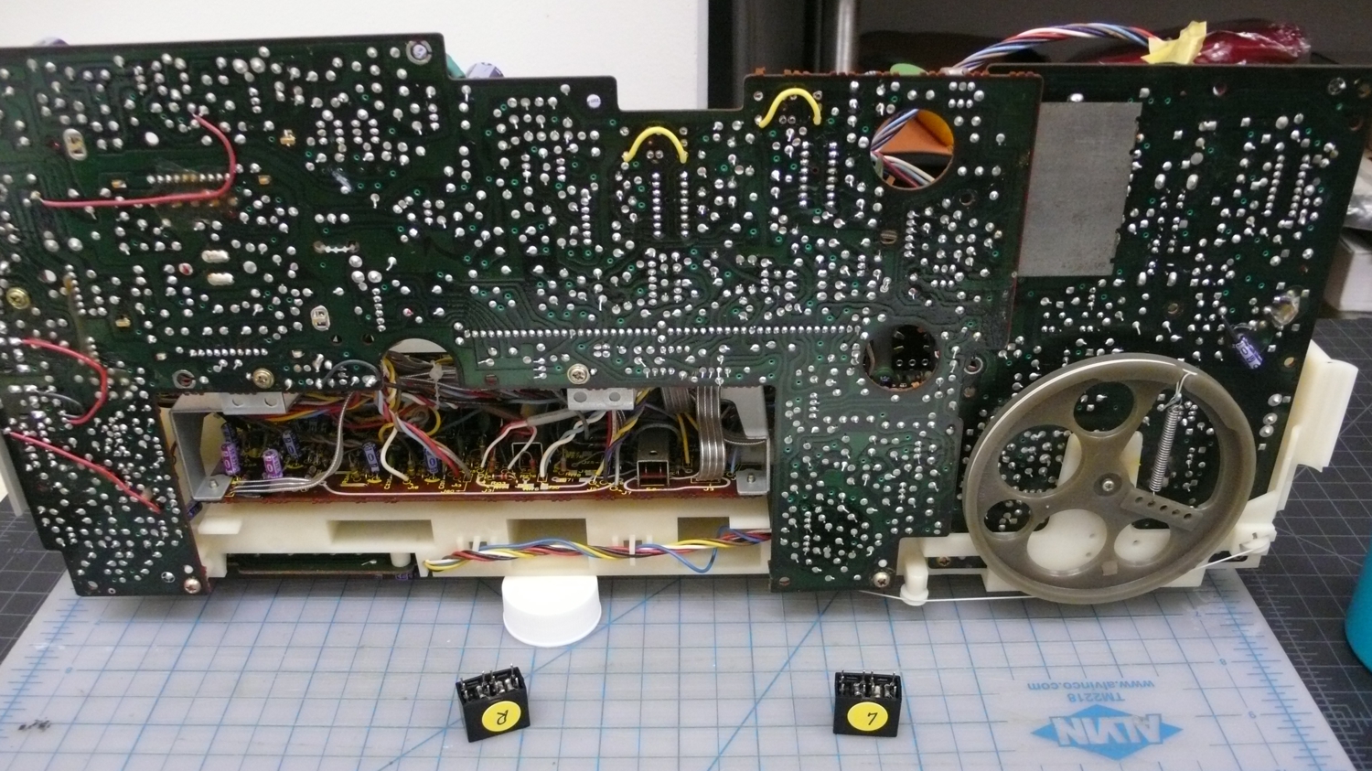

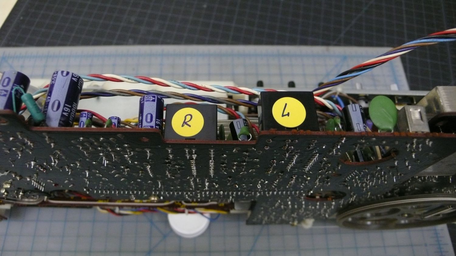

  8. Jorge
    1,786
    you reminded me of the photo I posted here at S2G ten years ago:
    I had the same problem with this RX-5500 and had a lot of 'fun' trying to fix it.

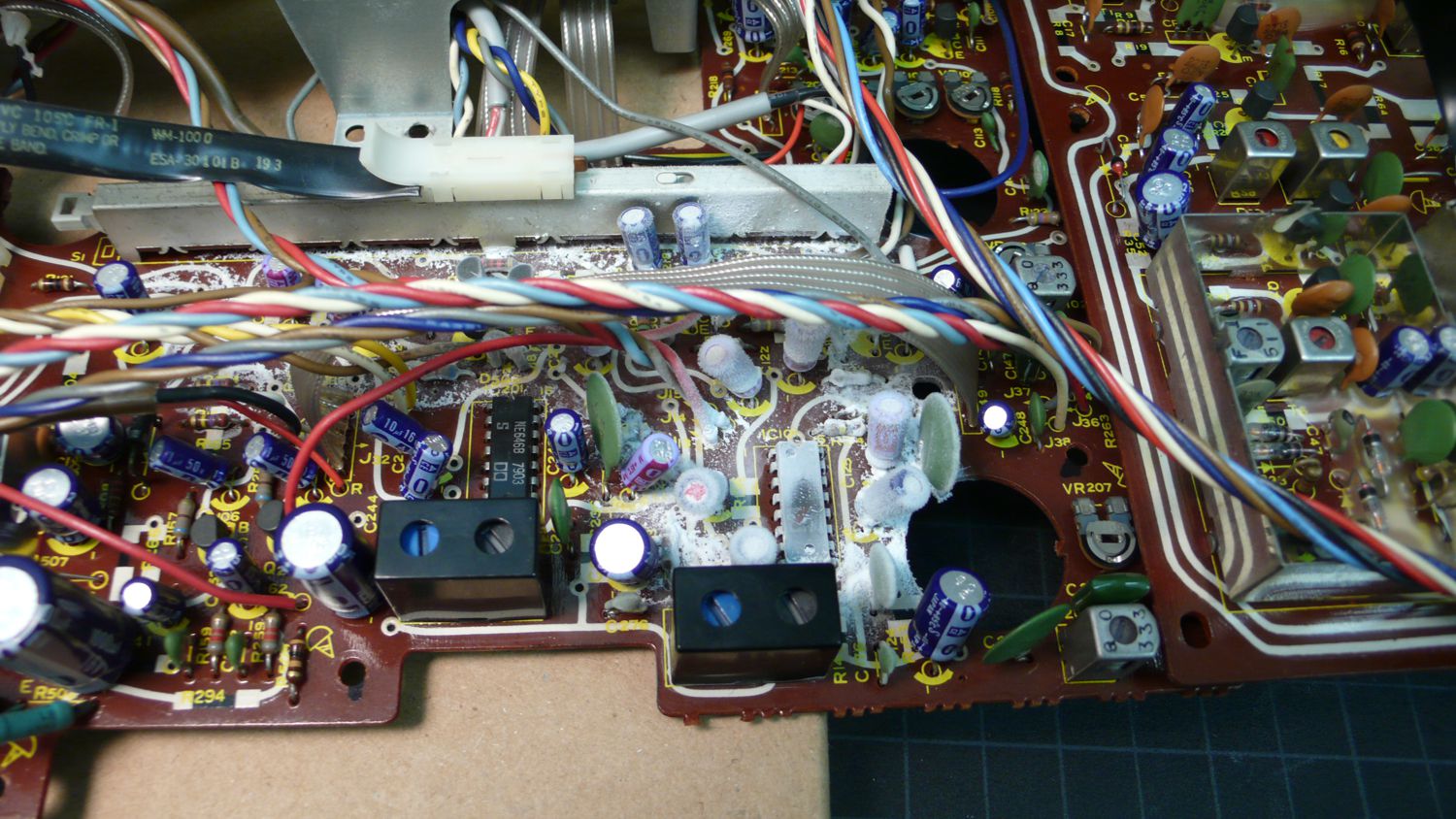

    Here is me using Cold Spray on the mainboard, in an attempt to find the glitch:
    In the end I had to do it The Hard Way and just traced the signal. It was failed MPX filter which caused the dropouts:
    Since I was not going to record from the radio (never did and never will), I just removed them:

  10. Jorge
    1,786
    Yes, I removed MPX filters (marked L and R on photos) and bridged the terminals (Yellow wires, last photo). RX-5150 does not have MPX filter as a separate 'chip' but my point was that sometimes failed part is not evident and has to be traced
    Make sure that you have good Right Channel through Line-Out, download RX-5150 Service Manual (it is free download) and start looking 'downstream' of R132/R232. You have one working Left channel, this makes the search somewhat easier

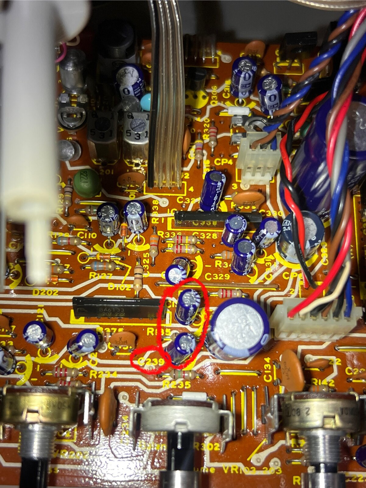

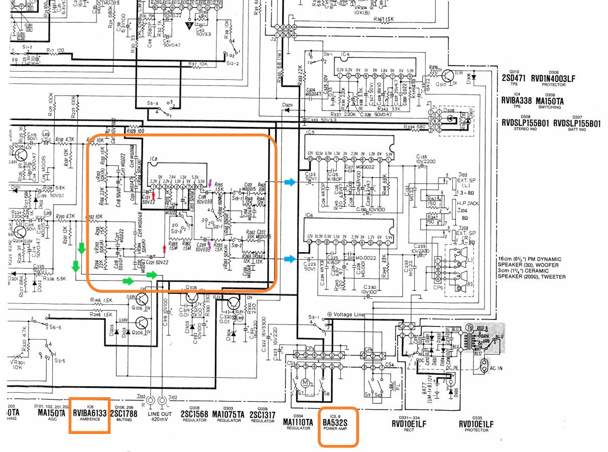

    Silver965 Well-Known Member
    734
    Torino

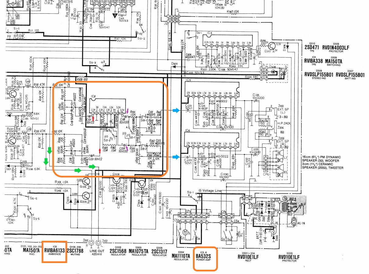

    RX.jpg Hi,
    I'm attaching a portion of the circuit. Verify that the power measurements are correct at the IC pins...
    Since the output line is fine (green arrows), the problem could be
    in preamplifier IC8, which controls the input tone and the output volume and balance, and then powers the power amplifier chips via two electrolytic capacitors...
    Check if you have any of these defective capacitors with high ESR, or replace them directly... the input and output electrolytic capacitors you see in the diagram will suffice.
  12. bmsinc
    bmsinc New Member
    9
    buffalo ny
    This is so helpful. I’m going to see if I can have a go at this tonight and see what I find. Thank you so much. I was trying to get ChatGPT to annotate images just as you have and it’s so wrong and random and not helpful. Sometimes it will pinpoint traces that don’t even exist or it will put a mark in between traces…so bad. It has its moments though.
    Thank you so Mitch for marking this up for me. I’ll report findings soon.
    Should I be measuring with my multimeter? I don’t have an oscilloscope.
    in pun 8 and 9 on ic8 left and right audio by chance?
  13. bmsinc
    bmsinc New Member
    9
    buffalo ny
    good news is that I have actually found the caps on the board with the help of your annotated picture. Thank you so much for that.
    If you can’t tell I simply don’t know how to use a multimeter to check the voltage as I read you shouldn’t be doing this while it’s plugged in because you can short and fry things. So I’m hesitant to just start probing away.
    I guess my next step is to just pull and replace them. I don’t have any means of measuring the esr levels so I figure it wouldn’t hurt to just put some new caps in there to essentially rule them out as problematic. I’m confident in my abilities to do this once I can figure out the values of them. It’s my understanding you can use higher voltage caps but have to match the other measurement exactly.
  14. bmsinc
    bmsinc New Member
    9
    buffalo ny
    Got some readings here.
    Both of those caps appear to be at 4.3V and holds steady while music playin. Not sure if that matters for this issue.
    here’s the pin readings on ic8 in order of pin 1-9
    some look like they are reading low based on the wiring diagram/schematic. I don’t know to go from here. Others seem to be in range. I had the fader set to middle when testing. Volume as well.
    2.14
    0
    2.14
    6.39
    1.51
    1.5
    7.95
    4.41
    4.33
    I did an ohm reading on the balance pot. My meter was set to 200k ohm for the following readings. It shows 34.6k when I have the probes on both of the outer terminals with the balance in the middle. Twisting the pot to both sides ends on 20.8k for both fully right and left.
    next, I place one probe on the left terminal and one in the middle, I twist the knob and the resistance changes gradually - no jumps or shorts - fully left it reads the same 20.8k. Turning the knob all the way right ends up at a 0 reading. I got the same values for touching the probe to the right most and center terminals - just in reverse. Knob fully left 0 - fully right 20.8k
    The pot itself says 100k on it in faded black ink. I read that the pot should be reading its printed reading of 100k when both terminals are touching the other points? Is this correct? Are we seeing diminished voltage flow in here?
    Are we getting somewhere?
