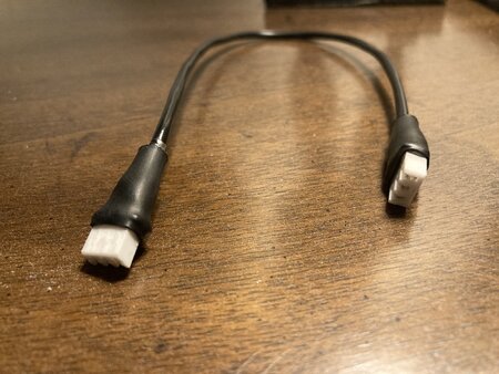

    Whoa! I received the unique hand-made cable recently from c.fey (eBay handle) in Germany. It was £50 + shipping, and was very much worth it. This is to connect my SL-XP5 to an integrated amp SU-CD50.

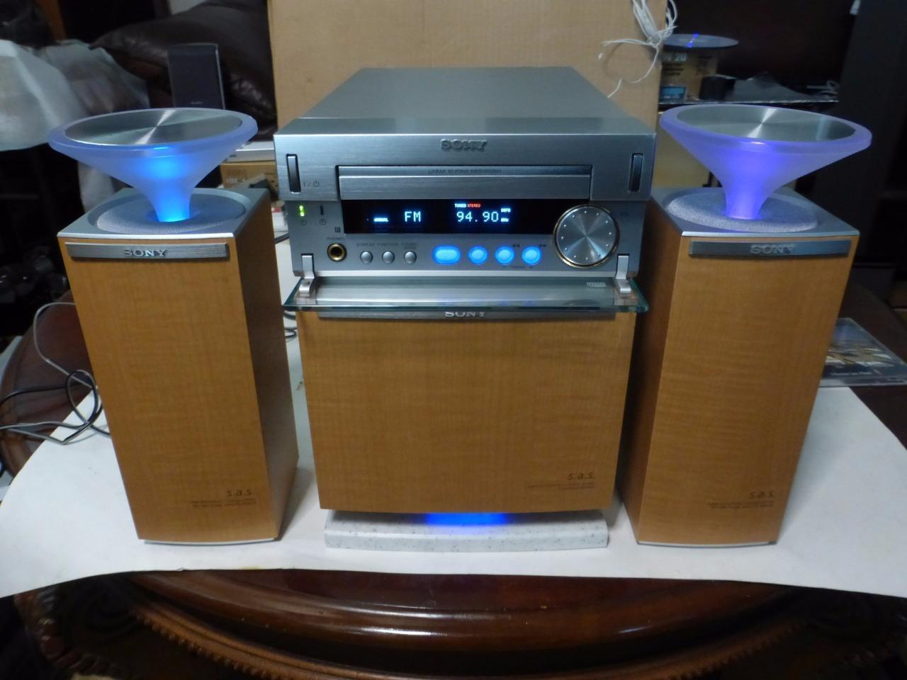

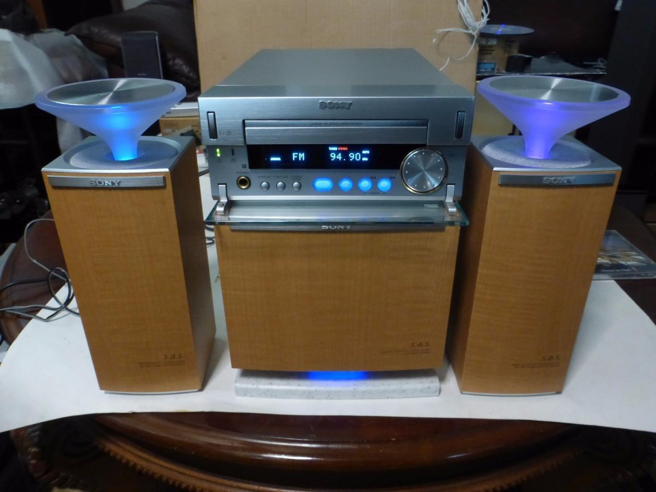

    Sure, here it is with half loaded Iron Maiden cd :) Speakers are actually from another Sony micro system HCD-SD1 - 2 satellite speakers plus subwoofer. This system was really beautifully show-cased in Sony catalogs when I was a teenager, I always wanted to own a set. Sound is disappointing, but they look beautiful and very extraordinary :) Original EX1 speakers sound much better.

  8. Longman
    3,855
    So the blue glowing cones are actually part of the speakers.
    I have seen that CD Receiver (sat on top of the sub-woofer) many times on eBay but the speakers are something else

  9. Kulgrinda
    Kulgrinda New Member
    13
    Lithuania
    Cones actually have 2 functions - they glow when unit is on (not only blue, there are 3 RGB controls at the back of each speaker so you could change color to match your interior or mood :) Cones are matt glass) and work as a diffuser for drivers that are mounted on top of the speaker. That is the main drawback of these speakers - sound is very boxy (speakers are actually plastic) and spread out, not concentrated. Without subwoofer it is really bad, with it correctly setup sound is acceptable from further distance.
    PS subwoofer base is marble. Probably unnecessary, but still nice touch :)

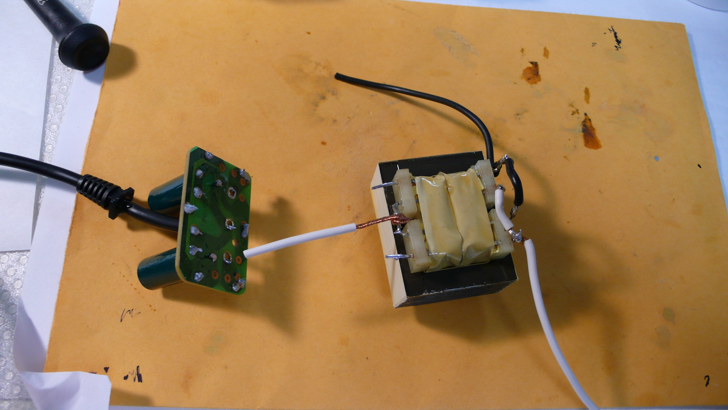

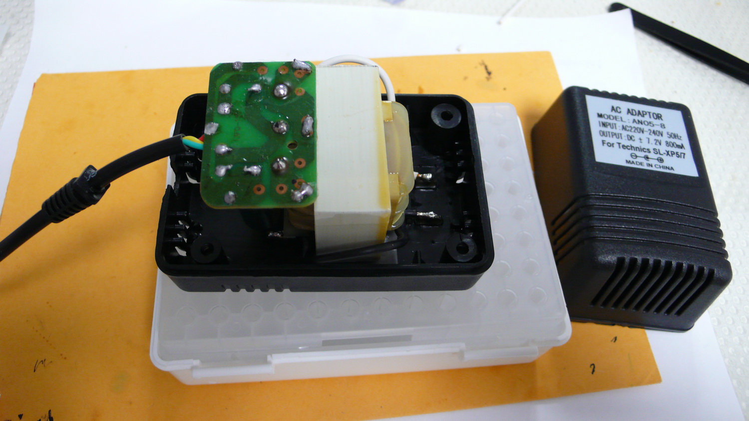

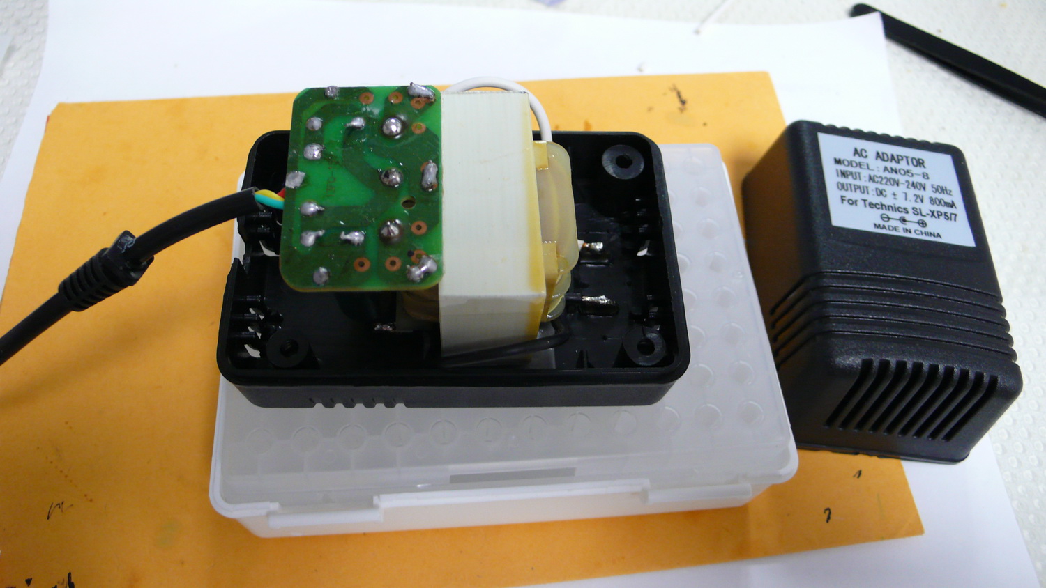

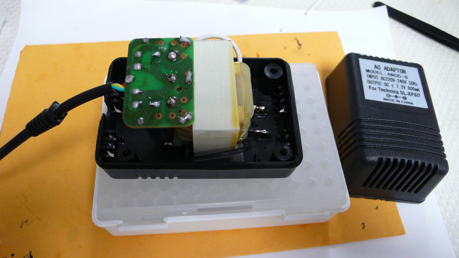

    Hi. I was hoping you could guide me on how to rewire this adapter for 120v as you did. I have a technics sl-xp5 and this chinese adapter and would really love to be able to rewire it for USA so I can use the cd player. Thank you for any help. Edit. I found one of those cd22 retocon car adapters in the package. If that works with it then I won't need to rewire the Chinese adapter, I'll just use the car adapter.

  11. Jorge
    1,754

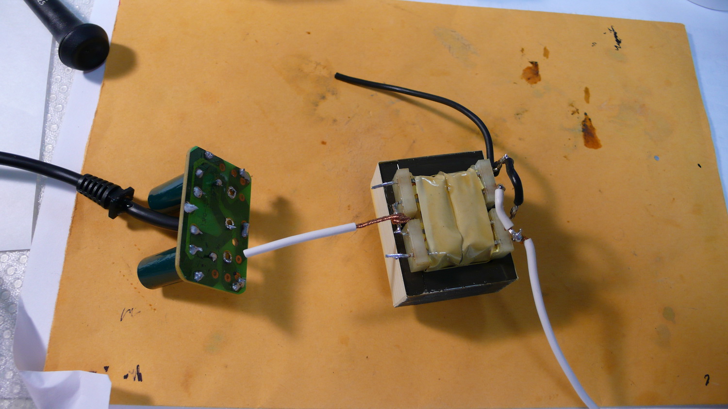

    The easiest and the cheapest, as always, is to buy 120-to-220 step-up transformer, they are sold on Amazon and eBay for ~$10.
    But it is very easy to rewire the original adapter. You open it (it is held together by screws) and exchange the transformer. Transformer which worked the best for me is FS12-1000 by Triad Magnetics. Follow the instructions which come with the transformer:
    Good luck! :)

  12. JasonZ
    JasonZ New Member
    12
    Virginia USA
    Nice thanks for the detailed info and pics. I got the link saved to my notes. I tried the step up transformer however I might have messed up my adapter cuz I think I might have originally plugged it in to a 110v socket. When I tried the step up transformer I have my CD player display would turn on then go on the fritz and it would make noise through headphones like the instrument used for the star trek theme song (not sure what it's called) and the the display would fade out. I tried a few different step up to transformers and then figure that the CD player might have been meant for 110v and not 220v. I bought a recoton cd22 car adapter with a wall plug to car adapter adapter to try and see if that would power on the device. I really hope I can get it working.
  13. Jorge
    1,754
    You could not harm 220V adapter by plugging it into 120V. This was done by myself and other SL-XP5 owners - lower ac just gives you lower DC on the output
    Either your step-up transformer is not powerful enough for the job (SL-XP7 and SL-XP5 Discmans draw almost 1amp during startup!)
    or
    Something is wrong with your SL-XP5
    JasonZ likes this.
  14. JasonZ
    JasonZ New Member
    12
    Virginia USA
    Confirmed there's something wrong with it. I made a diy battery pack for it and it did the same thing.
