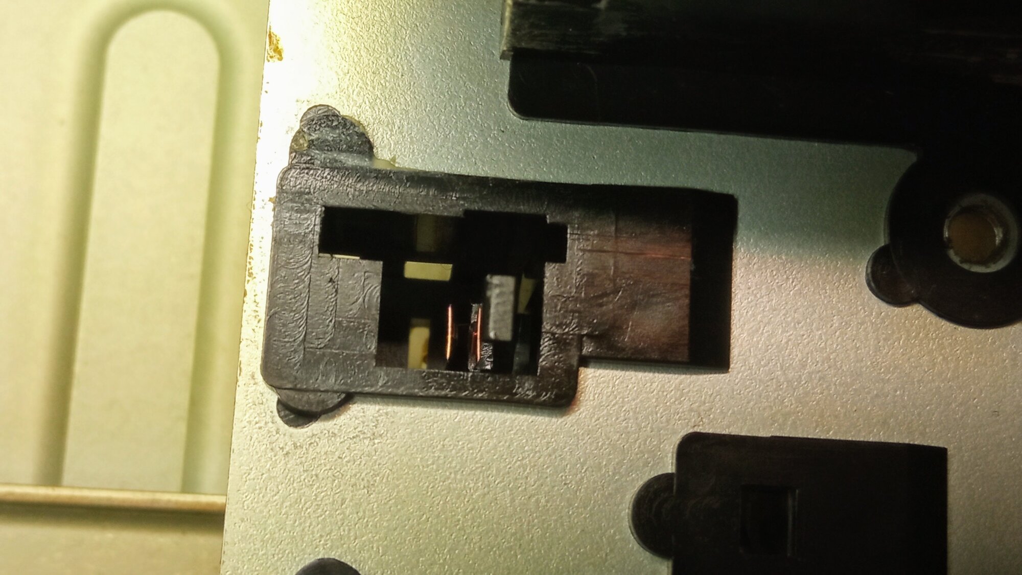

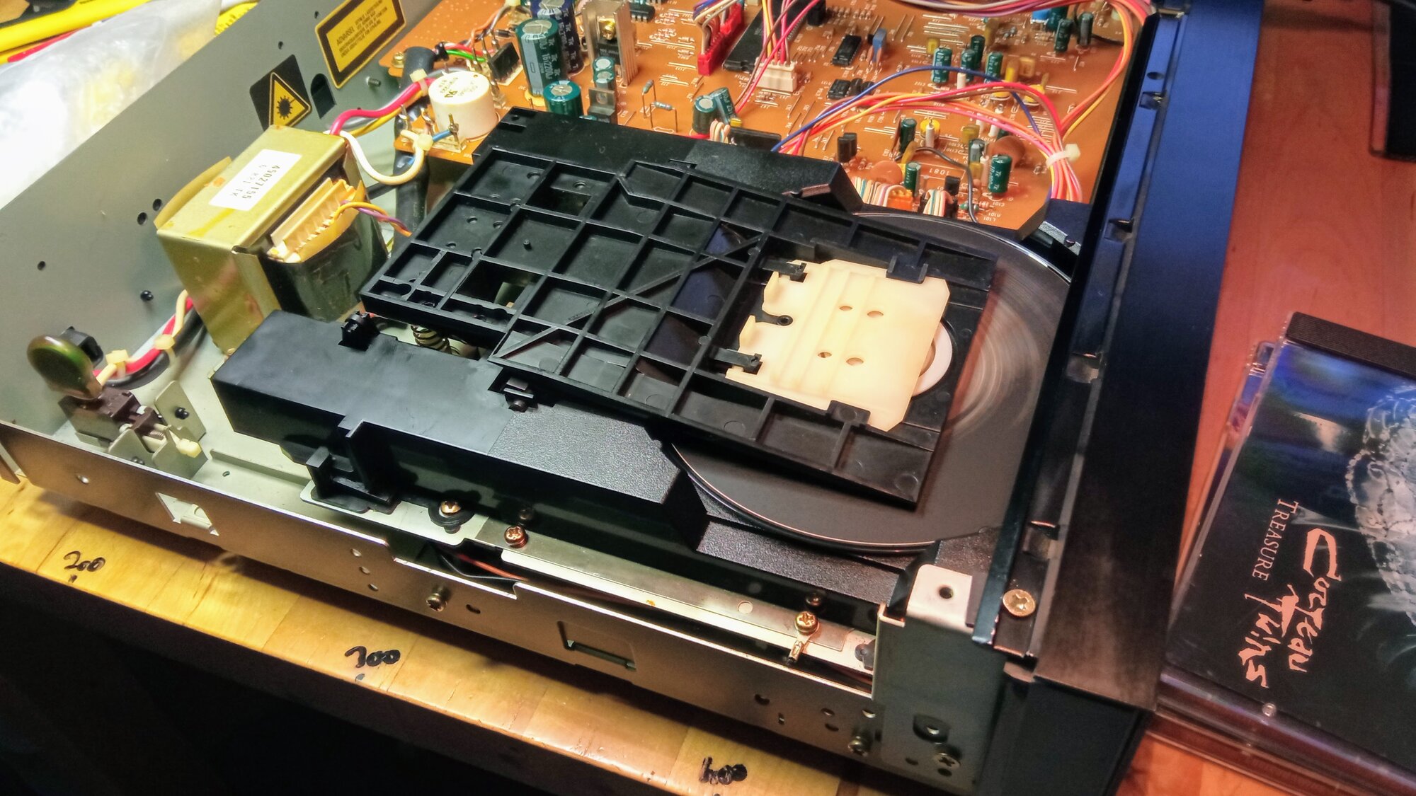

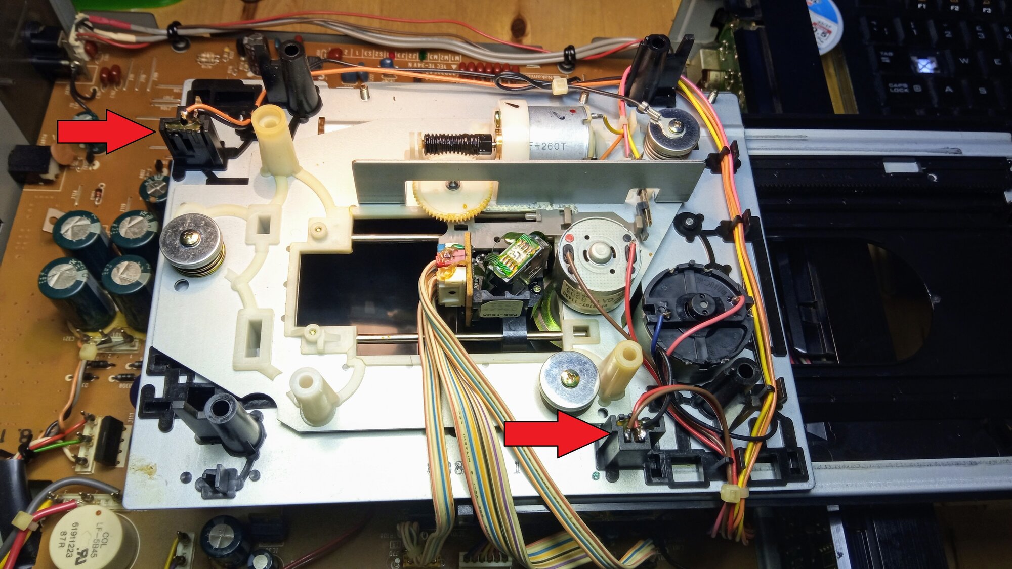

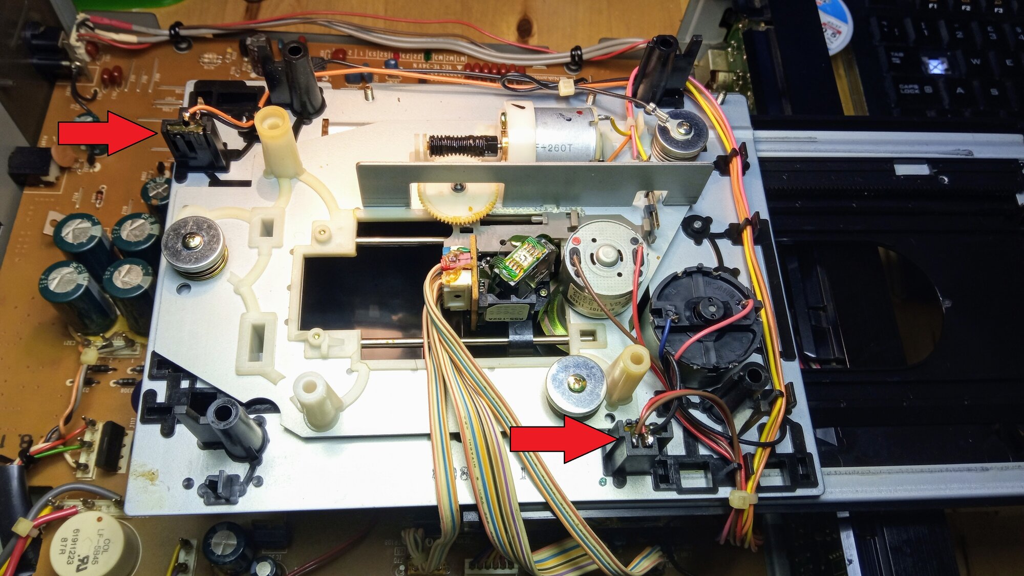

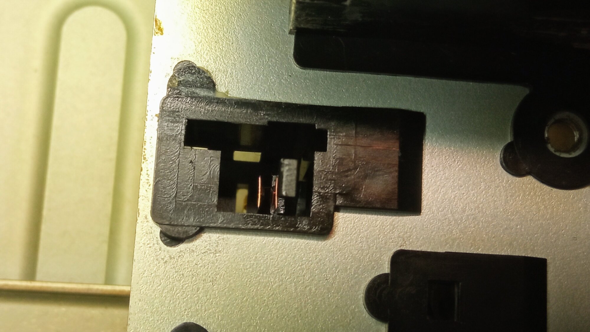

    Sorry to be a thread hijacker extraordinaire but while I have the attention of a few of you in regards to this player I'm having a tricky time rectifying the opening and immediately closing CD tray issue.
    I had wrongly assumed that it would be a single position sensor/sender as in 'most' CD players but then I should have realsied that Nakamichi don't do like 'most' other manufacturers and hence, on removing the top panel for a butcher's inside that the CD assembly uses 2 contact switches fore and aft, triggered by the tray stopping position at either end of the travel.
    The position sensor at the ejected position is obscured by the top of the tray assembly that looks like an absolute chew to remove. The manual talks about taping various parts in position before removal of other parts, presumably to maintain a datum position or such. What a faff.
    In any case, that's the sort of procedure I know I'll make a total ballsup of so I'm not going to attempt it just to clean the contacts...just to find out the problem will most probably be something totally different.
    Any ideas? Or do I just bite the bullet and go for the upper assembly removal?
    I suppose it's character building type stuff - diving into the unknown. God knows I've had to do that with various cars over the years so it won't be an entirely new experience.
    :ohno2:
    Alternatively, I could just learn to live with it and use Granville's technique with grabbing the change from Arkwrights cash register -I have about 2 seconds to either take a CD out or put one in. With concentration and dexterity I could possibly manage it. LOL
    :loldiag:
    Position sensors arrowed red

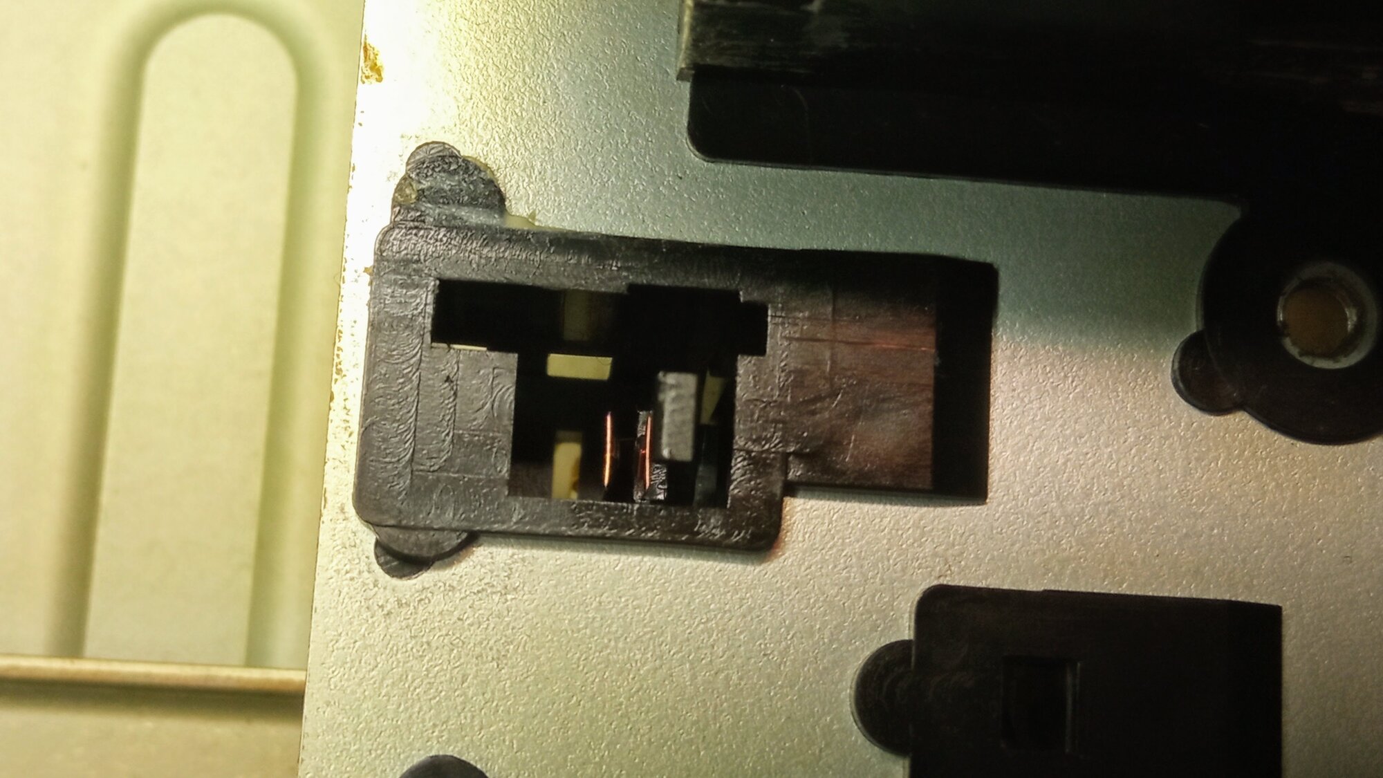

    Close up of the topside aft sensor

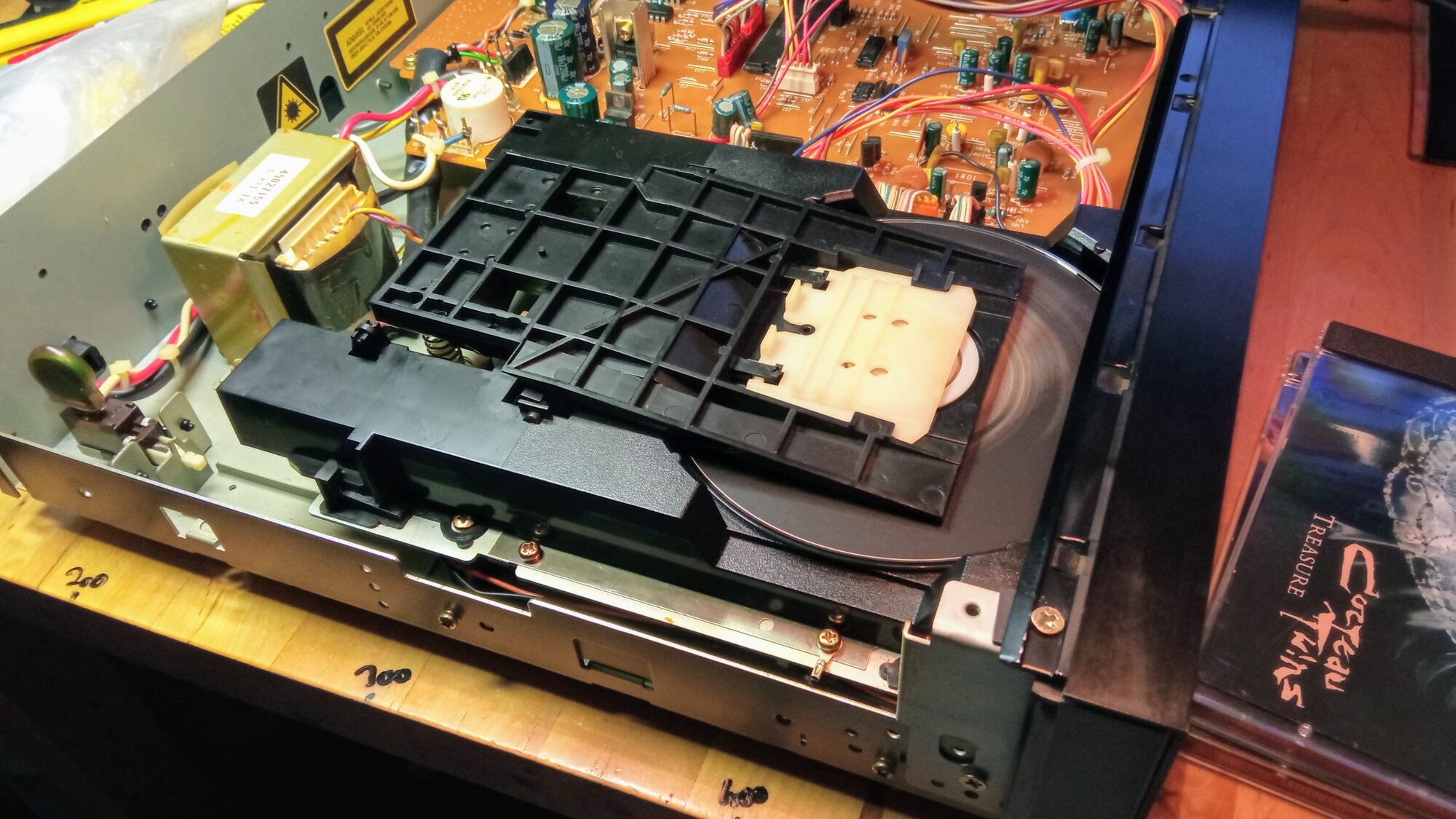

    Removing the top of the tray assembly. Yay or nay?
    CD insertion/removal would go something like this:
    :loldiag:
  2. Longman
    4,082
    That is an awkward design. I had the problem you describe with a Denon drawer loading cassette deck, and the position sensing switch contacts were easily accessible on the side of the mechanism. It took longer to take the lid off than to clean them and restore normal operation.
    In your case have you tried a quality contact cleaner like Electrolube or Deoxit? They usually come with long tubes to reach hard to get at places. Looking at your photos you might want to position the deck upside down or on its side so it drips into the contacts rather than onto other parts.
  3. Chris_D
    Chris_D Active Member
    156
    Netherlands
    Thanks for the suggestion. However I would need to get to the top-side of the forward sensor to clean the switch contact surfaces effectively. Squirting from underneath won't be effective and it's not ideal anyway.
    It's not even possible to use a long straw to squirt in contact cleaner as it is totally obscured by the black plastic tray.
    I use Kontakt PRF 6-68 and 7-78 usually.
    I will live with the issue for now and maybe I'll eventually get around to addressing it.
    I noticed when cleaning the case with IPA that there was tar stains on the cloth afterwards but the unit doesn't have that usual smoker's stench. It's actually not even an unpleasant odour that's been left behind so I'm assuming the previous owner was burning joss sticks or something. Idk what the oil/tar content of those things is but they definitely left a light residue over everything and I presume this is what may be casuing the tray issue.
    I gave the laser lens a clean and lens assy rails a good clean/lube for good measure. Otherwise it's a pretty clean deck. No scrtches or gauges which is nice.

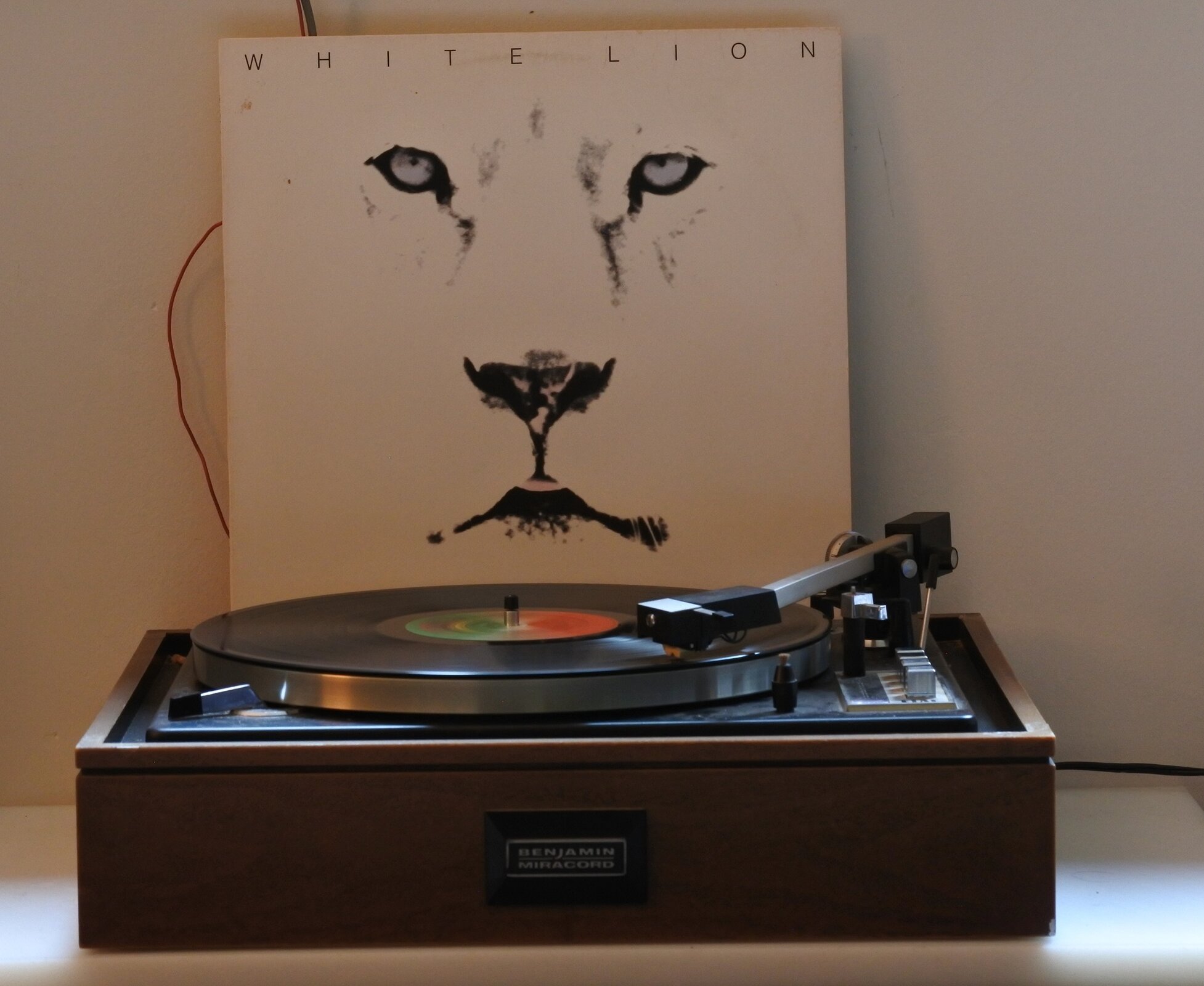

    One of my customers gave me this beautiful Elac Miracord 50H yesterday, I was dying to try it out so I fired up the AIWA TPR-950 above it and threw on some classic White Lion. I think these had strobe markings on a "belt" that breaks but it sounds like the speed is nuts-on. Unfortunately he sold off his large record collection and is now a lover of streaming audio.

    nice ELAC, i do have one exactly the same :drinks

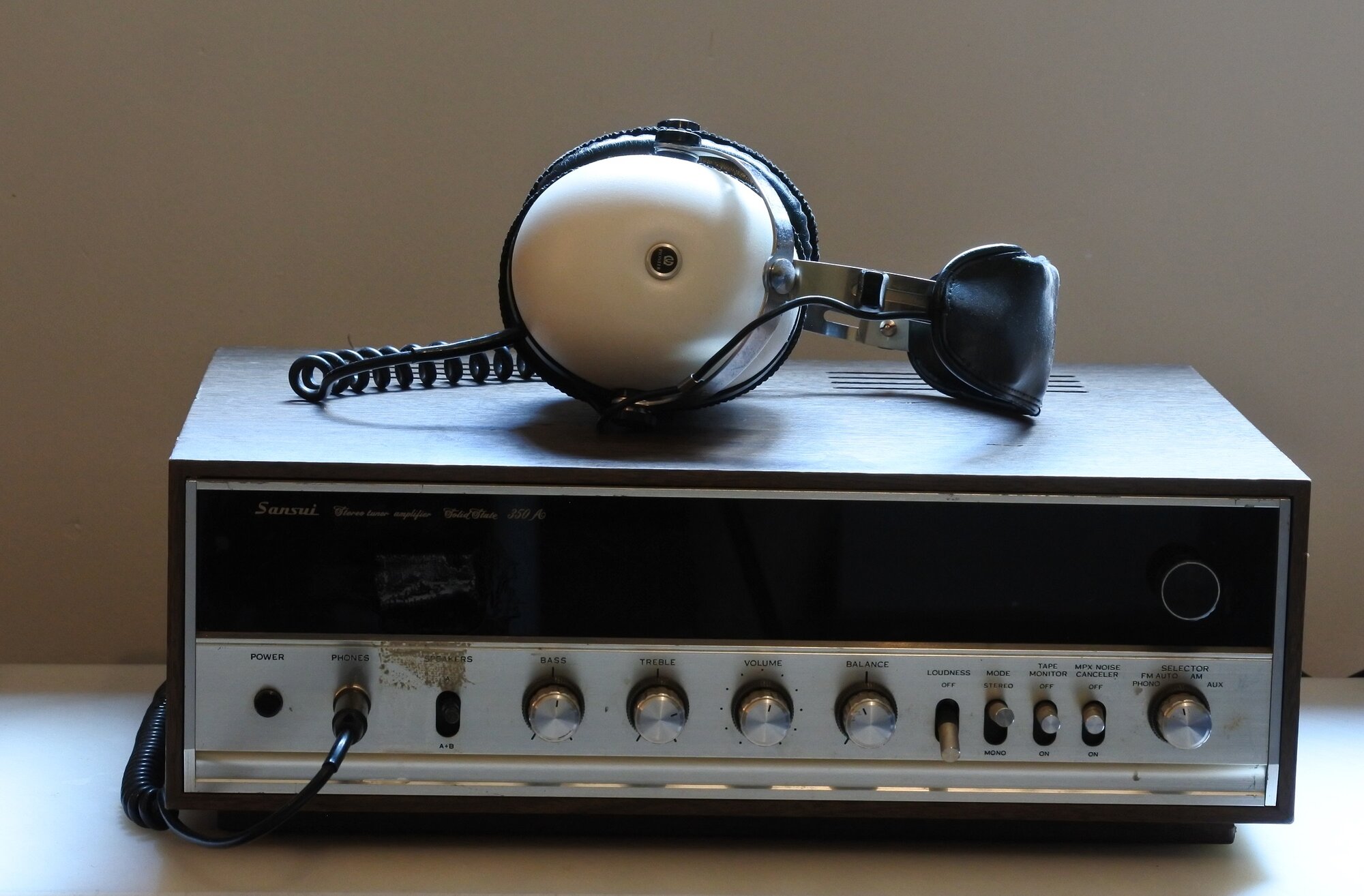

    I'm a sucker for Sansui Equipment, picked up this little 350A from the flea market for 20 bucks. It works just needs lights, the dial is impossible to see with out them. I haven't cleaned it yet, there's Goo-Gone working on the tape residue as I type, otherwise it's super clean except for the missing chrome cover on the speaker switch

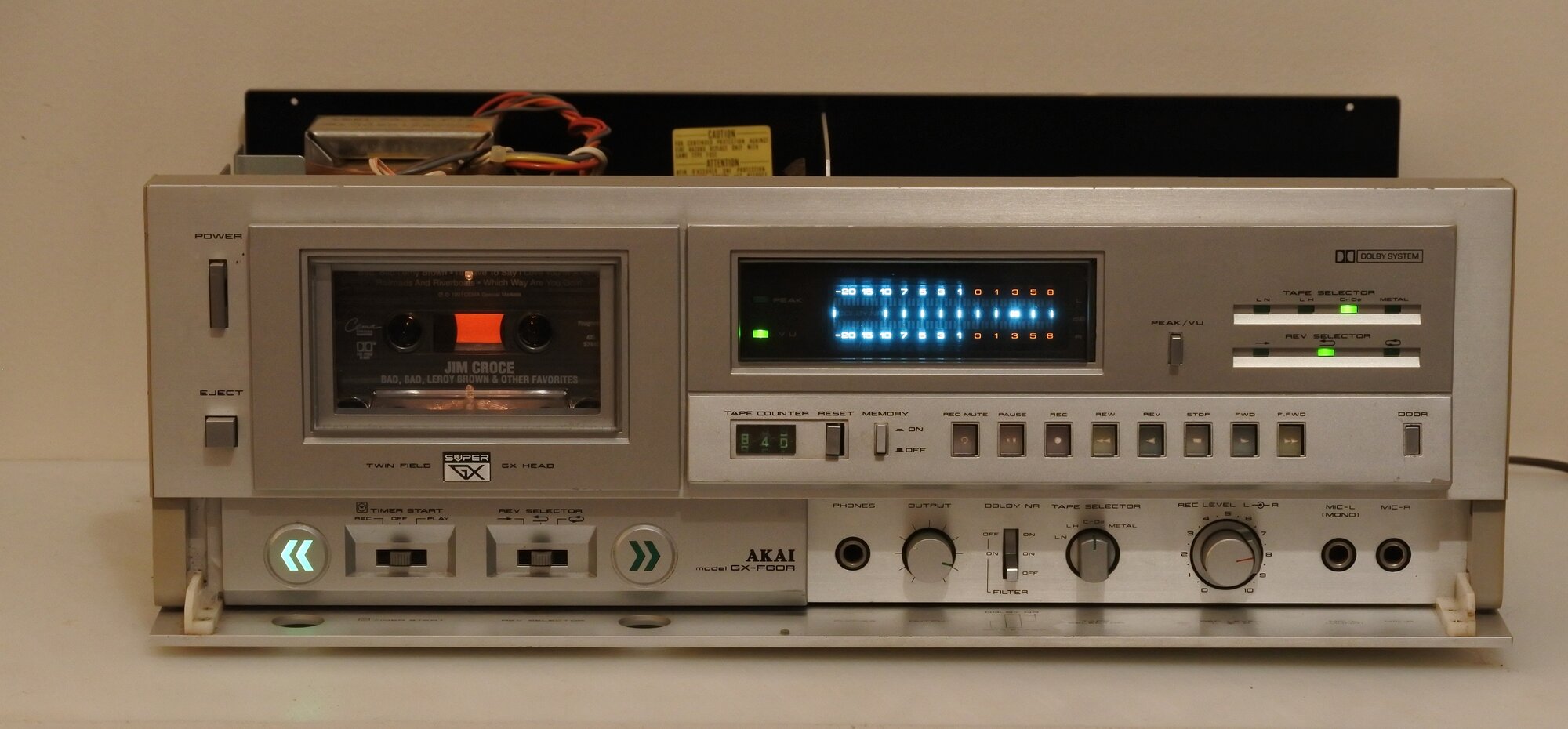

    So I got in a situation where the guy was clearing out everything and he threw in this gem with some stuff I bought. It was eating tapes but I took up the challenge. It's an AKAI GX-F60R from 1981 and it weighs a ton, almost as much as my big Nak TriRacer from the 70's. This has the problem that everyone talks about, it switches directions until the tape gets eaten, which takes about 7 seconds. I haven't seen an answer posted yet but I cleaned the hub motor assembly first. I engaged the switches, it runs without a tape and the hubs were moving slow. I cleaned the heck out of rubber parts, a metal knurled knob turns the rubber-coated hubs. I think dirt and lack of lube kept them from turning smoothly. Any way to make a long story short, it's almost good to go but I think I need to find a good lube for the hub reel axles, and a syringe to get into a tight spot without taking it apart.

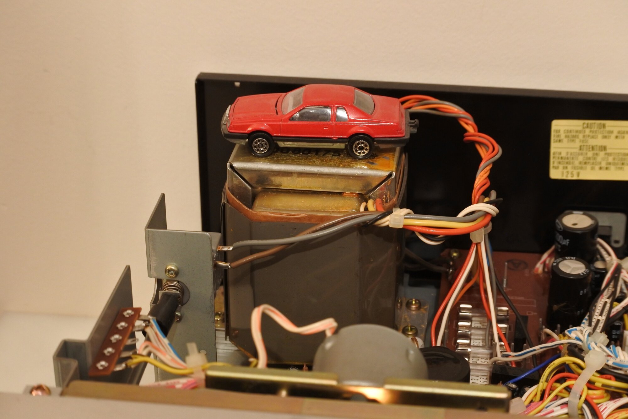

    Check out the transformer! It's huge! How many fuses are in this beast?

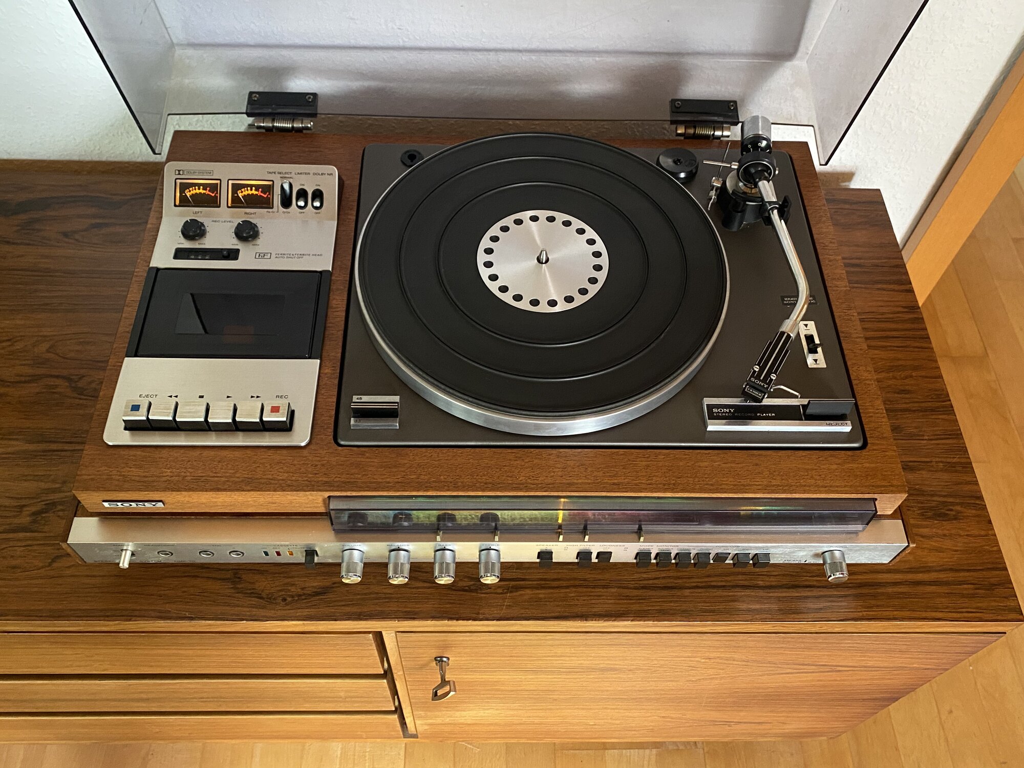

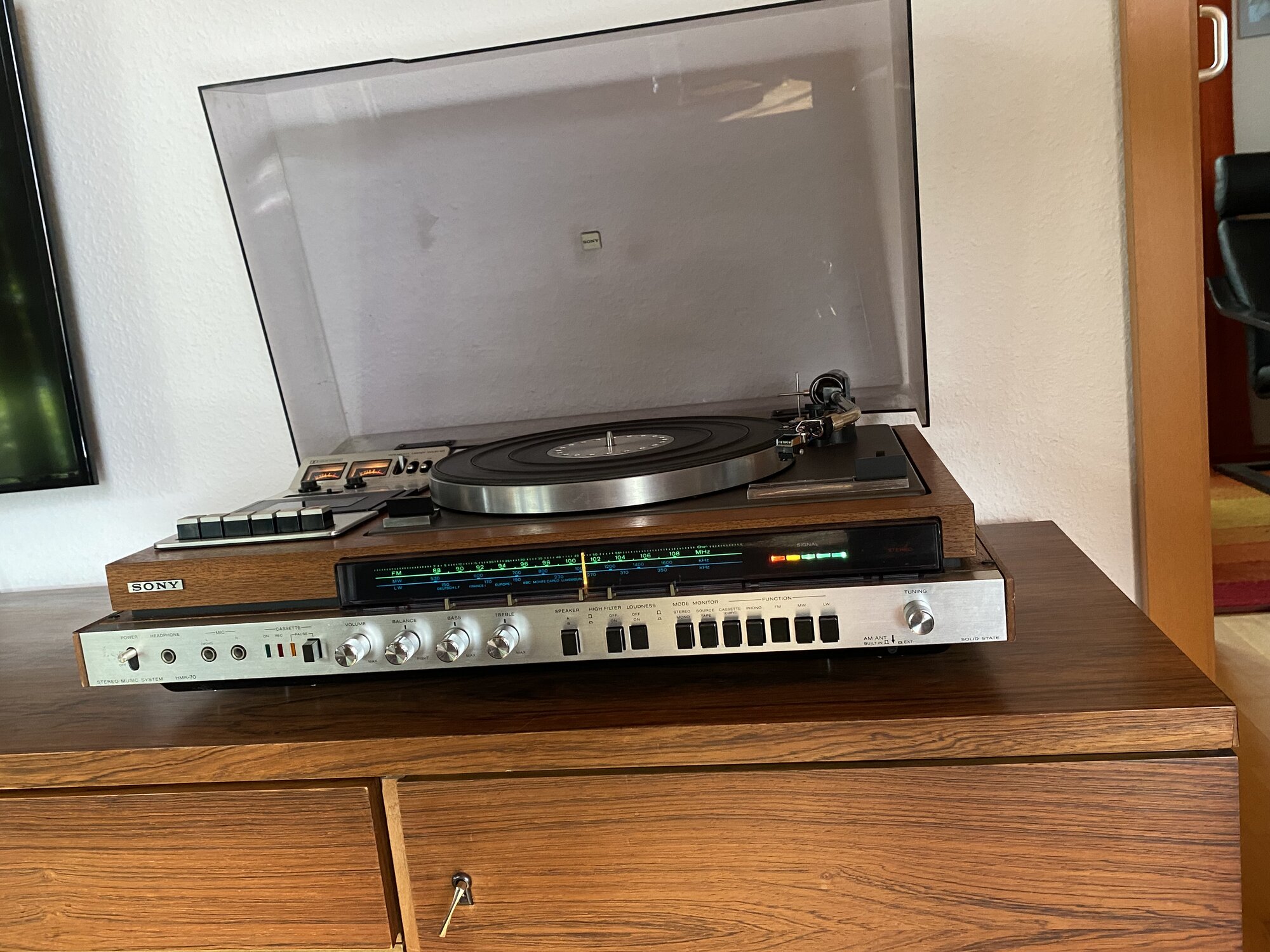

    got this beauty from local ebay: ca. 1975 Sony HMK-70
    tt was fooked - platter-bearing, a friend made me a new one and off course needed a belt, headshell was missing.
    funny the tapedeck is working. amp too, as well as the radio part:

    Nice. That would have been a middle managers pride and joy back in 1975.
    I have seen similar Sonys fitted with Garrard decks.
    https://picclick.co.uk/Vintage-Sony-HMP-40-Music-Centre-Garrard-MkIV-Record-124485497492.html
    The way the deck fits into the cabinet it would be very easy for them to change to a locally sourced one, depending on what the import taxes etc were for a particular market.

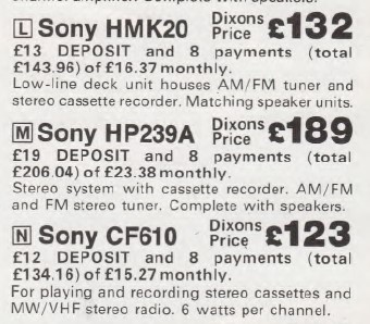

    p.s I just looked in the 1975 Dixons catalogue and I found
    The equivalent of about £830 in 2021 money.
    Yours looks to have a nicer cassette deck so could have been over £1000 inflation adjusted.

    Wow, what a beauty! We never had anything that cool over here, never knew why they weren't more popular. Is that a Sony by Lenco? It looks like one of their Idler's, even that's different from Longman's Photo. I have a feeling it was a better set-up.

    Beautiful @autoreverser seeing it from your photos makes it much better than from my small catalog

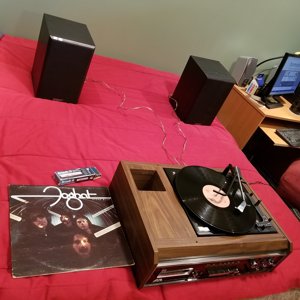

    Very nice all-in-one unit, autoreverser!

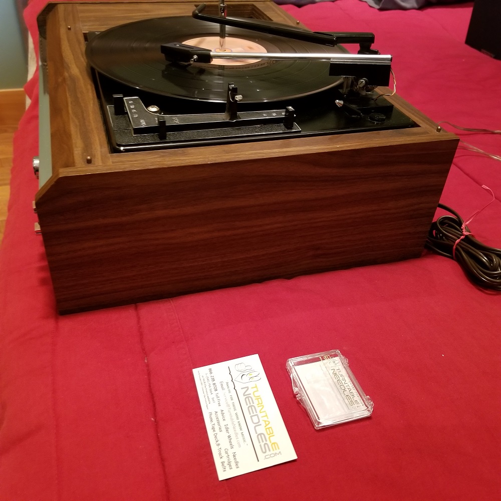

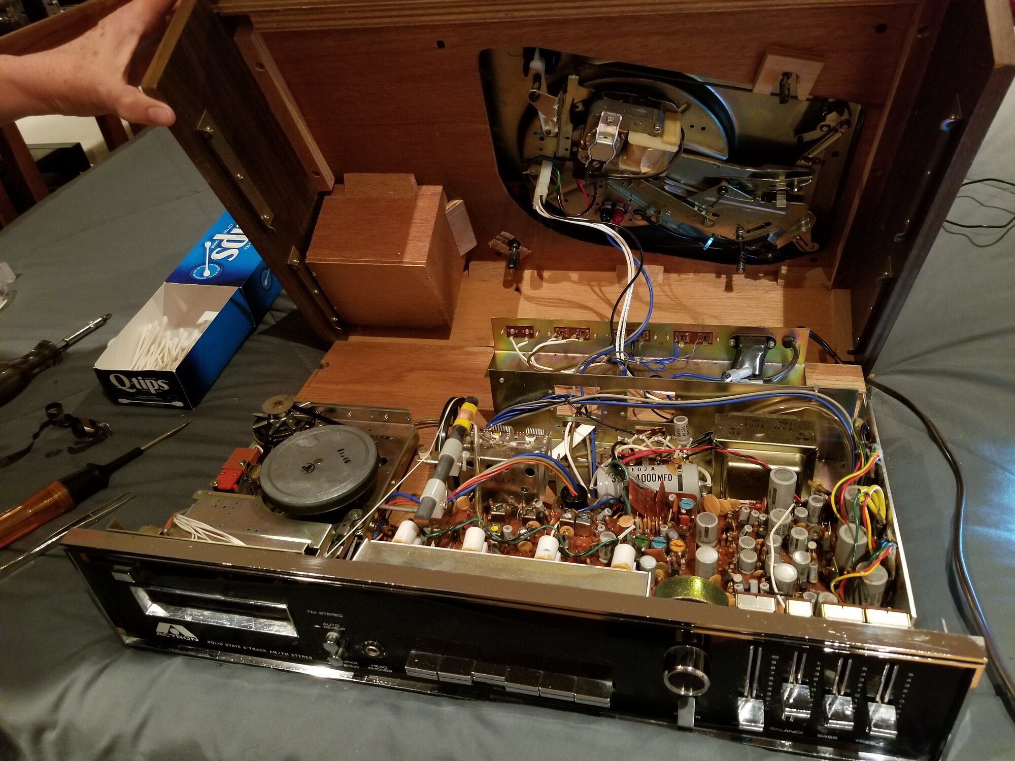

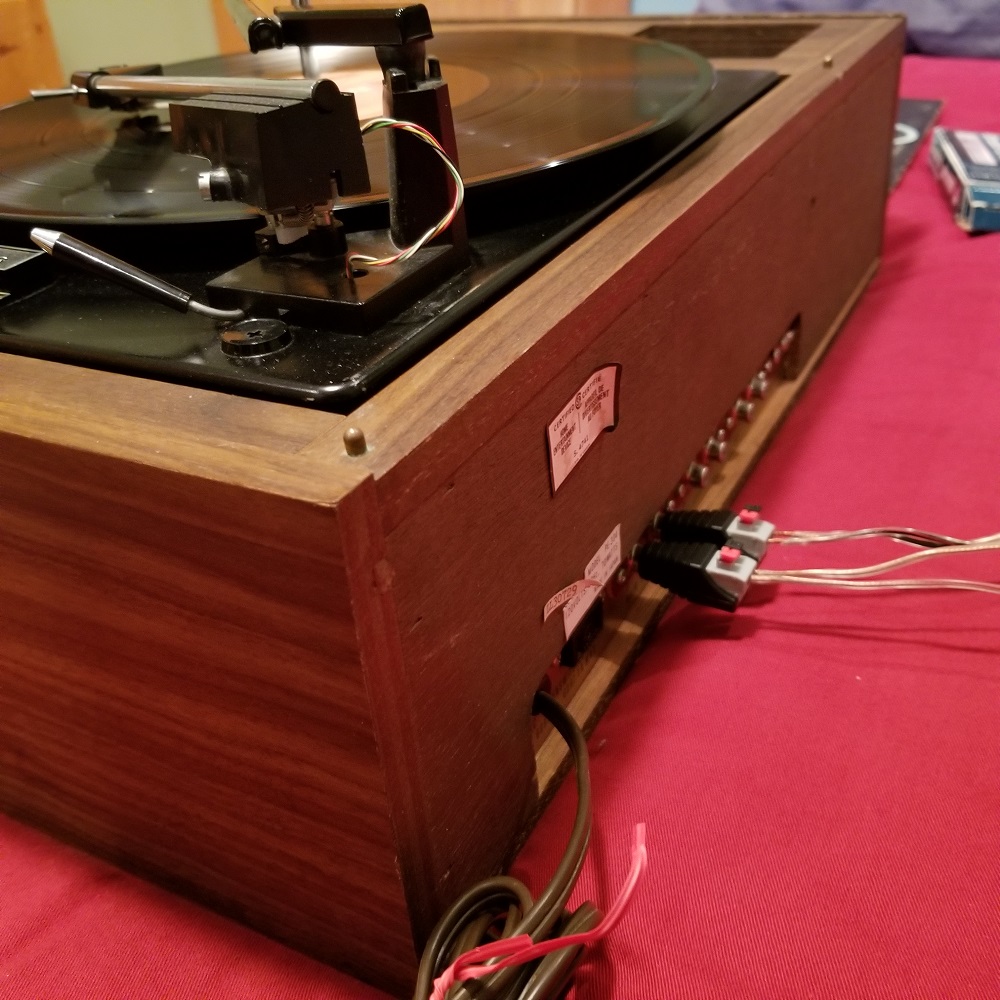

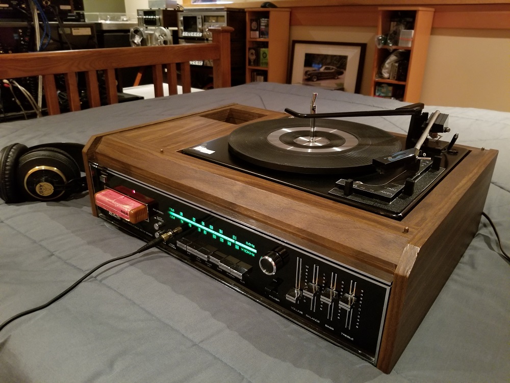

    I picked up an Actron PE-304 at my local thrift store in as-is condition for $20. Disassembled it, lubed the linkage for the BSR record changer, cleaned all of the tape path for the 8-track deck and ordered a new stylus for the cartridge. Once that was done, I gave the exterior some cleaning. I bought some inexpensive speaker adapters for the RCA connections on the back, too.
    And a video of it playing a record:

    That thing looks like it weighs a ton! Check out the huge transformer and monster caps.

    it‘s a beauty - after all it will burn longer than my Sony :smoke

    it‘s not an idler-drive, it‘s a belt-drive. in fact, the tt is a Sony PS-5100
    https://www.vinylengine.com/library/sony/ps-5100.shtml

    Proof that such systems made it to North America. I was going to comment on the 8 track, but know they were far more popular there. In Europe they were going out of fashion by the mid 1970s.
    Your internal photos show how manufacturers could buy bits in (like the record deck and cassette deck) and stick them in a case to make a system. From being the latest thing at the start of the 1970s they were going out of fashion here by the start of the 1980s. A teenage friend bought one of these (the tuner amp) and built his own system.

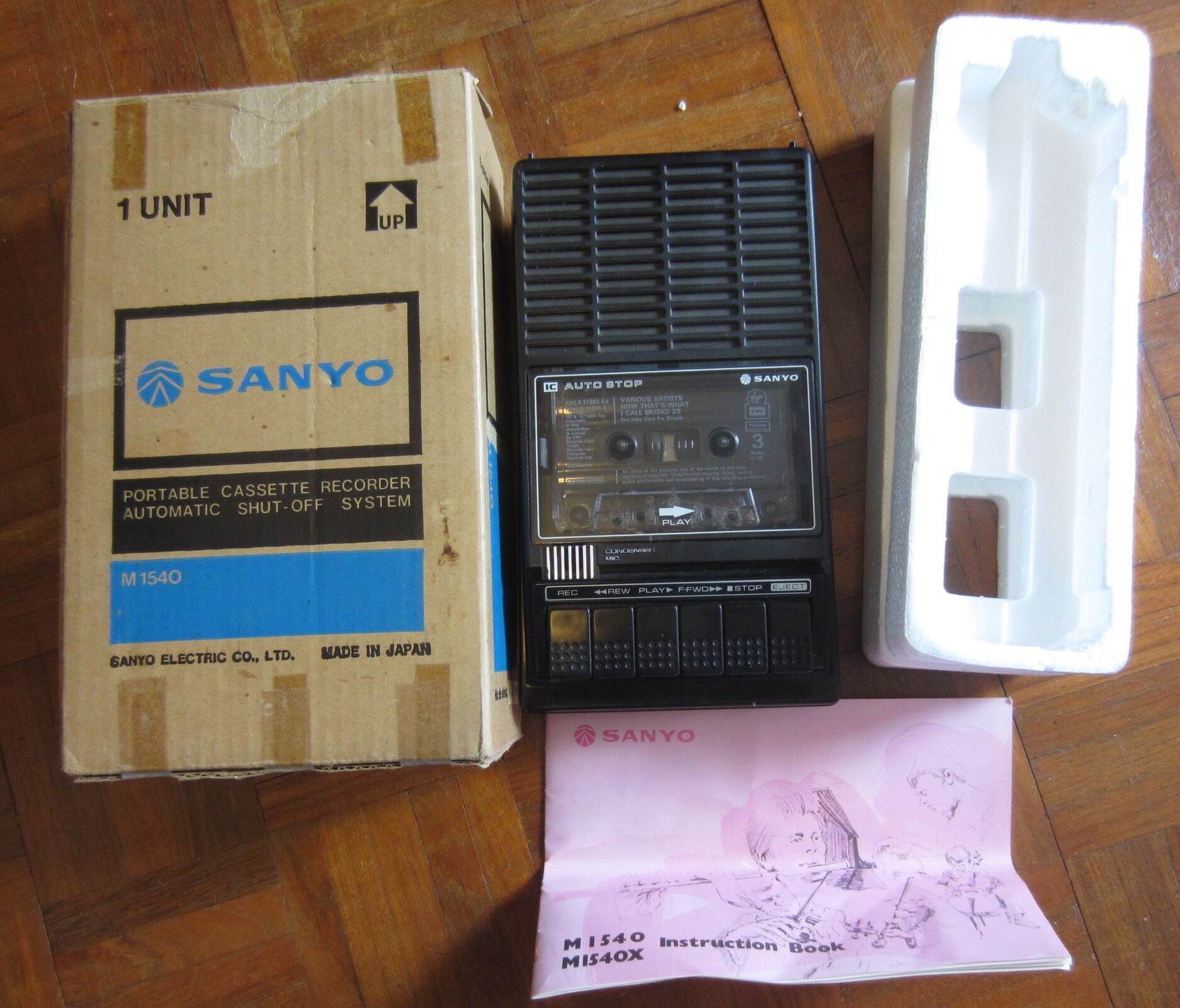

    In contrast to Executive Music Centres, here is the sort of thing they might have bought their kids.
    At £15 I definitely overpaid for this in a local charity shop, although the money will end up going to a worthwhile cause, plus it looks absolutely new complete with box, polys, and instructions. Testing it I have just discovered why. Extremely weak audio with background motor noise. I will need to investigate. It wouldn't surprise me if a wire has fallen off the head or a capacitor has dried out.
    p.s. It is slightly older than I thought and seems to have a Commodore connection

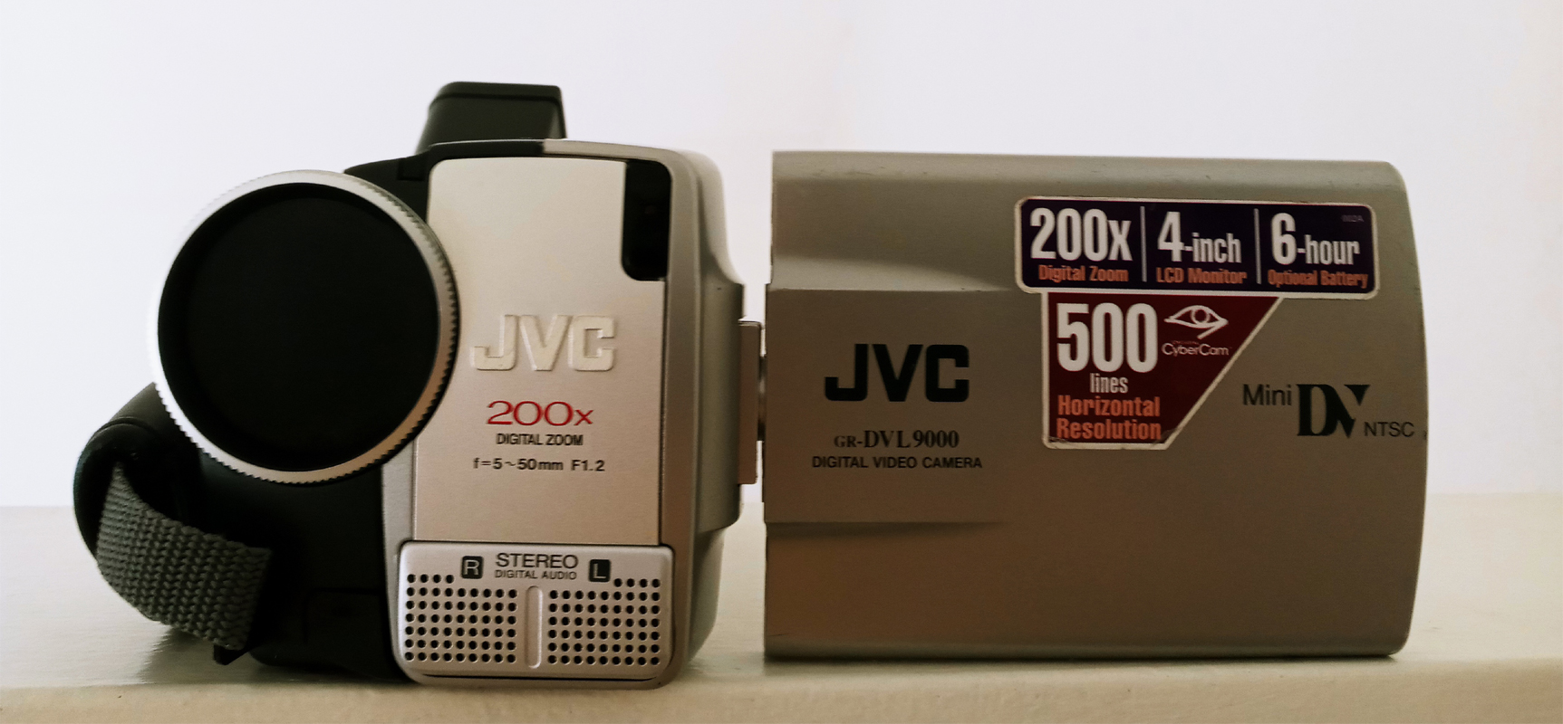

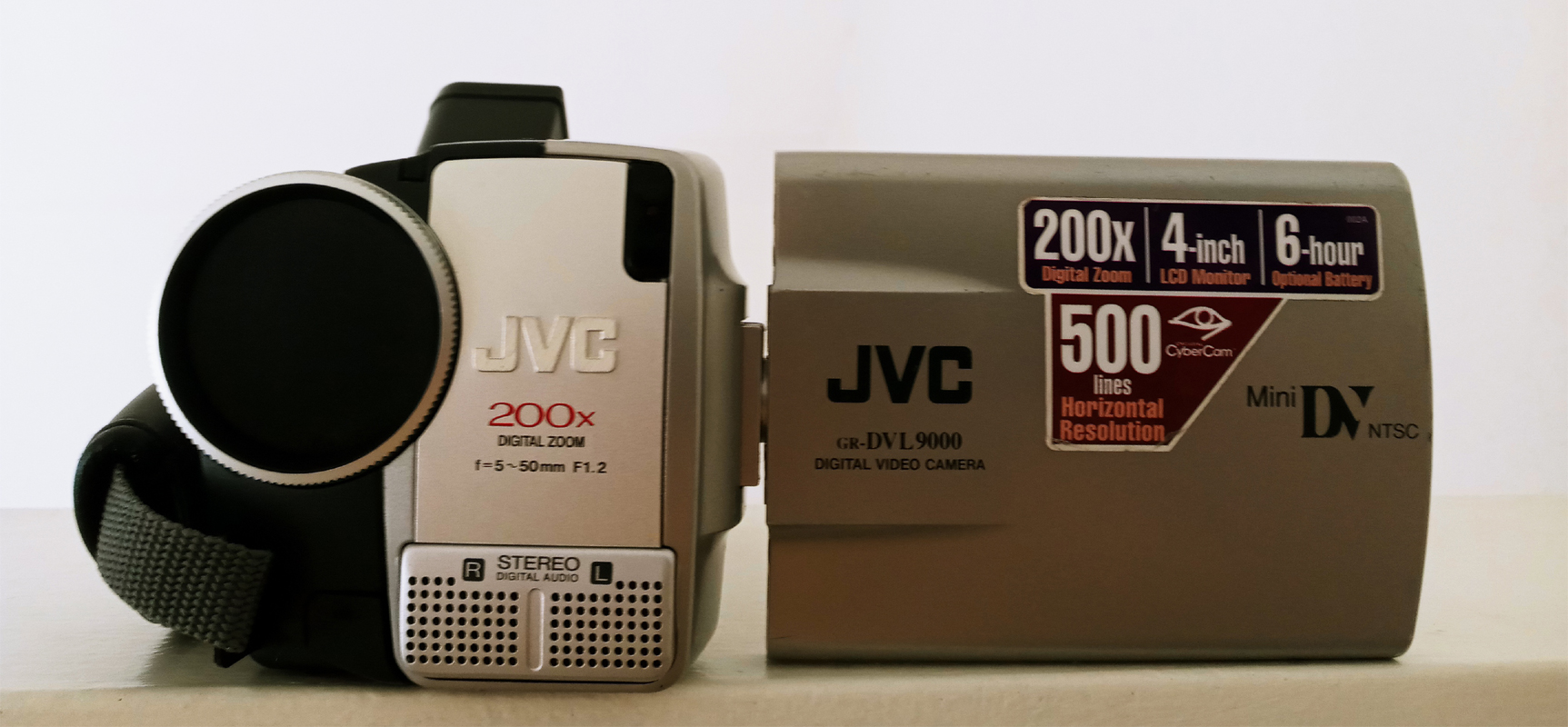

    Finally, I made a video about the JVC GD-DVL9000. :)
