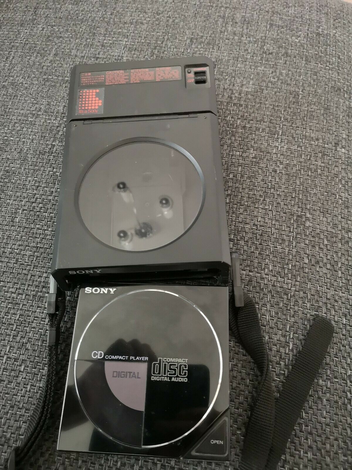

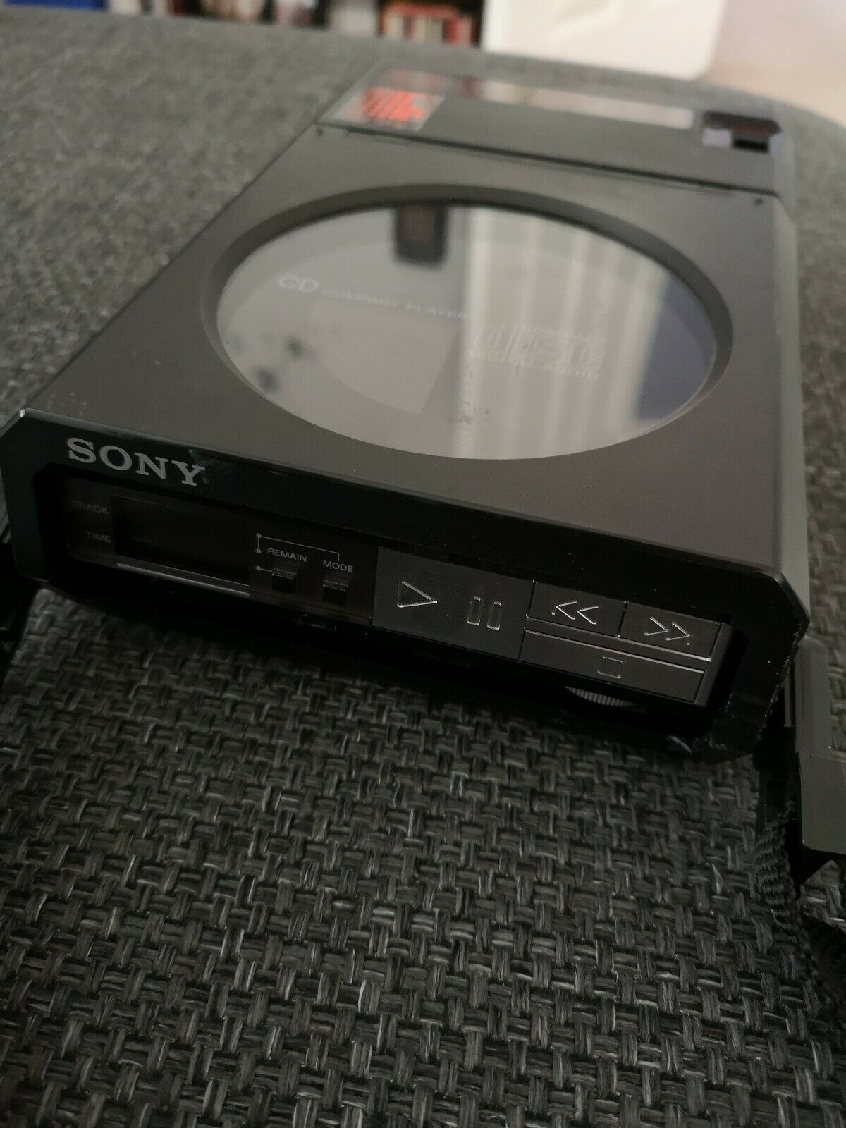

    I don't know what possessed me to pull a trigger on this one today on epay
    but... :) Maybe because it's the very first one Discman, even without this tag yet,
    Was declared as untested so will see.

    You must have been reading my mind Mystic Traveller, I've been searching for a certain fairly rare mini CD player today, not the beautiful unit you recieved but another Sony. I don't think I've ever seen that case before, it must have been extra.

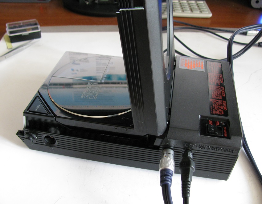

    Yep, since it was the first discman it wasn't really portable due to necessity to have this external case,
    it's actually a battery one + giving some protection as well.
    This is EPB-9LC Battery case:

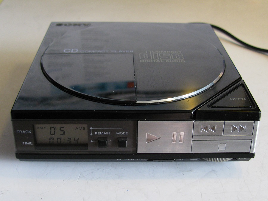

    Hope so but I found out that somehow it had reverse DC power polarity with Center "-"
    and if attention not paid to that fact somebody could have damaged it.
    Yes, I read that about D-50, that's this machine is "hard to kill".

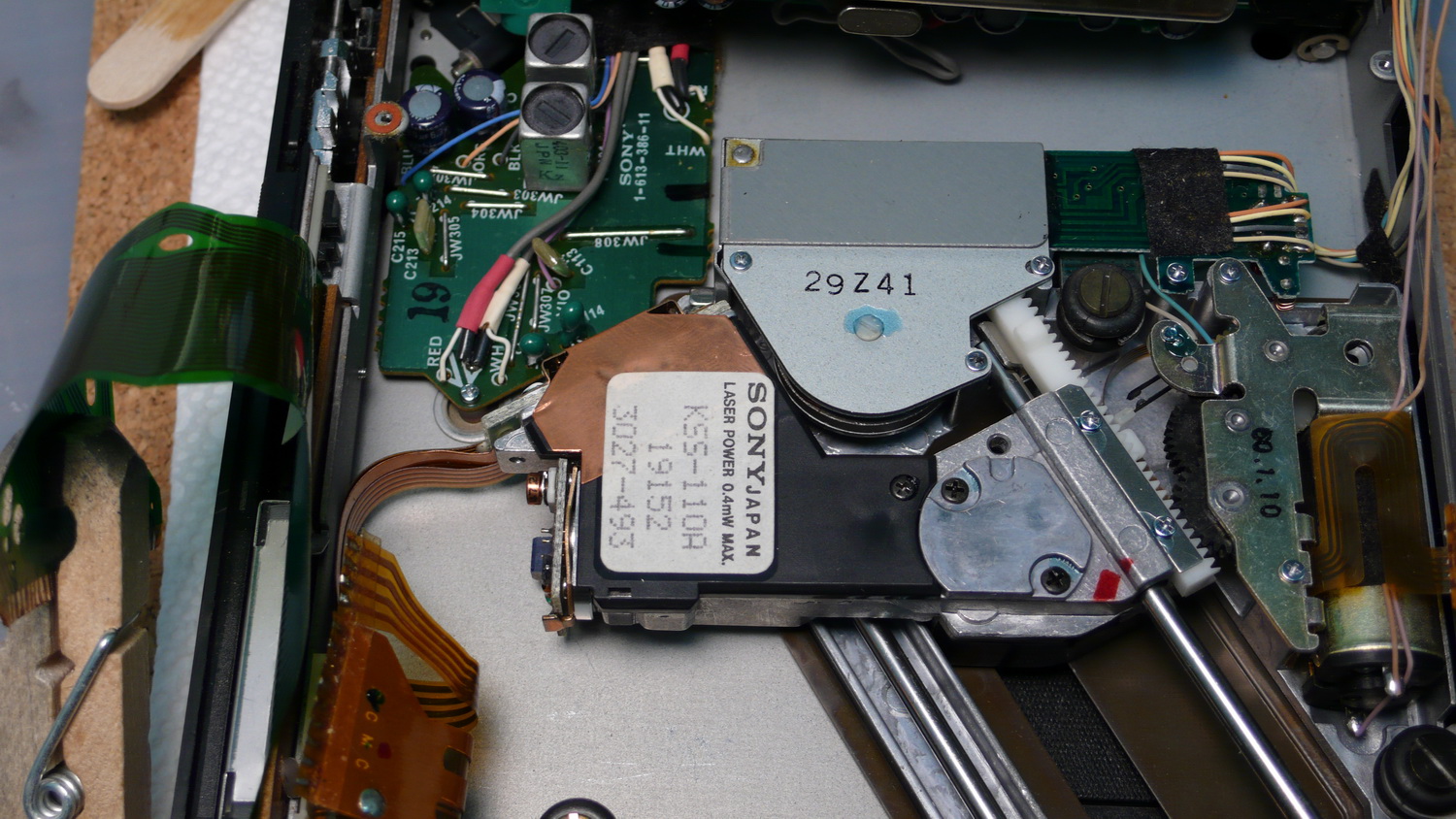

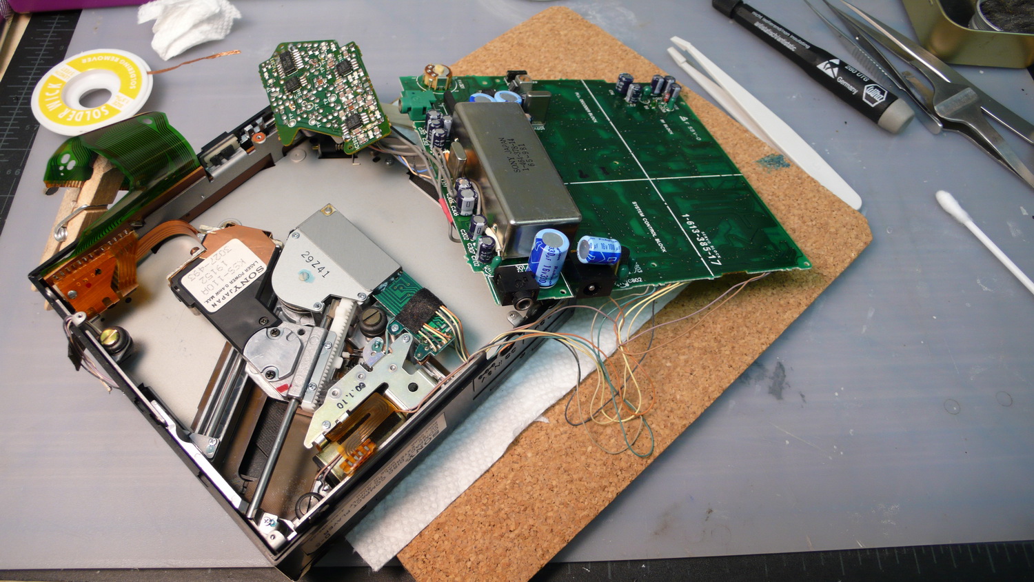

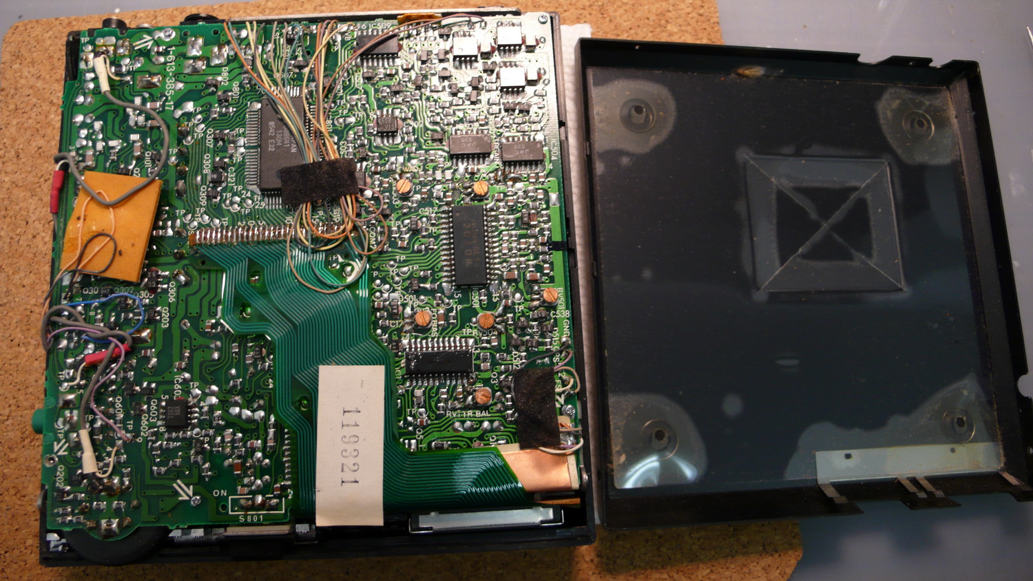

    Are those pics of an disassembled D-50?
    P.S. A-ha, got a closer look - D-5 - the same machine.. :)
    CX20133 multibit DAC - made by Sony itself?
    KSS-110A Sony pickup - ebay doesn't know about it at the first glance.
  14. Jorge
    1,794
    True! Actually, all good Discmans have center pin as negative. By the time they realized that "ground" is also a "shielding", they also figured how to make cheap Discmans. Sound quality of most "center-positive" Discmans is indistinguishable from MP3 :mad:
