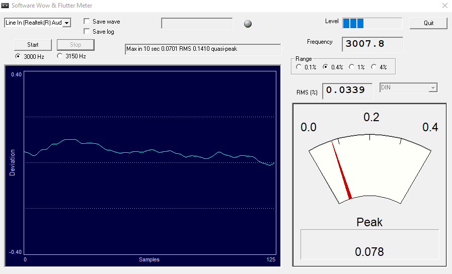

    The W&F I got ranged from 0.12 to 0.08, mostly stabilizing at 0.09, 90% of the time. I used tapes from Duplication.ca, 3000hz.

    Actually, I went back and checked it again, and I found out that my pinch roller assembly was bent, causing excessive wow. Now I've fixed that the wow went to ranging from 0.06 to 0.03, stabilizing at 0.04. Actually quite impressive. Speed was a little fast as well here on the picture so definitely will need to calibrate that as well.
