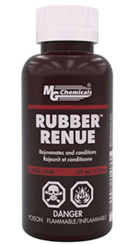

    19,593
    In case the capstan is harder than normal, I've used Rubber Renue to soften it up. Sometimes it lasts awhile, sometimes it helps with finding problems before getting replacement rubber.

    Rubber Renue is good for rubber things, there's also a similar one in Europe called Nowa Guma which does the same thing.
    But for the most part if roller isn't glazed or hard as a rock I wouldn't suspect it.
