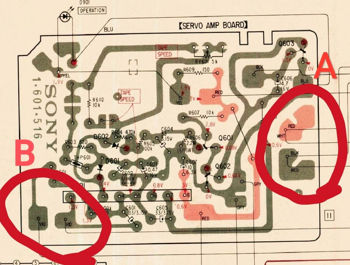

    Hi, I’ve been trying to repair a Sony Walkman TPS-L2 for a while. It arrived with a stuck motor and worn-out belts. I managed to free the motor using some watch oil and replaced the belts. Now the motor runs, but the Walkman stops after a short while. My hypothesis is that it’s an issue with the speed adjustment on the SERVO AMP BOARD. Here are my observations:
    During playback, the sound runs fast.
    The motor stops even when the belt is removed.
    If I wait a bit, the motor stays on longer (~5s); if I apply power again, it shuts off almost immediately.
    As shown in the photo, at point A I have 2.7V when powered on, and at B 1.4V. When off, B goes down to 0.5V and continues to drop (capacitor discharging).
    From these observations, I rule out the mechanical part since it stops even without the belt. I suspect it might be a capacitor issue, which could explain why letting it sit for a while (allowing the capacitor to discharge) lets it run longer — probably by opening the circuit on the transistor, I imagine. I might be on the right track, but I’m not 100% sure about this hypothesis.
    The capacitors have too low a rating to be reliably tested, so they would need to be replaced directly (something I’d prefer to avoid, especially since many are hard to find or would have to be ordered).
    Just to be sure, what else could it be? I’m also attaching a video of the problem where I do normal play, rewind, and then play twice in a row:

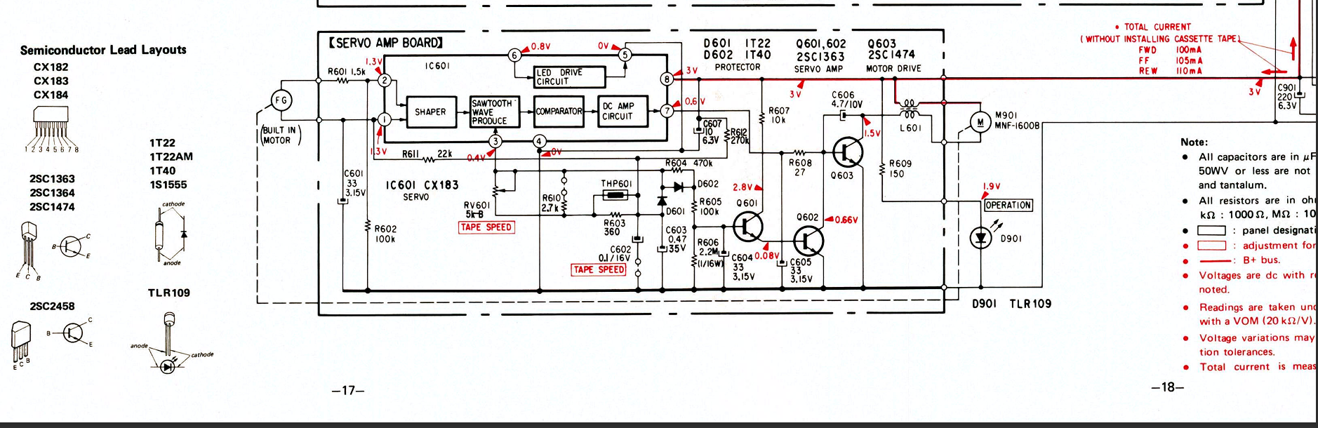

    check if you have these voltages marked in red

    Ok, I did a check and indeed pin 3 outputs 2.7V instead of 0.4 (pin 2 also has a different value, but it’s correct when the motor is running). I also checked the whole part of the circuit around pin 3 and everything seems fine. At Q601 I’m getting wrong voltages at its terminals, but I think that’s due to the output voltage from pin 3

    Exactly, I also noticed that the motor shaft has quite a bit of play. Anyway, I disconnected the motor and, when powering it externally, it runs correctly, and from the coil output I get a sine wave with 0.03 Vpp.
