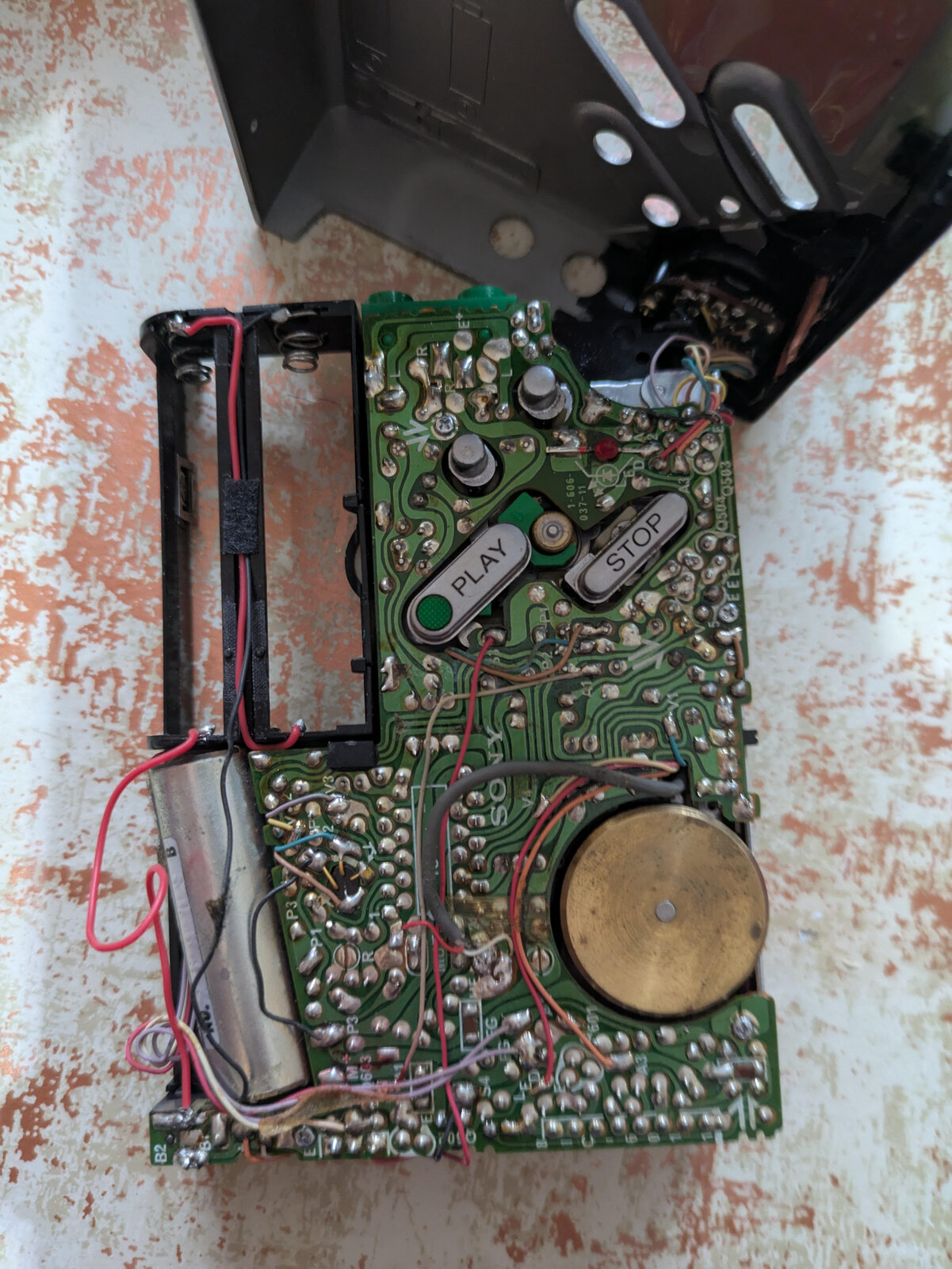

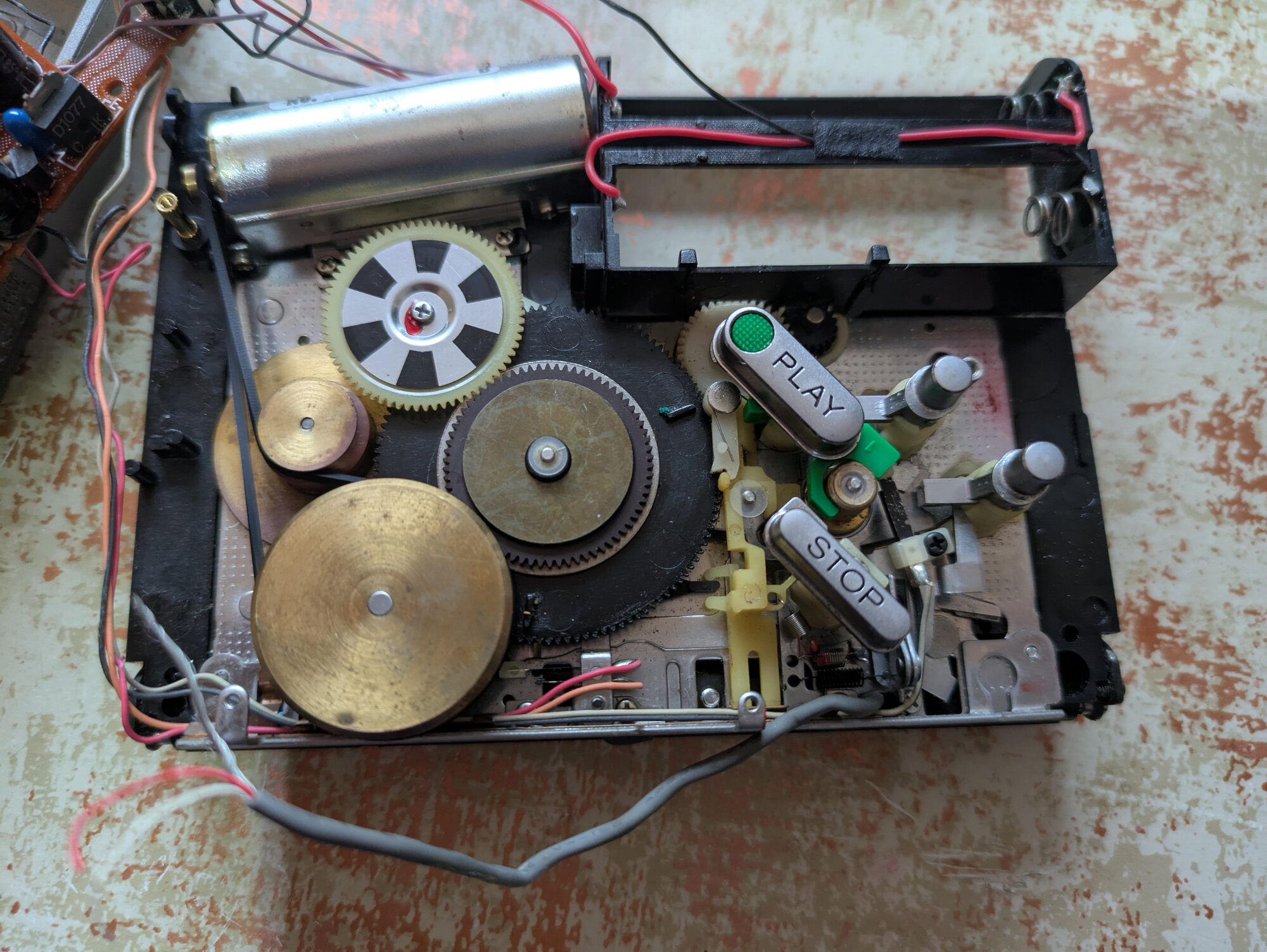

    Adding some images finally of the board and motor assembly:
  3. Valentin
    2,122
    Marked the clutch on the attached picture.
    However can't know if this is actually the problem. If you don't have a good feel of what a normal takeup torque feels like, it might feel it's too high even if it's not.
    Hence why I would suggest to compare it with any other walkman/cassette machine you may have in order to get a good feel.
    Test with stopping the takeup reel should be done with 2 fingers and you shouldn't struggle to stop it, but it should take a bit of force to stop it.

    It was completely seized up. I popped off the retaining washer and popped the clutch and washers and they were all very heavily stuck together. I'm cleaning them now.

    Clutch does need some grease on the middle, where there's friction between it and the middle plastic hub.
    If you want a small drop of oil can also be added on the nylon washer that separates the magnetic part from the metal disc.
    None of the 2 is critical, but it will reduce wear over time.
    For others reading this thread, this type of clutch is magnetic, so oil on the nylon washer will not change the takeup torque like it would on a clutch with felt pad.
