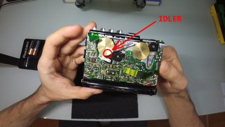

    Hi everybody!
    I've got a WM-55 walkman, changed rubber belt, so now it rewinds a cassette well in both directions
    But it does not play cassette and I can't get the cause
    There's a video below, maybe somebody knows how to fix it?
    And there's a video from the other side: youtube link
    There's a service manual: google drive link
    Silver965 likes this.
  2. Valentin
    1,370
    Hi,

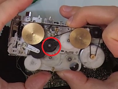

    From what I can see in the video, the takeup reel does not turn when in play, hence the autostop mechanism engages and stops the unit.
    What I would check is the clutch (I highlighted it in the picture attached), because that clutch would only be engaged in play, not in FF/REW.
    Either the clutch is slipping or there are some gears that have hardened grease on their shafts and are very hard to turn. Check that everything is moving freely.
    Good luck !

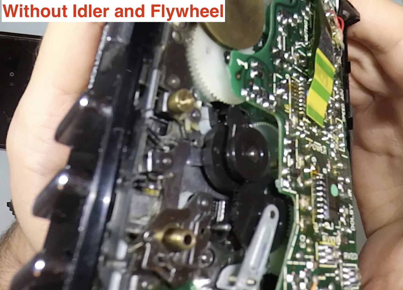

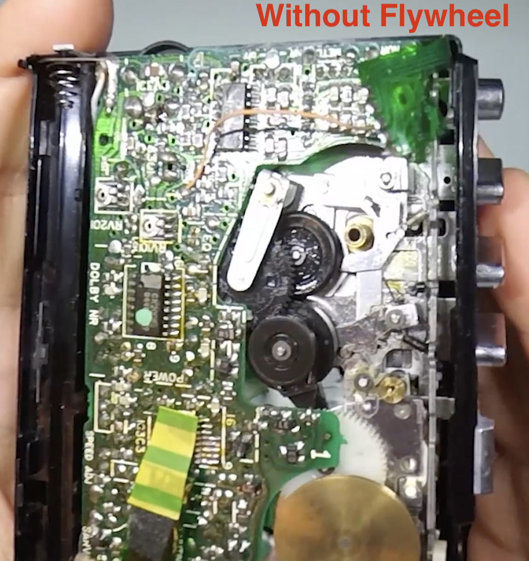

    There's an idler wheel under flywheel
    And it looks like there's not enough friction. Don't know why

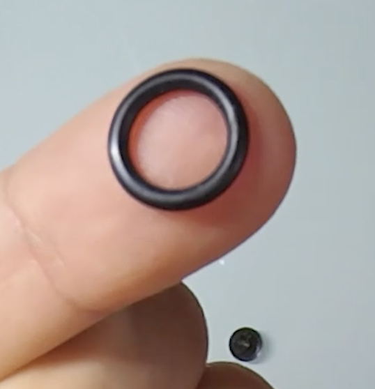

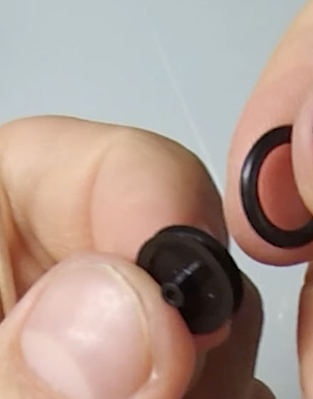

    Disassembled Idler looks like this:
    [​IMG][​IMG]
    That rubber ring has a circular cross-section
    I am not sure that it's an original part
    For some reason, people sell that idler rings with square cross-section
    For example: ebay
    I cleaned it and assembled walkman again, but it didn't help much. It slowly spins a cassette, but still not enough
    So I am waiting for new rings with square cross-section, hope it will help
    FYI WM-55 idler disassembly video
    If somebody has an image of the original idler from Sony WM-55, I'll be very grateful!

  6. Valentin
    1,370
    You won't need a picture with the original idler. Mihokm is a member of this forum and his parts are very high quality and identical in shape to the original.
    The original one was square section for sure (all idlers are square section), like the one Mihokm sells on ebay.
    The one in your picture is not an idler tire, but an o-ring that was used as a substitute. Sometimes they work, sometimes not.
    I'm glad you found the problem ! Given that you have taken the flywheel out, I also recommend putting oil in the bushings of both flywheels.
    And of course clean the capstan after that so it won't contaminate the tape and pinch roller.

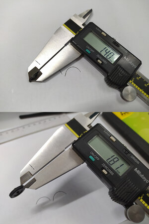

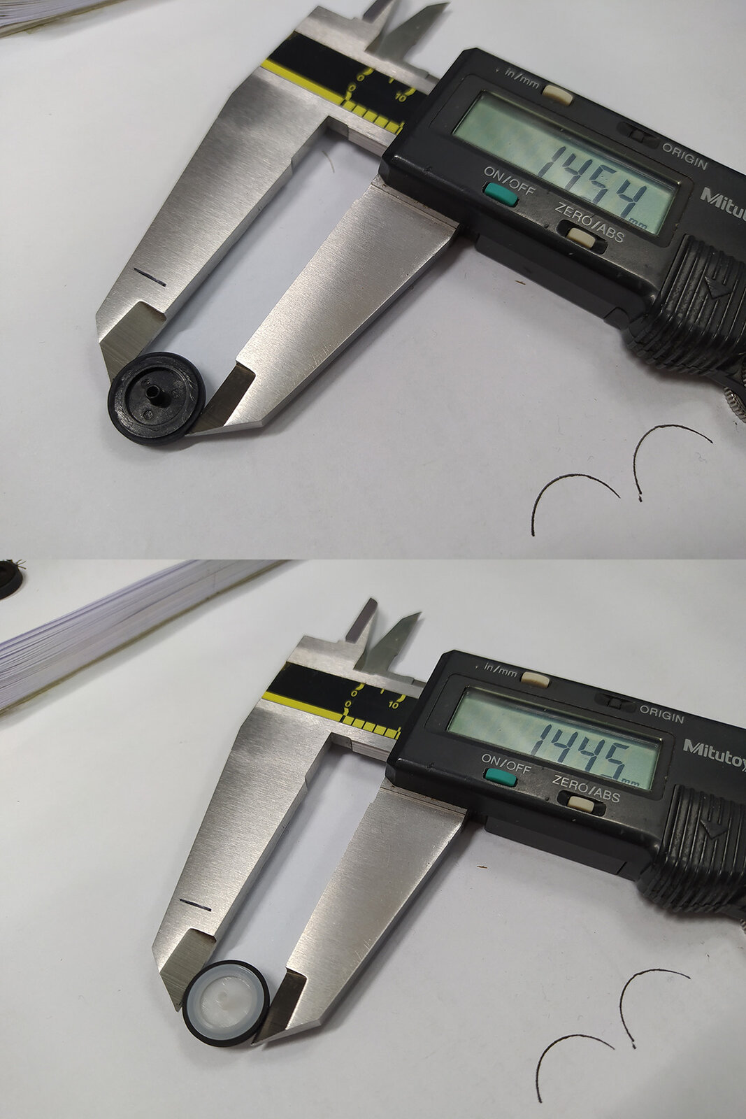

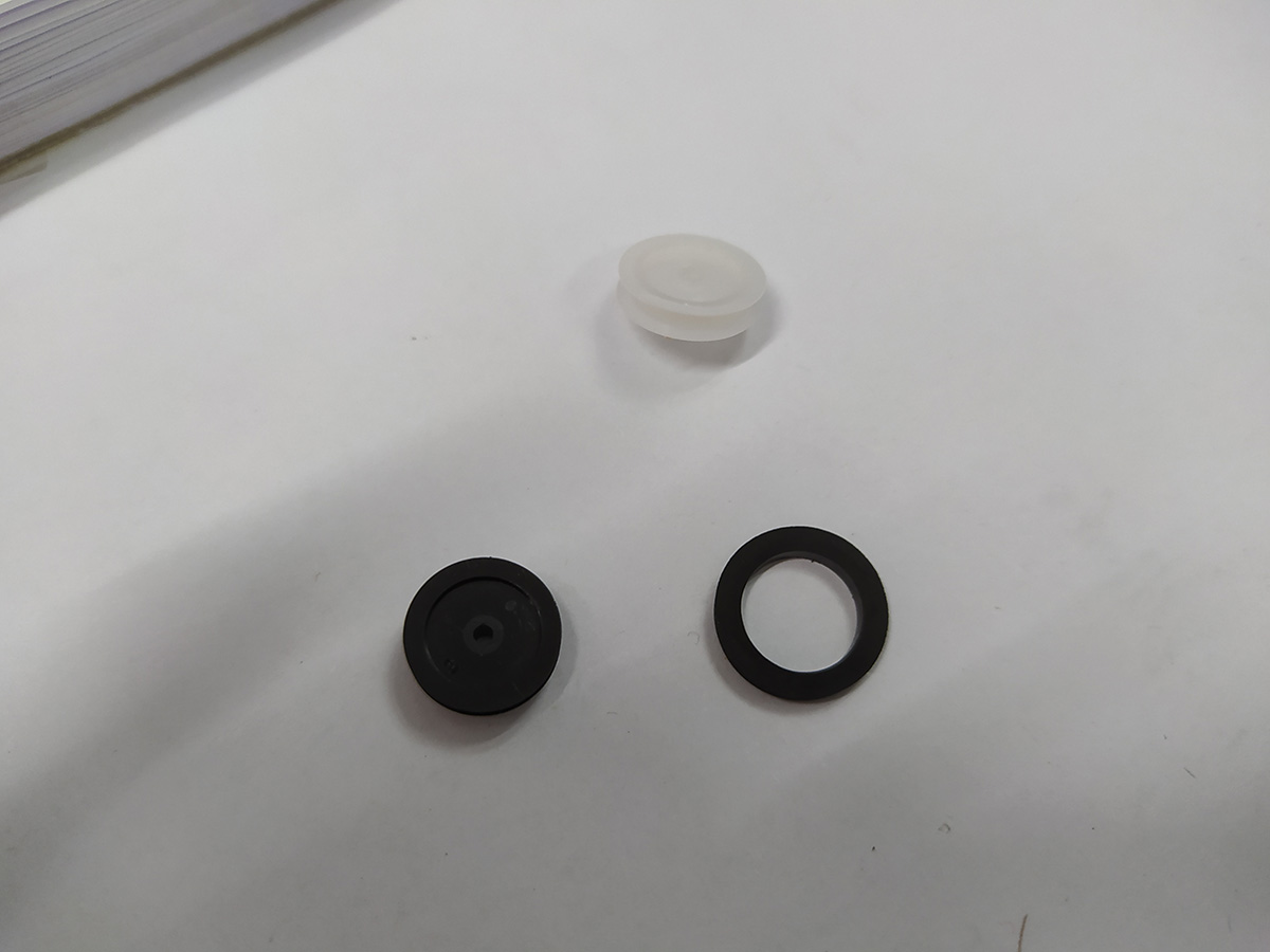

    I'm so glad my WM-F60 already working ,all parts work smoothly and the sound is fantastic.I have bought two FWD idler(general for casstte deck) ,but it's seems the thicknees of them is a little difference with the original one(1.4mm) .so I only use the rubber ring finally and the rubber ring need and do some change use a 600 sandpager .
