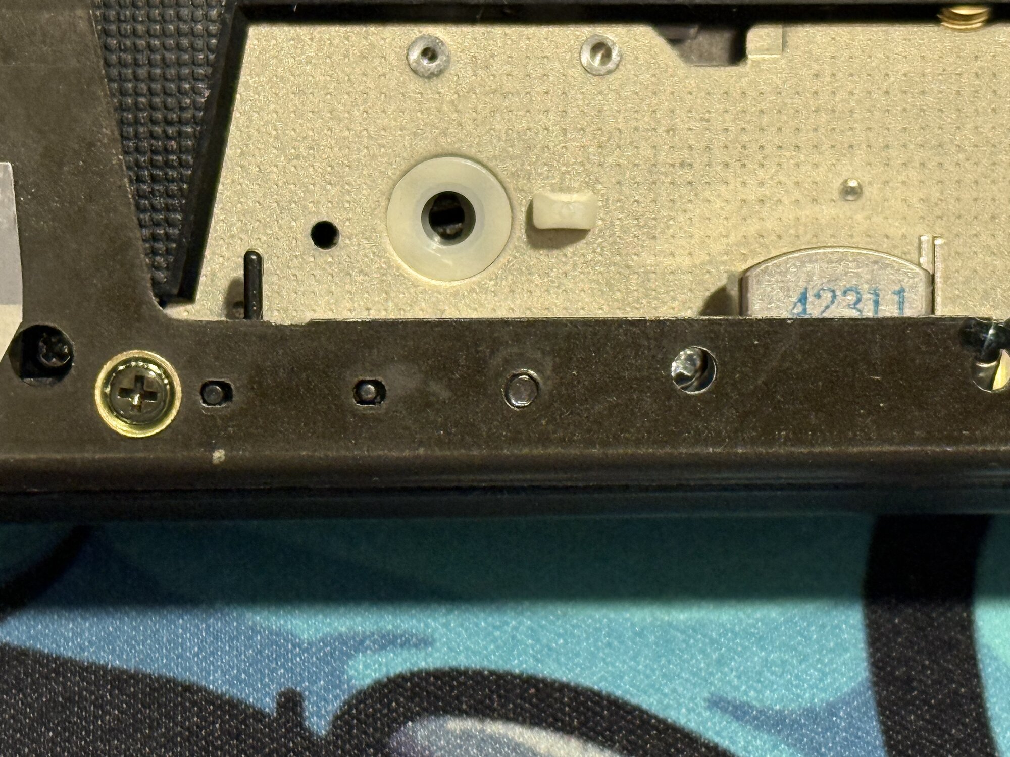

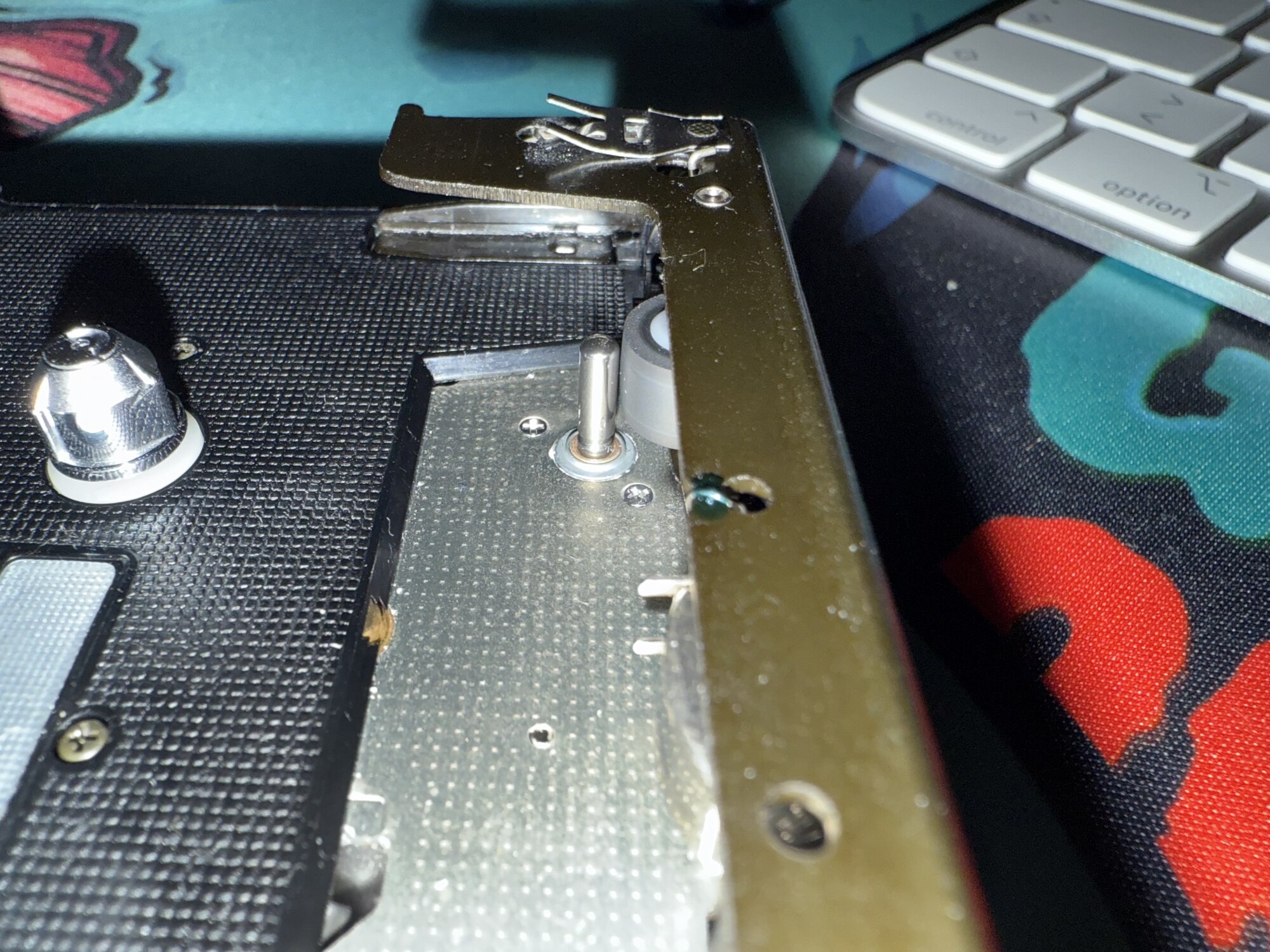

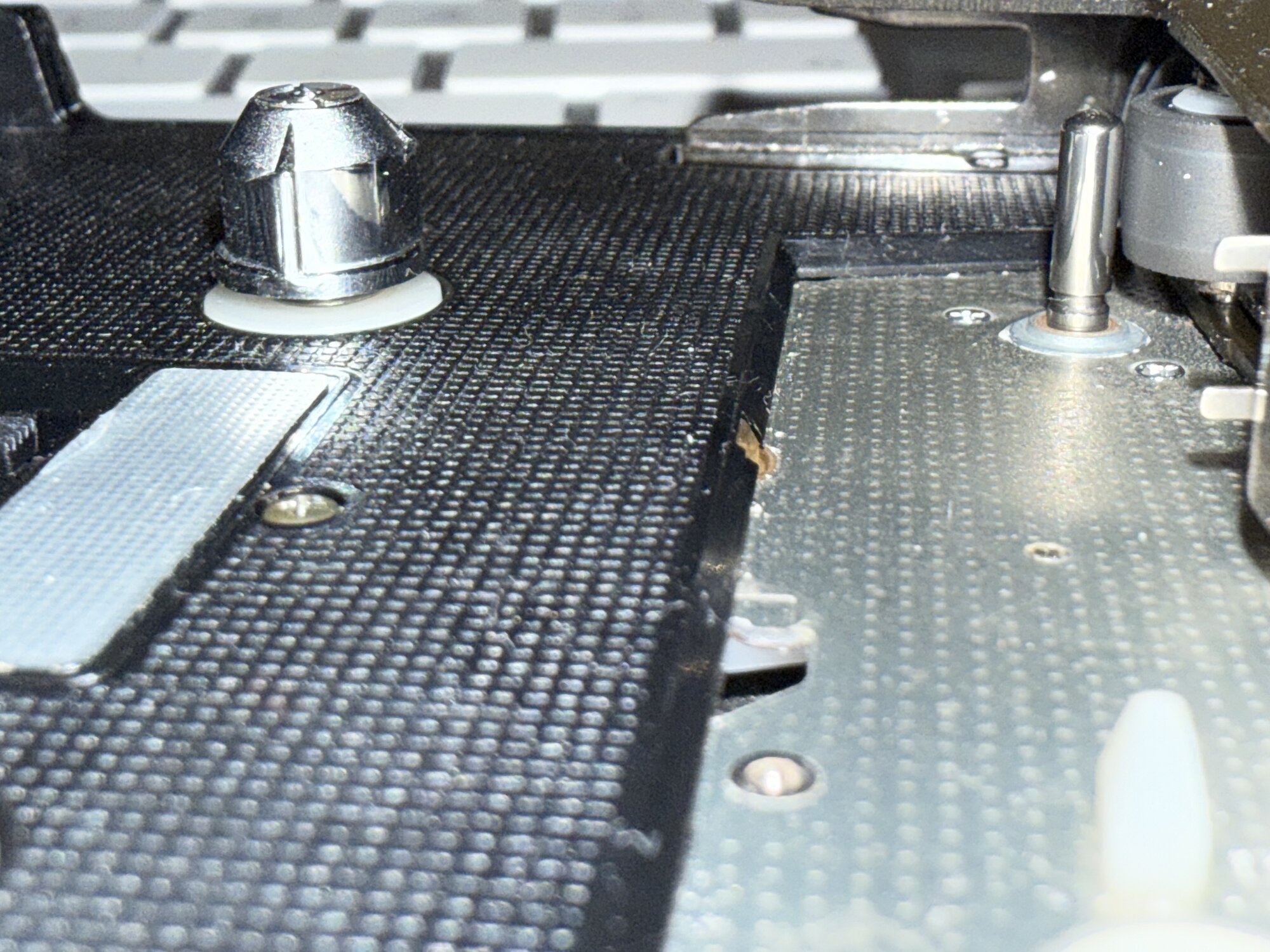

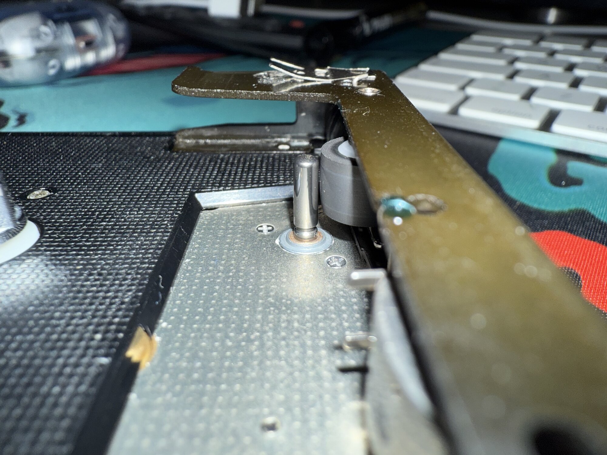

    Update, I found the issue with muffed sound, and slowing down the speed after reading https://stereo2go.com/forums/threads/wm-dd-azimuth-instability.7590/ by @Valentin.
    So I removed the door and tried to play this heavy Maxell UR90mins tape and what I found out that the moment i help a bit with the finger pushing the pinch roller, the speed recovers instantly.
    So it could be related to the issue he described even on the old pinch roller looks equally worn. and when I try to push the roller while not playing just to see how it travels up and down I dont seethat the inner part of the roller is far from the rotating capstan.
    Now I am just now thinking what to do, to bend the bracket to somehow increase the tension with existing spring or replace the spring. But if I want to replace, which one to buy... :S

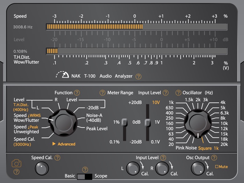

    I have not taken the screenshot with me, but I remember that the frequency I measured when assembling walkman was from 2985 as lowest peak and 3005 as highest peak.
    However, the tape I have with 3000khz recording was recorded at the beginning. The issue I was having with slowing down is happening in the last 10-15minutes of 90mins tape only, and I tried applying slight pressure with my finger to the pinch roller bracket, the speed stabilizes instantly and I have not noticed any w&f. I have tried to bend the roller bracket part where the spring is attached and the issue was significantly reduced, now I can barely notice the slow down in the last 5 minutes of 90mins tape.

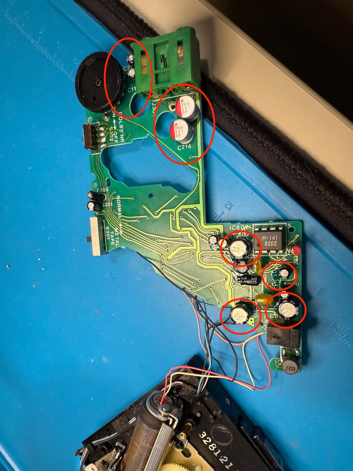

    Ok, yes, you are right, I got those caps from Marian, I will try to change them too and to clean again the rubber disc, it was changed together withe centre gear and also ordered from Marian (this is the only place I order stuff for walkmans anyways). Also, I will try to find ferric chloride somewhere in the store and etch the capstan.
    Then I will measure the w&f again.

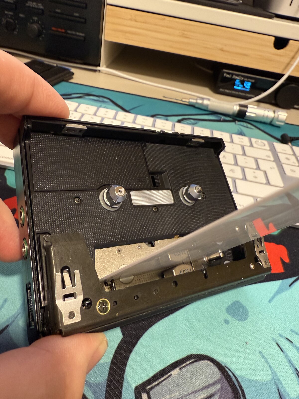

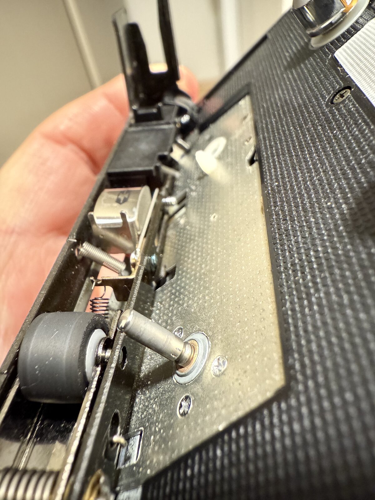

    The substance has arrived. Straight from work went to finish this. Attached images of pinch roller after the treatment with Ferric Chloride and also replaced C102/202 capacitors.
    Tested with couple of 90min tapes I have so far (only playing for the 10 minutes) and I could not hear any sound/speed deviation. Also, measured while the walkman was still in pieces wow/flutter (attaching files here). I was checking the service manual and not sure if I understood correctly, but there they mention 3000Hz (+9Hz) is ok. I have not seen after few minutes measuring the w/f this goes bellow 3007 and above 3009Hz on 3kHz test tape.
    I am not sure if this is perfect (from the technical point of view) but sound wise, this sounds great. Only difference compared to my Yamaha deck is that it has stronger bass, and that the output is a bit higher than the deck when playing on Volume 6/7 on the walkman. For the cassettes I recorded, this is max before I start hearing some short distortion when highs are having a peak.

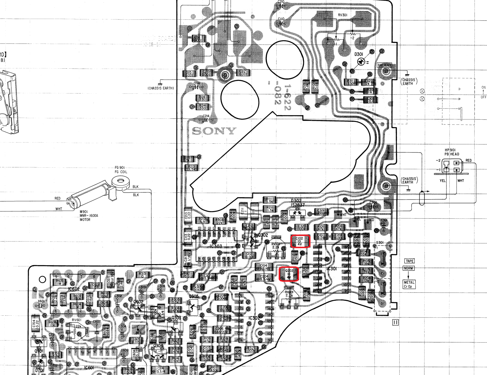

    I tried resoldering zener diode (at least I think thats zener diode marked with ZEE), next to C701 capacitor, as I found that here on the forum.
    Anyone experienced any similar behavior or has any idea what else should I try?
    Thanks
  11. Valentin
    1,956
    D701 is a 7.5V zener diode, used as a voltage reference in the DC-DC converter circuit.
    However thid DC-DC only powers the PLL, so it's easy to isolate a potential fault by simply removing the PLL solder bridge.
    Also, what happens to the motor voltage when speed is low ? Is it higher than 1.45V or lower ?
    When you load down the motor by touching the flywheel, voltage goes higher or lower ?
    If servo is working correctly, it should sense the speed going low and raise the voltage to compensate for the higher load.

    When you say solder bridge, yo think of long solder between white motor wire and C316 leg?
  13. Valentin
    1,956
    Don't think you understood how to do the test.
    We're interested in the voltage WHEN (at that exact point, not after) the motor is slowed down by hand, not after it recovers.
    Point is, if the servo is working correctly, it should instantly increase the voltage when the FG coil senses a slowdown in speed.
    If I understood your measurement right, it does seem like a servo problem as the voltage is 1.54V initially and jumps to 1.65V after the recovery.
    Regarding the PLL bridge, check the service manual page 5 (pages 7-8 in the actual manual), Tape Speed Adjustment section. You'll see at the bottom the solder bridge labeled "Adjustment patterns".

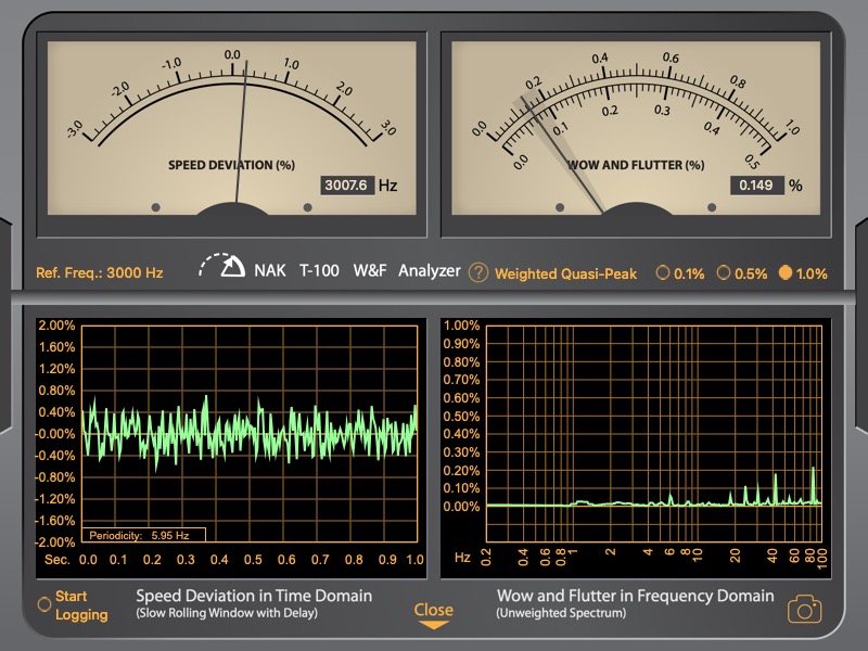

  14. cikaKosta
    cikaKosta New Member
    29
    Oslo

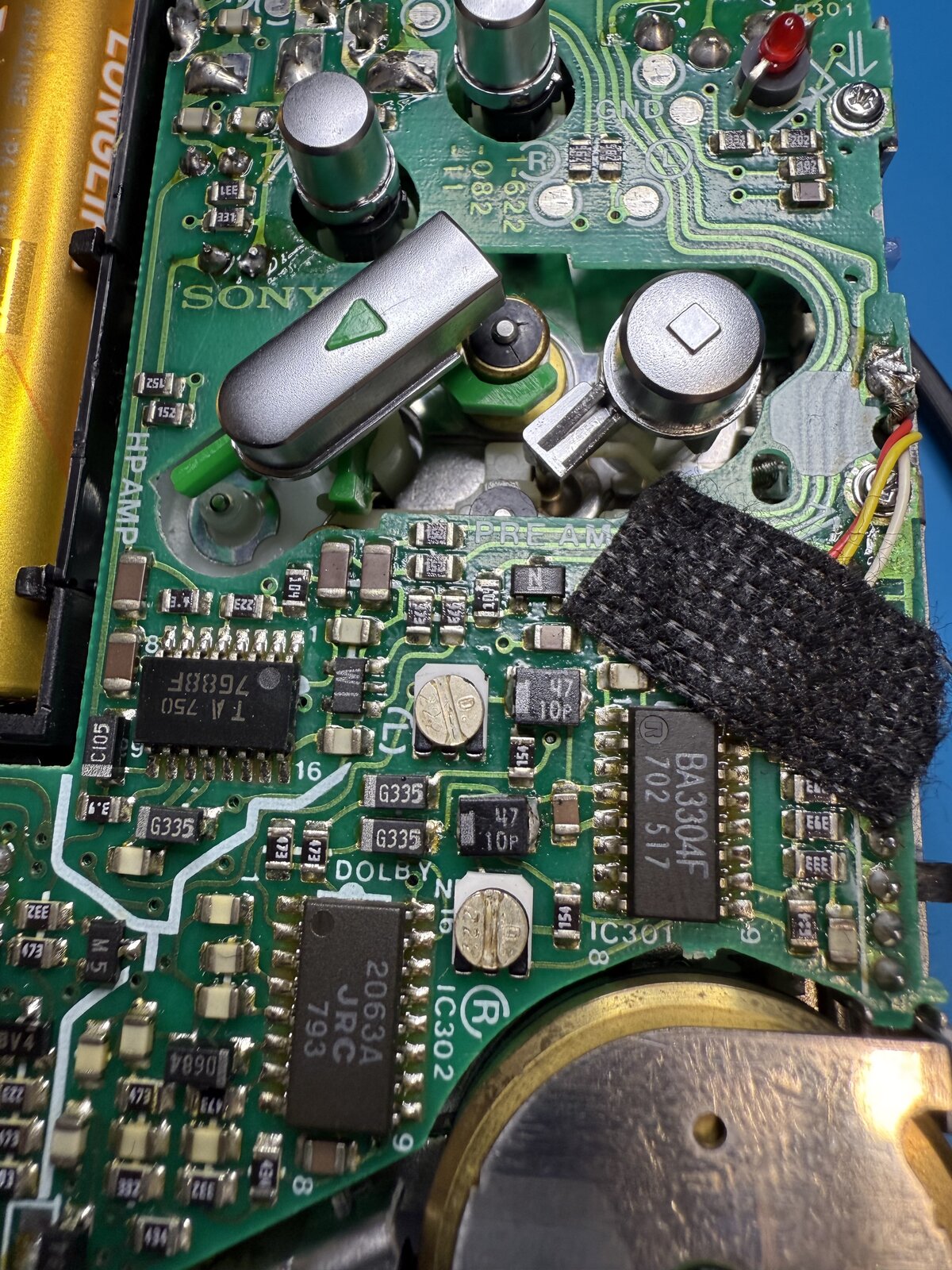

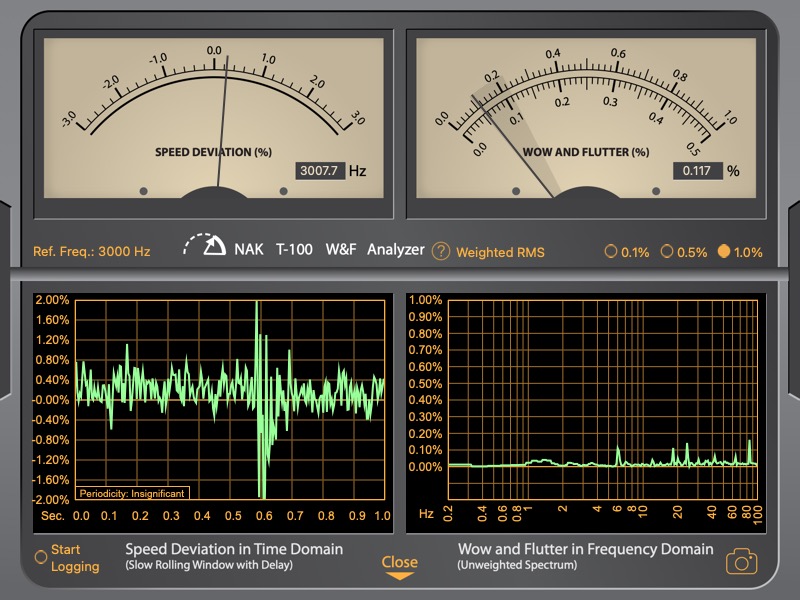

    The voltage jumps to around 2V instantly when I touch the flywheel and then when I release the finger from it, it goes back to 1.65 with recovered speed.
    Also happens if I try a couple of times to do the same, then the speed sometimes goes back to low, and the voltage is again 1.54V
    Desoldering the bridge “Adjustment patterns” turned the speed way lower. Of course, touching the flywheel would not recover the speed in this case.
    Update 2: Resoldering the bridge and adjusting just a little bit RV601 fixed the speed permanently. Now whatever I do, (stop/rewind/ff/play/touch the flywheel) speed is ssteady and this is what I was getting when measuring w&f.
    Valentin likes this.
  15. Valentin
    1,956
    Looks much better than before, but that W&F is high. Recommend doing 2 things:
    - oil the front bearing of the motor if you haven't done so already; use the walkman a while after this to make sure the oil got inside the bushing.
    - adjust RV601 correctly. Speed with bridge desoldered should be adjusted to 3090Hz, then bridge should be re-soldered.
    From the 3090Hz I would also substract 7Hz since your tape is likely a bit off. So you can adjust to 3083Hz instead.
    This RV601 adjusment, when it's at the extreme ends, causes erratic behavior of the servo.
    Given in your case the speed way way lower with bridge desoldered, it's clear this adjustment was probably close to the min.
    cikaKosta likes this.
