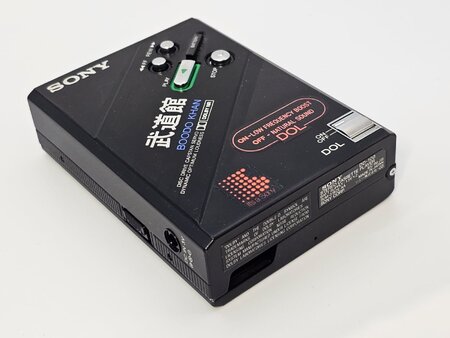

    Guess which model this is... hint: Picture taken from the inside

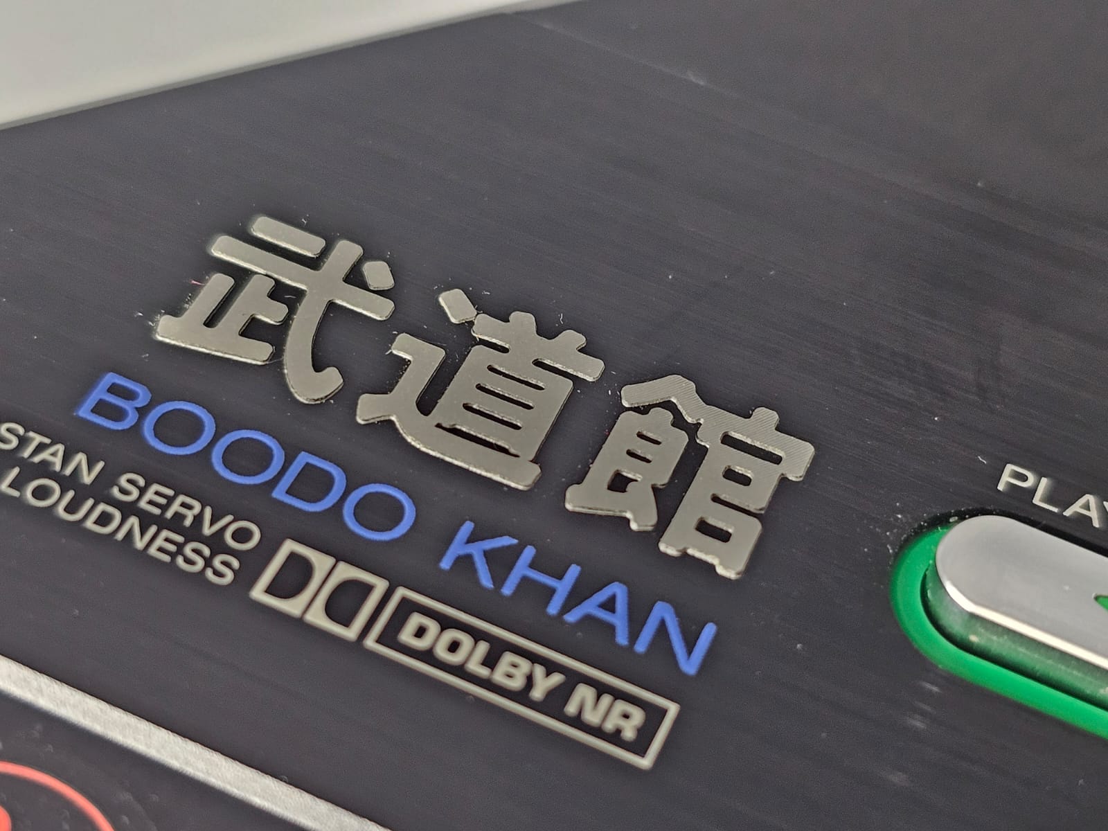

    Yes, the Boodo Khan text is really embossed in the aluminum

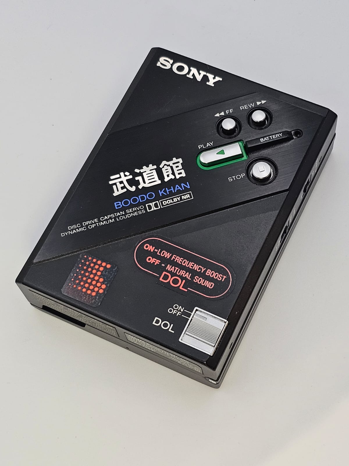

    Very happy with this WM-DD100, I got it recently and it's the nicest one I've ever seen. Really 100% mint, cannot find any imperfection at all.
  4. Timewarp
    Timewarp Well-Known Member
    267
    The Netherlands
    If you look at it rationally, it's not very different from a regular DD, however it's pretty iconic as it was the first one to feature DOL, the predecessor to Mega Bass etc

    Even the original stickers are in perfect shape

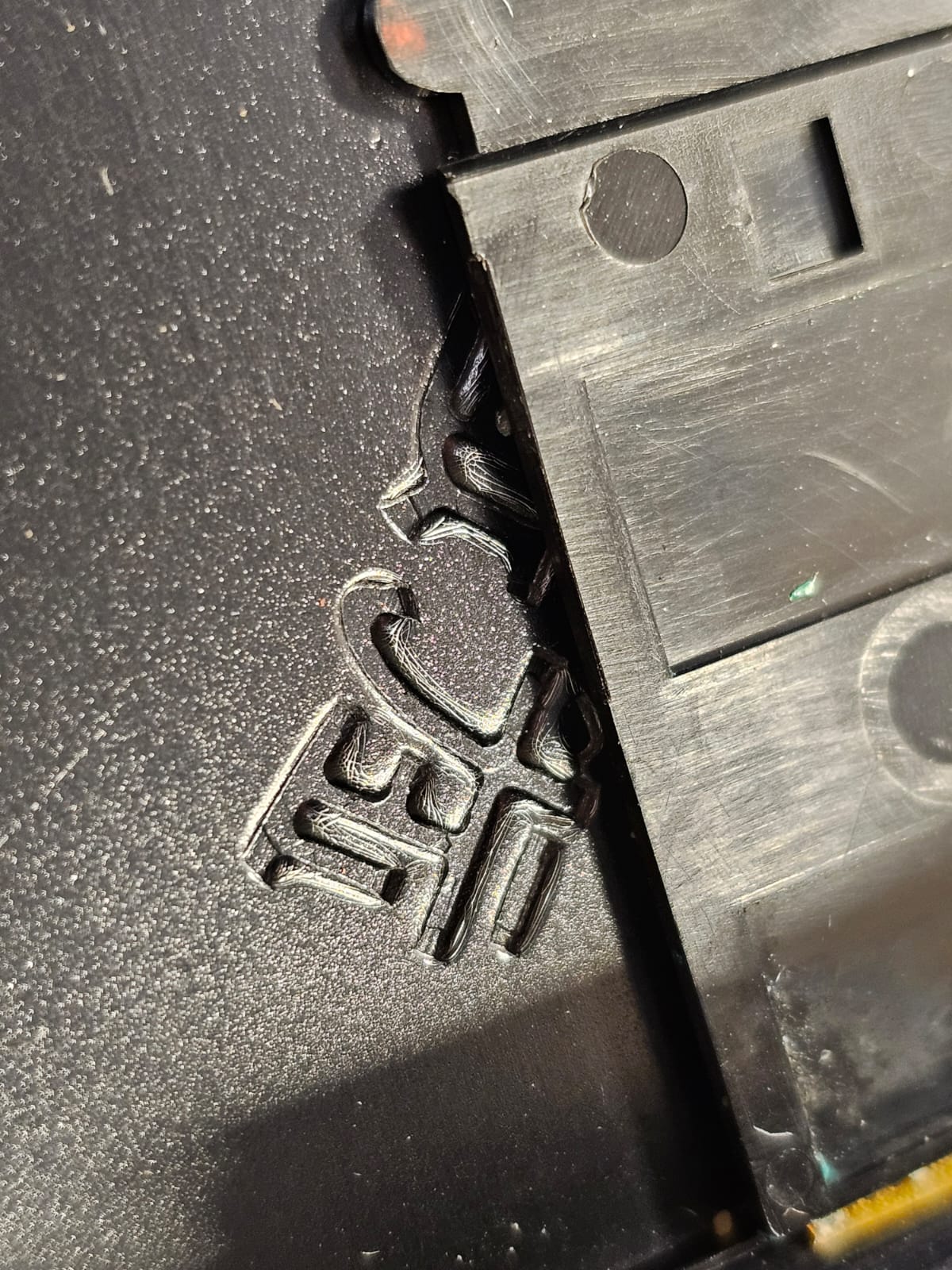

    Unique case for the DD-100 with DOL switch hole

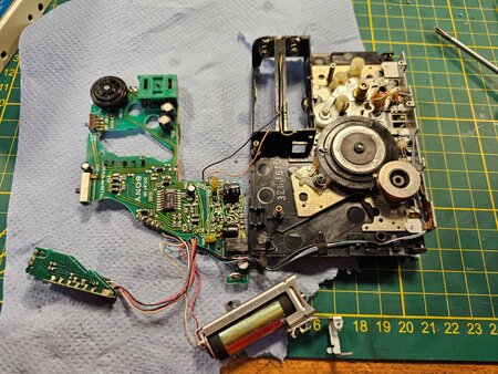

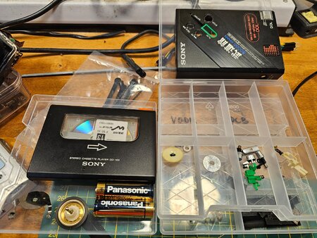

    Inside, it's obvious how much work it was to manufacture these devices in this era. A lot of manual soldering and routing of wires.

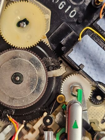

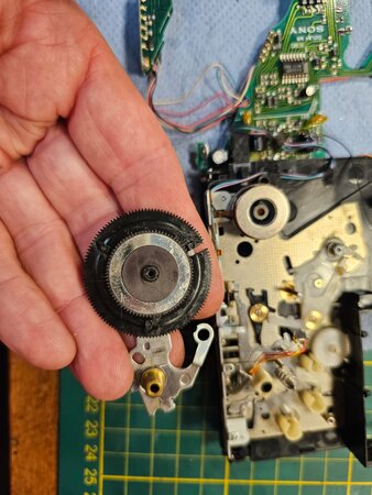

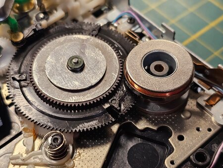

    And yes, even though this DD-100 is in new-like shape, it cannot escape the cracked center wheel problem. It's just age that results in shrinking the black plastic gear around the metal inside, with such tension built up that it cracks.

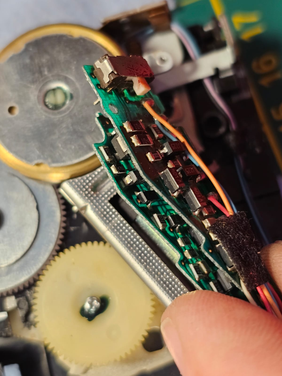

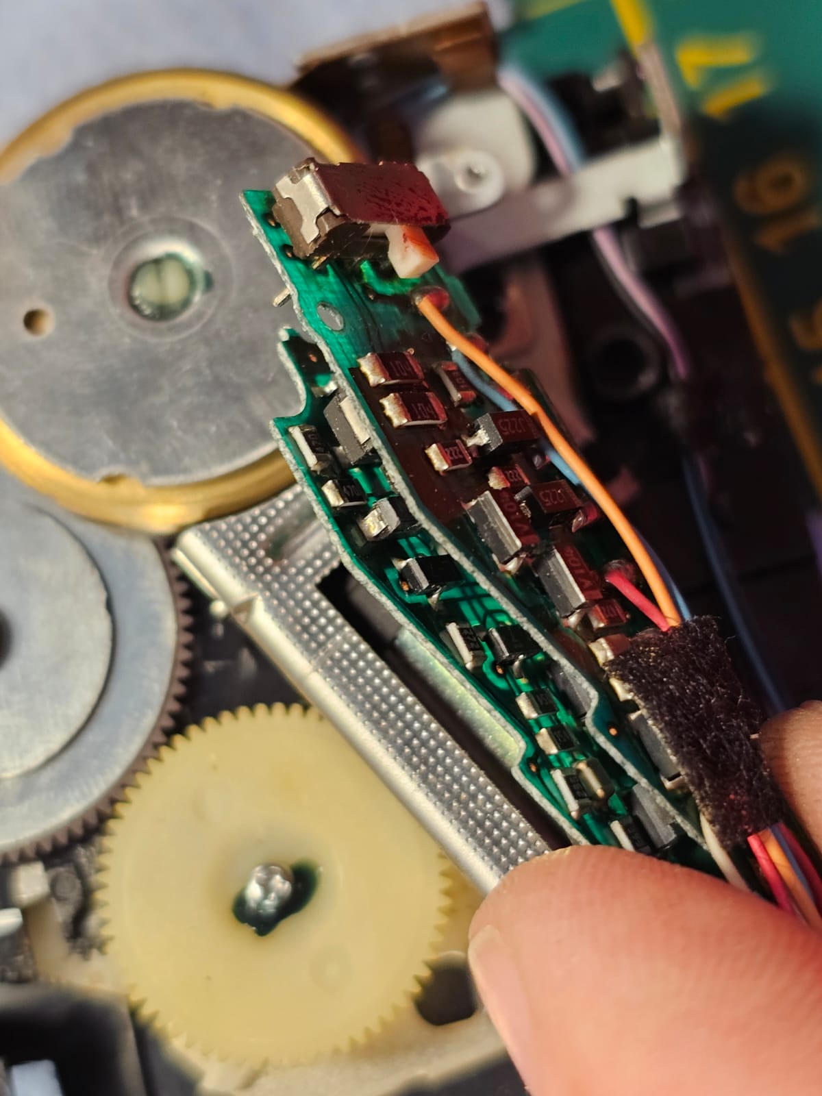

    The small PCB on the bottom left is the DOL circuit that set the DD-100 apart at that time.
  12. Timewarp
    267
    The Netherlands

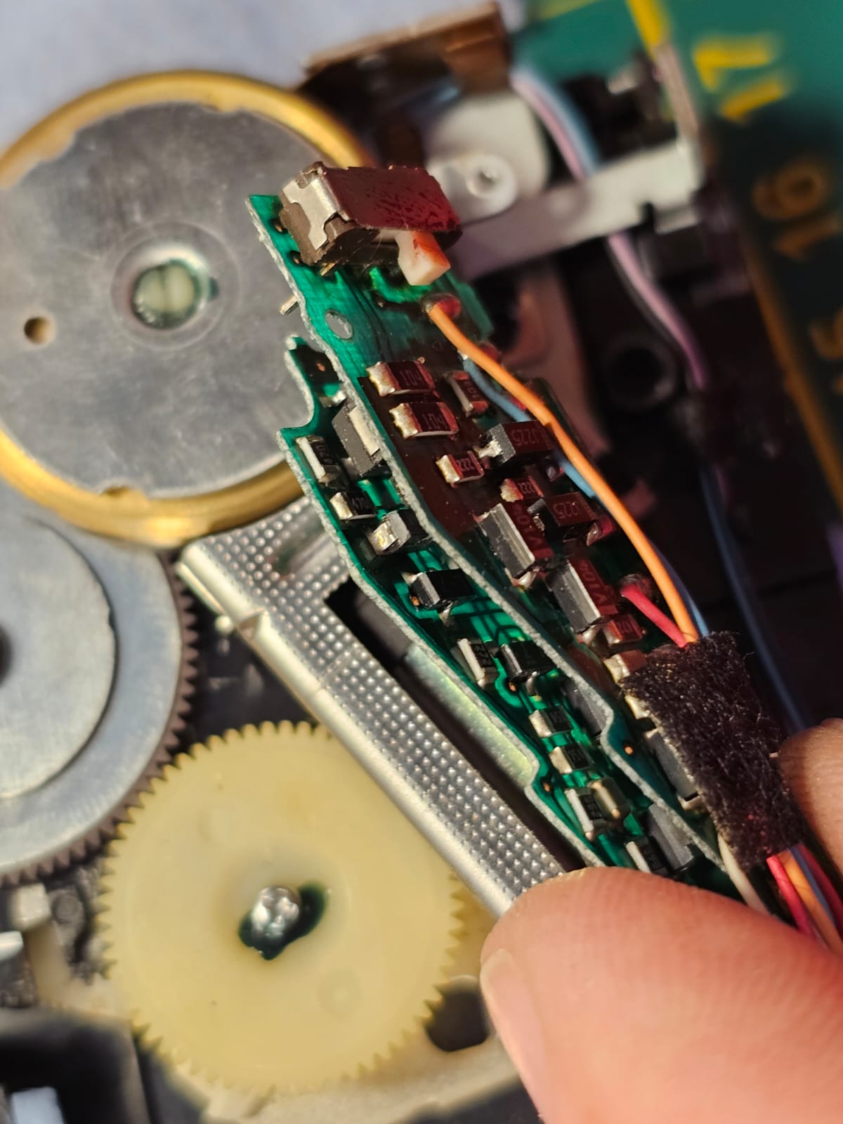

    It's an interesting stack of PCBs with - fairly novel at that time - SMD only with PCB interconnects at the side. No PCB vias, just soldered elements to connect both sides. I guess dual-sided PCBs and SMT components were pretty new back then.

    Servicing the Boodo Khan so that not only the outside is new-like, but it will also play that way.
    The mechanism itself is fairly straightforward and the maintenance to make it new-like is not so tough.
    Taking the center gear out is not that difficult as long as you have some basic mechatronics skills, you're not affraid of the small stuff, and you keep precise track of what you do.

    Very clear crack in the center wheel.

    After the repair it plays very well and sounds quite good.

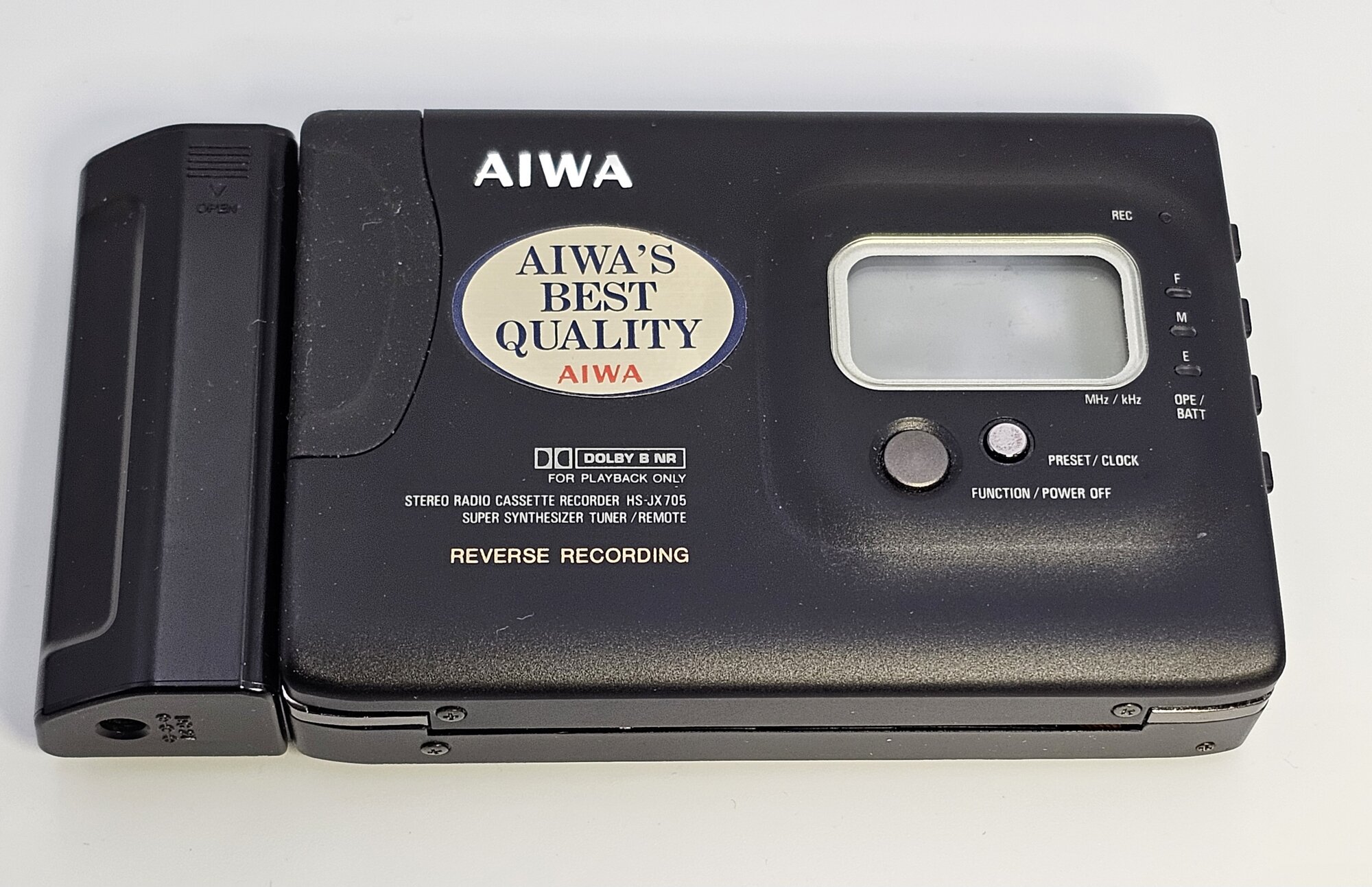

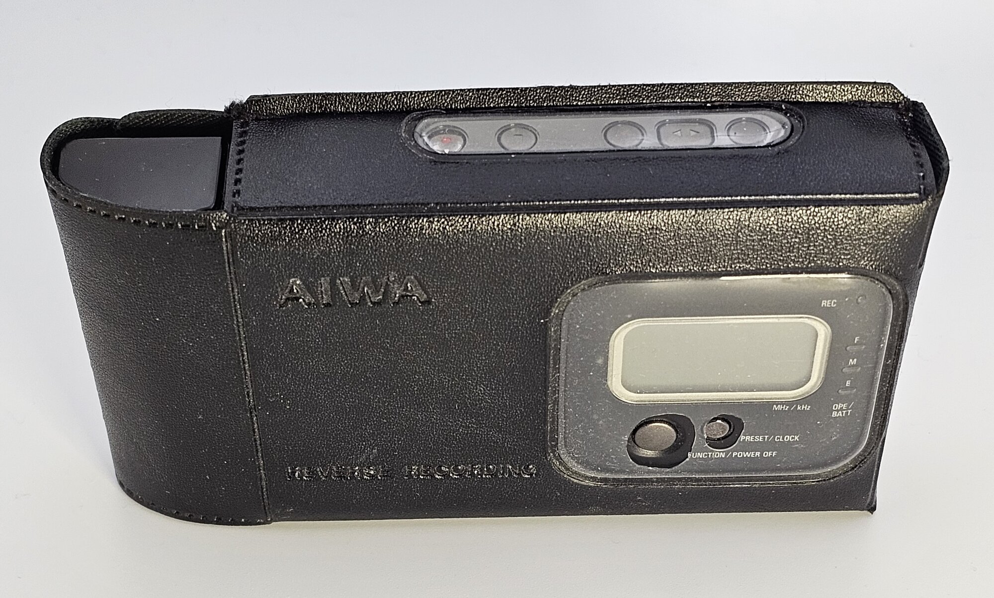

    Another Aiwa
  19. Timewarp
    267
    The Netherlands

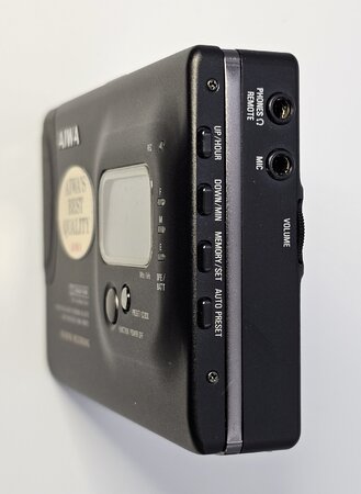

    The HS-JX705.
    A high end Aiwa you don't see so often. It's a fully featured model with tuner, recording and a lot of buttons:
    It has to be one of the highest number of physical buttons portable players out there.
  20. Timewarp
    267
    The Netherlands
    Unfortunately it runs on the proprietary 2V lead acid battery, but it also takes regular battery power through the box.
    Mine is in very nice shape without any visible damage. The design may not be the cleanest, but it does feel solid and high end to the touch.
    The sticker "Aiwa's Best Quality" may also contribute to the feeling that we have a high end "subtop" model here. The sticker shows a certain pride. One could also say it insinuates that there's another side of the spectrum where Aiwa didn't show their best, so how would they call those?
    Michiel, Mister X and Emiel like this.
