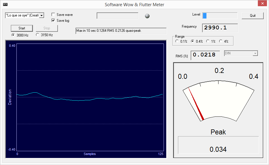

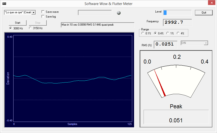

  4. walkman archive
    1,901
    And here's with an UX-Pro recorded with my Dragon
  5. mrn
    mrn Member
    69
    germany
    Thanks a lot, Hugo!
    So, it is roughly 0.025% vs 0.0022% for a tape recorded on a Dragon vs. the Calibration tape.
    In other words, the Dragon adds roughly 15% W&F to the 0.022% of the k909es.
    But, when looking at the Peak values, it is 0.051 vs 0.034, which is exactly 50% more.
    51/34 =1.50.
    Nice weekend and thanks again!
    M.

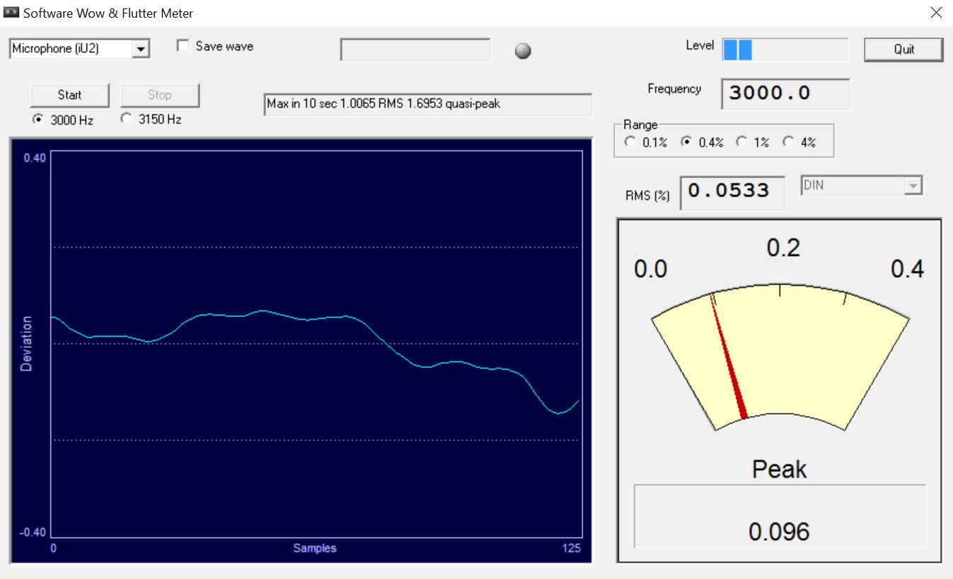

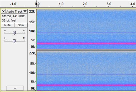

  9. mrn
    mrn Member
    69
    germany
    Hi.
    I think I know the problem with strange W&F numbers.

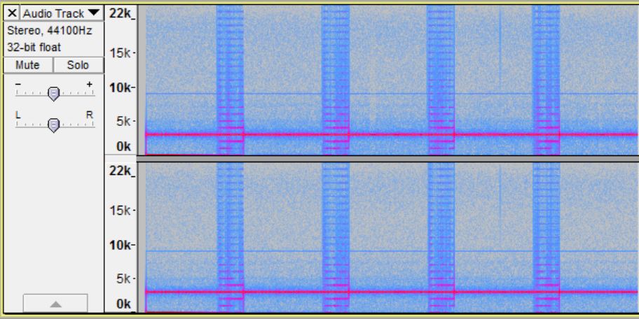

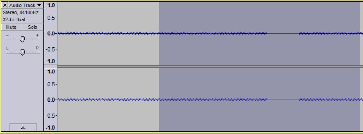

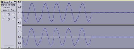

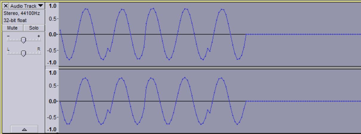

    Here is a recording made in Audacity (free audio recording app), using the Tascam iU2 and a Win10 laptop:
    Left side: clearly visible missing samples from the recording, problem a result of a wrong recording HW-SW combination.
    Right side: zoomed-in samples of the same recording reveals not only missing frames, but also interrupted signal (probably repetitive storage of same samples.)
    Below left: the same signal visualized as spectrogram: periodic damage of the signal is clearly visible
    Below right: still, same failing HW-SW setup seems to provide STILL realistic number when using the W&F too.
    However, it is possible that (at least the Peak) W&F value is strongly influenced by the missing samples /frames/ of the signal.
    Before comparing Walkmans with this W&F meter, I think it is really important to check, if the Setup works properly, ie. that the HW-SW combination does not provide damaged signal like in my case. The laptop was NOT in energy saving modus, and no other apps were running while recording.
    Hope it helps.

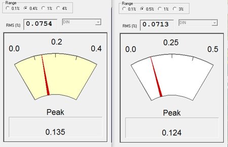

    Btw, both versions of the W&F tool from that page seem to provide similar results.
    So I believe does not matter which one we use.
    (note the difference of the two: 0.5 ... 3% vs. 0.4 ... 4% scales):

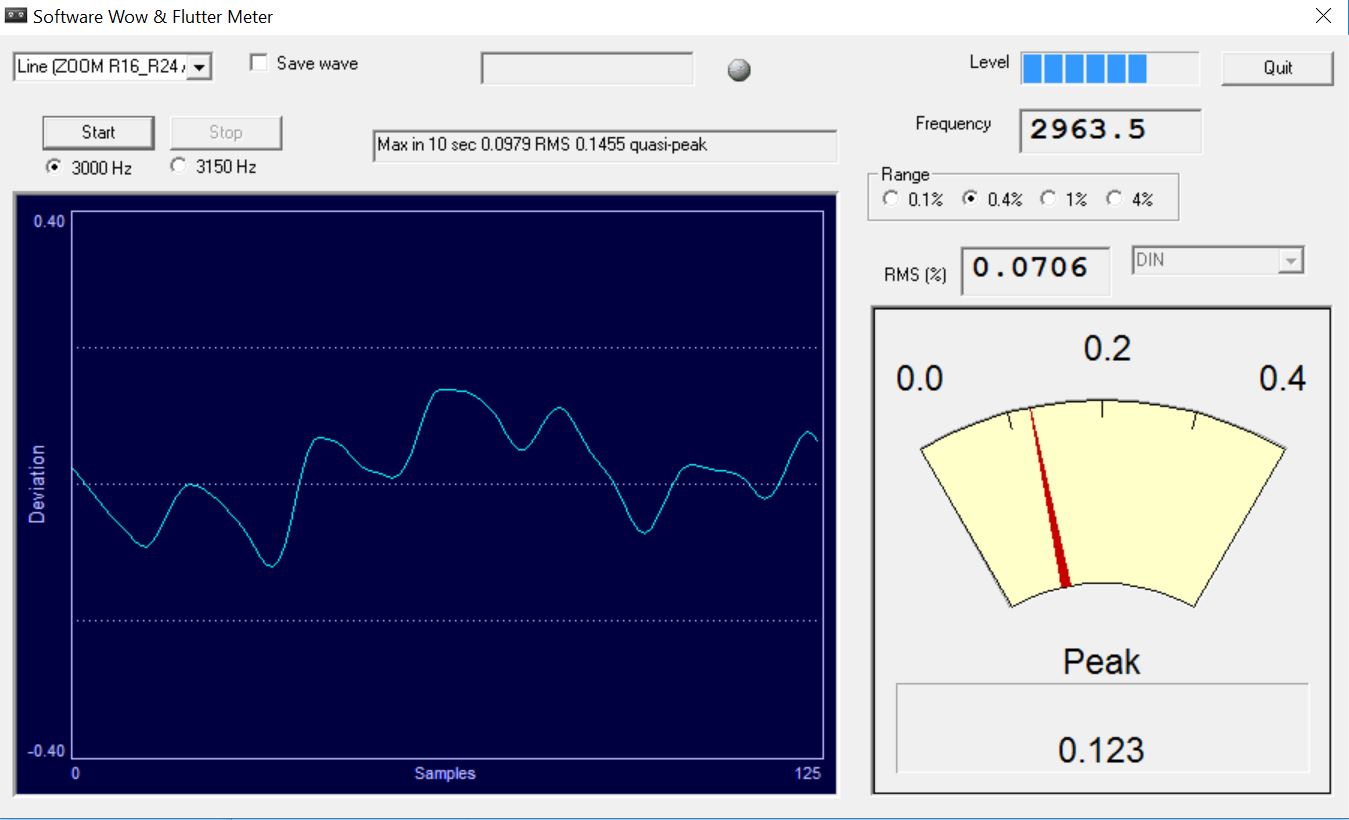

    Ok, here is the same experiment using a different Sound Module:
    the Zoom R16 with Driver version 2.1.0 :)
    No more skipping frames ...
    ... and better W-F values:
    Yes, the setup matters!

    I have heard from Alex (ANT Audio) that Audacity add audible distortion to the sound, so I never used it. I always used Cool edit pro and then Adobe Audition for my small and sporadic edits.
    Yes, but seems to me that the needle is not point well to the proper value in the right window. 0.07 should not be placed in the middle of 0 and 0.25...
