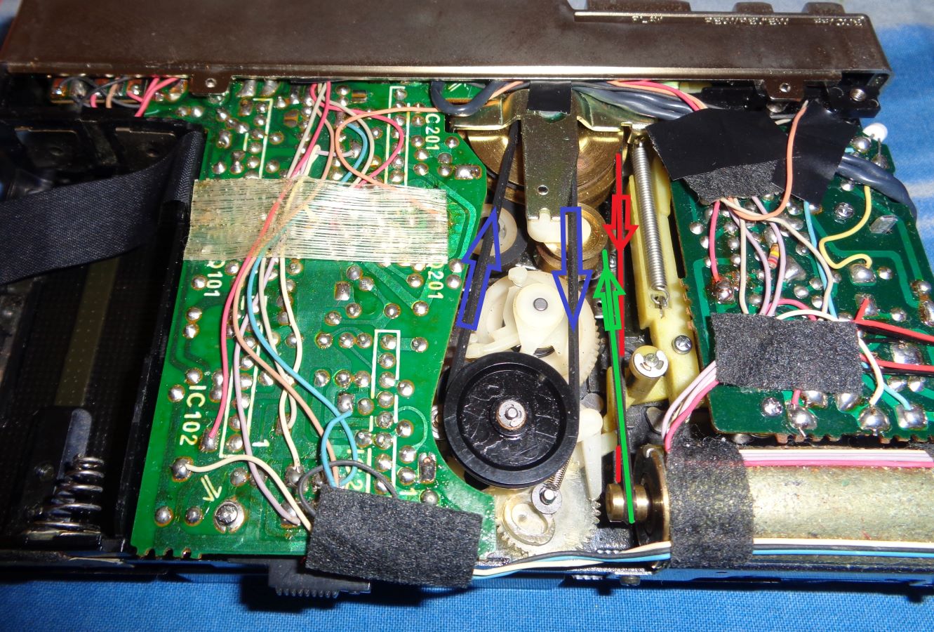

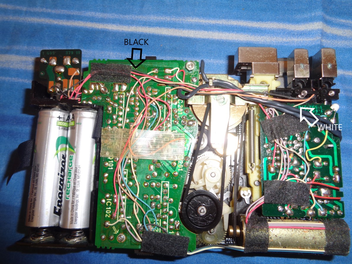

    I am looking to get a second set of eyes on a Sony Walkman WM-3 I am refurbishing.
    Recently, I received new belts and idler tires from fixyouraudio.com. After replacing the worn out rubber, the player unspools cassettes. This is regardless of whether or not I have "flipped" the larger belt that connects to the motor. Prior to installing the new rubber, the player had no issue playing tapes at the proper speed from start to finish (aside from some very minor wow and flutter).
    I am almost certain I bungled something around the area of the smaller idler tire, as it isn't really touching the mechanism that drives the take-up reel. Please photo attachments below:
    There is a small, white "mystery arm" just south of the smaller idler tire, that I pushed under the large white gear assembly that drives the take-up spool. Unsure if that is correct. Any assistance is greatly appreciated- I've put some hours into getting this far, certainly thanks to reading past threads, but couldn't find anything on this area in particular. Thanks!
    -Adam

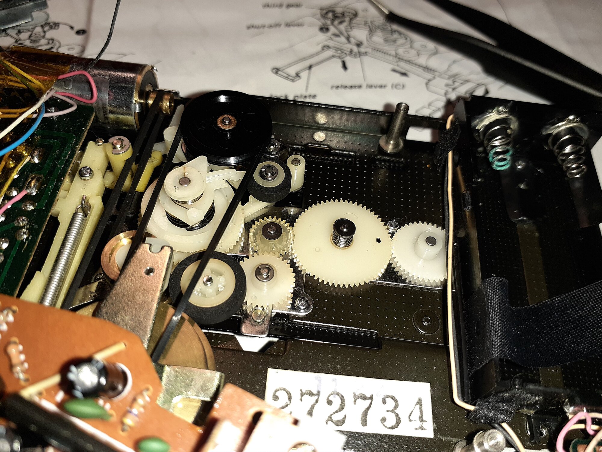

  2. Talkman
    Talkman New Member
    Michigan
    Looks like I have everything in it's proper place now. Unfortunately, a few of those tiny, c-shaped washers flew off into another dimension, anyone know of a suitable replacement?
    There also seems to be some kinda micro-flutter that makes vocals sound a bit robotic. Perhaps there's an adjustment to be made, or I just need to deep-clean the pinch roller. Either way, I did order a roller from Fix Your Audio. Home stretch!

    Hi ... I know I'm late ... I already wanted to write to you yesterday but I didn't make it in time ... I noticed from your photos that the belt on the engine is reversed ... I think you have already solved this problem seeing the video you posted .... however I take this opportunity to post two more photos in case others have the same problem ...
    Talkman likes this.

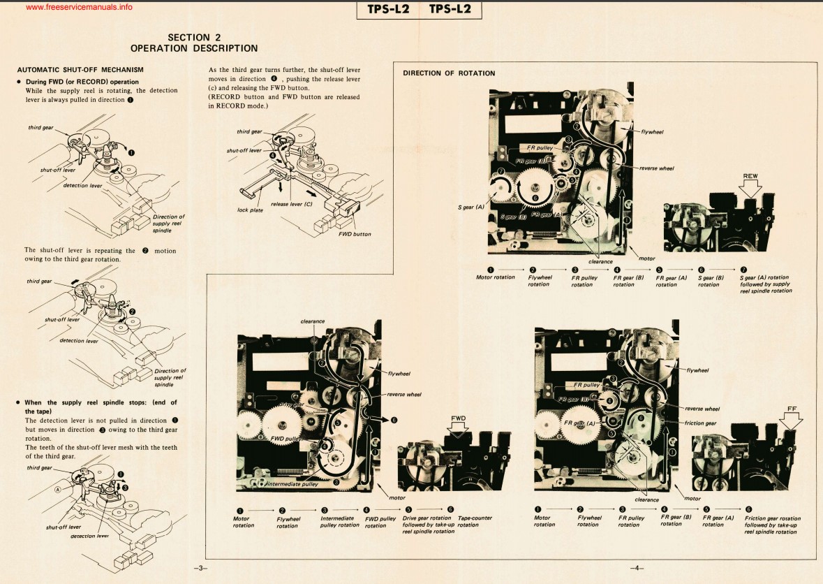

    Hi. My TPS-L2 motor has clockwise rotation, is this correct?
    I bought new belts and for some reason if I install the longer belt as showned in the pictures, on the upper side of the motor pulley, the walkman eats all the tape.
    In every youtube videos the belt install like this pictures.
    so the question is what could be the problem?
  8. Silver965
    Silver965 Well-Known Member
    633
    Torino
    Hello to try ... put the belts as in the picture above .... do not put a cassette and play ... see if the belts turn as in the picture .... if they turn correctly the problem you have is not here. ..will be on the cassette take-up reel that is not spinning and the tape is pulled out of the pick roller

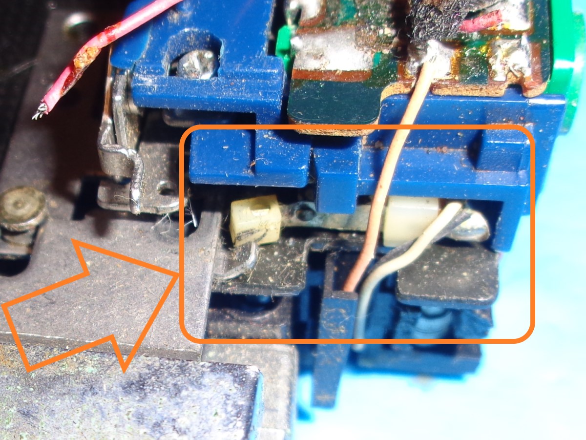

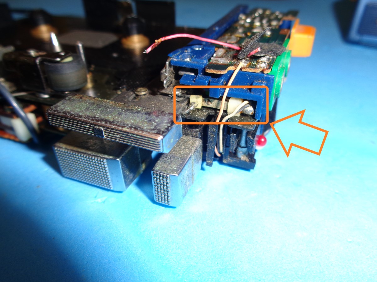

    The only thing: sometimes if I push any of the action buttons (FF/ RE/PLAY) it won't starts.
    Edit: don't know if its a mecanical problem,w if there is a wear piece, or or should I oil everything?
  10. Silver965
    633
    Torino
    HELLO ... By pressing a button ... Play..FF..Rw..check that this switch is activated .... and if it makes contact ... or if not working ... check the black and white wires connected to it ... check the connection of the wires also on the circuit ... The black one is from the external power socket and the white is from the circuit above the motor ..... I still remind you that inside the external power socket ... there is a switch that makes the exchange between the batteries of the walkman and the external power supply ... also checks the correct functioning of this ...
