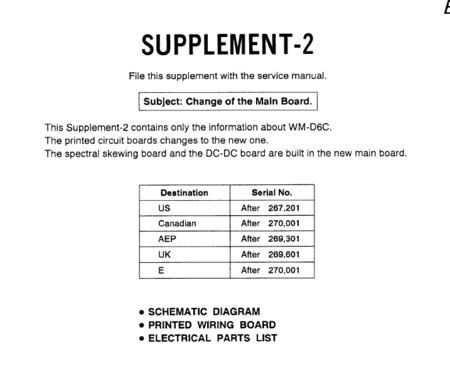

    Thank you all for sharing the information - below my summary of all changes during the lifetime of the D6C.
    Overall, there are 3 heads, 2 Dolby ICs, 2 Servo ICs, 2 Dolby sticker colors, 2 PCB types, 2 upper housing parts (with and without amorphous), and 3 motor (assy) types.
    Initial release, & revisions 1-5 have amorphous heads of some type and use Servo IC CX20084.
    Changes between revisions are highlighted bold.
    1984 - Initial release: 3602A head, CX20068 Dolby IC, X-3305-830-1 motor assy (MNF-1601A), NJM4558M line/rec IC, brown phenolic PCB.
    1985 - Revision 1: 3602A head, CX20218T6 Dolby IC, X-3305-830-1 motor assy (MNF-1601A), NJM4558M line/rec IC. Ends at serial range 71237 - 72265 (TBD). Supplement 01, Jan. '85.
    1986 - Change of 3602A to 35711 head between revision 1 (1985) and 2 (1994), closer to 1985 than 1994, estimated 1986. No bulletin to support, evidence provided by S2Go forum members.

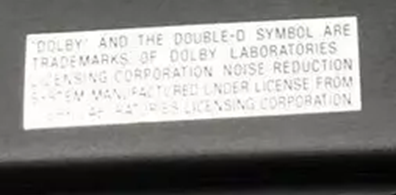

    1988 - Color of the Dolby sticker changed from silver to black, around serial #116000.
    1991 - Revision 1 fix: incorrect capacitor reference (138->318). Bulletin 366, Jun. 20 '91.
    1994 - Revision 2: 35711 head, CX20218T6 Dolby IC, 1-541-851-11 motor (MNF-1601A, once referenced to as I2CL-3026), UPC4558G2 line/rec IC, green epoxy PCB with SMD components.. Supplement 02, Mar. '94. Starts at US serial number 267200.
    1996 - Revision 3: 35711 head, CX20218T6 Dolby IC, X-3370-805-1 motor assy, UPC4558G2 line/rec IC. Bulletin 395, April '96.

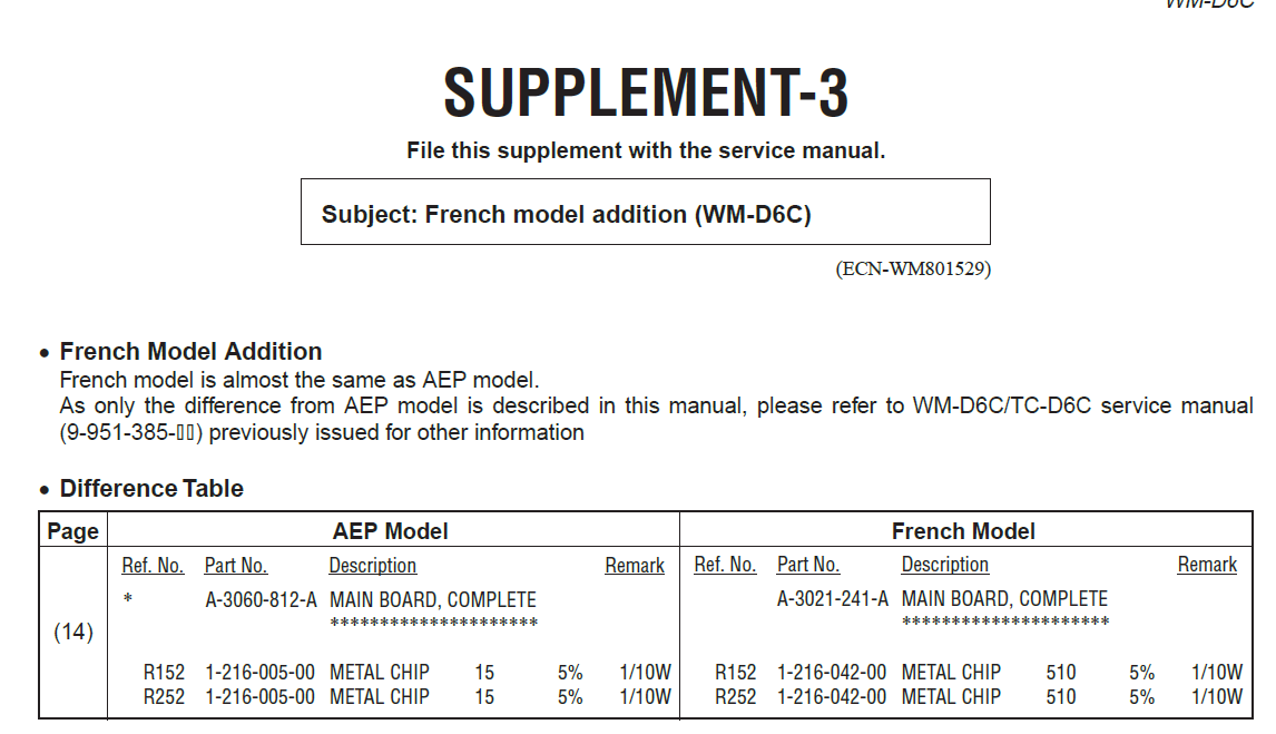

    1999 - Revision 4: French model addition, same as AEP model except resistors R152 and R252. Supplement 3, April '99.
    2001 - Revision 5: 35712 head (not amorphous, housing changed amorphous text removed), CX20218T6 Dolby IC, X-3370-805-1 motor assy, NJM4558M-TE2 line/rec IC, CX-069A servo IC + NJM2904V comparator IC (CX20084 includes comparator). Supplement 04 (and re-release manual 1.1), Jun. '01.

  9. dotneck335
    dotneck335 Active Member
    127
    Los Angeles, CA
    • 1991's change of 220uF capacitor designation 138 to 318 is not really a revision; it's just a correction of the schematic. The PCB was actually marked correctly.
    • April 1996's service bulletin states a change of motor from X-3305-830-1 (original) to X-3370-805-1. I do not see mention of 1-541-851-11 motor anywhere in Supplement 2 or elsewhere.
    • Although the color change of the Dolby sticker from silver to black (~ serial # 116xxx) was not accompanied by any significant change to the unit, it may still be useful in identifying the approximate manufacturing date of a deck.

    The Dolby sticker color change is quite obvious and a good indicator of deck vintage:
    As mentioned previously, this occurred ~ serial # 116,xxx, early 1988.

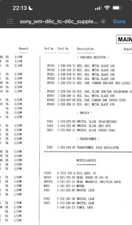

  14. Emiel
    1,115
    Might we be missing a bulletin or 2? 1 for the statement from Deb64, and second about the head change?
    Summary post updated, the info below has been included:
    a) the color of the Dolby sticker change around ~ serial # 116,xxx, early 1988.
    b) part of revision 2 in 1994: change to SMD components, where the board change was from brown phenolic to green epoxy.
    c) tentatively between revision 1 (1985) and 2 (1994) the head change from 3602A to 35711, closer to 1985 than 1994, estimated 1986.

    This is my version of the WM-D6C history:
    February 1984: Original Sony Walkman WM-D6C released. Amorphous "pointy" parabolic PA259-3602A head marked "Japan". Brown/green phenolic PC boards 1-611-494-11 with through-hole components.
    January 1985: Generation 2: Supplement 1 notes Dolby chip change from CX20068 to CX 20218, as well as surrounding component value changes. PCB now -12. Serial # range undetermined.
    Mid 1986: Generation 3: Change from "pointy" parabolic to rounded head 35711 @ ~serial # 72000.
    Spring 1988: Change to Dolby sticker color from white (silver) to black ~ serial # 117,000.
    March 1994: Generation 4: Supplement 2 at ~ serial # 267,201 notes change to green glass epoxy PCB 1-651-545-12 with SMD components. Change to 1-541-851-11 motor
    April 1996: Service Bulletin 395 issued.
    April 1999: Supplement 3 shows two resistor values were changed in the French model.
    June 2001: Generation 5: Supplement 4 shows main PCB changed to 1-651-545-14; motor drive servo circuit redesigned with servo IC CX069A. Service manual issued as Rev. 1.1.
    Generation 6: Change to permalloy head 35712 in serial #s ~50xxxx and above. Date undetermined. Marking "amorphous head" on the case is no longer present.
    2002: WM-D6C production discontinued.

    1) Supplement 3 shows the addition of the French model, as it did not exist before.
    Many portable audio units of that era had a French variant; I recall it was to regulate the max. output, mandatory at the time in France.
