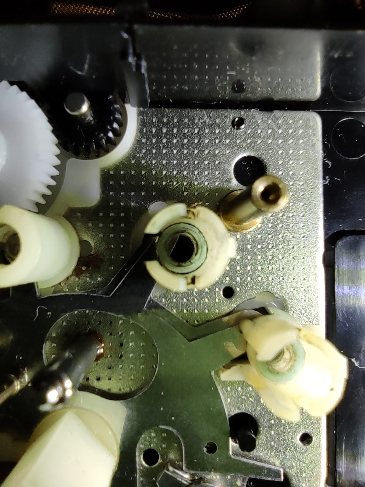

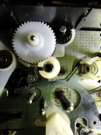

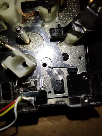

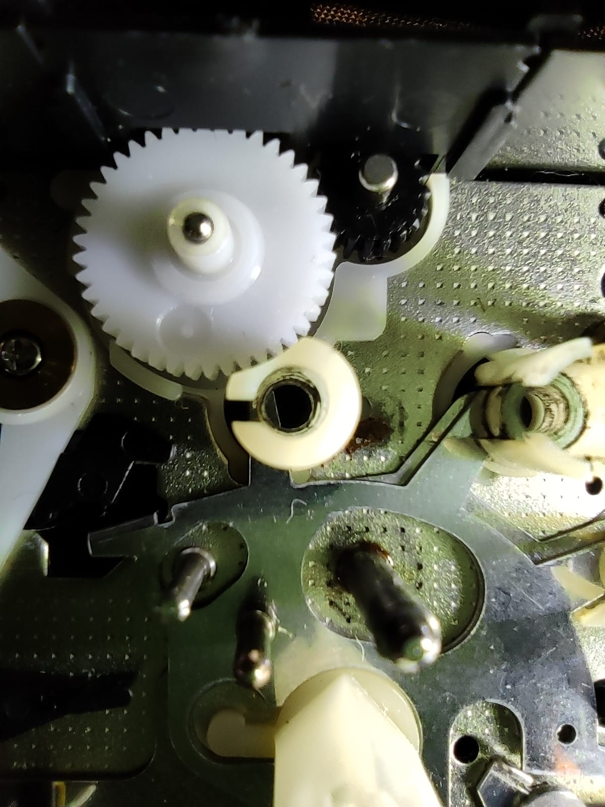

    Play button
    FF button
    REW button
    The latch on the REW button seems to protrude less into the hole compared to the other buttons.
    I removed the metal sliders and didn’t find anything obviously wrong with them. They move freely without any resistance.
    However, I did notice that the position of the slider is slightly different to the other sockets.

    See the difference in slider position, at first glance it looks to protrude enough to make the button lock.
    Question is: when you have the button installed and press it, what happens to the lever ? Does it move back at all ?
    When operating correctly, the lever should retract, then go back when it locks into the button shaft recess.
    So should be pretty easy to tell what exactly happens by observing the movement of this lever when pressing REW.

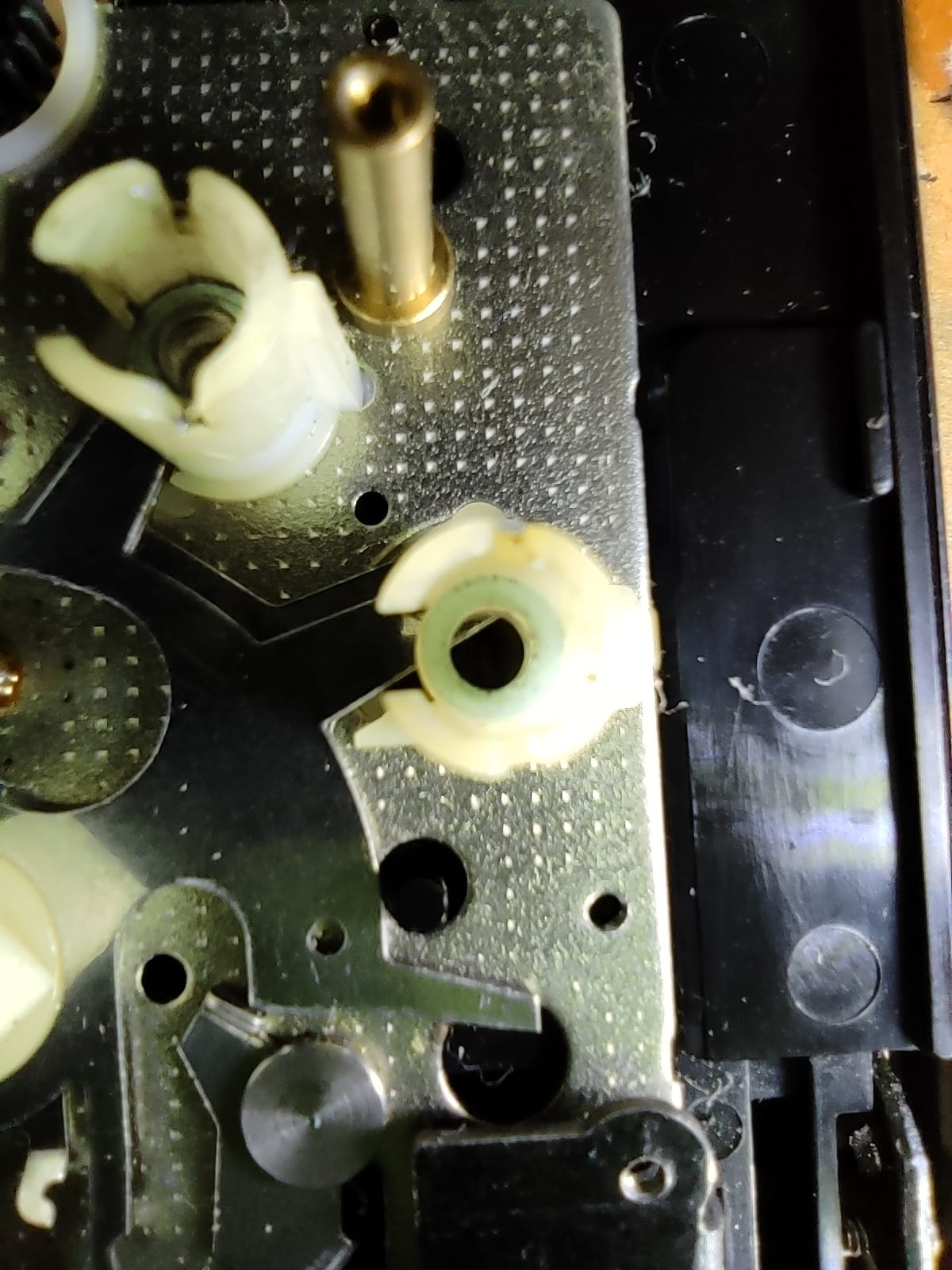

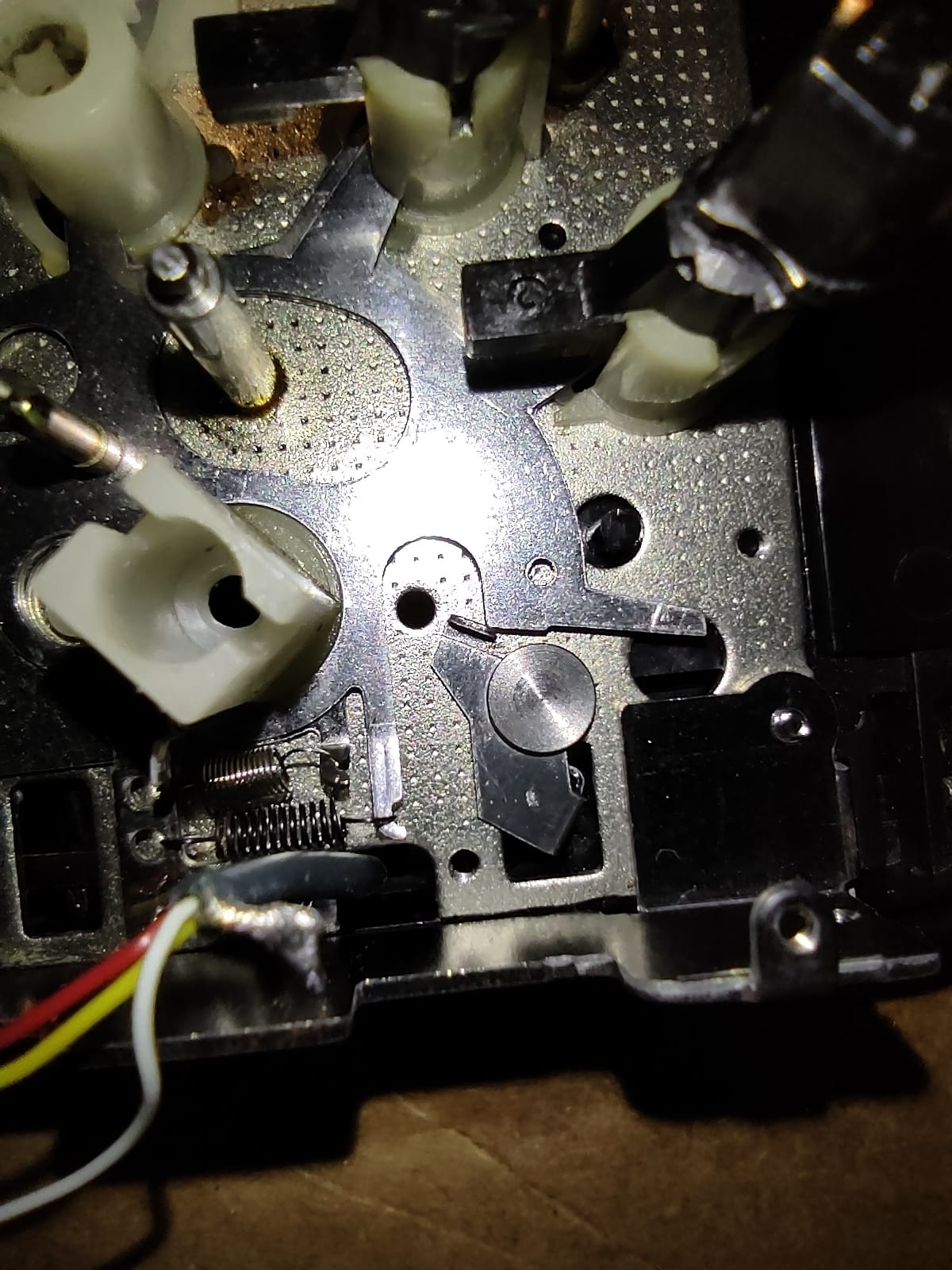

    Hello, I finally fixed the issue!
    It turned out that the grease underneath the lever, which resets the buttons when opening the door, had dried up.
    I fixed it by applying some IPA and gently heating it. After repeating this a couple of times, it should move smoothly again.
    It might be a good idea to add this information to the “buttons not latching” thread.
    For further details, please refer to this thread (Amnon’s messages in particular): https://www.tapeheads.net/threads/help-please-dd30-play-ff-rw-buttons-dont-engage.34391/.
