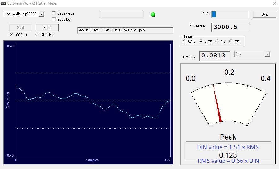

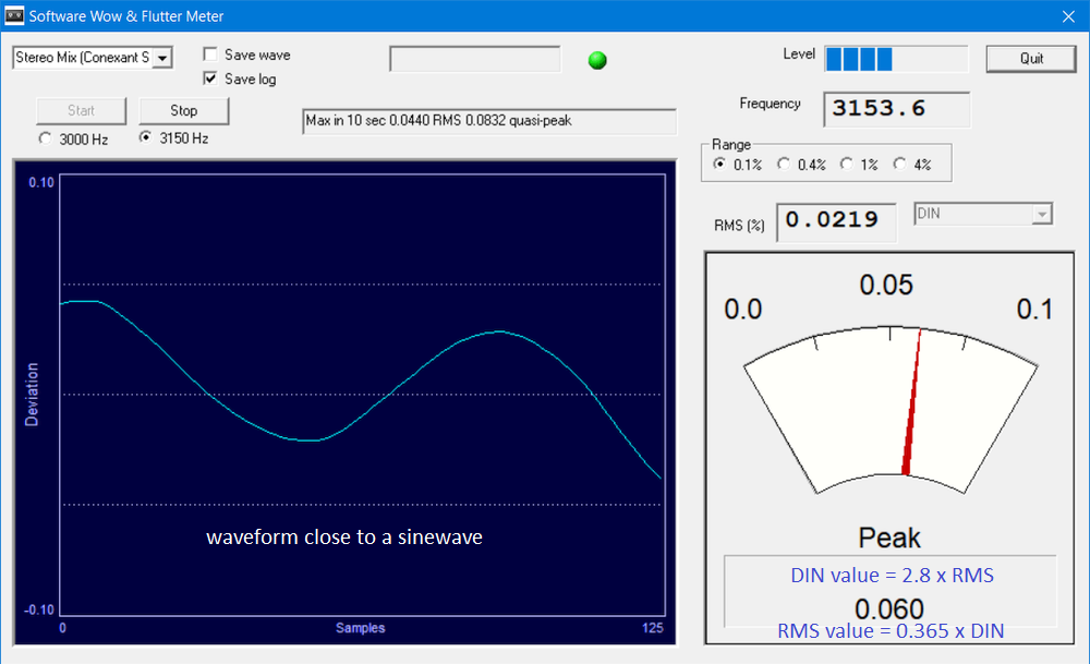

    @CDV I have read again you article on Medium: it's great, probably the best wow&flutter reference to read out there.
    There is nothing wrong with it with one minor exception: the statement that the DIN value should be about double the WRMS value. Don't know where that statement comes from, if it's taken from somewhere else or it's a deduction made from empirical observation.
    After doing multiple measurements on different units and also taking the WFGUI picture from your article as a sample as well, it became clear to me that the ratio betwee WRMS and DIN is NOT a constant number and will vary depending on the shape of the speed variation waveform.
    Let me explain more clearly: as I stated in the previous post, for a pure sinewave, the ratio between RMS and peak-to-peak is 0.35 (it will be 2.8 if we put it the other way around, peak-to-peak over RMS).
    Of course, it should be pretty obvious that, in practice, the speed variation waveform (that is displayed in WFGUI) will, in most cases, be different from a pure sinewave and will be more or less random like.
    Below, I attach the generic formula by which RMS is calculated (independent of waveform shape). It's obvious that the result of the integral is dependent of the waveform shape and will only be a fixed value for some particular waveforms, like a sinewave.
    The ratio between peak-to-peak and RMS is called crest factor. Given the crest factor varies, the ratio between WRMS and DIN measurements will also vary. https://en.wikipedia.org/wiki/Crest_factor
    Below I attach multiple measurements which are all done with the same standards, so the weighting can be taken out of the equation as a factor, because it's the same on all measurements.
    I stated both the ratio between RMS and peak-to-peak values and between peak-to-peak vs RMS, in order not to confuse you, because you're probably used to see the RMS as a function of peak-to-peak.
    It can be seen that in the picture where the waveform closely resembles a sinewave (the one from your article), the ratio is close to the 0.35 mentioned above. Of course, these are only a handful of measurements and this ratio can have more variation than what's seen here.
    My conclusion is this ratio varying between units does not indicate any problem, but just individual variations between mechanisms, mechanism designs and servo circuits.
    For example, DD units tend to have more flutter (in the first 3 pictures that can be seen as small but frequent variations) than wow. The flutter will be even more dominant in DD units with quartz lock.
    The particular microscopic imperfections of each motor pulley, flywheel pulley and belt cut will create a different wow&flutter waveforms.
    EDIT: Something that is also worth stating is: the wow&flutter numbers alone will not tell the whole picture and the waveform shape is also important. The most noticeable will be the slow variations, especially on music with long constant tones.

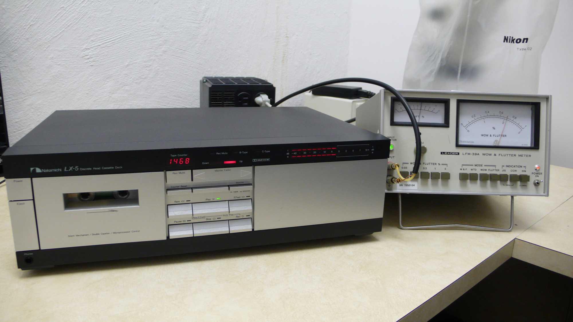

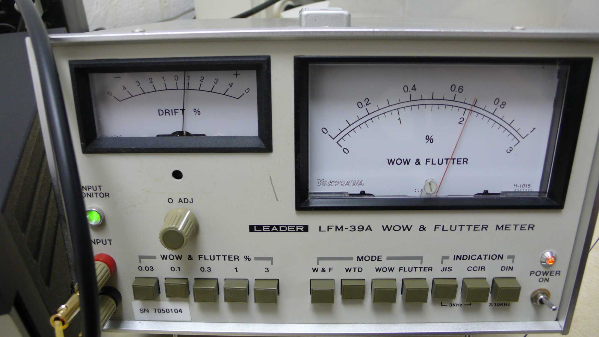

  14. Jorge
    1,794
    I did that, accidentally, for El Diablo:
    I did get service manual for the Leader, but as far as I remember calibrating W&F meter was out of my league. So, I used Nakamichi LX-5 freshly restored for me by Willy Hermann to check my own measurements. The results, in pictures:
    Boodokhan, Valentin and Emiel like this.

    @Jorge, Willy Hermann reported 0.067% weighted peak. Peak value according to DIN standard is reported as "plus-minus". On the other hand, his number corresponds to your JIS WRMS number. Usually - in practice, not according to formula - W.Peak is two-three times higher than WRMS. Therefore, what he measured was WRMS, not W.Peak.
    So, willfully or not, he misled you into believing that your deck has spectacular performance, while it barely meets the manufacturer's specs: less than 0.06% weighted RMS, less than ±0.11% weighted peak. Anyway, restoring a forty-year old deck close to manufacturer's specs is a job well done.
    You may want to remove the first picture or at least blur your name and address.
