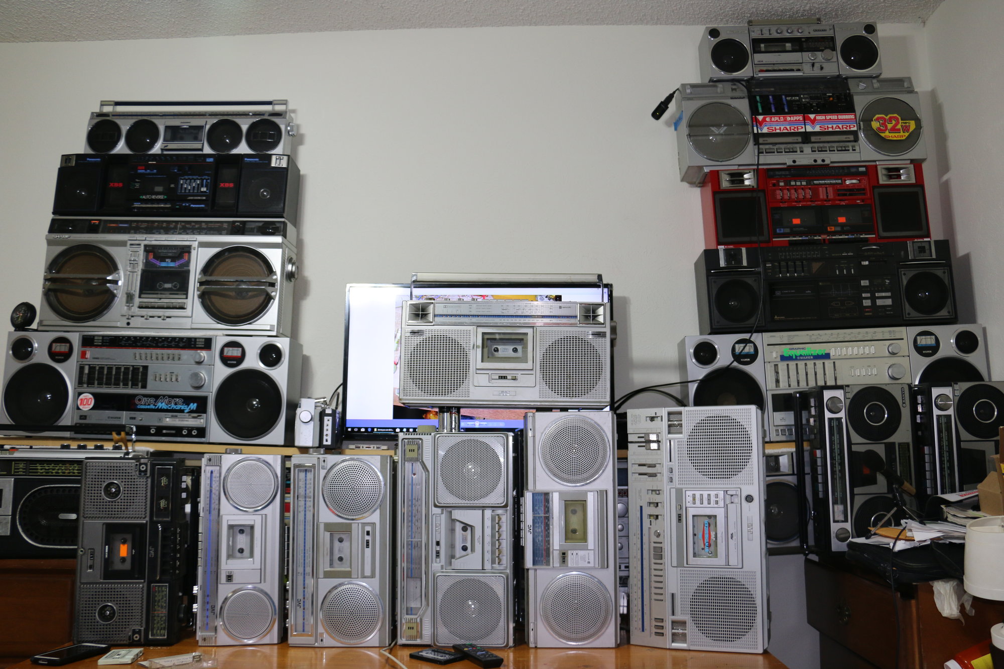

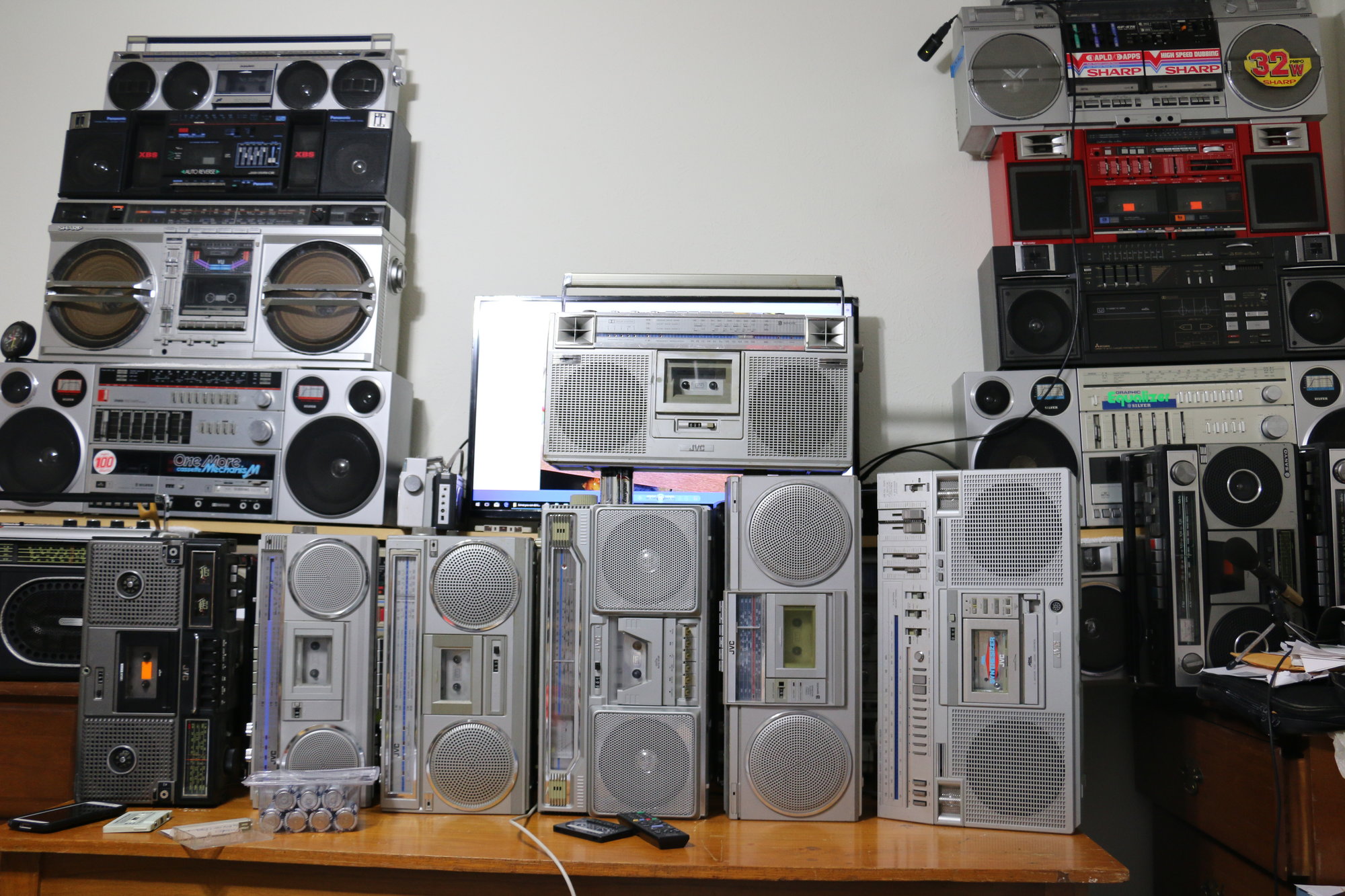

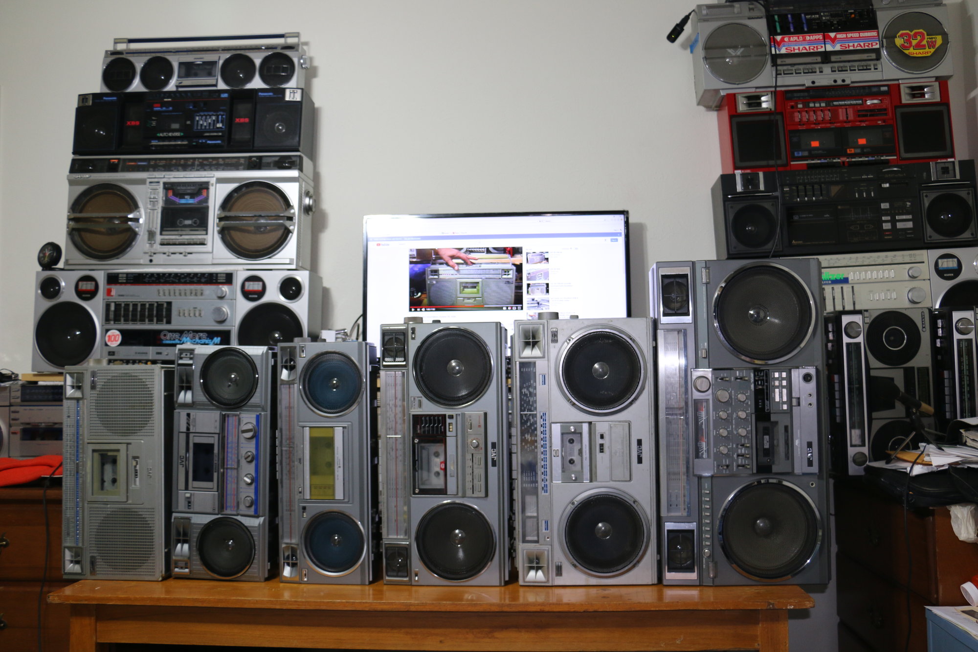

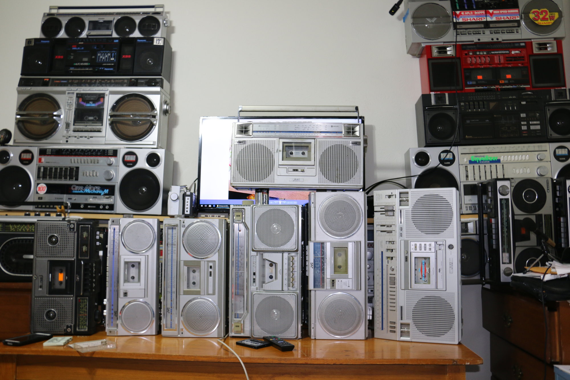

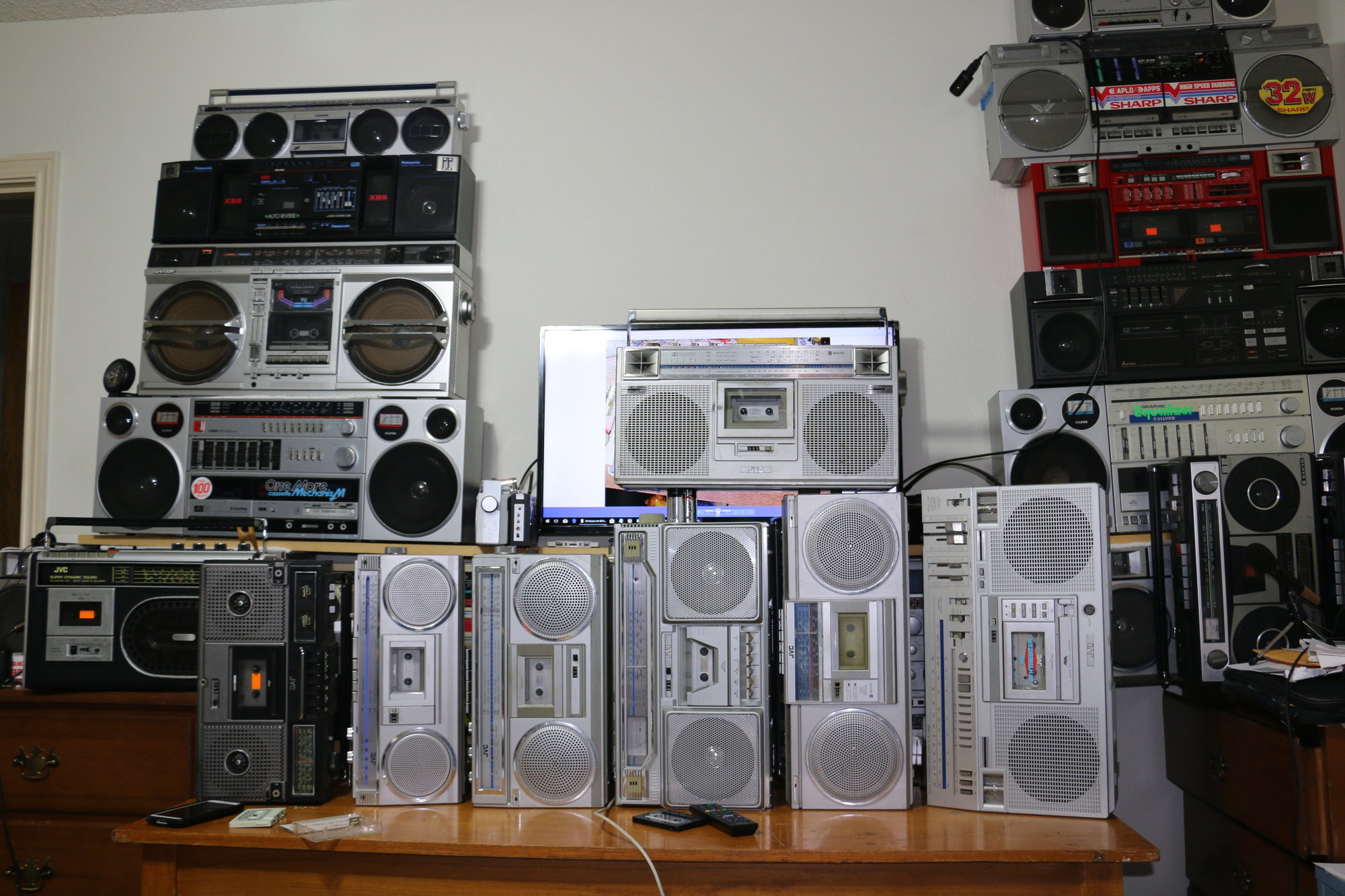

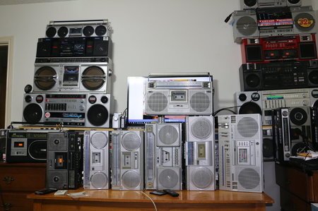

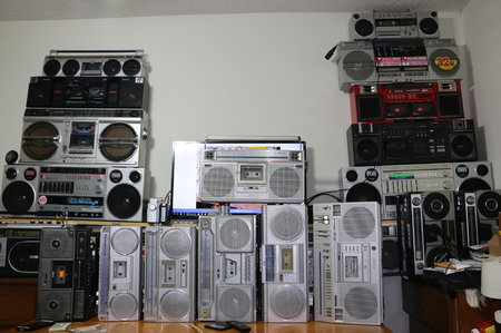

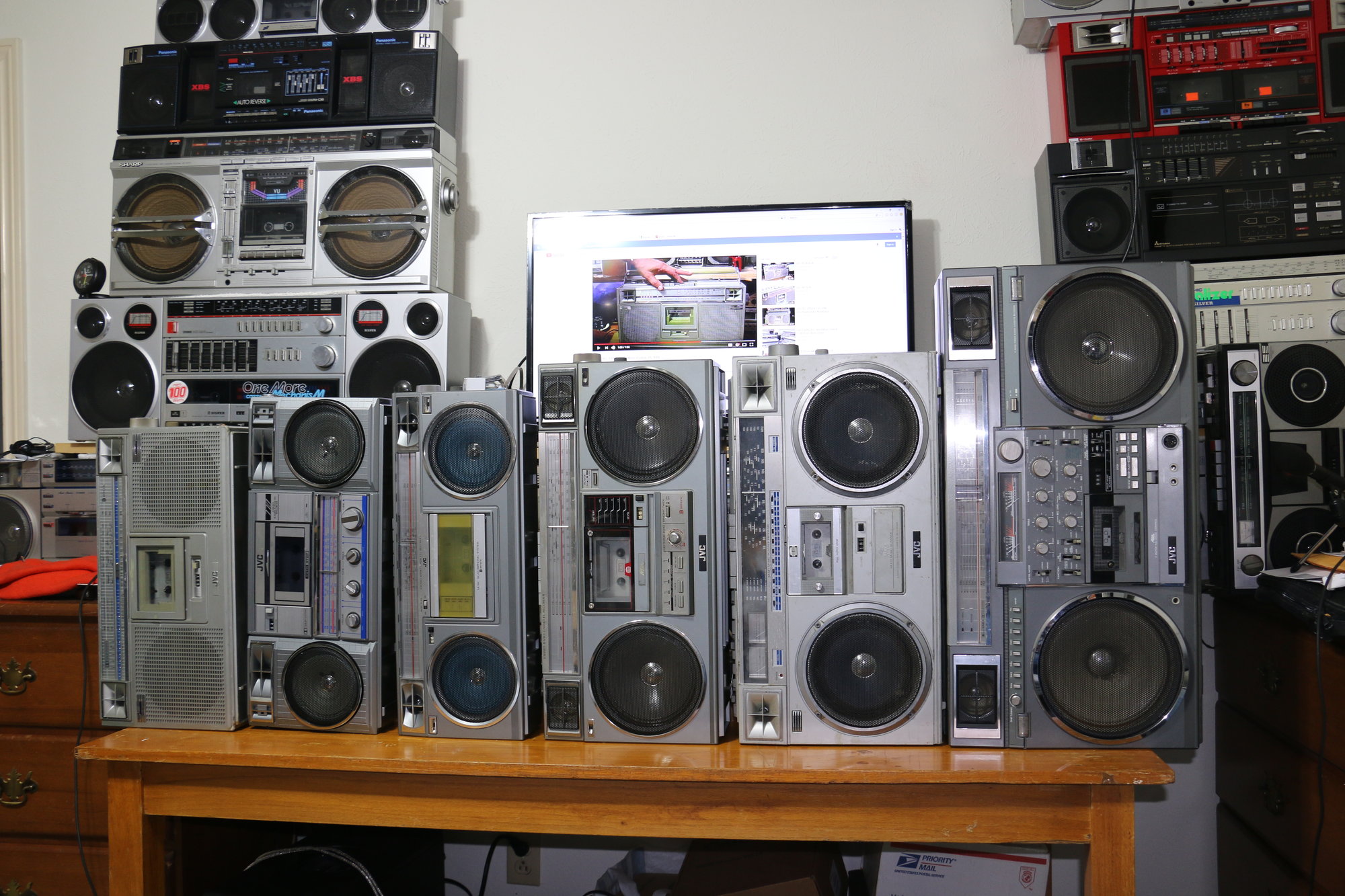

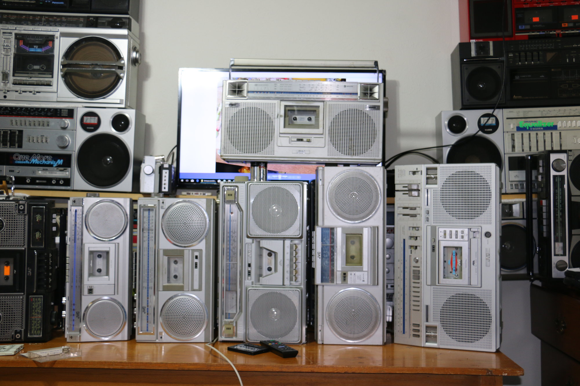

    I have a similar issue with a jvc rc-575 here is a few pictures of it as you can see with different exposures It is Green in color
    I wish I knew of a solution to get this back to clear too?
    IMG_3094 JVC RC M90 m70 m50 770 575 656 bedroom 23 nov 2017.JPG IMG_3095 JVC RC-656C 717 363 555 747 565 M80 bedroom 25 Nov 2017.JPG IMG_3096 JVC RC-656C 717 363 555 747 565 M80 bedroom 25 Nov 2017.JPG IMG_3097 JVC RC-656C bedroom 25 Nov 2017.JPG IMG_3098 JVC RC-656C 717 363 555 747 565 M80 bedroom 25 Nov 2017.JPG IMG_3099 close JVC RC-656C 717 363 555 747 565 M80 bedroom 25 Nov 2017.JPG
